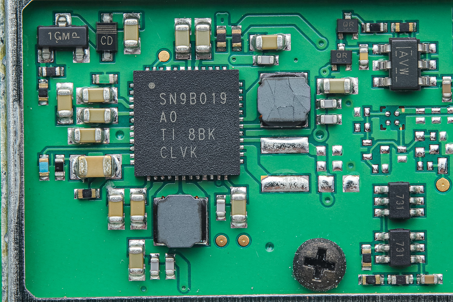

    I have several boards like this from my buddy...The boards are out of training collars for hunting dogs. Powered by 3.6V Li-ion, 2750mAh, 9.9Wh battery. This components are related to the audible tone and shock functions of these collars... and all have these same SMD components that are bad. All the boards have 2 of these (as shown in the 2nd image) and the related functions of the units are non-working on the boards with the damaged SMD's. They have only C on them.
    Does anyone here know how to find out what this component is and where to get it.. if it is available??
    Any help will be greatly appreciated.

        Without details cant help , share the details . or share the board full picture any part no on the board.
          • 31250
          Re: ID help with SMD, Please?
          it's an inductor, but i dont know what "C" means
          why are they breaking? ferrite is pretty strong

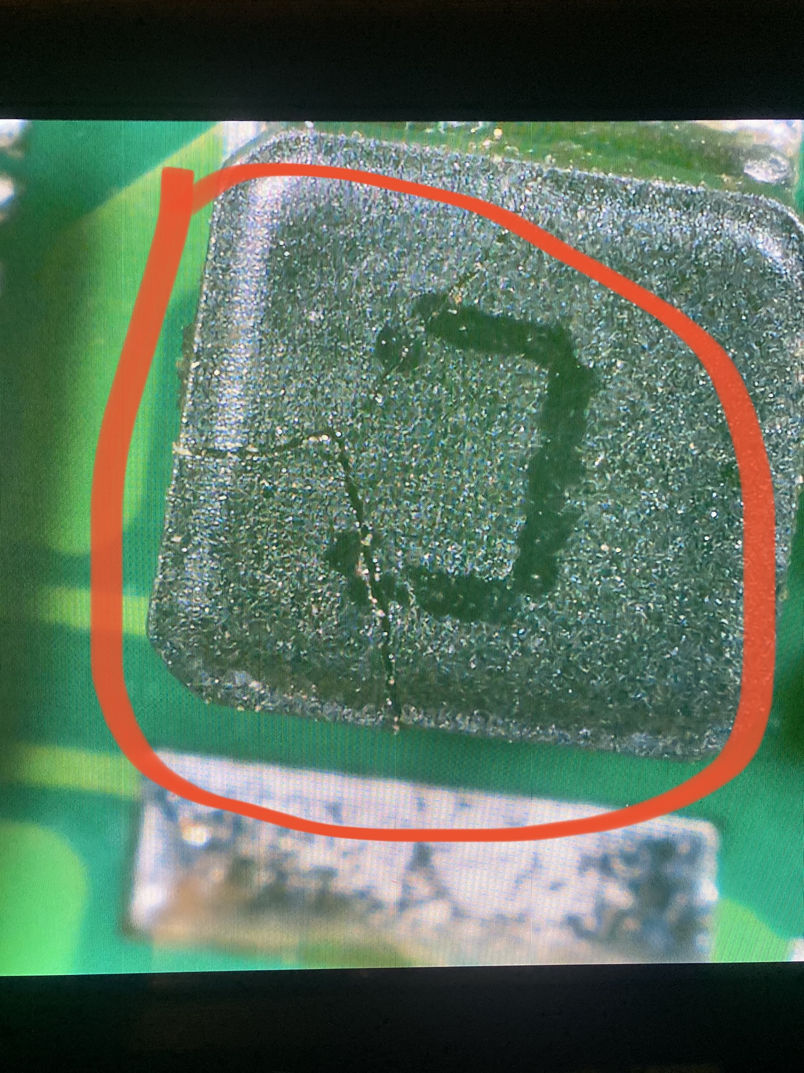

            The collars are strapped around dogs necks and the dogs fight huge wild hogs/boars (anywhere from 150-350 plus pounds) and are in a lot of swamp areas..lots of water. I am not seeing any moisture damage in the units though.
            I am guessing that it has something to do with the shocking part of the collar..maybe it over heats if shocking for too long..although the collar does have a 10 second auto shut off on the shock function. Not sure...but I do know that these inductors are damaged in every collar that the shock/tone function no longer works.
            THe board is fastened with 4 screws and 3 solder connections inside a waterproof housing...so I would think that it's not "rattling" around in there or anything like that.

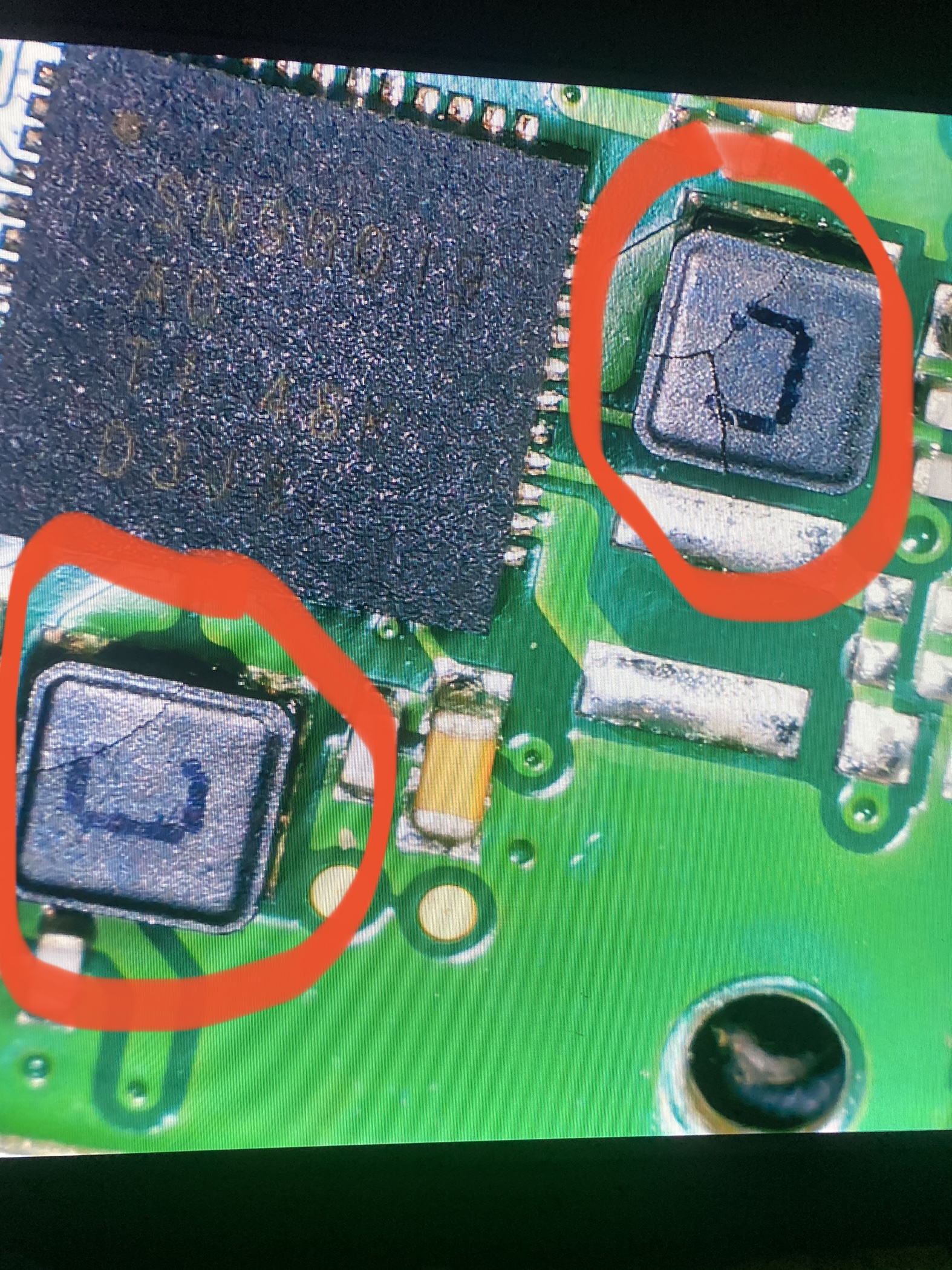

            • Macroman
              • Feb 2022
              • 22
              • USA/Philippines
              another couple of the boards..same smd's, cracked

                whats the part number on that chip?
                btw, it may be a water problem.
                if the dog is wet the shock will bypass the dog and go through the water - at much higher current.
                it could be overloading the high voltage generator.

                  Best I can tell the number on the chip is..
                  SN98019
                  A0
                  TI 91k
                  ASKL
                  The theory about the wet dog is very possible for sure..

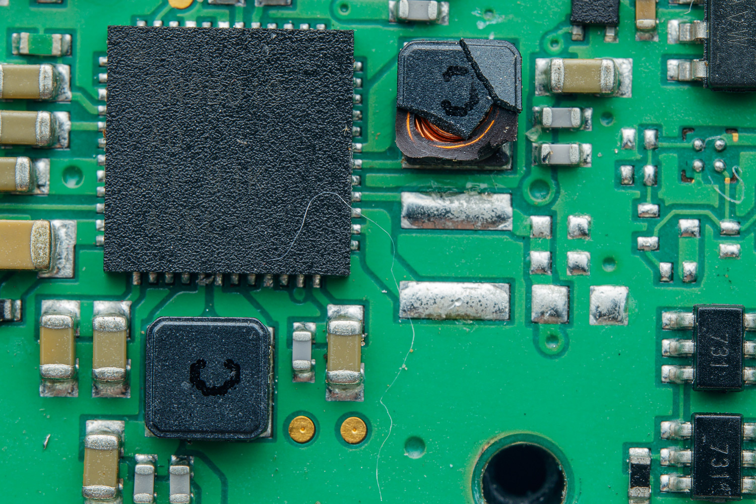

                  • Macroman
                    • Feb 2022
                    • 22
                    • USA/Philippines
                    Newer version of same model collar..
                    Different looking coils but same damage and different numbers on the chip..

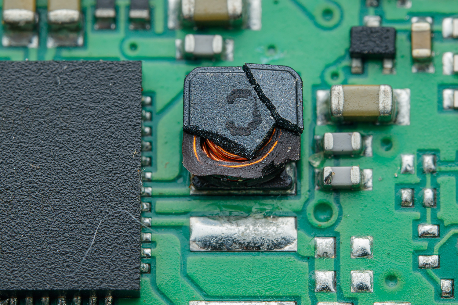

                        I suspect this is the main power management ic, "similar" to a TPS6521815 or maybe like a TPS65072
                        "similar" as in NOT THE SAME, different pinouts etc.

                                I would guess something else is bad, like the chip. In post #10, the coils ferrite is cracked, but I can't see that being the problem, likely the internal buck converters that the coils are part of, are bad. Have you done any voltage checks etc. on the ic? What are the voltages on the coils? I suspect this ic supplies other voltages for the other ic's in this device.
                                based on a picture of another garmin device that also uses a TPS6300 ic (buck/boost converter) and an inductor marked "C" It's datasheet suggests a 2.2µh coil
                                TDK VLF4012-2R2
                                Coilcraft LPS3015-222MR
                                muRata LQH3NPN2R2NJ0

                                  I have a working collar..so I am going to do some comparison testing with one of the non-working collars and check the voltages and readings on some of the other components in the circuit.
                                    • 31250
                                    you could lift and meter an undamaged coil - if you have an LCR or component tester

                                      DC50, T5? Damaged inductors on all Garmin collars. Occurs when the shield cover is struck or closed. This is their disease. In this state, they work and the collar turns on. SN9B019 This is a multi-voltage power controller.
                                      If you want to replace the throttle, then take it from a donor or measure a serviceable one.
                                      If your collar does not turn on, then the coil is not the problem.

                                        This is a TT10 collar...I have looked at several of these for my friend (TT10's, TT15's, and a couple T5's) and a lot of them have the same problem with the inductors for sure.
                                        Do you think that this is being caused from a "jar" while the dog is wearing the collar??... Or could it be that the guys are tossing the collars around roughly..say into a metal toolbox or storage compartment on a dog box, etc.????
