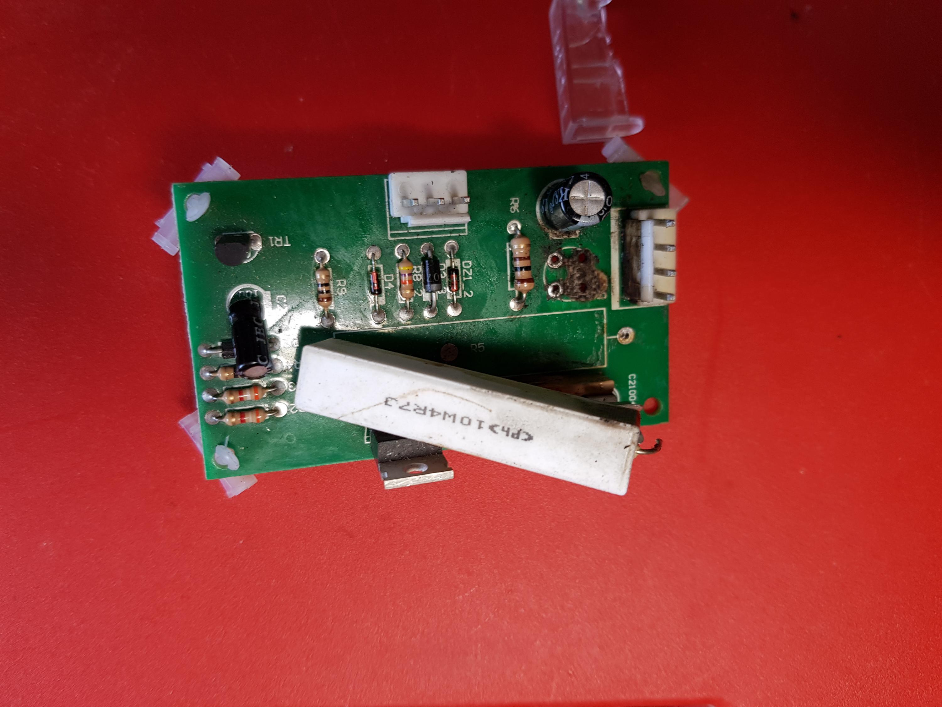

MIG-130 feed motor PCB GI-PCB-H59-A0 repair (old: Help me with capacitor replacement)

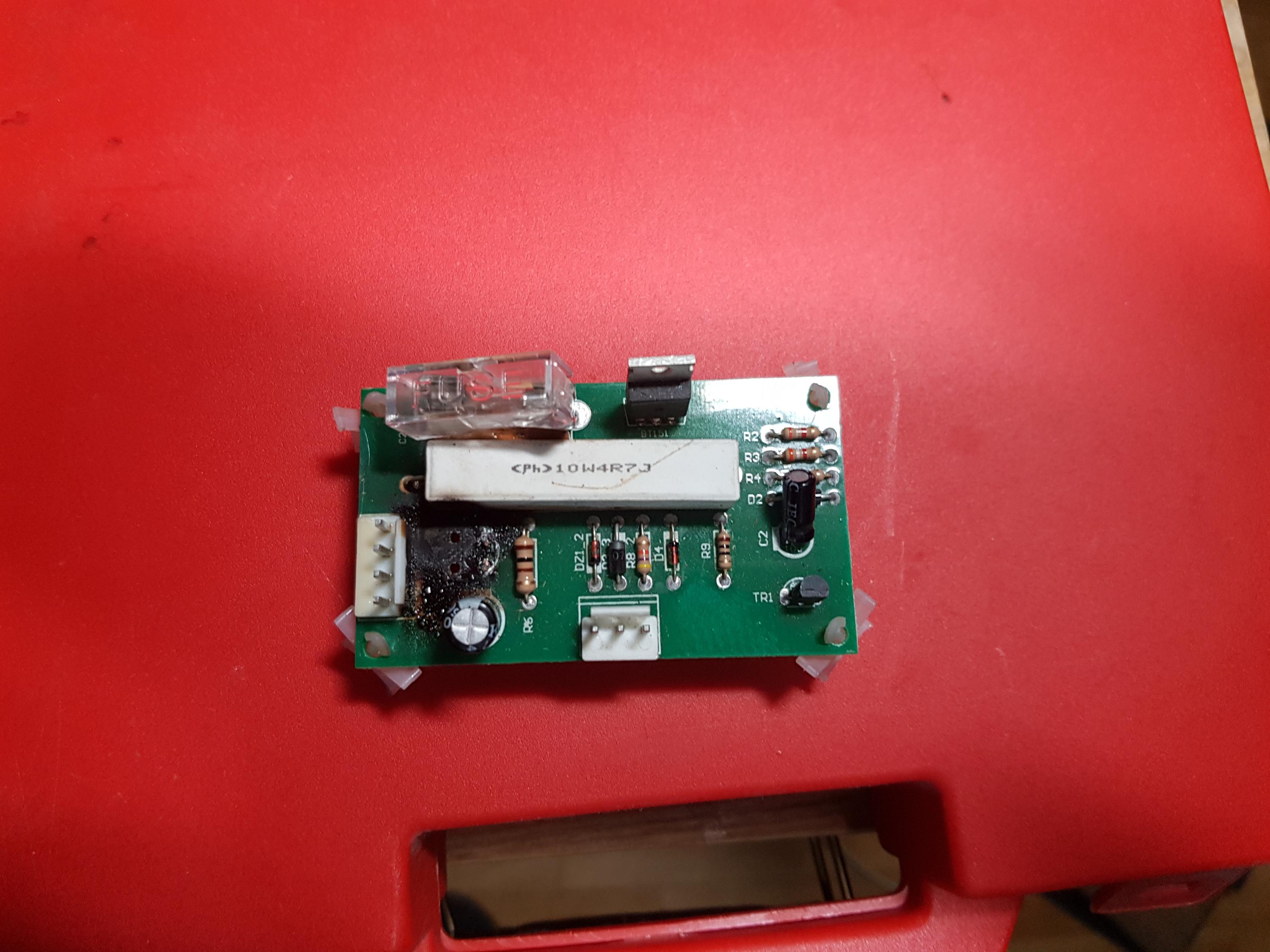

    Hi I have this circuit from a me welding station that has a burnt capacitor but I don't know the value of it wonder if you can help me? the one that is left has 100uf 50v there is a fuse on the circuit it is ok
    • 31015
    Re: Help me with capacitors replacement

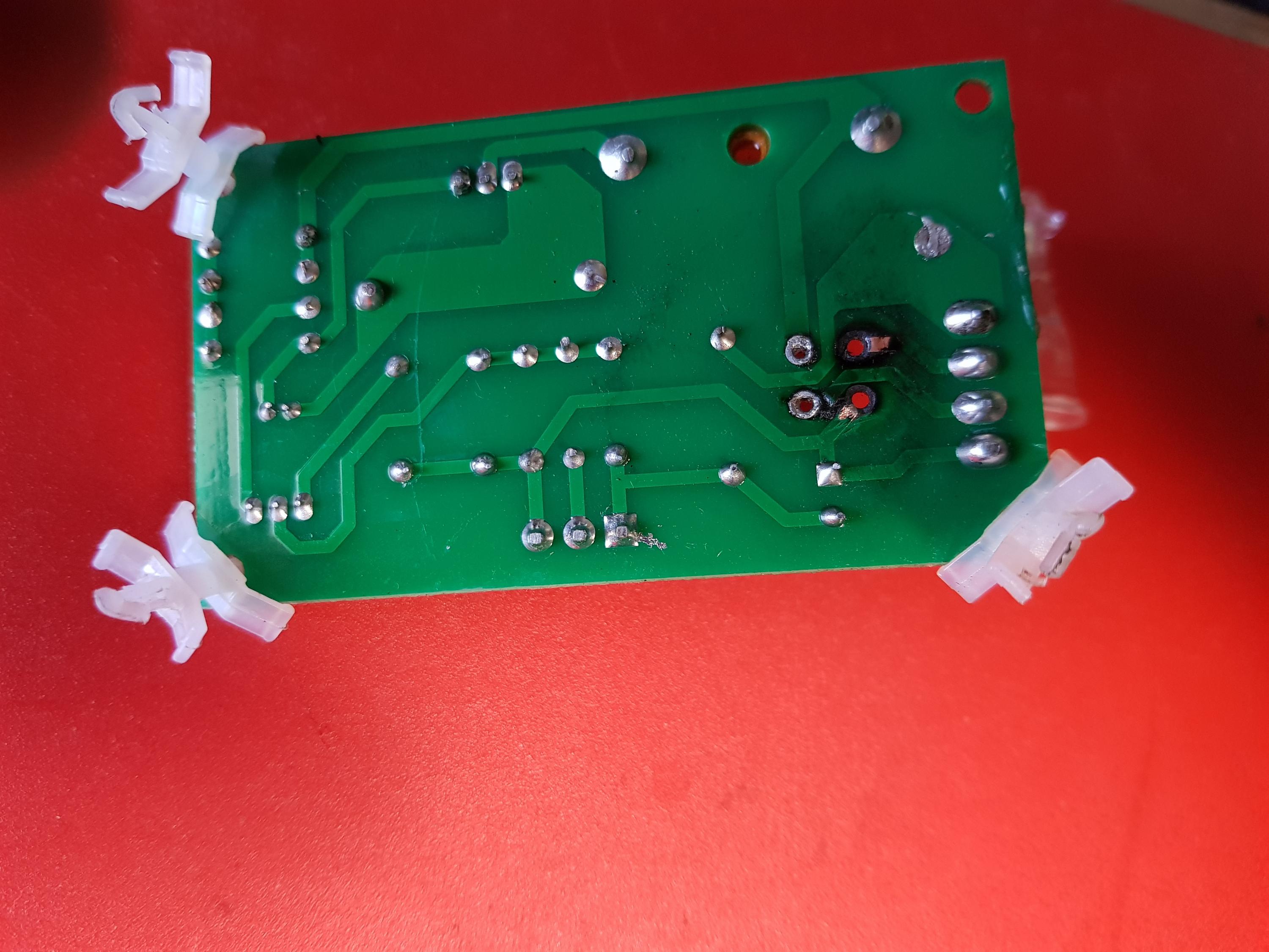

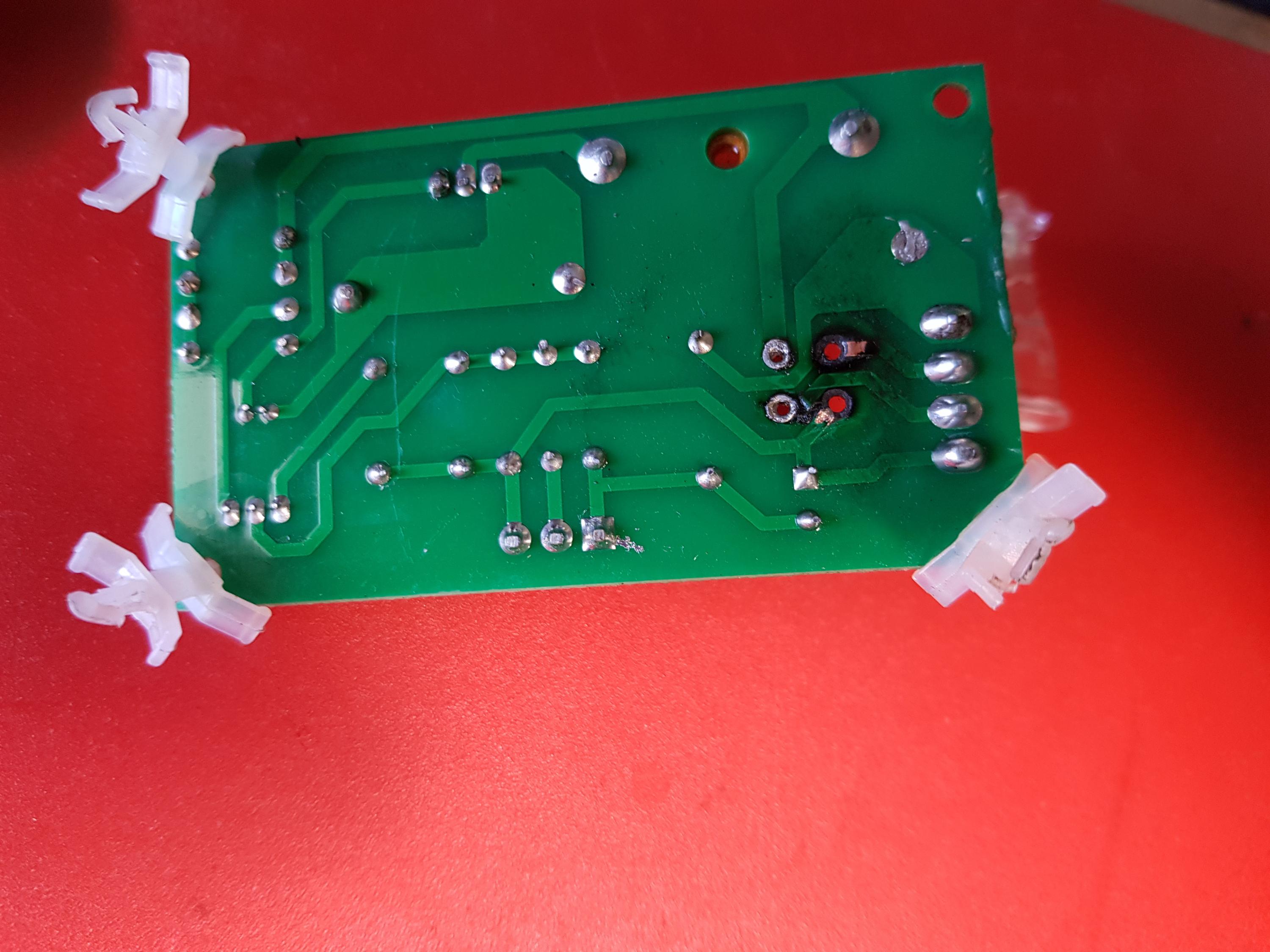

    show the back of the board,
    there are 2 missing parts i think
        It's not a capacitor, it is a 2W10 bridge rectifier. Here is a picture in case the others disappear in the future.

          • redwire
            • Dec 2010
            • 3907

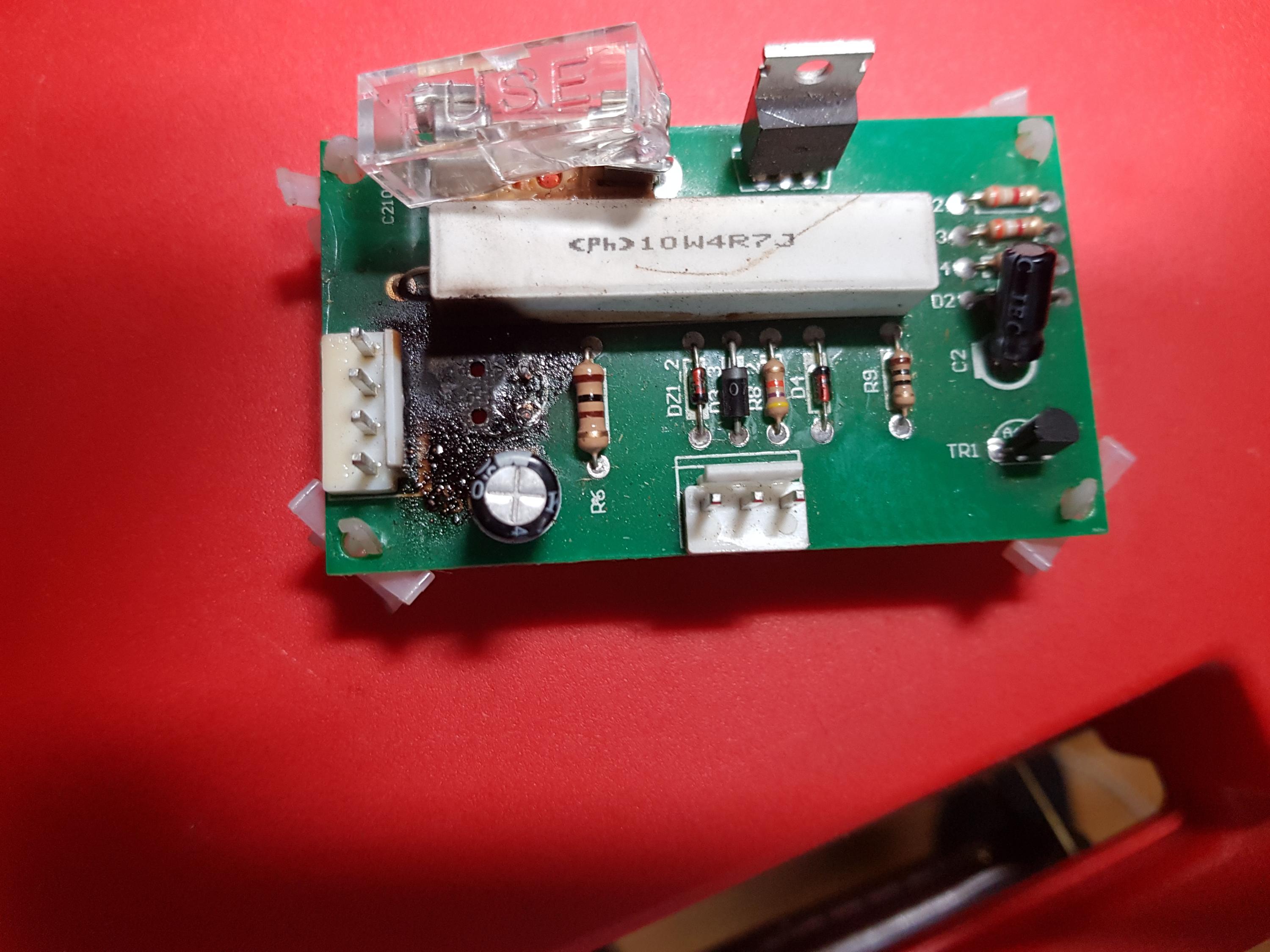

            I would say it's a crappy soft-start circuit, the big resistor gets bypassed by the triac once the main filter caps are charged up, after the delay.
            The board does not look repairable - the bridge rectifier burned up quite badly and the board has too much carbon tracking for mains voltage use IMHO.
            If the welder has shorted power components (mosfets, IGBT's) it usually burns up the soft-start resistor so not sure what happened here. The board might have had an arc across the connector/bridge rectifier due to badly designed pc board spacings.

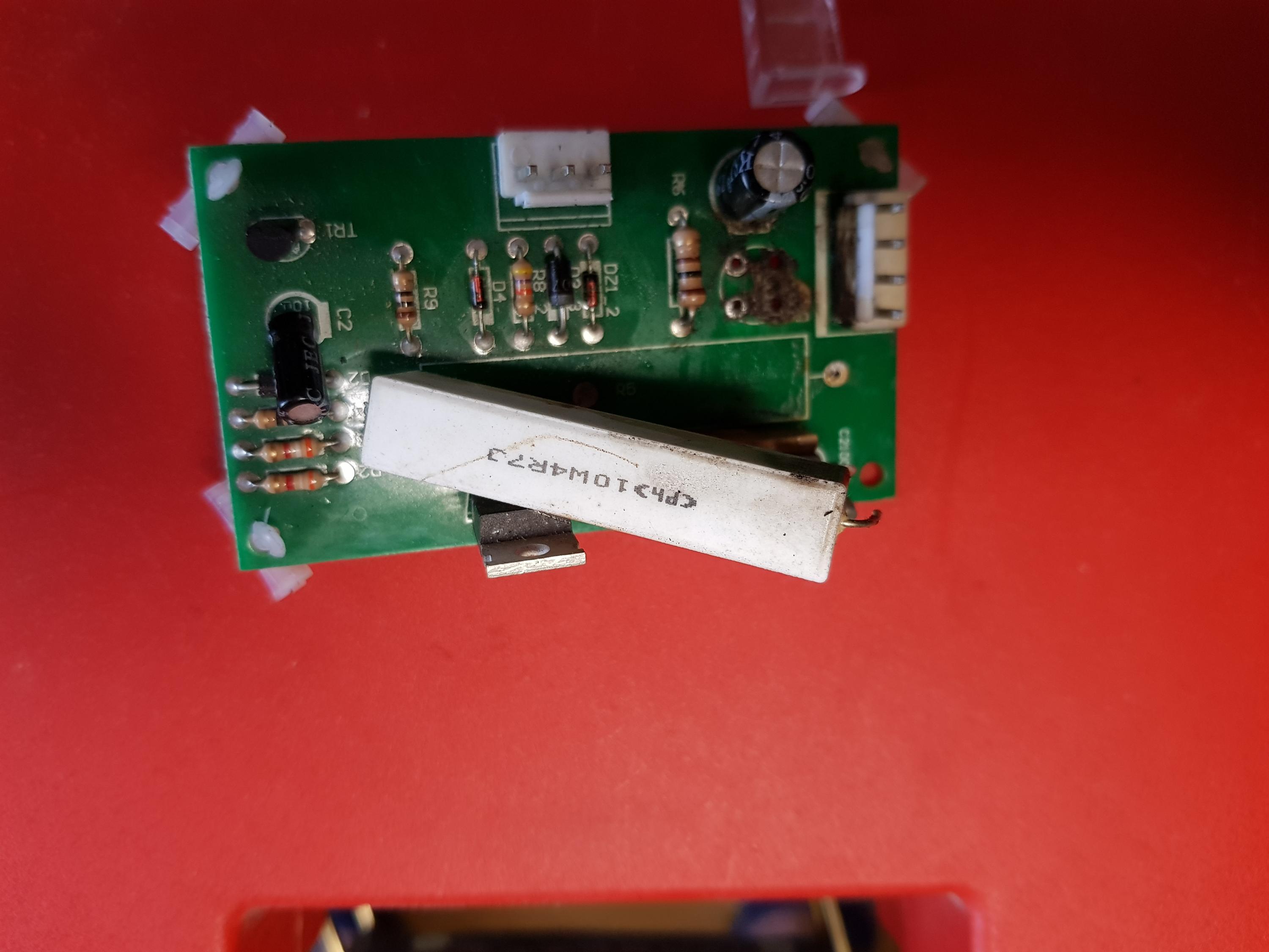

              Thank you all for your quick replies. The circuit looks to be able to be layered it's just dirt on the top part .now the question is what best bridge rectifier that can replace the old one and that might last because I can't find similar in my junk
                please show pictures after you have cleaned the pcb
                    here some pics there are those two holes that need to be cleared a bit more
                      • 31015
                      thats a lot better than expected!
                      but did you find anything else shorted? something else probably caused that.

                                • Per Hansson
                                  • Jul 2005
                                  • 5895
                                  • Sweden

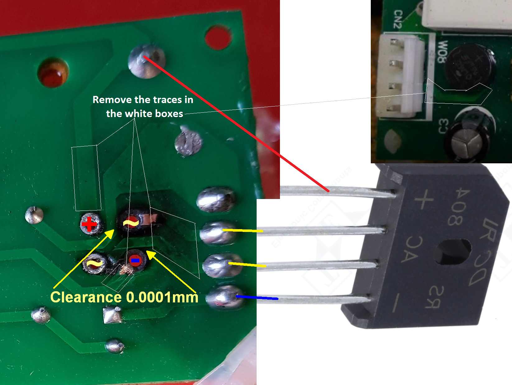

                                  Check the attached photo, the clearance is a joke!
                                  I would put a regular bridge rectifier like I have shown if there is room for it.
                                  Then remove the traces so the clearance between them is more than a cat whiskers hair!
                                  But you need to triple check my work, it is hard to tell if there are more traces on the top of the board...

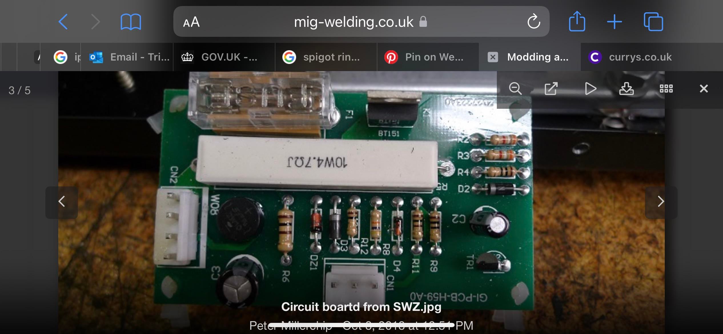

                                      Just noticed your board is unmarked but the one linked by petehall347 in reply #3 has markings on it.
                                      The board is apparently for the wire feeder motor in the welder, and from what others wrote on Reddit it sags so the wire speed is inconsistent.
                                      If you search for these you get lots of hits, seems like a remarkably crap design!
                                      GI-PCB-H59-A0
                                      ZD27223A0
                                      PS: K1 is a: BT151-500R Thyristor (aka SCR)
                                        Thank you very much R J, Per Hansson and petehall347. Yes there is room but as you said Per I need to take an extra look at your work. but you say "I would put a regular bridge rectifier" of what value if you were to recomendera?
