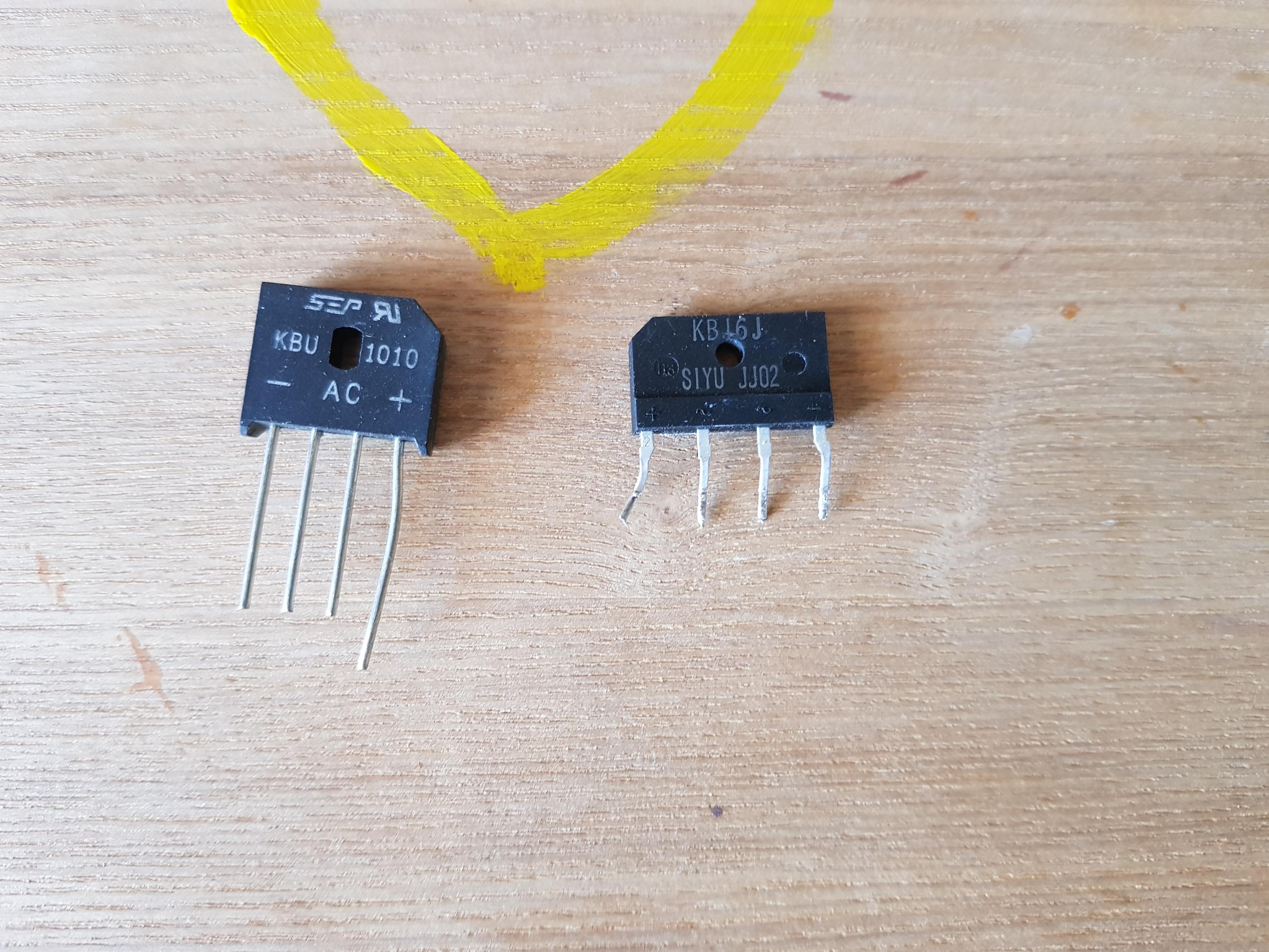

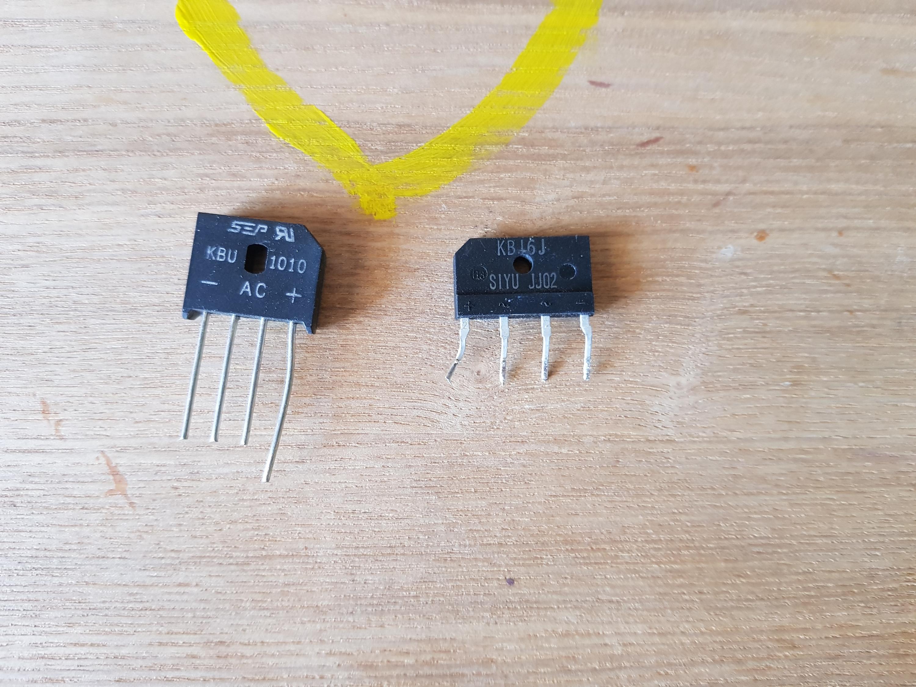

      Yes there is room but as you said Per I need to take an extra look at your work. but you say "I would put a regular bridge rectifier" of what value if you were to recomendera?
      It does not matter, the original is only rated for 2A so it should be more than that.
      But any bridge rectifier you have in that large package I showed is going to be rated for more than that...
      I would go with one rated for 1000v just because the original seems to be.
      And not because the circuit requires it, but because in a welder you have very large voltage spikes, and that could destroy the diodes...
      Infact it might be good to put some TVS protection, for example a varistor across the bridge rectifiers input.

            Yes sure, I'd pick the one with the longer legs, just because I could not find a datasheet for the other one.
            • R_J
              • Jun 2012
              • 9515
              Re: Help me with capacitors replacement
              The one with the shorter leads is 6 amp 600v

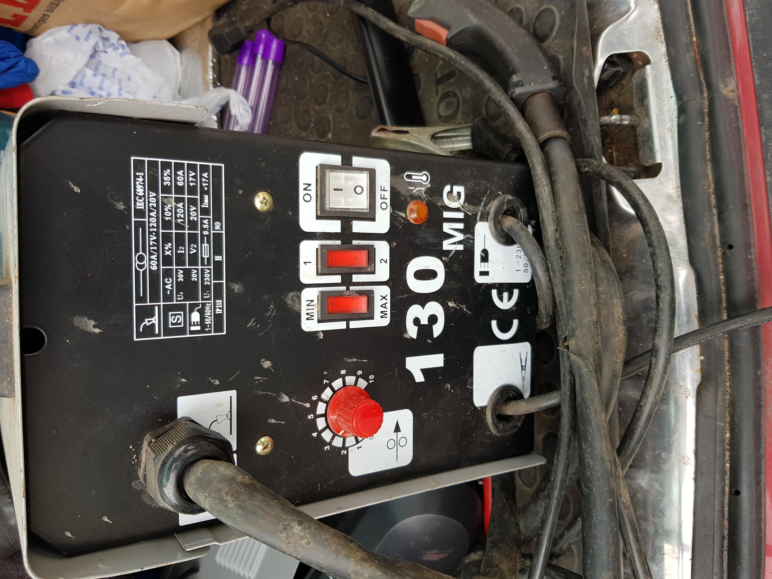

                  I can't see upsizing the bridge rectifier because of the high (mains) voltage and the PC board bad design mean the spacings simply are not good enough. You need a couple mm at least or it will just arc. That leaves flying leads to connect to it I guess.
                  Second, then it will start a new problem - what now limits power to the feed motor, when it jams? You need a fuse or circuit breaker, otherwise something new will burn up. The triac has no heatsink either. This is a cheap board.
                  It seems to assume the feed motor only needs say 2A max.
                  What model name/number is this welder?

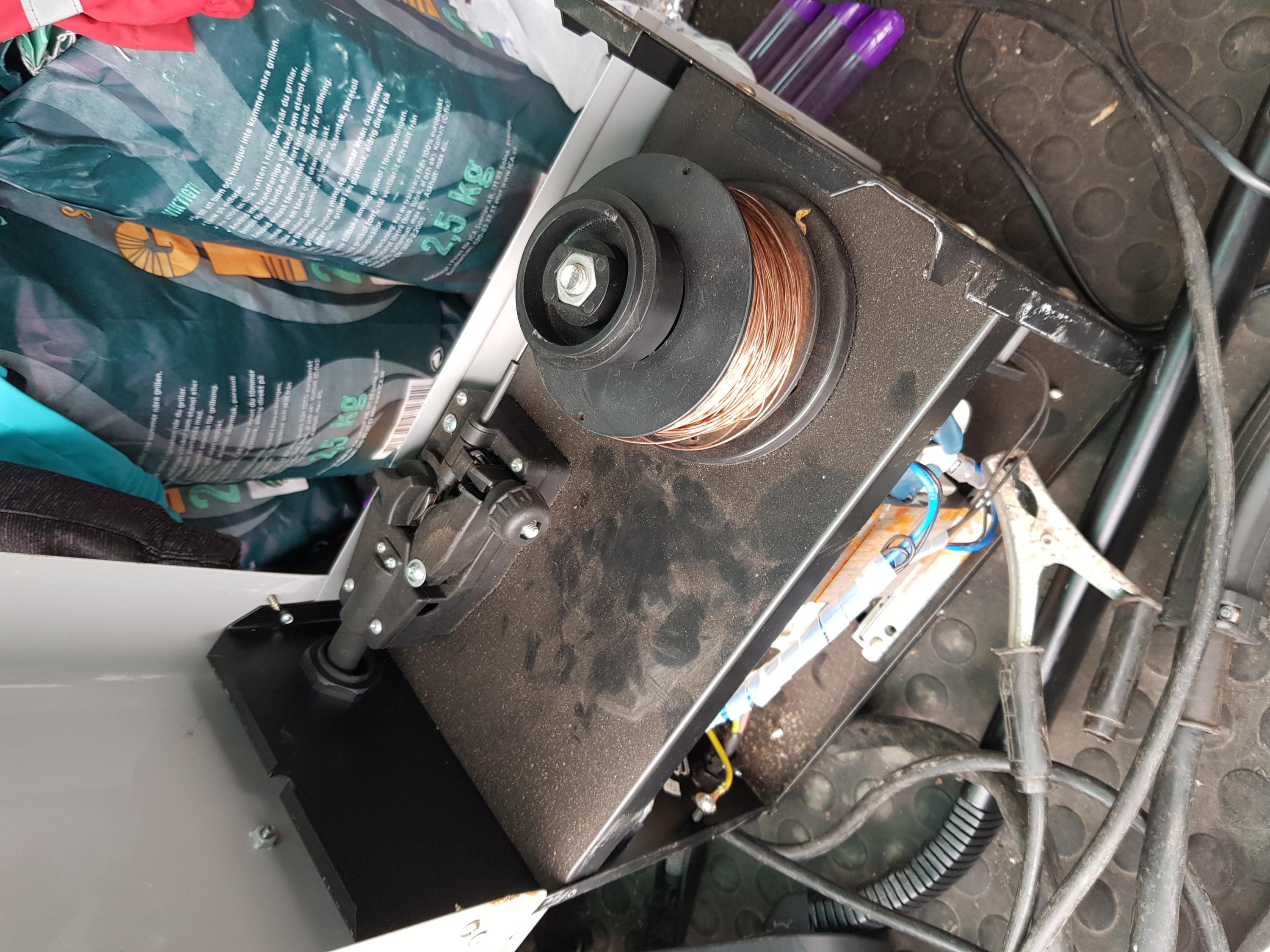

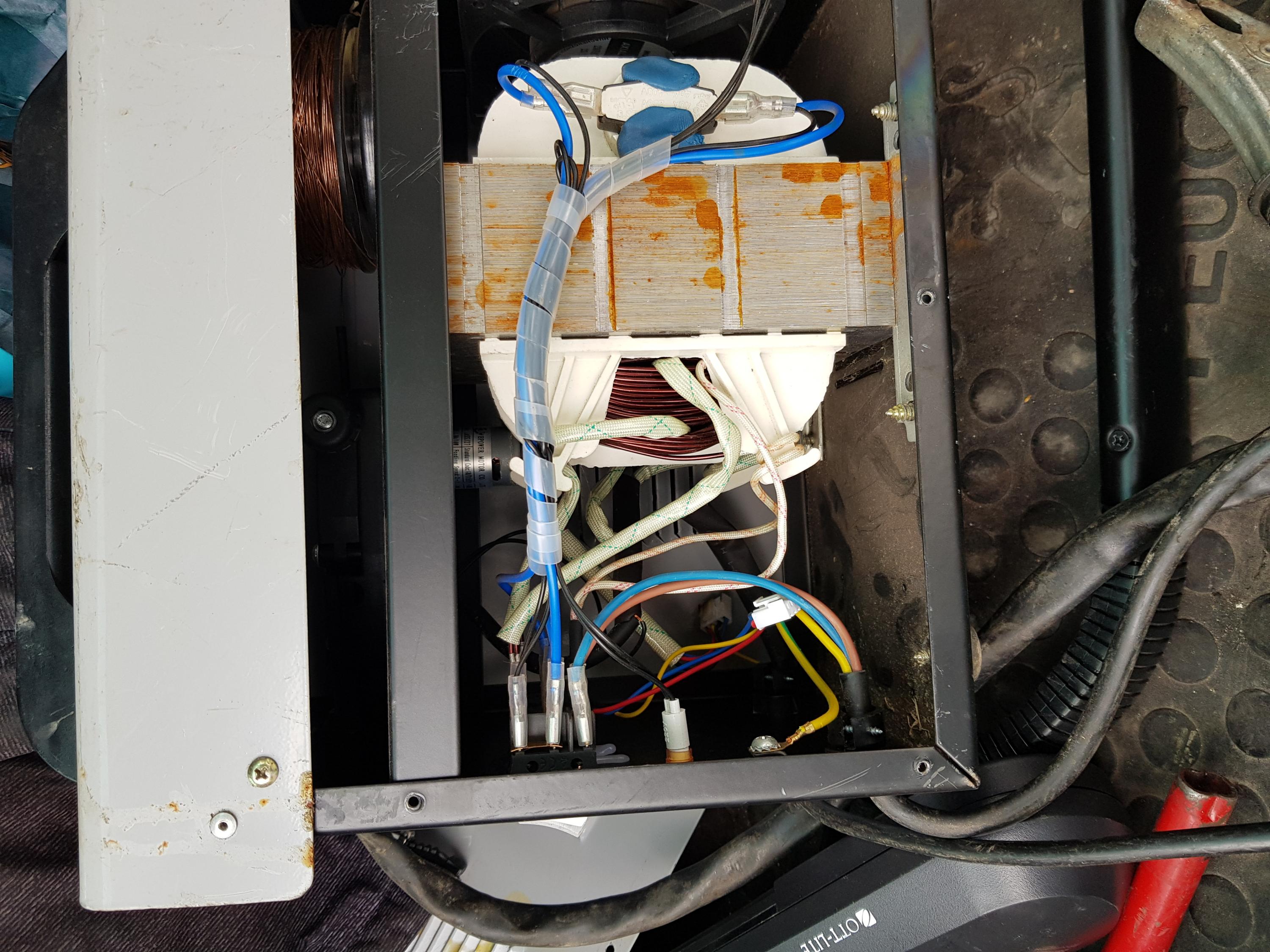

                    here some pictures of the aggregates with some data
