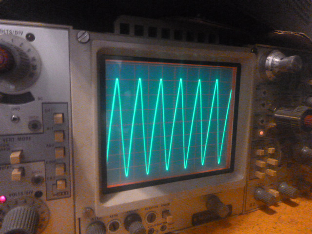

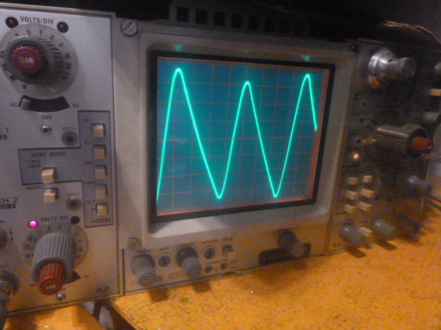

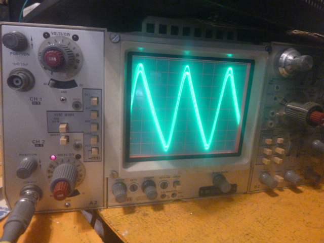

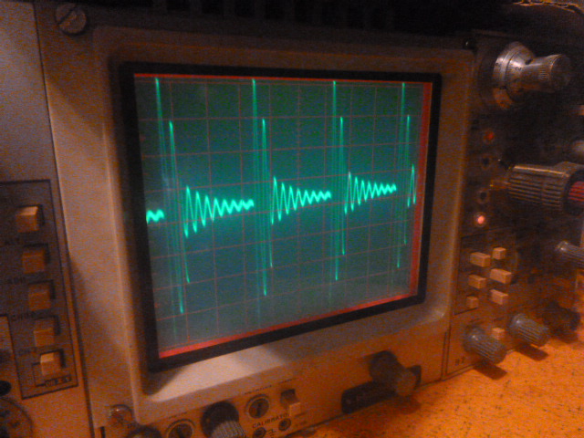

Another Kenwood CS-4035 question
  • Crystaleyes
    replied
    Re: Another Kenwood CS-4035 question
    Must say, considering that the HV transformer is not realistically possible to find a replacement, I'm getting very close to moving on from this. Either selling on for parts, or stripping it down and selling the super-rare hybrids, CRT, mains transformer, buttons etc.
    After reinstalling the HV trafo, not a lot, if anything, has changed.
    The only thing I can still think of is that the 2SD613 really NEEDS to be the correct 2SD1666 in order to work? (although I am sure it was working before)
    So unless there are any more ideas, then it is probably time to take it on the chin and do something else.
    Picked up a Tek 2215 this week for example, which needs the sweep cleaning up...
    Last edited by Crystaleyes; 06-05-2022, 08:02 AM.
    Leave a comment:
    replied
    Re: Another Kenwood CS-4035 question
    the primary side is fed by the +-10v wherever that comes from.
    and yes, the op-amp tweeks the feedback to regulate the output
    Leave a comment:
  • Crystaleyes
    replied
    Re: Another Kenwood CS-4035 question
    Originally posted by stj
    pins 1 and 2 are the primary,
    pins 3 and 4 are the feedback that creates self-oscillation.
    when 3 and 4 have voltage the transistor Q8 turns off killing the primary,
    that causes the voltage to drop on 3 and 4 allowing the transistor to turn on again.
    11 and 12 are the heater drive, usually between 6 and 10v
    5 is output common
    6 is the 140v output - but at AC it wont look like that - check the cathode of D11
    7 is the HV and the schem says -1500v but again you need to meter it after the diode/cap at R56 or p9
    obviously all the windings will be oscillating at the same frequency.
    Thank you. Very interesting.
    Are you saying that the primary 'induces' a voltage into the feedback coil? And the primary is fed by the same AC signal which is seen in TP 6, or is it by the oscillating DC?
    The op-amp is to regulate the voltage?
    Last edited by Crystaleyes; 06-04-2022, 08:20 PM.
    Leave a comment:
  • Crystaleyes
    replied
    Re: Another Kenwood CS-4035 question
    Well, I've the pulled the transformer to see if anything is obviously wrong, and I can see that there might be a problem.
    There are no shorts between the coils and measuring off board and with a component tester gives the following readings;
    Pins 1 + 2 = 0.19Ω
    Pins 3 + 4 = 0.11Ω
    Pins 5 + 6 = 953.6Ω / 318.3mH (36pF)
    Pins 5 + 7 = 803.5Ω / 261.9mH (43pF)
    Pins 6 + 7 = 6.65Ω / 3.06mH
    Pins 11 + 12 = 0.14Ω
    The problem is that any reading which includes pin 5, occasionally comes up as a 'capacitor' measuring 10's of picofarads, not always, but only with pin 5 (Gnd), so I'll have a good look in the daylight and see if the solder has come loose or dry? Still unsure about the HV diode D10 too.
    ...I told you I should have set fire to this scope the other day...
    Last edited by Crystaleyes; 06-04-2022, 08:17 PM.
    Leave a comment:
  • Crystaleyes
    replied
    Re: Another Kenwood CS-4035 question
    Originally posted by stj
    if you still have a second matching scope, i'd swap the transformer.
    Unfortunately not...
    Trying to think how I can confirm the transformer is at fault?
    Leave a comment:
    replied
    Re: Another Kenwood CS-4035 question
    if you still have a second matching scope, i'd swap the transformer.
    Leave a comment:
    replied
    Re: Another Kenwood CS-4035 question
    pins 1 and 2 are the primary,
    pins 3 and 4 are the feedback that creates self-oscillation.
    when 3 and 4 have voltage the transistor Q8 turns off killing the primary,
    that causes the voltage to drop on 3 and 4 allowing the transistor to turn on again.
    11 and 12 are the heater drive, usually between 6 and 10v
    5 is output common
    6 is the 140v output - but at AC it wont look like that - check the cathode of D11
    7 is the HV and the schem says -1500v but again you need to meter it after the diode/cap at R56 or p9
    obviously all the windings will be oscillating at the same frequency.
    Leave a comment:
  • Crystaleyes
    replied
    Re: Another Kenwood CS-4035 question
    Originally posted by stj
    resistance between 5 and 7???
    lift one end of R52 and recheck the voltage at 11,12
    btw, did you replace the caps at c17,20 and 21?
    Yes, C17, C20 and C21 were all replaced
    Actually I made a mistake. Had confused the secondary coils pinout.
    Pins 1+2, have around +11.06v and between 32 to 35kHz (depending on which measurement).
    Pins 3+4, have around -10.55 volts across them, and the same frequency
    Pins 5 to 6 is ~6.8Ω with ~17kHz - Negligible voltage
    Pins 5 to 7 is ~1.600kΩ and has ~33kHz - Negligible voltage
    Pins 6 to 7 is ~1.590kΩ - ~18kHz - Negligible voltage
    Pins 11 + 12 are the ones fluctuating wildly, but do have up to 35kHz too
    Lifting R52 makes no difference to the secondary outputs
    As for pins 5, 6 and 7... A short circuit after a semi-conductor gets switched on?
    Maybe I'm being a bit thick, but for example, with R52 lifted, the 11 + 12 coil should be open-circuit. Surely it should behave as a normal secondary with no load connected? It should give a voltage reading across it. Unless the voltage is above 1000vdc and my meter has some serious over-voltage protection which I'm unaware of?
    Gonna lift R55 to make sure..
    Last edited by Crystaleyes; 06-04-2022, 03:40 PM.
    Leave a comment:
    replied
    Re: Another Kenwood CS-4035 question
    resistance between 5 and 7???
    lift one end of R52 and recheck the voltage at 11,12
    btw, did you replace the caps at c17,20 and 21?
    Leave a comment:
  • Crystaleyes
    replied
    Re: Another Kenwood CS-4035 question
    More info...
    The HV transformer coils all have continuity.
    Pins 1+2, have around +11.06v and between 32 to 35kHz (depending on which measurement).
    Pins 3+4, have around -10.55 volts across them, and the same frequency
    Pins 6+7 fluctuate anywhere between -1v to over -130v DC with no frequency
    Pins 11+12 appear to have absolutely nothing on them, although the coil measures 6.8Ω with the power off.
    Apart from wondering if perhaps the transformer is fecked, the fluctuating output of pins 6+7 needs to be resolved?
    Leave a comment:
  • Crystaleyes
    replied
    Re: Another Kenwood CS-4035 question
    Originally posted by R_J
    I did not know you had another scope, I thought you sold the other one. That waveform looks like the primary winding is just being pulsed and shutting down. One pulse on the primary, leads to the large pulse on the secondary, which then just fades away until another pulse on the primary.
    So also check the waveform on pin 4 of the transformer (Q9 collector) It should be a nice sine wave like wf6 but smaller.
    Something else to try would be to disconnect the high voltage block (W1) disconnect the jumper E, then see what the waveform 7 looks like.
    I've picked up a few broken scopes over the last few months for silly money, and the one in the pictures I only got working last week, but I haven't checked any cailibration other than the LV rails yet.
    Actually just bought another Tektronix scope this week too.
    That is one good thing about being in a third world country is that hardly anyone actually does component level repair, so some real bargains can be found for non, or partly-working stuff.
    As for the readings, I have just started over again and 1 to 4 are as pictured in the manual, although they are not solid, they are pulsing.
    TP 6 is actually not 'clearly' a sine wave, and it sometimes appears to have a ghost image on top. (see photo #1) and sometimes not (photo #2)
    TP 7 shows no signal with jumper E disconnected
    Q9 Collector gives the wave in photo #3
    C20 and C21 both show AC ripple of about 500mV
    Reading into the manual it says that Q8 should oscillate around 50kHz yet the DMM senses no frequency other the mains
    Last edited by Crystaleyes; 06-04-2022, 10:16 AM.
    Leave a comment:
  • R_J
    replied
    Re: Another Kenwood CS-4035 question
    I did not know you had another scope, I thought you sold the other one. That waveform looks like the primary winding is just being pulsed and shutting down. One pulse on the primary, leads to the large pulse on the secondary, which then just fades away until another pulse on the primary.
    So also check the waveform on pin 4 of the transformer (Q9 collector) It should be a nice sine wave like wf6 but smaller.
    Something else to try would be to disconnect the high voltage block (W1) disconnect the jumper E, then see what the waveform 7 looks like.
    Last edited by R_J; 06-03-2022, 09:53 PM.
    Leave a comment:
  • Crystaleyes
    replied
    Re: Another Kenwood CS-4035 question
    Originally posted by R_J
    So test point 6 is ok??? approx. 35v p/p ? Since you have another scope... check what is on C21+ and C20- if the caps are good the ac ripple should be next to zero. That waveform looks like something is killing the oscillation, check the waveform on the heater winding
    Shall do, but need to hit the sack now as it is past midnight and I don't wanna turn into a pumpkin (again)... But I'll check those in the morning and get back.
    If you think of anything else to test, I'm all ears...
    Thanks again.
    Leave a comment:
  • R_J
    replied
    Re: Another Kenwood CS-4035 question
    Originally posted by Crystaleyes
    It came from TP7 - The transformer side of R24
    So test point 6 is ok??? approx. 35v p/p ? Since you have another scope... check what is on C21+ and C20- if the caps are good the ac ripple should be next to zero. That waveform looks like something is killing the oscillation, check the waveform on the heater winding
    Leave a comment:
  • Crystaleyes
    replied
    Re: Another Kenwood CS-4035 question
    Originally posted by R_J
    Where did the scope image come from in post 37? Did you scope that point and get that waveform?
    It came from TP7 - The transformer side of R24
    Leave a comment:
  • R_J
    replied
    Re: Another Kenwood CS-4035 question
    Where did the scope image come from in post 37? Did you scope that point and get that waveform?
    That aside, up to and including TP 6 a clear reproduction of the waveform can be found.
    So test point 6 is ok??? approx. 35v p/p ? Since you have another scope... check what is on C21+ and C20- if the caps are good the ac ripple should be next to zero.
    Last edited by R_J; 06-03-2022, 09:32 PM.
    Leave a comment:
  • Crystaleyes
    replied
    Re: Another Kenwood CS-4035 question
    Originally posted by R_J
    Look at the schematic. that 193 volts is the DC output of the D1 bridge rectifier, if the voltage is 3 volts low it means nothing! the 160v a/c feeding the bridge could be a couple volts low, C1 could be weak. The line voltage could be a couple volts low. As for the wave form, that is the ripple measured across C1 which according to waveform (1) is 2v p/p. Note the AC after the 0.5v
    Thank you for that. Now I understand. (Although I hadn't actually considered the 189v to be a problem)
    There is a problem with no high voltage, there are only a few components in that circuit two of which are .50 cent capacitors which check low in capacity, maybe they are ok, but what if they ARE weak causing the circuit not to oscillate
    Quite true. Seems to me that the problem must lie somewhere which has already been checked. Perhaps I need to be more diligent?
    Leave a comment:
  • R_J
    replied
    Re: Another Kenwood CS-4035 question
    Originally posted by Crystaleyes
    TP1 for example should be +193v for example and reads 189.9v. The thing I don't understand is that the corresponding waveform shown has the vert and hoizontal knob settings as 0.5v AC and 2ms per division.
    Unless the CRT is 6 feet high, then I am struggling to see how a 193v waveform should be measured using 0.5v a division?
    Look at the schematic. that 193 volts is the DC output of the D1 bridge rectifier, if the voltage is 3 volts low it means nothing! the 160v a/c feeding the bridge could be a couple volts low, C1 could be weak. The line voltage could be a couple volts low. As for the wave form, that is the ripple measured across C1 which according to waveform (1) is 2v p/p. Note the AC after the 0.5v
    There is a problem with no high voltage, there are only a few components in that circuit two of which are .50 cent capacitors which check low in capacity, maybe they are ok, but what if they ARE weak causing the circuit not to oscillate
    Last edited by R_J; 06-03-2022, 08:53 PM.
    Leave a comment:
  • Crystaleyes
    replied
    Re: Another Kenwood CS-4035 question
    Originally posted by R_J
    I checked another kenwood scope (CS-5350) service manual and it uses a 2SD613, so I guess it is acceptable in that circuit.
    You do have -10v on the emitter and +10v on the collector? what voltage is on the base?
    I take it you have replace both C20 & C21.
    Emitter is -11.25v, collector is 11.08v and the base is -10.6.
    At least that is where the voltages start at, for the transistor heats up too much and the voltages start to drop.
    I haven't replaced those two caps, however they were pulled and tested. Both came in at just over 90uF, with negligible Vloss and ESR, so they went back in.
    Anyway, looking broader at the schematic I have decided to verify all the test points, which hasn't got off to the best of starts.
    TP1 for example should be +193v for example and reads 189.9v. The thing I don't understand is that the corresponding waveform shown has the vert and hoizontal knob settings as 0.5v AC and 2ms per division.
    Unless the CRT is 6 feet high, then I am struggling to see how a 193v waveform should be measured using 0.5v a division?
    That aside, up to and including TP 6 a clear reproduction of the waveform can be found.
    TP 7 is fecked. It should be sinusoidal.
    Looks like an LC wave on acid - See attachments
    Last edited by Crystaleyes; 06-03-2022, 09:01 PM.
    Leave a comment:
  • R_J
    replied
    Re: Another Kenwood CS-4035 question
    I checked another kenwood scope (CS-5350) service manual and it uses a 2SD613, so I guess it is acceptable in that circuit.
    You do have -10v on the emitter and +10v on the collector? what voltage is on the base?
    I take it you have replace both C20 & C21.
    Last edited by R_J; 06-03-2022, 04:52 PM.
    Leave a comment:
  • DrDos
    Kenwood KR-6030 vintage stereo ,Old Man Trying to Save a Buck
    by DrDos
    Hello all. I'll try to keep this short. I have no knowledge of electronics. I can use a multimeter and am familiar with caps to some extent. I bought a Kenwood KR-6030 vintage stereo. It need work and so I thought I would recap the thing since I get power to the on switch but nothing else is working. No lights, no sound and so forth. I went to Mouser to order caps and I find I am way over my head. I not only do not know the type of capacitors I need but Mouser and digikey do not accept Kenwood part numbers. I have the info such as 220uF 63v and such but no place to put it. I could buy a recap...
    08-08-2025, 03:16 AM
  • repair-it
    Need advice testing a samsung power supply board with scope
    by repair-it
    I am attempting to test a samsung power supply board to verify the pfc ic is working. I am powering up the board with my isolation transformer. The board turns on fine but when I attempt to connect the ground for the scope probe, it trips out the isolator. I was taught not to 'float my scope' so I am wondering if I should test without connecting the ground lead or would that be asking for trouble? Not sure how else to test, I don't have a portable scope. I could plug direct to mains power but that would bypass the safety factor.
    07-12-2025, 11:00 AM
  • Crystaleyes
    Kenwood CS-4035 Oscilloscope repair questions
    by Crystaleyes
    Hola all,
    I recently picked up two dead scopes in a job lot. One had missing and blown components as well as a toasted trace on the PSU, whereas the other was complete and not burnt.
    Anyway, managed to get both PSU's working enough to switch the scopes on, with the LV rails all more less where they should be, and that is;
    +140v
    +8v
    +5v
    -8v
    Minus 8v is the adjustable reference voltage, which actually doesn't seem to adjust on either PSU. There is a KMA 01 hybrid IC with a couple of op-amps in it which the voltages pass through....
    05-02-2022, 07:42 AM
  • Crystaleyes
    Is an exploded cap still usable?
    by Crystaleyes
    I just bought two non-working Kenwood CS4035 scopes to muck around with, as I'm in the process of learning electronic repair, so figured they should teach me something.
    They have linear power supplies, and on one of the PSU boards, there is a 4700uF electrolytic which had it top blown open.
    Turns out that both scopes have had various repair/mods done before and this cap had been fitted in reversed polarity.
    Anyway, out of interest, I figured I would see how a blown cap tested, so flattened the top and took a reading, which came back as 4800uF, with negligible...
    04-28-2022, 09:54 AM
  • EasyGoing1
    Reading input and output of bridge rectifier on the same scope?
    by EasyGoing1
    I have a 40 volt AC transformer that I put a bridge rectifier on, and I wanted to see the input signal and the output signal on the same screen on my scope, so I set one channel up with the test lead on one side of the input and the ground lead on the other side of the input, then I used another channel on the scope and clipped the test lead on the positive side of the output then the ground on the negative side of the output.
    When I connected the transformer to power, the wire that was connected between the ground lead on the second channel and the negative side of the bridge rectifier...
    06-26-2022, 12:52 AM
