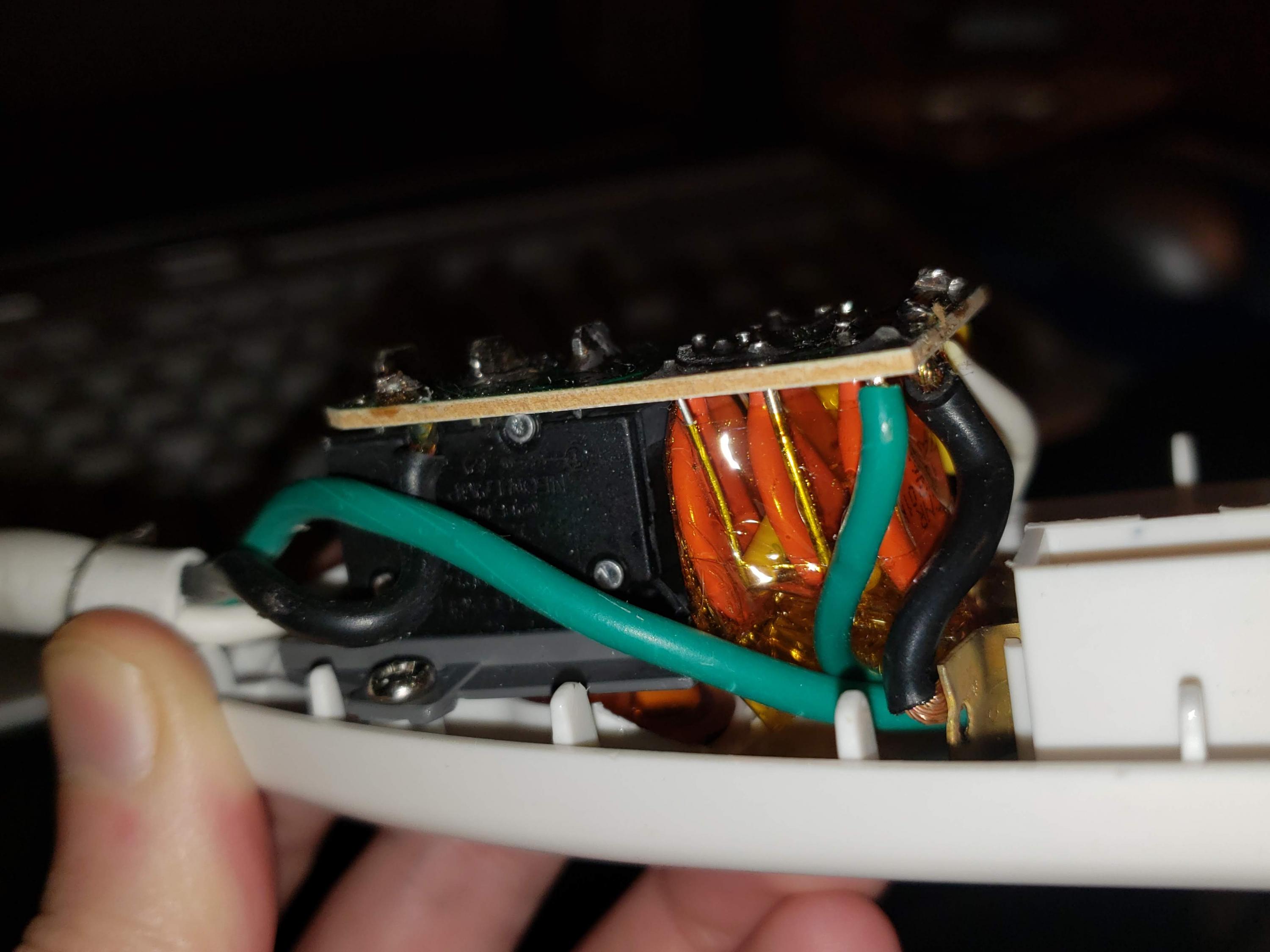

      So I just checked the two that I was suspicious about. One was made January 4, 2005 and the other was made April, 2008 and have had heavy usage. I just opened the 2005 one and I'm having a hard time deciphering all of the stats for it. It has three MOVs and they read: CNR 18D201K and have a resistor in between each.
      As far as I can tell, CNR is brand or the series, 18D is the diameter, 201 is AC voltage, and K is tolerance? If so, I cannot find a suitable replacement on Digi-Key.
      Here is a picture. Definitely need to do some resoldering!

        those resistors probably arent.
        bad mov's get hot or short out so a lot of protectors include fuses or thermal fuses

          Nothing looks popped or hot here. Are you saying that they're most likely still good?
            • 31286
            Re: Replacing MOVs in surge protectors?
            no idea - meter them.
            is that capton btw or some type of glue?

              I like the TMOV series from Littlefuse, they have a built in fuse so they don't burn your house down by default when they are overloaded!
              And there is also a version of it with a third lead for telling if the internal fuse has gone or not, perfect to connect to a LED on a surge protector so you know if it works or not.

                OP's strip has thermal fuses and Kapton tape, MOV's look to be CNR18D201K rated 130VAC max. operating and 200VDC 1mA (185-225V). There is coverage if they cook and burn.
