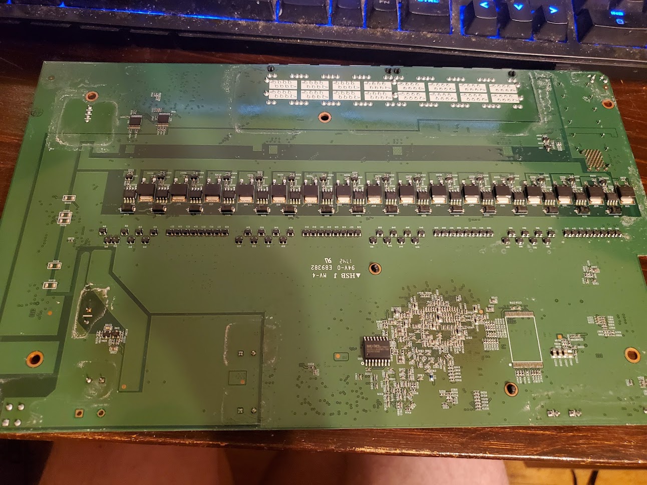

    Got this dead Unifi US-16-150W, assuming it was the power supply. Alas the PSU and everything looks perfect and the PSU is outputting a solid 53V.
    I noticed that upon disconnecting then reconnecting the 4-pin connector from the PSU to the switch's mainboard it makes quite a spark. More than I would expect. So I got curious, took the mainboard out, and found the bottom to be like this.
    Is this water damage? Or something else? Should I try to clean it off? Or is it toast?

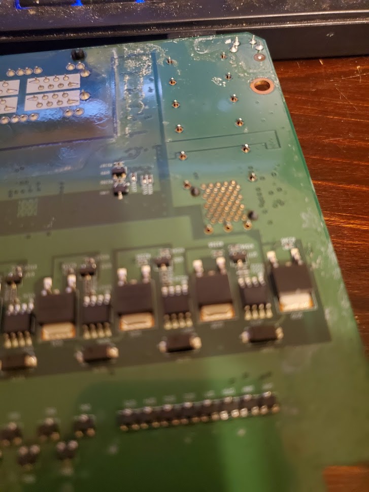

    Re: Liquid damage or somethign else?
    Try cleaning up with denatured alcohol and see if you can clean or use a good flux remover spray I have clean a few boards with a flux remover spray
    https://www.mpja.com/Flux-Remover-41...info/30364+MG/
    It might be water stains but I not completely sure about this
      • 31281
      thats residue from water soluable flux,
      the factory isnt changing the water often enough.
        Gotcha, thanks, do you think there is any point in cleaning it? Or is something else wrong with it?

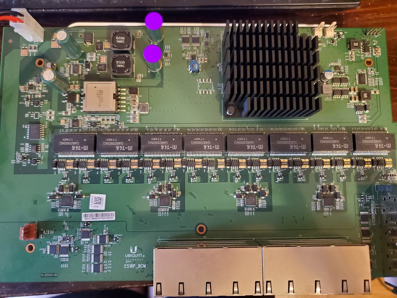

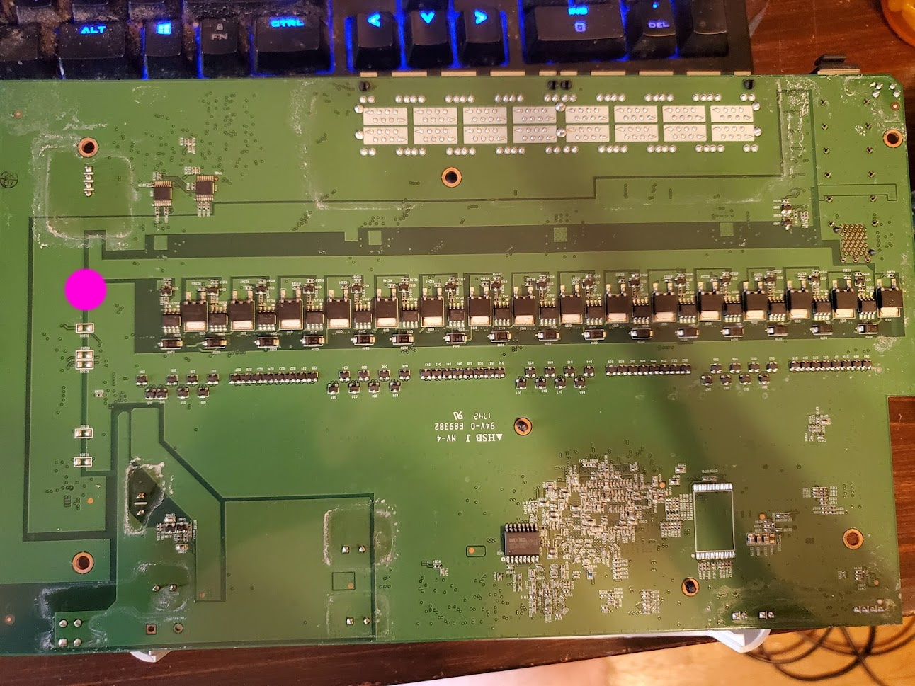

          Alright, so I did a little testing.
          I've attached a couple pictures. I have a solid 24V across the purple caps. This is probably the circuit for the 24V Passive PoE function.
          More important, in the other pic across the two points right below the pink dot I have fluctuating 0 to 3.3V. I'm assuming this is a/the problem.
          What can I check to see why the 3.3V is fluctuating like that?

            Re: Ubiquiti US-16-150 Help
            Most likely something is shorted and the power supply is hiccuping: that is it senses the short, powers down and then tries again...
            Some times such a short can be found by a thermal camera (or hand) or you can use a very sensitive multimeter in ohms mode.
              Hmm, thing is the power supply is happily at 53.7V with absolutely no fluctuating the entire time.
                I mean on the secondary side, the 3.3v power supply.
                  Probably there are no shorts on the 3.3V rail. I think there is something else that gets powered from the 3.3V rail that shorts out when powered up. Check the other buck converters. Power the 3.3V up with a bench power supply and see what happens...
                    Hmm, OK, I'll have to rig something up.

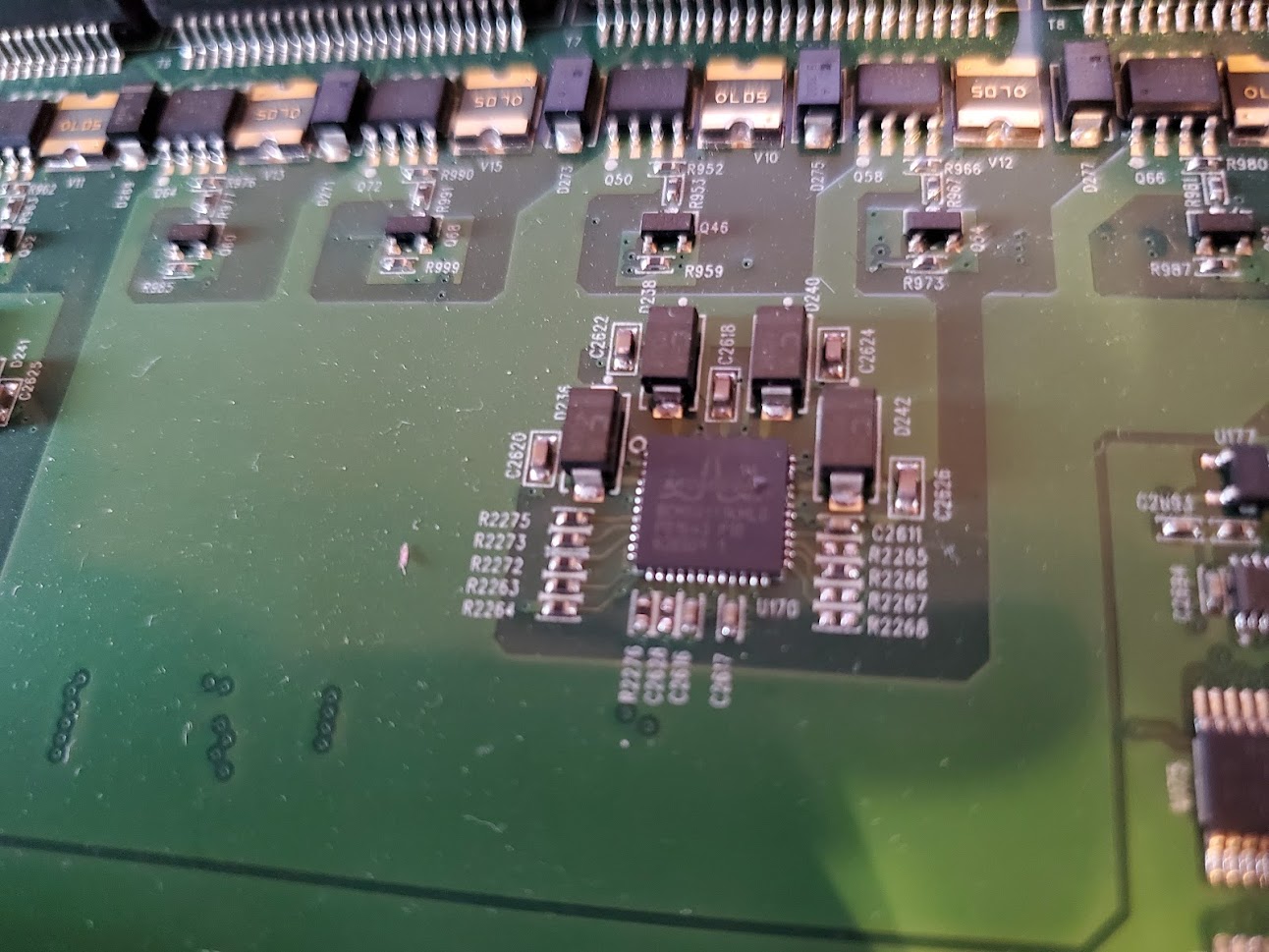

                    In the meantime, I found this bubble on one of the BCM59111KMLG chips. It's supposedly a 60W PoE controller. Is this normal? Or bubbles=bad?
                      That chip is the problem I’d say.
                          It's dead Jim. That's a burn mark alright. Look also at the discoloration on the PCB around it.
                          Speaking of removal, depending on the power of your hot air station, you may need to use some sort of preheater or hotplate, that chip is a QFN with a large heat dissipation pad underneath.
                            Shouldn’t be that hard to remove. You can always preheat the board, then take it off with hot air gun.
                              It's easy peasy if you preheat, just don't be surprised if a cheapo chinese SMD rework station alone won't cut it.
                                  so, i got my cheapo smd rework station and it worked perfectly to remove the chip.
                                  i was hoping i'd get at least some sign of life now that the chip is removed and presumably the short is too.
                                  unfortunately its still dead. what can i check now :'(
                                    • 31281
                                    check for shorted ceramic caps near the dead chip area.
                                      Check your wonky power rail. See what it does now?
