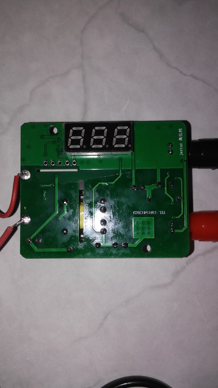

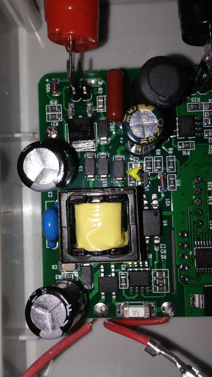

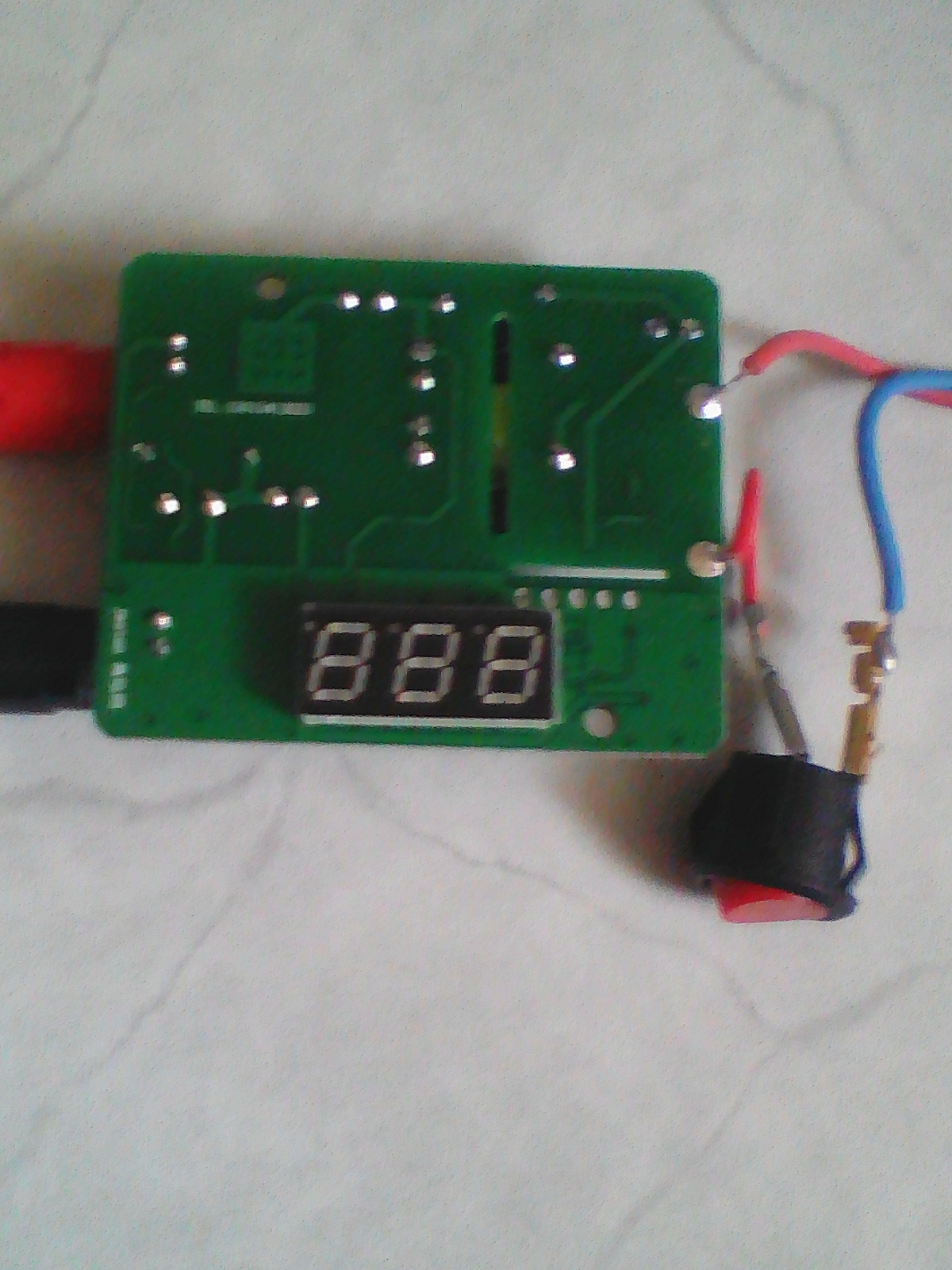

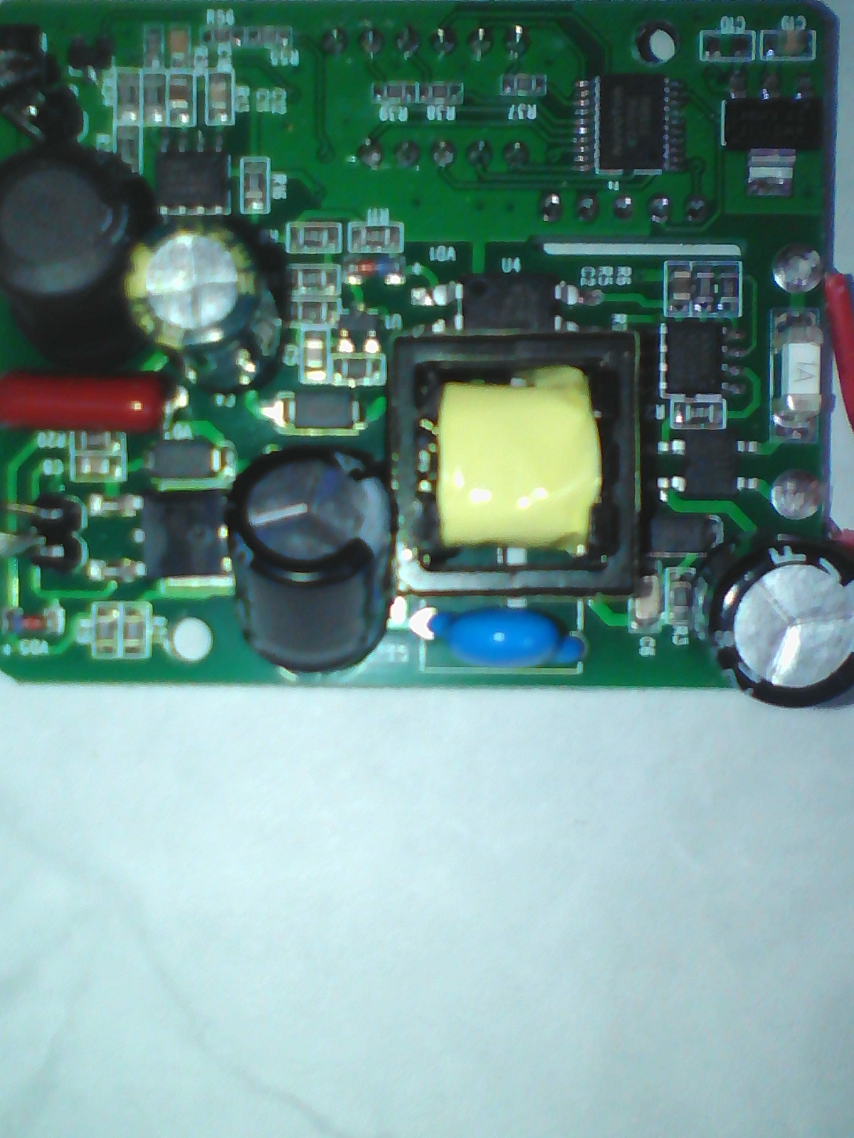

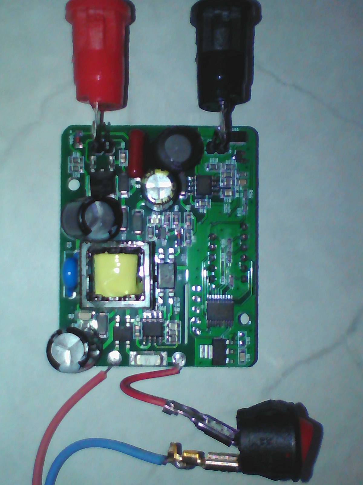

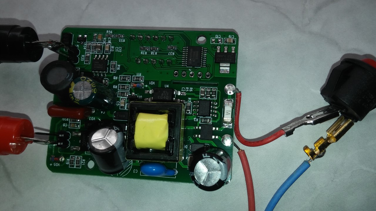

                    • stinger
                      • Jan 2014
                      • 57
                      • usa
                      Re: backlight tester malfunction
                      I'm sorry, Due to family med emergency I have been unable to get back here. To confirm, when I received the tester it would power up to 300v with test leads open and adjust accordingly when load was applied. Now it powers up to 17-20v max when turned on with no load at test probes. I took pics of circuit board and will post them.
                      • stinger
                        • Jan 2014
                        • 57
                        • usa
                        Pictures are not too clear.
                        • stinger
                          • Jan 2014
                          • 57
                          • usa
                          Hope these are clearer
                            I would check the mosfet? near the red output plug, then check the diodes in that area. Also check for any poor solder connections.
                            If you only had the tester for a short time, contact the supplier and tell them, maybe they will replace it for you.
                            • stinger
                              • Jan 2014
                              • 57
                              • usa
                              The mosfet seems to be bad(open) and one diode seems shorted, but I will unsolder it and check out of circuit. I will order and replace those parts. Thank you. The supplier wasn't too cooperative even though the tester is only about a month old and only used twice.
                              • R_J
                                • Jun 2012
                                • 9579
                                If the diode checks shorted, It could be all that is wrong, the mosfet might be ok. Can you show which diode is shorted?
                                • stinger
                                  • Jan 2014
                                  • 57
                                  • usa
                                  It is the one with yellow arrow pointing to it, next to D3. There is no value marked on it.
                                  • R_J
                                    • Jun 2012
                                    • 9579
                                    I can see that there IS a marking on that component, but I can't make it out in your picture, Could be a 1 amp schottky diode OR something else, What is the board designation? You can clean the top of the component with alcohol to see the number better.
                                    • stinger
                                      • Jan 2014
                                      • 57
                                      • usa
                                      I looked closer with loupes and see it says US1M. All 4 in that area are the same.
                                      • R_J
                                        • Jun 2012
                                        • 9579
                                        1.0A 1000v SURFACE MOUNT ULTRA-FAST RECTIFIER
