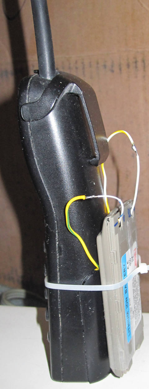

                              hmm... have a very similar problem here too. Have a cordless phone I'm still using and its NiCd cell is dead. I was running on a single 26650 cell (since it was the only one that I had prot on) and it worked fine until I needed to charge it...
                              Looking at my old cell phone batteries I may end up re-purpose a cell that has protection, though dealing with charging will be another issue. Probably will just charge it with an external li-ion charger...

                                How do you deal with the incompatible battery size? Duct tape?

                                  #36
                                  Re: Swapping out a NiMh for a LiPo?
                                  Paper clips, shoe string, and of course, duct tape!
                                  (though a 3d printer might be involved...)

                                    #37
                                    And let's not forget the zip ties! This looks a bit more hilarious than I thought it would before I put it together:
                                    Hey you, (some person I hate), pick up my phone please?
                                    Oh yeah, it does work and it's just a straight wire, using the protection circuit of the pack. I've not figured out a solution yet to overcharging but for now I'm just going to make sure I take it off the charger when it's fully charged. I left the connections open so I can easily measure the voltage and add the overcharge prot circuit...technically a ~4V 3W zener would do the job.
                                        i wouldnt pick that up or use it in public if i were u. it looks more like a remotely triggered ied. the fbi will swoop in suddenly and kick ur ass. dont use it or flash it around if u have a paranoid neighbor!! lol!

                                          #40
                                          yet all of us ghetto modders know exactly what it is and why it looks the way it does
                                          I wonder what I can do to make it look a little less menacing, I suppose hiding as much of the wire as possible by itself would make it look more presentable - yet it does nothing if it really was a questionable item...
                                          BTW I charged it with the original charger meant for NiCd up to about 4V and stopped, it charged!
