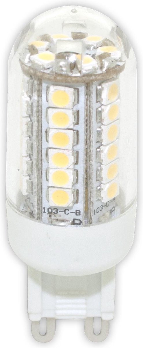

              Upload a photo of the bulb, so that we know what we're dealing with. Am I right thinking you're talking about G5-type bulbs (see attachment)?
              Before you start swapping caps, first check if all LED's are OK. Only 1 burnt LED will prevent the entire bulb from working.
              A few years ago I had 2 G5 LED bulbs die on me within two weeks. My bulbs each had 36 LED's, one bulb contained 2 (plainly visible) burnt LED's, the other had 1 burnt LED. I replaced the burnt ones with LED's ordered on AliExpress, both bulbs have worked without a problem ever since. It was a bit tricky getting the LED's (de)soldered, but it turned out OK.
              Do make sure you replace the LED's with matching ones (V, mA, color temp, casing dimensions).

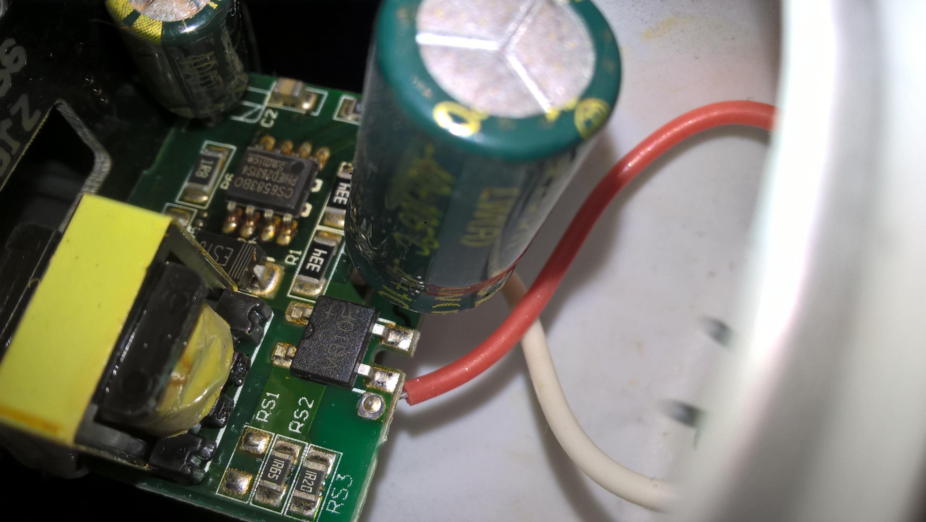

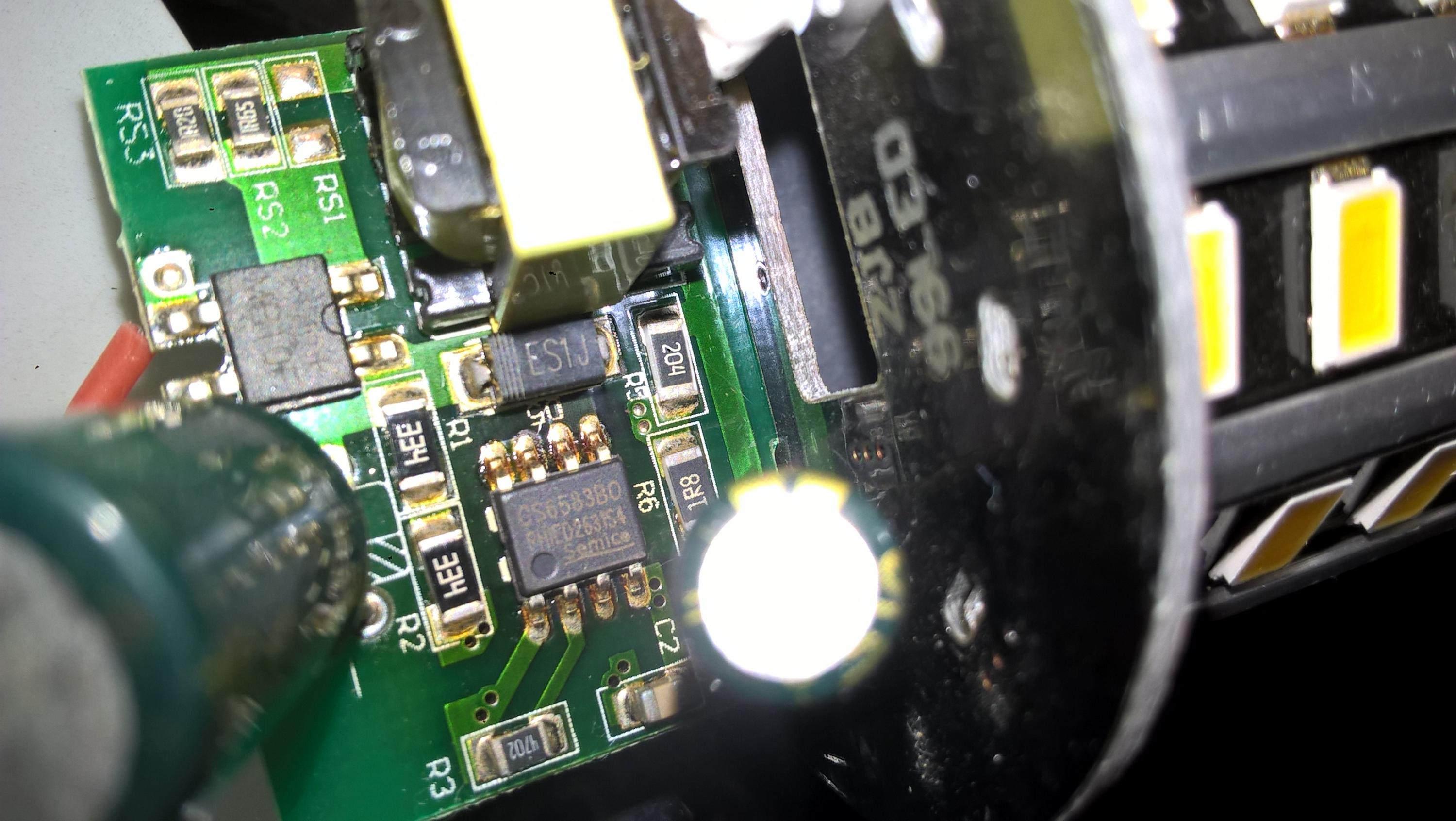

                      I have attached pictures of a PCB with both capacitors unbent for more clarity.
                      So, which caps should I try ?
                      And by the way, should I replace both of them ?
                      The big one is 15uF/400V,
                      The small one is 2.2uF/400V)
                      Thanks again !

                        a real psu - nice!
                        so the caps need to be low impedence type
                        the output one does anyway - but i cant tell which that is from the pictures.
