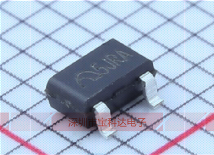

    got a sot23 marked "5JRA".
    i think it's a regulator - anybody know it?

      Re: component help marked "5JRA"
      no, the device is temporarily re-assembled.
      it's just a 3pin sot-23 package with power going in, ground and power coming out.
      i just dont know the voltage or the current limit.

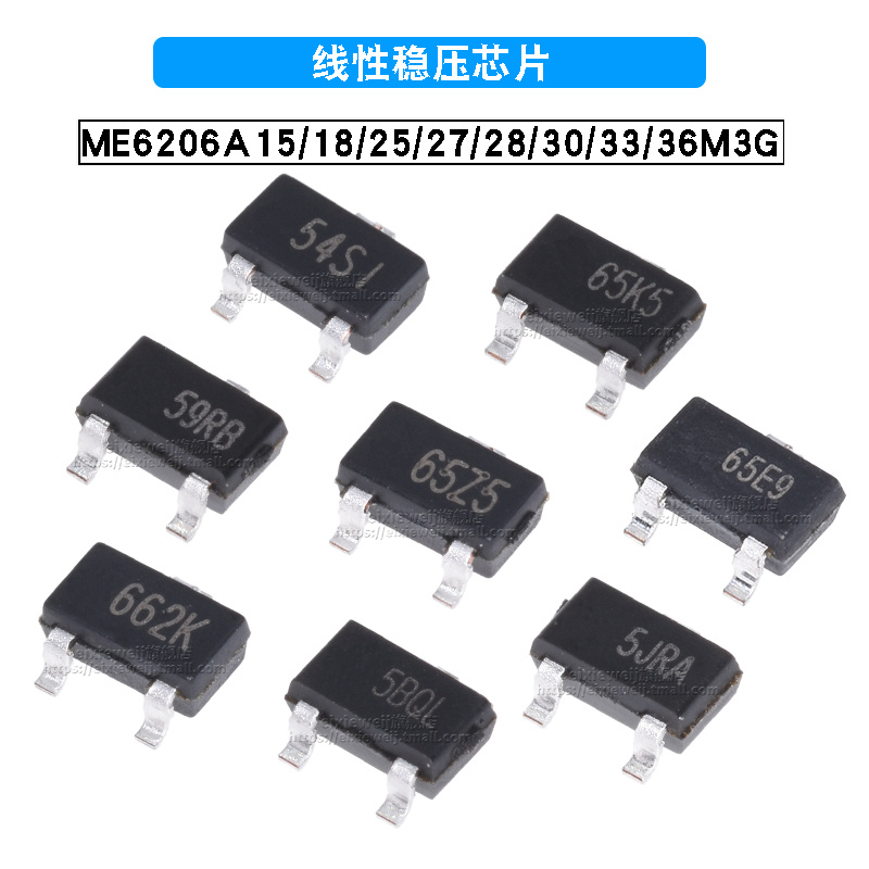

        R3131N45EA is the best i can find. http://chip.tomsk.ru/chip/chipdoc.ns...4501&count=500 https://datasheetspdf.com/pdf/122838...H/R3131N45EA/1
          is this it? ME6206A27M3G

                • 30977
                just the code in bold - no room for any logo on a sot23
                i may be able to get another later and just meter it - it's in a high-end flashlight between the battery and mcu.

                    • 30977
                    doesnt matter now,
                    i know the important bit - output is 2v7
                        Here are some without the logo
                        Looks like some of the markings are:
                        1.5V = 65E9
                        1.8V = 65K5
                        3.0V = 65Z5
                        3.3V = 662K
                        This datasheet for the XC6202 series has a voltage chart that might help
