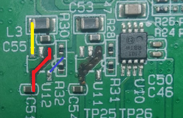

    I’m trying to repair a Lucky Miner LV06 Bitcoin miner that was given to me.
    It looks like someone plugged 12 V into the 5 V rail and fried the three small adjustable regulators.

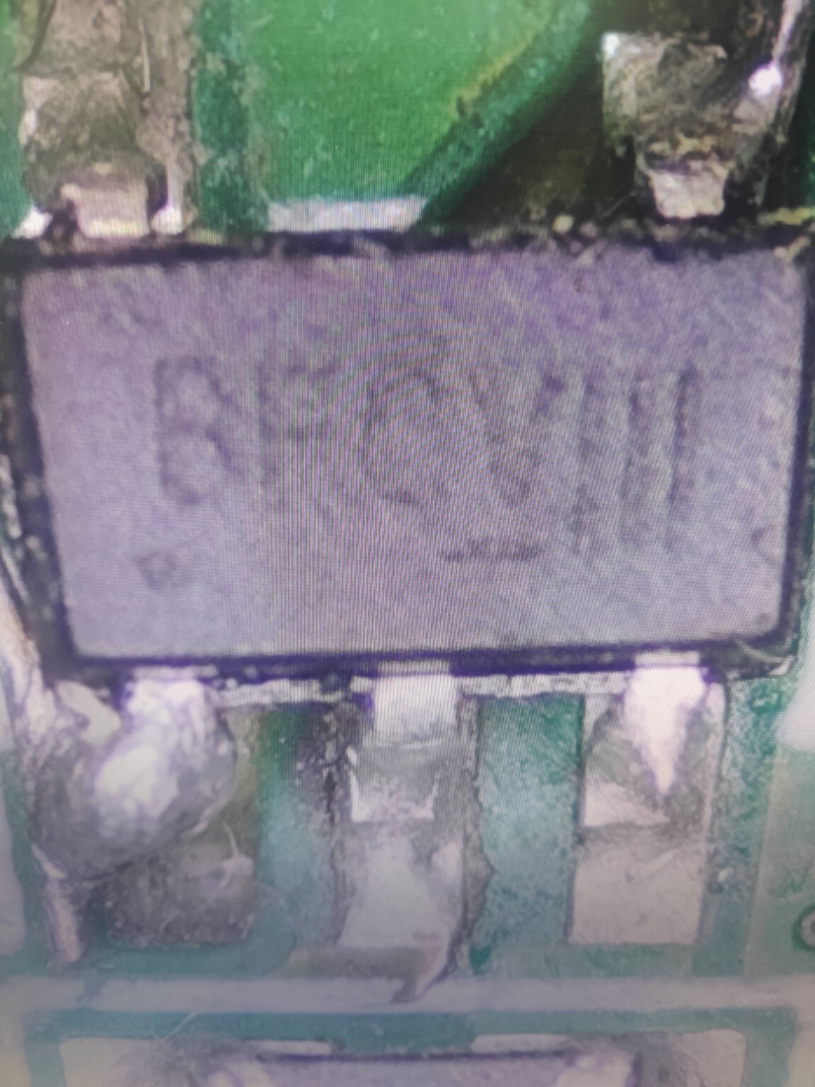

    Each regulator is a SOT-23-5 package, all marked “BFCV.” I can’t find any datasheet or reference to that code. The regulators appear to generate 3.3 V (for ESP32), 1.8 V, and ~0.8 V (for the BM1366 ASICs), set by resistor dividers?.
    From tracing the PCB:
    Pin 1 (red) → 5 V in
    Pin 2 > GND
    Pin 3 (yellow) > output
    Pin 4 (purple) > resistor divider midpoint
    Pin 5 → enable? connected to 5V
    I cant find anything with a pin out like that would anyone have an idea? googling about i think something like "SY8009A" might work but i'm not 100% sure any help would be appreciated.

    http://www.icmkw.com/file-download-1006679-left.html
    BFyw = ETA3496 / ETA3496S2F, etasolution, 1.2A, 1.2MHz Synchronous Buck Converter with 7.2V OVP
    https://www.lcsc.com/product-detail/C7465505.html
    https://www.lcsc.com/datasheet/C7465505.pdf
    assets.lcsc.com/images/lcsc/900x900/20230828_etasolution-ETA3496S2F_C7465505_front.jpg
