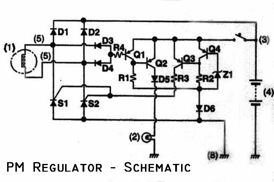

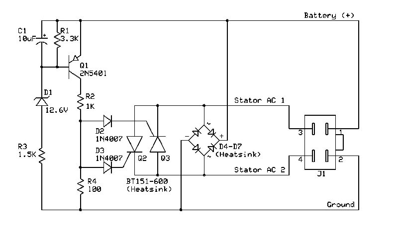

            If the magneto is generating 9V, the zener clamps to 6V, wasting the excess as heat. Do you have a battery? It would boil and lose water.
            You don't want to use a zener because it shunts excess voltage and just loads the motor down, as well as getting hot.
            There are 6V magneto voltage regulators you can buy or make. The Kubota circuit is better than the other popular circuit - that shorts out the magneto. Then people wonder why the coils are burnt.
            I would mod the Kubota regulator for 6V. The circuit is from the 1970's though.
            edit: the large voltage drop of the bridge rectifier and SCR's (~2V) might cause the lights to be way dimmer at idle or low speeds. Might have to use Schottky diodes and something better than two SCR's.

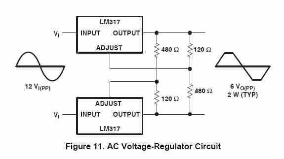

                  Any (series) regulator will lose some voltage (or dropout), so dimmer lighting at idle or low speeds.
                  Any (parallel) shunt regulator wastes the extra voltage as heat, with the motor loaded down more and it just wastes energy.
                  You need an AC LDO, connected like this dual LM317 circuit I remember. I'd guess it loses almost 3V though. LT1084 would work but a real LDO (pair) would only lose maybe 0.3V if you picked out a good IC.
                  This dual Darlington accomplished about the same thing, if you mod it for 6V output.
                  Not sure how many watts OP's lighting load is.

                          Thanks for the schematics redwire, I will have deeper look

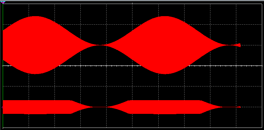

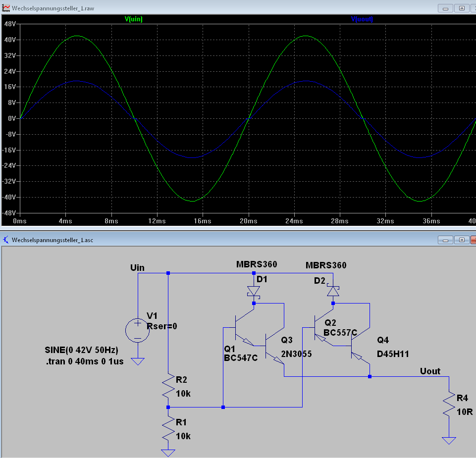

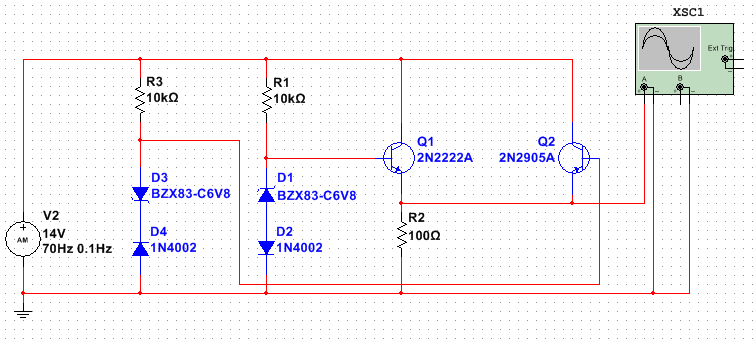

                                After a few weeks of involvement on other tasks, I tried designing my own AC limiter.
                                Top wave form shows an amplitude modulated sine wave which is representative of the variable output AC voltage from the magneto. The signal changes from 0 to almost 50V peak to peak. The output signal (bottom) never goes above ON Zener + ON diode voltage (6,8V+0,7V). The zener and diodes maintain the voltage on the base so that when the voltage on emitter goes above the limit the transistor starts acting as a resistor which forms a voltage divider with R2 (=the lamps)
                                This is only a "working principle" schematics as enough powerfull transistors will have to be selected, to dissipate the extra power.
                                This has the advantage of only doubling the dissipated power each time input voltage doubles.

                                  Thanks for following up, it looks like you got a solution that may well work (no guarantees, simulation doesn't always equal real life!). Go for it, though I still prefer LED retrofits
                                  You still will need to deal with dropout voltage, though I don't know what your typical voltage is (which depends on RPM of course and that changes...) and couple that with your minimum required brightness.
                                  The only thing I'm a bit concerned about is the reverse breakdown and long term reliability. But that's another issue...
