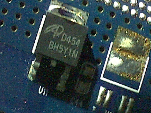

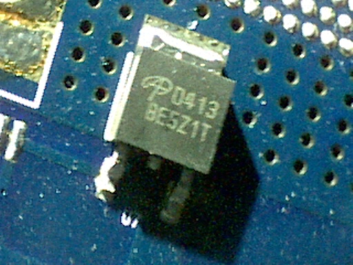

    Akai Inverter transistor ID
    LCD tv Mod# LCT3285TA

    Ok so i still can't post pics so # on them are D413, D454

            Re: Akai Inverter transistor ID
            That logo is Alpha and Omega semiconductors
            I think you have http://www.aosmd.com/web/products/pr...tnumber=AOD454
            and http://www.aosmd.com/web/products/pr...tnumber=AOD413
