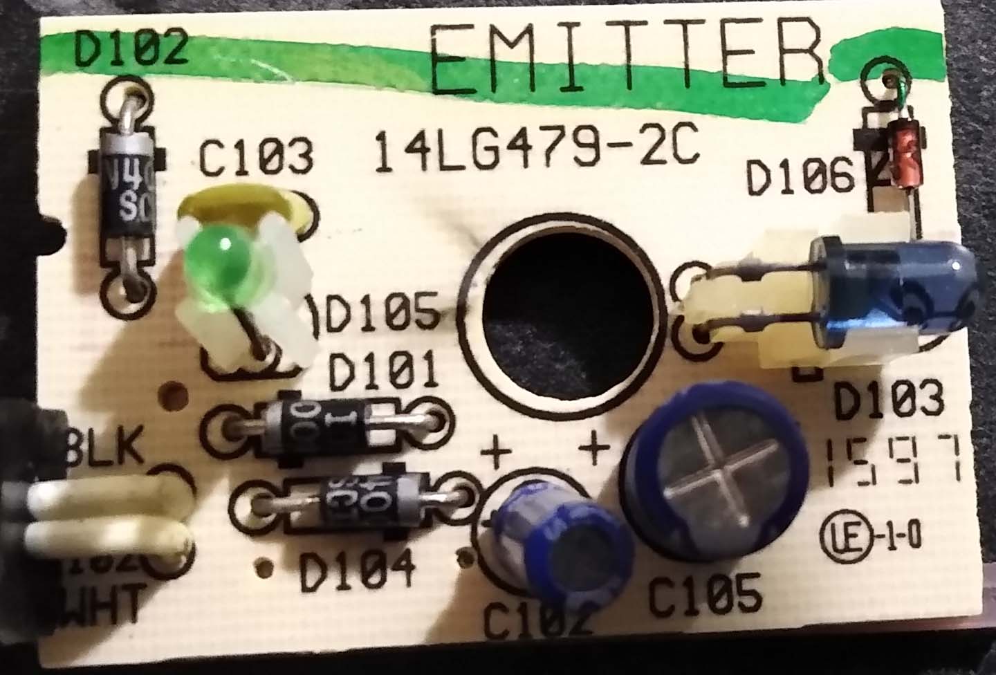

                        I've got the same emitter board 14LG479-2C that is not working. I believe LM2903 is my problem but I found something odd when checking the components on the board. The indicator led, D105 reads 15 ohms and is not lighting. Does anyone know what to replace that with? That is of course not what is causing my IR pulse problem but it does seem odd that this should be bad. Again though--the damage is due to lightning. You can see a slight scorch mark on the board near where the bolt would pass through the board to mount the sensor to the door rail.

                            One is the red power on led, the other transmitter infra-red LED is a vanilla 5mm part, around 940-950nm and narrow angle. Like Kingbright WP7113F3BT, or Wurth 15400594F3590.
                            If you post pics of both sides of the board I can add more info.
                            If you get low resistance it could be a shorted diode or the LED is shorted.
                            You can see the IR led light while looking at it with your cell phone camera, it's dim but tells you if it's emitting some.
                            I would look at replacing a few semiconductors on the board it you have the patience and the opener circuit is not toast. Does the manual switch for lights work? It shouldn't door close without a good sensor signal, for safety purposes.
                            Lightning strikes seem to come in mains power (to the opener) and then arc over to the nearest ground, like the garage door door rails. So it jumps from the sensors to the rail and can damage either or both ends.
                            Some garage door openers have MOV kits to add protection, if you live where it's a common occurance. That is a couple of MOV's like MOV-20D271K, each from line-neutral and line-ground at the opener.

                              Not that the color matters but this is an older style 1995 sensor and the power indicator led on both the emitter and receiver were both green. I have already determined the emitter board is the only problem by installing a replacement board. The receiver and logic boards are fine. I'm just trying to see if I can repair the old emitter board. The power led reads 15 ohms across it. I can supply power to the board and the ir led will light up but since the receiver does not recognize it I am assuming the comparator ic has failed. I could be wrong and it could also need to be replaced. I can probably come up with a replacement diode for the power indicator that would work since we know the voltage and current limiting resistors value but I had hoped someone would have known the best replacement or original specs for the power indicator led. I've had many of these sensors fail due to lighting over the years and also had the logic board damaged. I have been able to repair the original logic bd several times over the years but the last time it was hit the damage was too severe and I had to replace it. I have used a surge protector in the past which has not protected anything from being damaged. Last year I installed the Chamberlain surge protector they used to sell that may have some protection at the sensor lines in addition to the power for the logic board. In any case the surge protector did not trip this time but the safety sensor still did get popped.

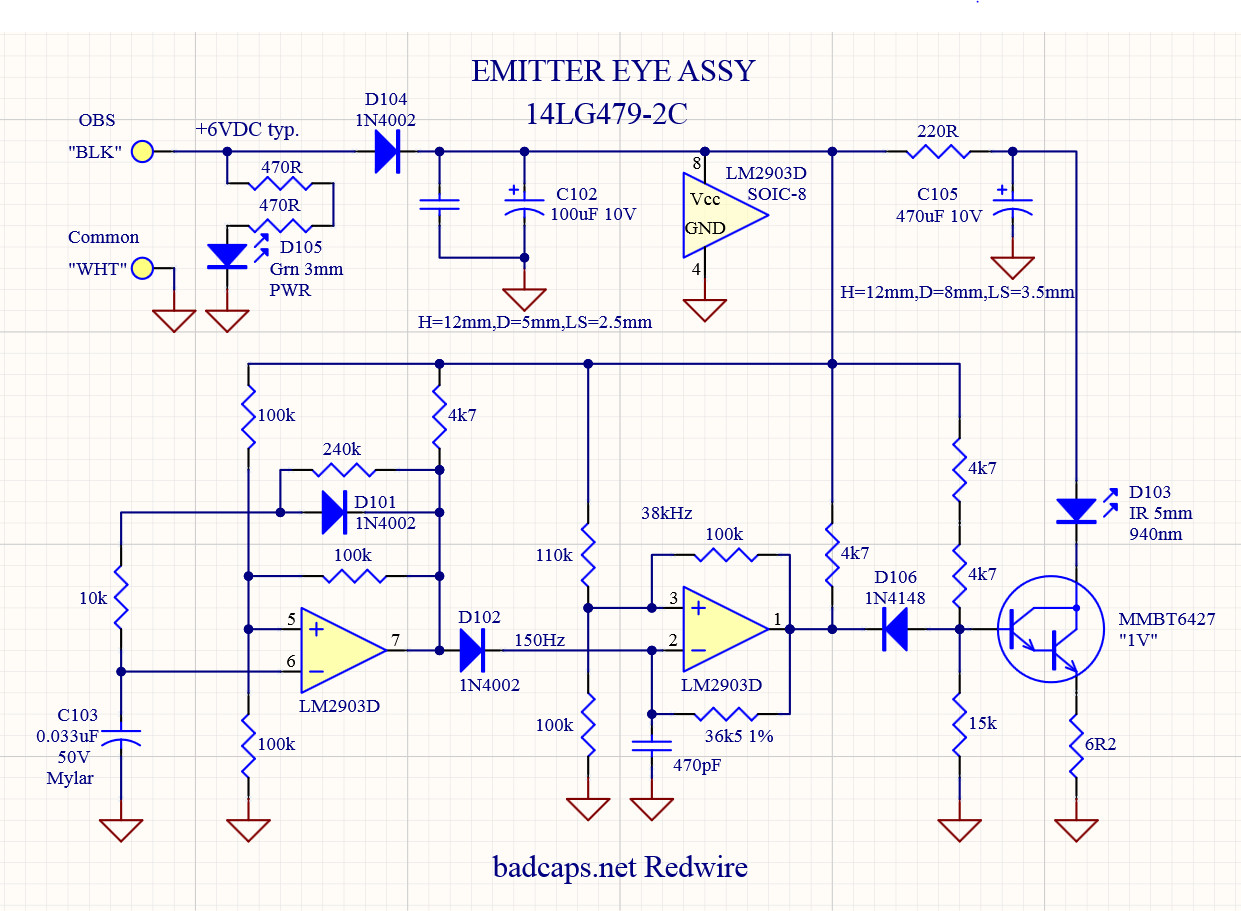

                                  I'm able to draw this schematic for the 14LG479 Emitter board. Please review for mistakes.
                                  They deleted the surge zener diode that was present on early models
                                  The Power On LED is any vanilla 3mm (T-1) size green that you can find lying around, or off eBay or Ali as penny parts. Sorry I thought it was the IR emitter LED you were after.
                                  Note the board marking "BLK" is +ve voltage, (I think the wire colour is reversed, Blk strip goes to WHT?) it used to run off 6VDC as a current-loop supplied by the opener, giving 5.3V for the entire circuit after the reverse polarity diode D104.
                                  The circuit has two oscillators, one for 150Hz and the other gated 38kHz.
                                  I'd get a new IC and LED and try that, check the IR LED is not shorted as well, it should be OK.

                                    LM2903D sub ok for the original LM2903M? Yes the IR LED is not shorted. I'm hoping just the power led and the IC will do for this board. Thanks.

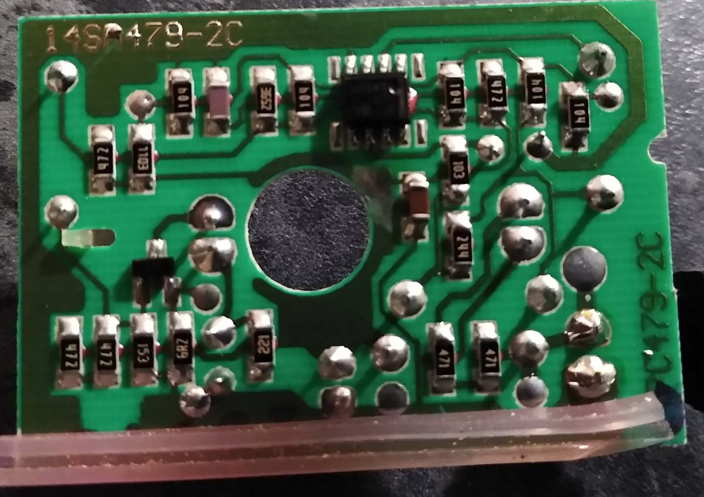

                                      What number is on the old part? From the pic, your IC is in a SOIC-8 package.
                                      TI LM2903DR or LM2903-Q1 (automotive rated).
                                      On-Semi LM2903EDR2G, the LM2903M is obsolete
                                      ST LM2903DT or LM2903W (has extra protection diodes) or LM2903YDT, LM2903D seems expensive obsolete.
                                      Diodes Inc. LM2903S or LM2903QS (automotive rated)
                                      This part has been around for many decades since the early 1970's so there are a zillion different ones today.
                                      I would get a LM2903DR as a replacement.

                                        The original was LM2903M. I already ordered some LM2903D ic's and the led from eBay. I think any of them will work that are 903 based although the LM2903DR would have been a better choice. I'll let you know how it goes.
