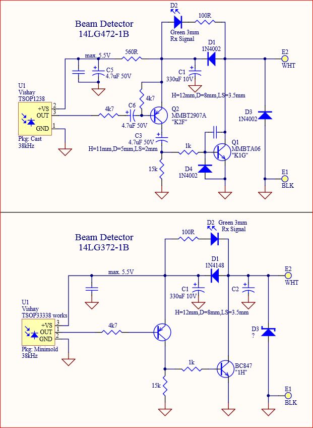

          Originally posted by redwire
          Here is my schematic for older very similar 14LG472, yours is 14LG479. Same basic circuit as the other. The diode is not a zener but is a 1N4002 in series with power to the board.
          Very hard to kill a 1N4002 there, it must have been a -ve spike that hopefully found no path to arc.
          Redwire, Do you also have the Receiver schematic? I think yours is closer to my circuit. I'd like to compare if you do have it. Thanks!

            Re: Help identify a Zener?
            14LG472 - I have that schematic.
            14LG382 - the schematic you posted but uses lots of parts.
            14LG372 - your receiver, I drew a schematic but think you need a zener for D3. Let me know if you get the part numbers for that stuff I can make corrections.
              Red, I will get the value for D3 but I think is a normal diode. I scoped the emitter board LM2903 and there are no pulses on pin 1 or pin 7 . so i will replace that next.

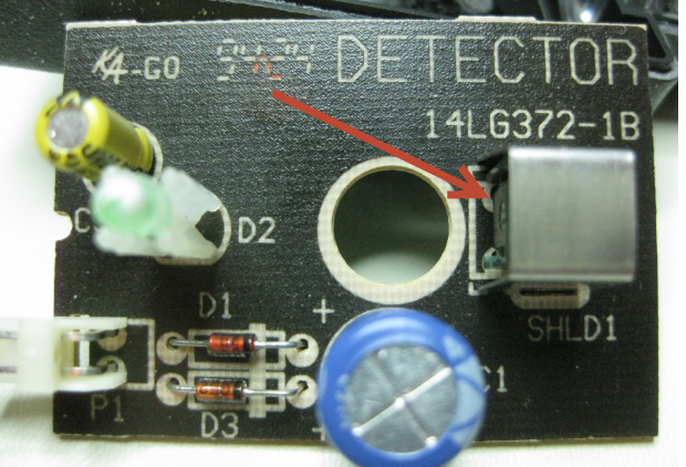

                D1 and D3 are marked LT 1N4002
                  In these 14LG372 receiver pictures, I see the two glass diodes the same look and part number as the transmitter 052 critter you have. I think 1N4002 is what I've seen everywhere else. As long as the IR module does not get more than 5.5V (6.2V power) which would kill it.
                  The 14LG472 seems to impose the receiver's pulses on the bus, while the 14LG372 looks a strange design having a big capacitor across it.
                  I think the garage door opener outputs a low current-loop at around 6V max. so the MCU can see the pulses from the receiver yet power the IR transmitter.
                  One manufacturer has the patent for everything on the two-wire bus, so transmitter, receiver, pushbutton door/lights - all in parallel.

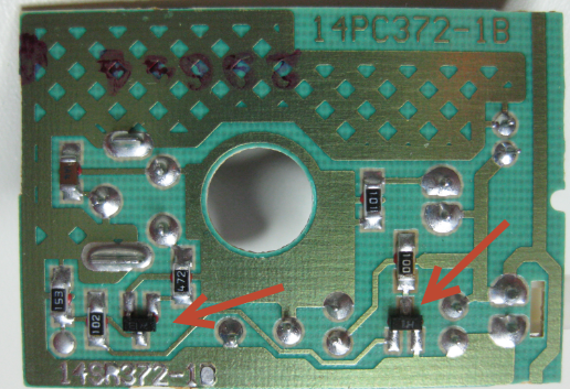

                            I found a trace break on the input to the PNP device. The demodulation makes sense, I am seeing a constant of the 150Hz - when I shine the emitter inthe receiver it does not change but maybe the PNP is demodulating ? Once I repair the trace and retest I will know.
                              I repaired a bad trace and now the receiver is working on the bench. I can see on the scope when I shine the emitter on and off that the puses drop or return with the IR led shining. The indicator LED does not light at all. When I test with my Fluke it does light up. I guess maybe the NPN transistor is defective. Thanks for all your help on the schematic and input! FYI - Of the 2 schematics you posted last the TOP one in the pair is the right one. the bottom image had a possible zener and the unmarked PNP device.

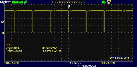

                                    here is the waveform from the output of the IR Receiver, PIN 3 OUT. I still have to hook to the actual logic board with the motor and test, but its looking decent. The LED on the logic board when not connected flashes 4 times vs no flashing at all. I might be close to closing this one down. Will report back by tomorrow for sure. BTW for those that may need an LED the datasheet says 950nm is the IR wavelength. I did not have to replace the LED but thought someone might liket to know.
                                      The waveform looks good, ~160Hz pulses.
