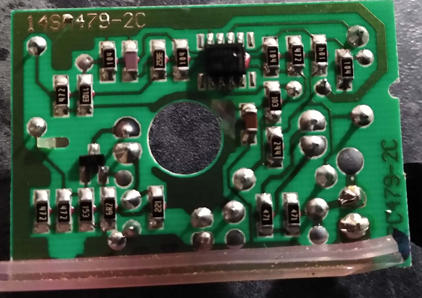

The LM2903D and the power led were all that I needed. Everything works. I will set aside the sensor kit that I purchased and use it if the next lightning strike does more damage than can easily be repaired.Comment

you got the sensor emitter fixed

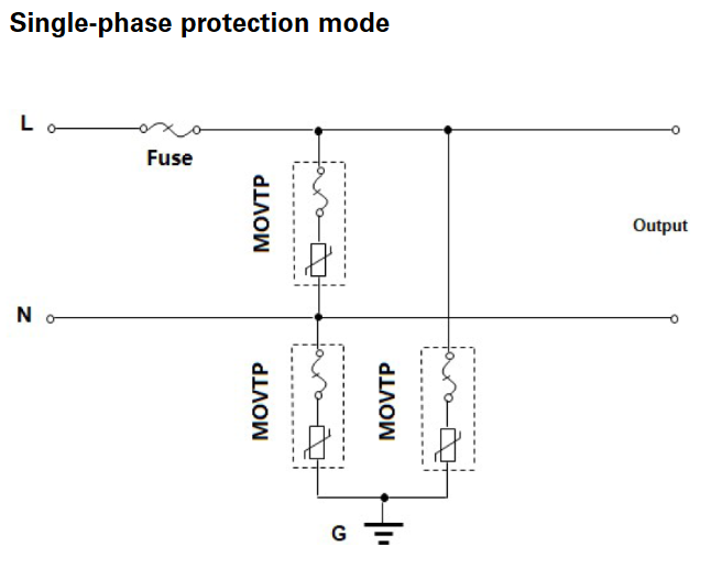

Liftmaster 41A5530 are add-on kits with two MOV's (Line-GND, Neutral-GND) seems to have no Line-Neutral MOV, similar to Wayne Dalton 252994 it is just a couple 150VAC 20mm MOV's. These connect to the control board terminal strips.
I'd suggest buying a decent mains surge protector to plug the opener into, or adding two or three (L-N, L-G, N-G) 20mm MOV's 150-175VAC rated, with built-in thermal fuse, someplace safe.
Littelfuse TMOV's which have a thermal fuse inside for added safety, same as:
Bussmann MOVTP MOVTP20V150N
Epcos/TDK ThermoFuse T20K150 or T20K175.

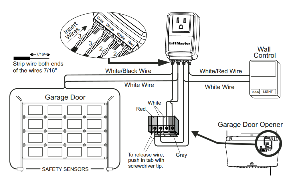

The 990LM also protects the sensors and switches against lightning, I would expect 4 MOV's or TVS to protect there, going to ground.
It kind of depends on how the lightning surge is getting into the house - through stikes to the powerlines (mains) , or ground strikes (ground).Comment

Inside I expect three MOV's for mains surges, and four other parts for the control lines. Maybe a small MOV or TVS diodes. Maybe a fuse for the green LED.

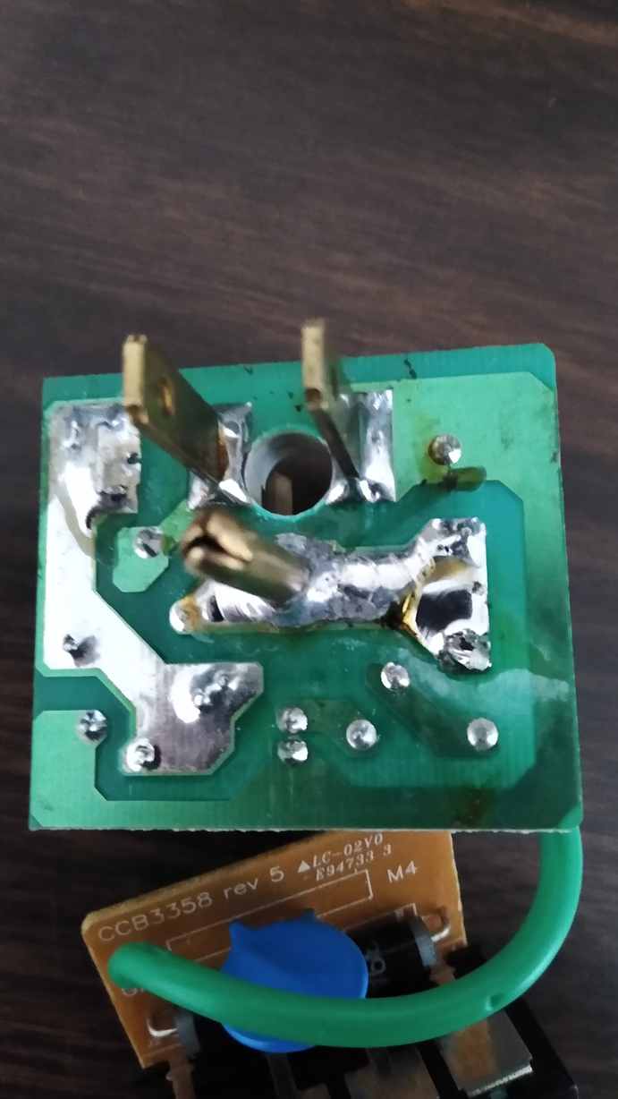

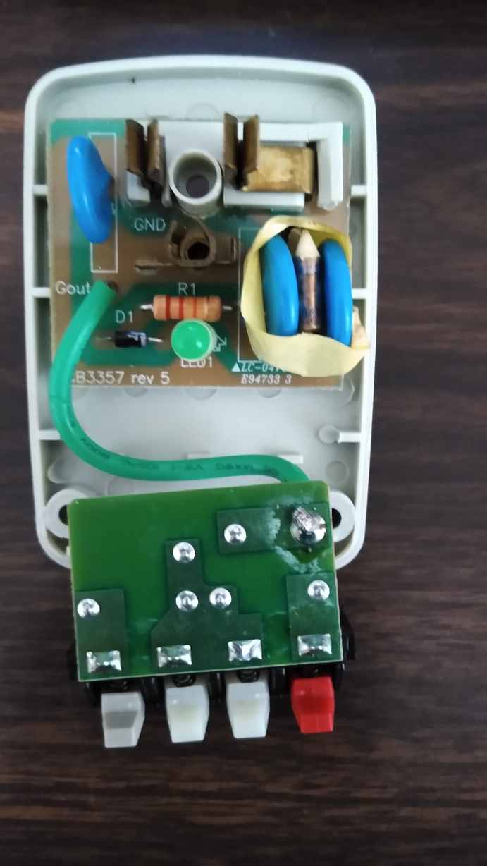

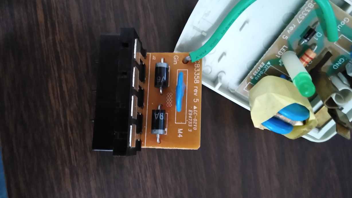

I took one apart that I just received--only three screws and comes apart easily. The 990LM does not use MOV's that have a built in fuse. The main board has mov's m1 and m2 as GNR20D431K and m3 is GNR14D431K. It does sandwich a thermal fuse between m1 and m2 and tape it all with what I suppose is a tape that will not go up in flames? The board that goes to the opener sensors and control uses a 14D201K. Since failure of that MOV would not result in the indicator led not lighting up I think I will take that one down and look at it to see if the MOV poofed when the safety sensor emitter board was damaged. After looking at the circuit I'm not all that sure that the thermal fuse is sufficient to keep it from being a fire hazard. That could be why it was discontinued.Take it apart, you know for the science

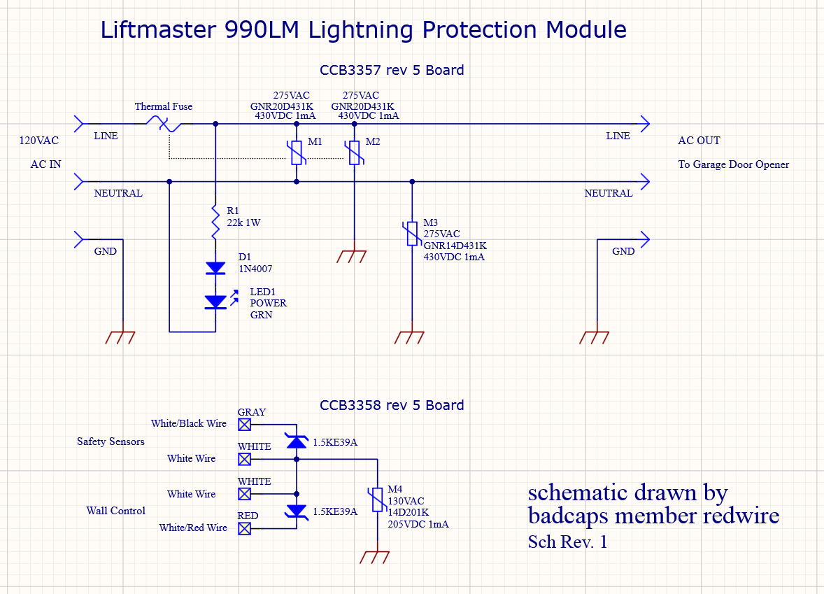

Thanks for the teardown pictures of Liftmaster 990LM.
I drew a schematic for the Liftmaster 990LM and think it's a decent design and would use it if I lived in an area with lots of lightning.
The non-flammable insulating tape around the MOV's helps their heat get to the thermal fuse and pop it if the MOV's heat up. This was the way in power strips too for many years. It might be the liability that made Liftmaster discontinue these? Or they just want to sell you a new opener.
I did not know you already have one of these modules with the green LED out. Not sure if the TCO fuse popped or the LED died. Take it apart, do an autopsy I guess. If the fuse went, it should not have any power to the opener.Comment

Thanks for the drawing. I scrawled pretty much the same thing out for myself already but yours looks much better. I didn't want to post the one I did because it looked amateurish. Perhaps I phrased it in a misleading way but I did not have a 990LM with green light go out. The one I have still indicated it was protecting the AC line. I was just referring to the fact that the emitter sensor board had obviously been damaged by lightning and after looking at the lightning suppressor circuit it appeared to me that the mov m4 could have been damaged in that strike and it would not have affected whether or not the green led on the module was still lit up or not. I did take it apart and verified that all of the mov's still appeared to be undamaged. Thanks for the drawing. I wasn't sure about the diodes off of M4 and it makes perfect sense that they would be zener diodes.I posted a reply today but it seems to have vanished so typing it in again from memory.

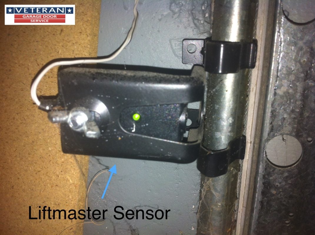

What I have seen happen is between the garage door opener and the door rails you get high voltage, it's high frequency too and an arc or zap happens between them. I think the sensor/wall switch wiring acts like an antenna or something and picks up the lightning. The potential difference is between the mains ground (outlet) and the door rails I think.

I believe it has to do with the rails and sensor wiring. Almost every time I have had damage to the sensors you can see a scorched area on the pc board that leads back to the screw which mounts the sensor board and sensor to the rail. You can see it in the picture I uploaded. I will check the electric panel ground but I don't think I'll find a problem there.If you are running one of the 990LM and lightning still took out the sensor, then I would also suspect the electrical panel ground for the home. If can be an old ground rod or plate that might be not working due to corrosion or bad wiring. Or the ground is too dry etc. Just something to inspect I guess.

I see the mounting bolt, which is electrically connected to the mounting bracket and door rail and concrete floor, goes through the center and ends up close to the PC board. I did see one that arced through the seam in the housing to the bracket.
Strange the PC board traces around the hole go to internals. On the 14LG372 model it's to the IR transmitter LED so that gets zapped. As if Liftmaster knows something how to cause failure lol...Comment

The part number for the bottom circuit diagram is this
1.5KE39A when try to copy and paste the part number it drops the 1. and only show the 5KE39A
Just posting this in case someone tries to copy and paste the part number to find the date sheetLast edited by sam_sam_sam; 07-02-2023, 06:38 AM.Comment

Not sure where the part number is not working? The 990LM schematic is just a picture. I could post a bill-of-materials if you are making one.
If I lived in Florida or Texas I would definitely have lightning protector on the garage door opener.Comment
