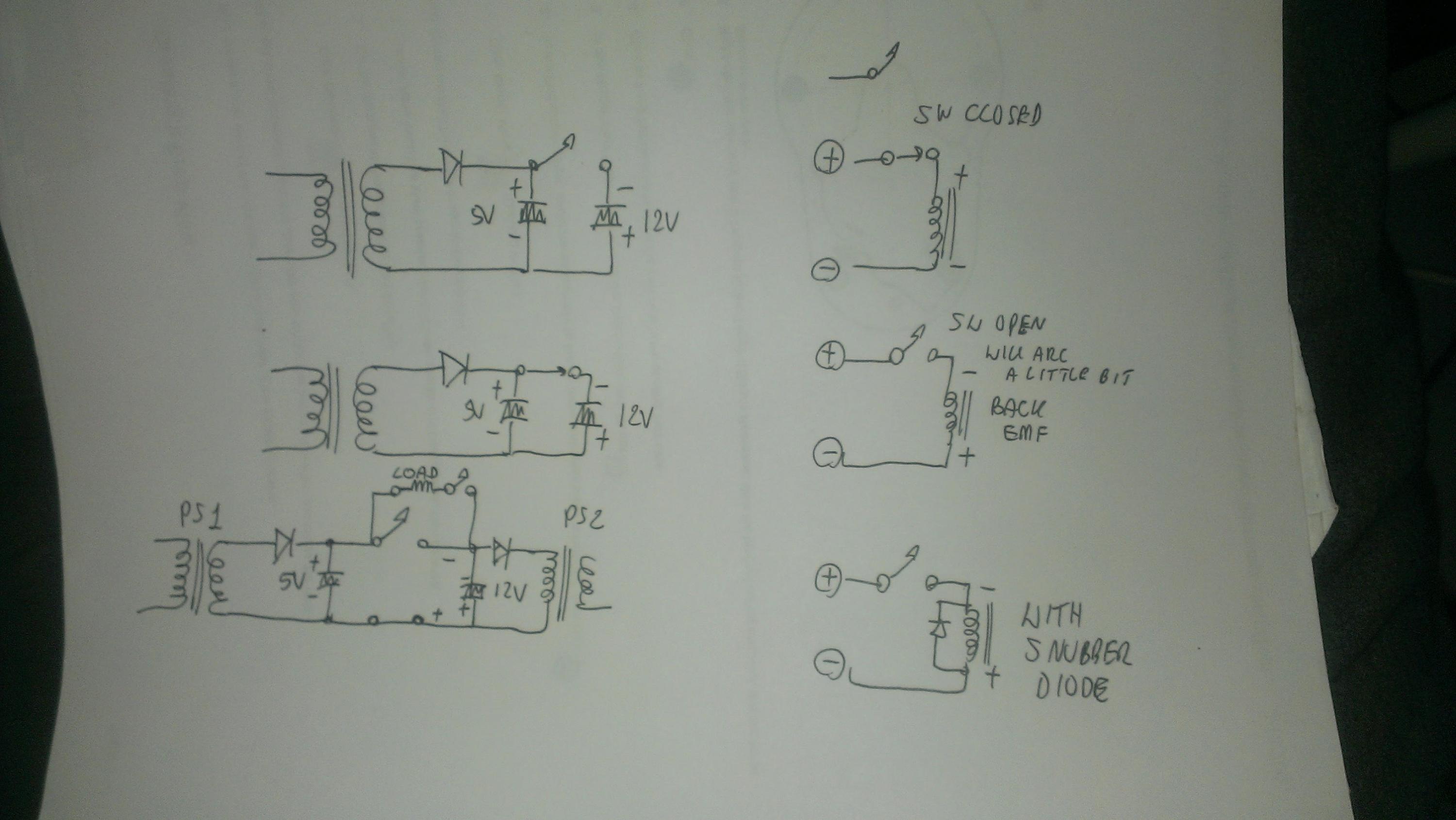

                                    Re: Power bricks in series?
                                    Here is something to look at, analyze, and think about.
                                    The top left shows hooking up cap that is charged to 12V to he 5V power supply.
                                      Hooking up power supply in series do and don't.
                                        The power supply shown is only capable of operating in the first quadrant.
                                        Imagine taking a BATTERY (pick a variety of voltages) and connecting it across the output (i.e., a cap eventually loses its charge into its load; a battery takes considerably longer -- practically forever, in terms of signal response -- to do so, given it's low output impedance!)
                                        Replace switch with a real load. Repeat.
