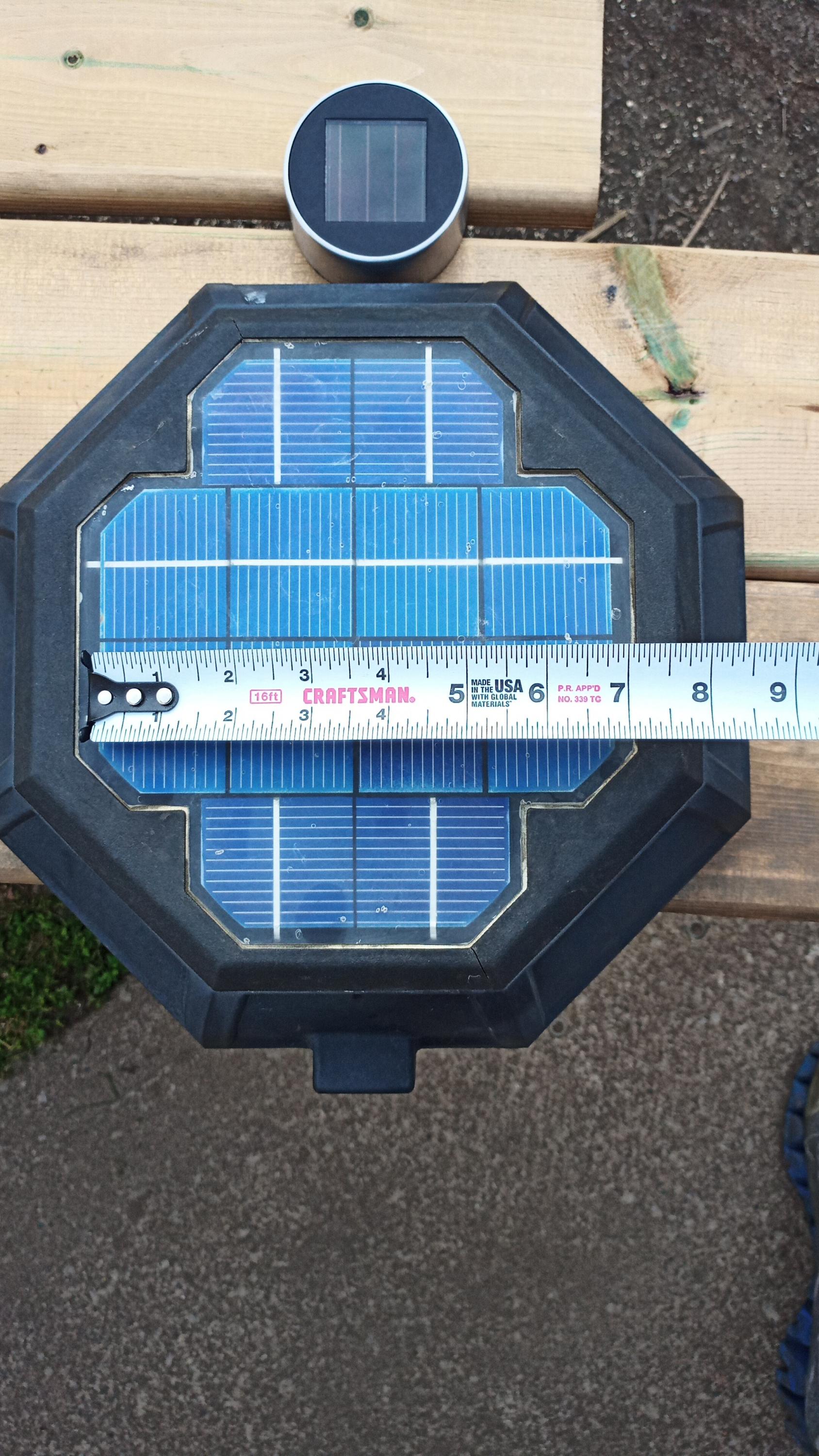

    I have one of those decorative solar lamps, heavy cast head goes on a metal pole, hasn't worked in some time so took it down to have a look at it.
    It has a fairly large array of panels compared to the single panel sold in those cheapo solar lights sold in the dollar stores. But when I measure the voltage coming off the panel in full sunlight it struggles to reach half a volt. In comparison the cheapo dollar store ones easily put out 2.3 volts. I know they are different designs and the one I have uses a 4v 4ah SLA battery and a much more complicated circuit board but my question is... is the solar array dead or was there a time that half a volt was the expected output ?
    I was hoping to use the array and replace the circuit board (not sure if it's working) and the old SLA battery for a couple nicads at minimum or lithium even better. The single led inside still works.

    Here's a pic with my lamp and the dollar store one above it.

                      Re: Decorative Solar Lamp Question
                      We'll need a pic of the backside. The solar array can be installed either on the top or the back side of the cover.
                      Either way, the solar array is pooched and it needs to come out if you want to repair it.
                      One cell on the middle far left has a rust spot- which is bad.

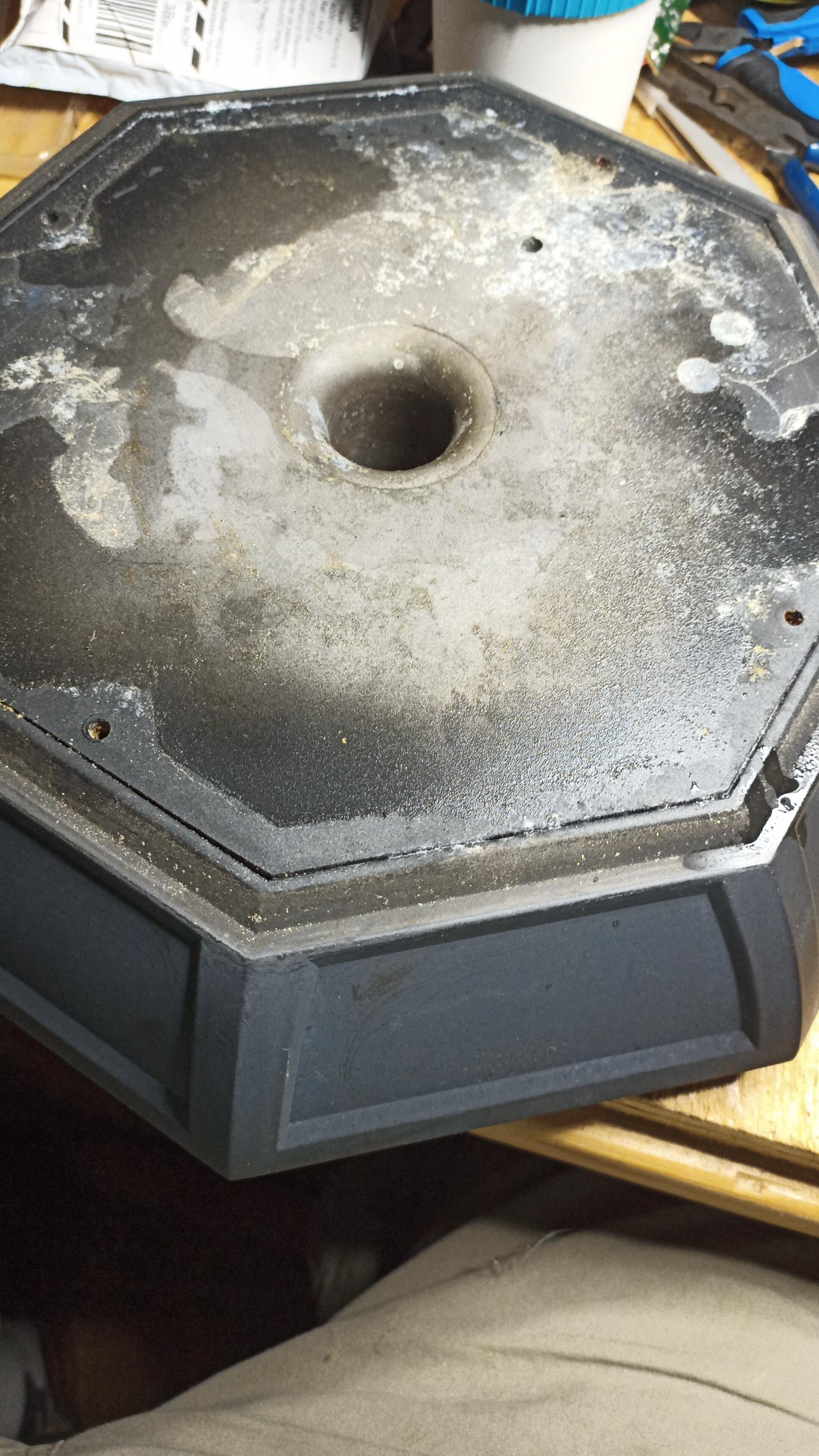

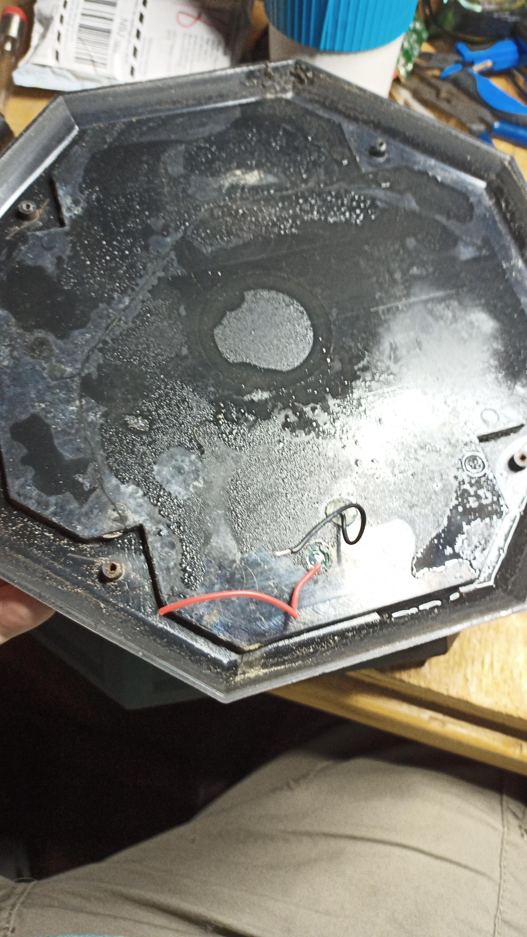

                        Removed the cover that houses the panel from the lid but now the panel still has to be removed from that somehow. Still working at it. Definitely evidence of water between those surfaces.

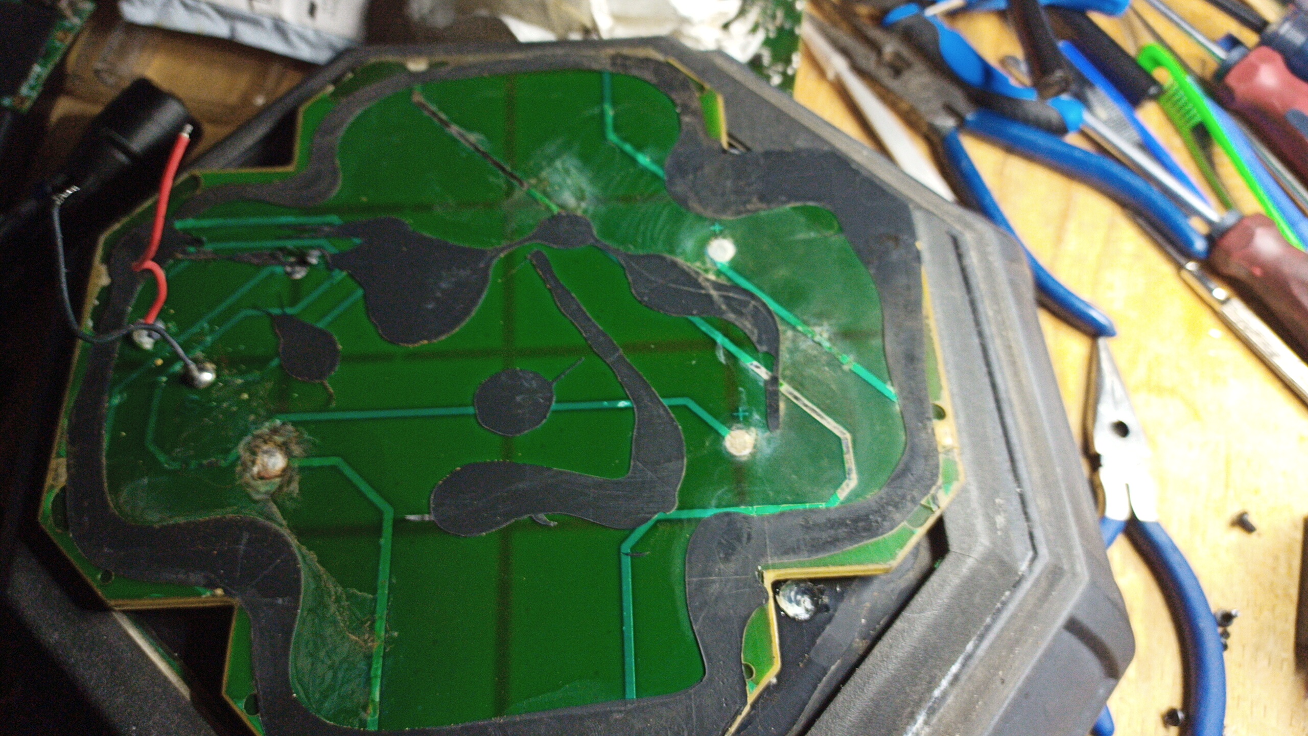

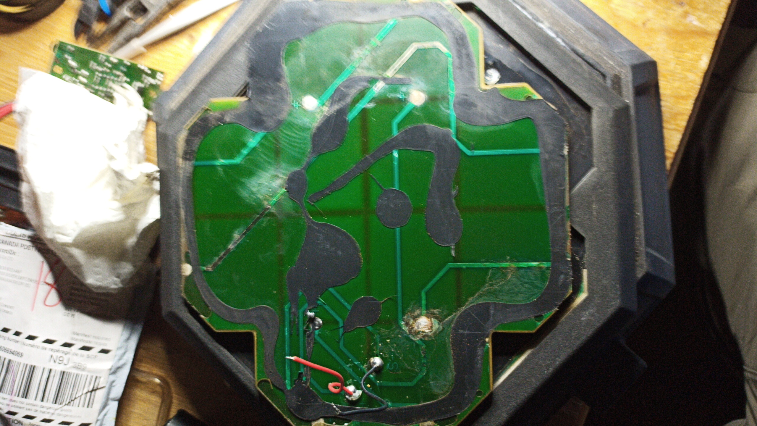

                                      So yes, this DOES look terrible. Several broken traces and oxidized solder pads as predicted.
                                      Can the traces be replaced with wire ? And can I clean up the contacts with fresh solder or should they not be touched with an iron ?
                                        It looks fixable. I use q-tips with alcohol IPA to clean the corrosion and flux. I only resolder dull looking connections.
                                        It's strange the long trace is black, not sure where the water got in (at the pad, then under the trace?) and what else got the electrolysis. Black is from current flowing through the water between two points.
                                        If a pcb trace looks bad, then a thin jumper wire could be put in. Not sure if this board could sit lifted up a mm or so? Or does it need to be flat which is no more once you add wires.
                                        The glue job is thick or thin in some places, really not a great job.
