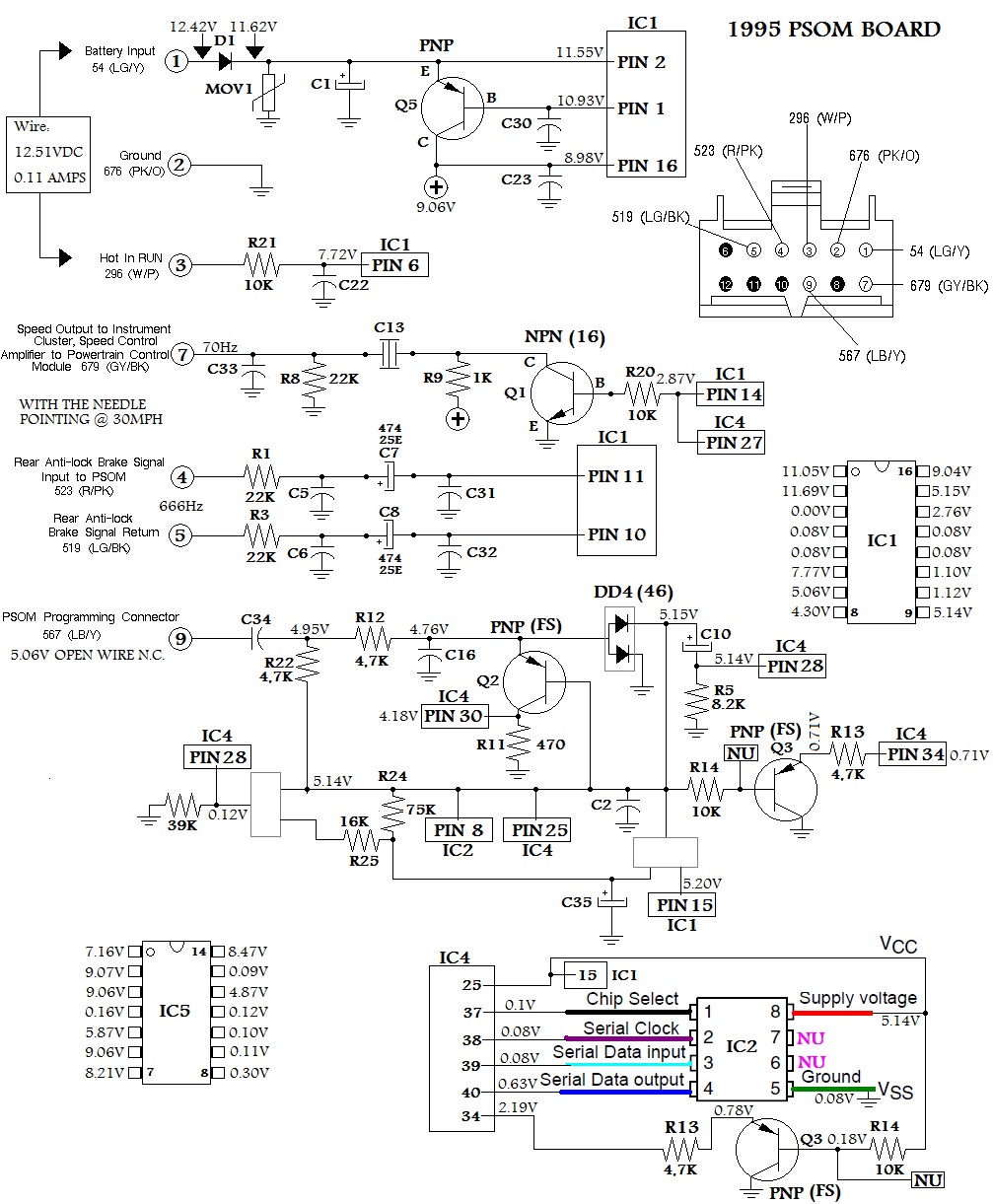

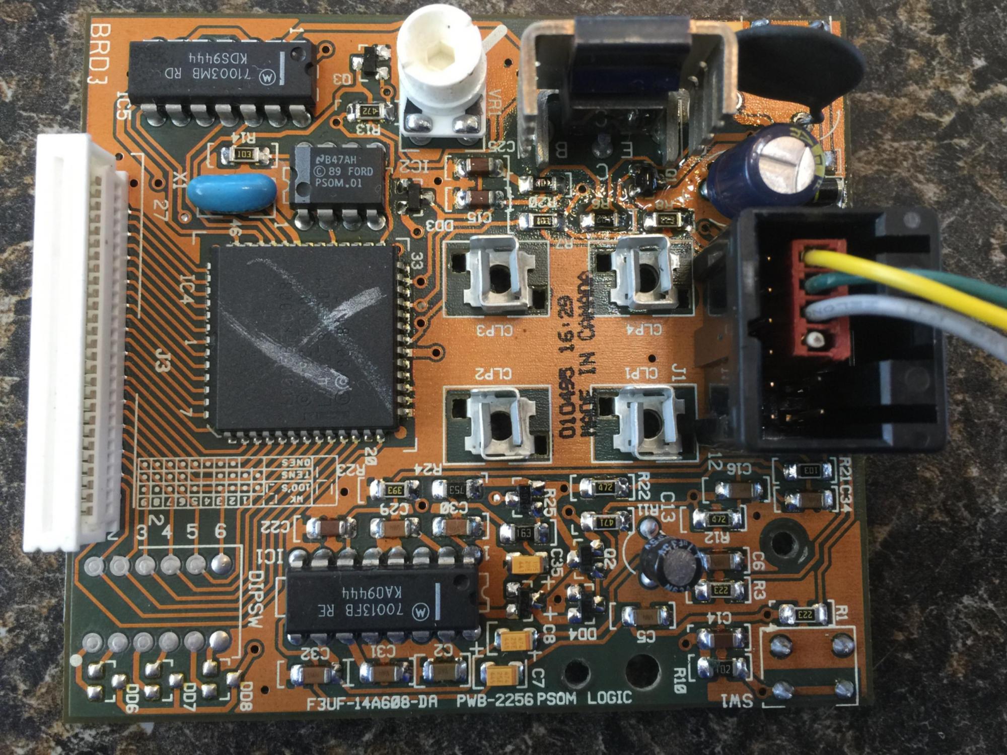

    I am trying to figure out where I am losing voltage, the center pin (c) on transistor should be giving me 9v but I am only getting 1.3. Which goes to pin 16 on IC1. B on transistor is outputting 11.8 but I only get 1.7 on pin 1 of IC1. Thanks Michael
    https://imgur.com/2pML3nc
    IC1 is a Motorola 70013FB
    I have replaced the IC and transistor with no change in symptoms.

    Re: Psom circuit help
    Did you connect IGN to +12V (conn pin 3) to turn on the module? Otherwise I think it stays asleep. IC1 pin 6 should have 7V then and see if 5V is also present.
        programmable speedometer odometer module ... the EEPROM probably keeps the odometer reading.
        Looks like Ford dropped the ball on design of the power of this board, seems the protection circuit was not properly designed. Still very odd why ford designed it the way that they did, but oh well...

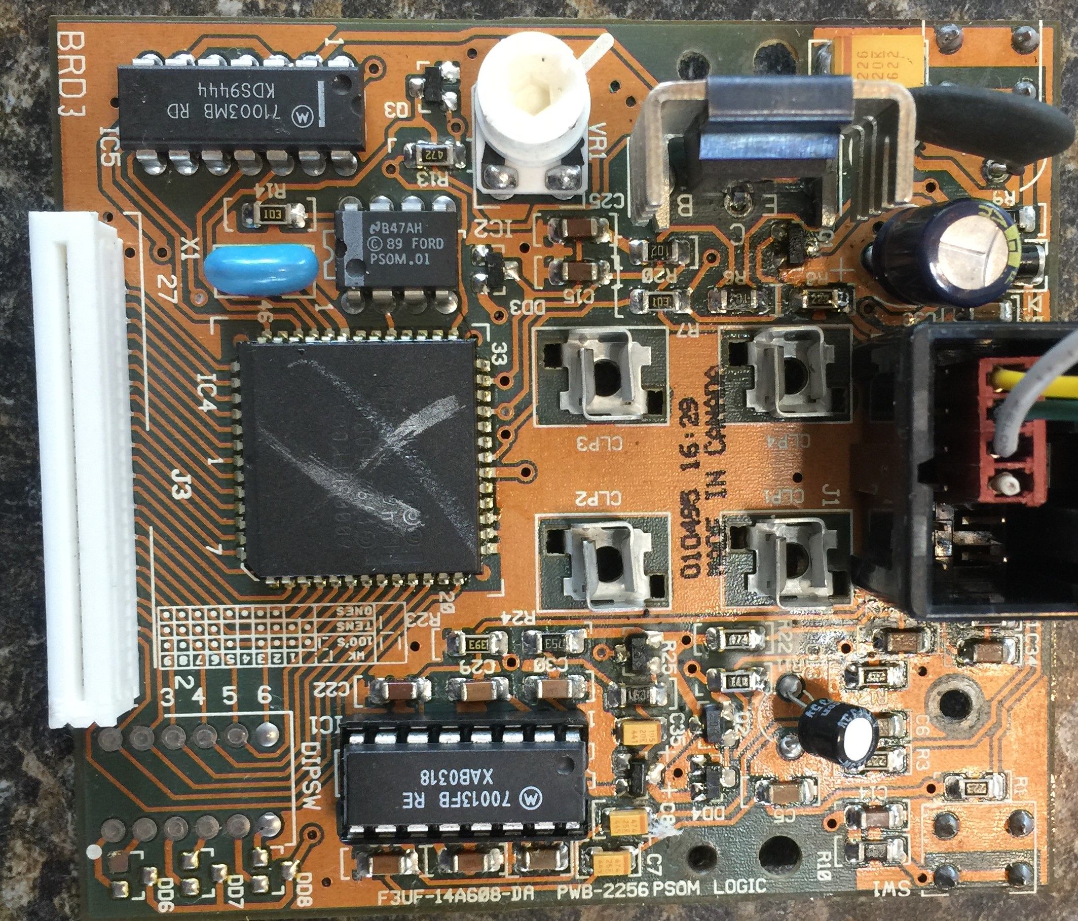

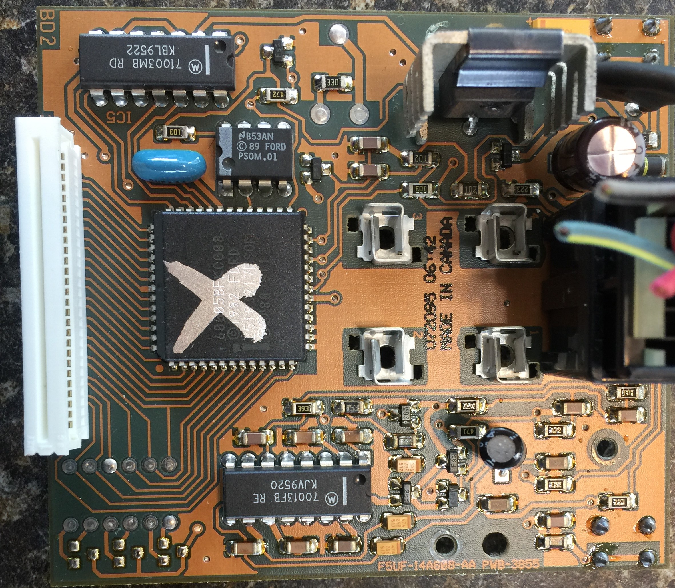

          I purchase a working board with wrong mileage and MPH (80 Compared to 120)
          Working board voltages on IC1
          1) 11.67 16) 9.01
          2) 12.29 15) 5.1
          3) .005 14) 113mv
          4) .005 13) .005
          5) .005 12) .005
          6) 7.85 11) 1.06
          7) 5.02 10) 1.06
          8) 4.33 9) 5.1
          Non working
          1) 1.75 16) 1.3
          2) 12.3 15) .7
          3) jumping 14) .7
          4) .003 13) .003
          5) .003 12) .003
          6) 7.75 11) .85
          7) .79 10) 333mv
          8) 104mv 9) 139mv

                I am guessing the eprom is the 8 pin chip,
                working boards number is:
                B53AN
                89 Ford
                Psom.01
                Non
                B47AH
                89 Ford
                Psom.01

                    The only difference I see is there is an a adjustable pot on the original board. The working board is marked with an X.

                      On the non-working board, there is no power making it to IC1 pin 2. Check diode D1 is open, or a bad trace/solder joint. You can beep it out with multimeter.

                        Pin 2 is showing 12v on both, is that the wrong pin?

                          If IC1 pin 2 is at 12V, but non-working board pin 1 is 1.75v then the big transistor Q5 has open-circuit E-B junction. Sorry I got mixed up with your list of measurements.

                              Transistor Q5 Ford 5101FB is a house-number. Ford has custom numbers and parts everywhere in this PSOM.
                              It should test as a PNP, not NPN. Pinout should be B-C-E and tab/heatsink is C.
                              There is some problem with it, I wonder if the parts you got are OK or fakes.
                              For a substitute I would use an 80-100V transistor (because of transients, even with MOV) tough such as D45H11, D45H11G, KSE45H11. 80V 10A.

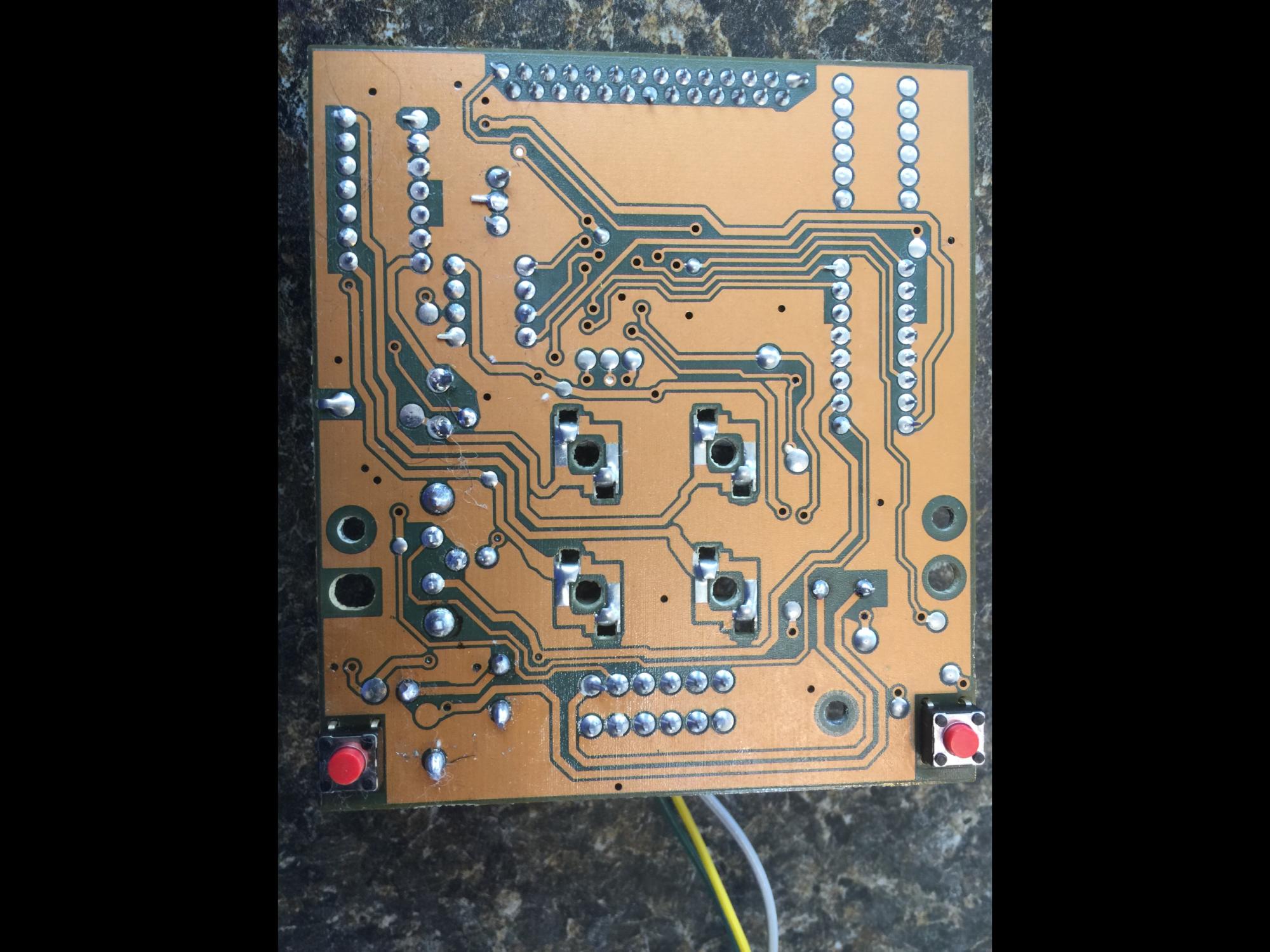

                                    Use your multimeter to test the trace continuity, and also the E-B junction on the transistor Q5. The black corrosion is weird and might have etched the trace.
                                    When I fix stuff I try to find the bad part because changing parts doesn't always work or can make it worse if a bad part kills new parts.

                                        Trace was broke, now the only voltage I am missing is 4.3v on IC1 at pin 8, currently 277mv. Any Clue
