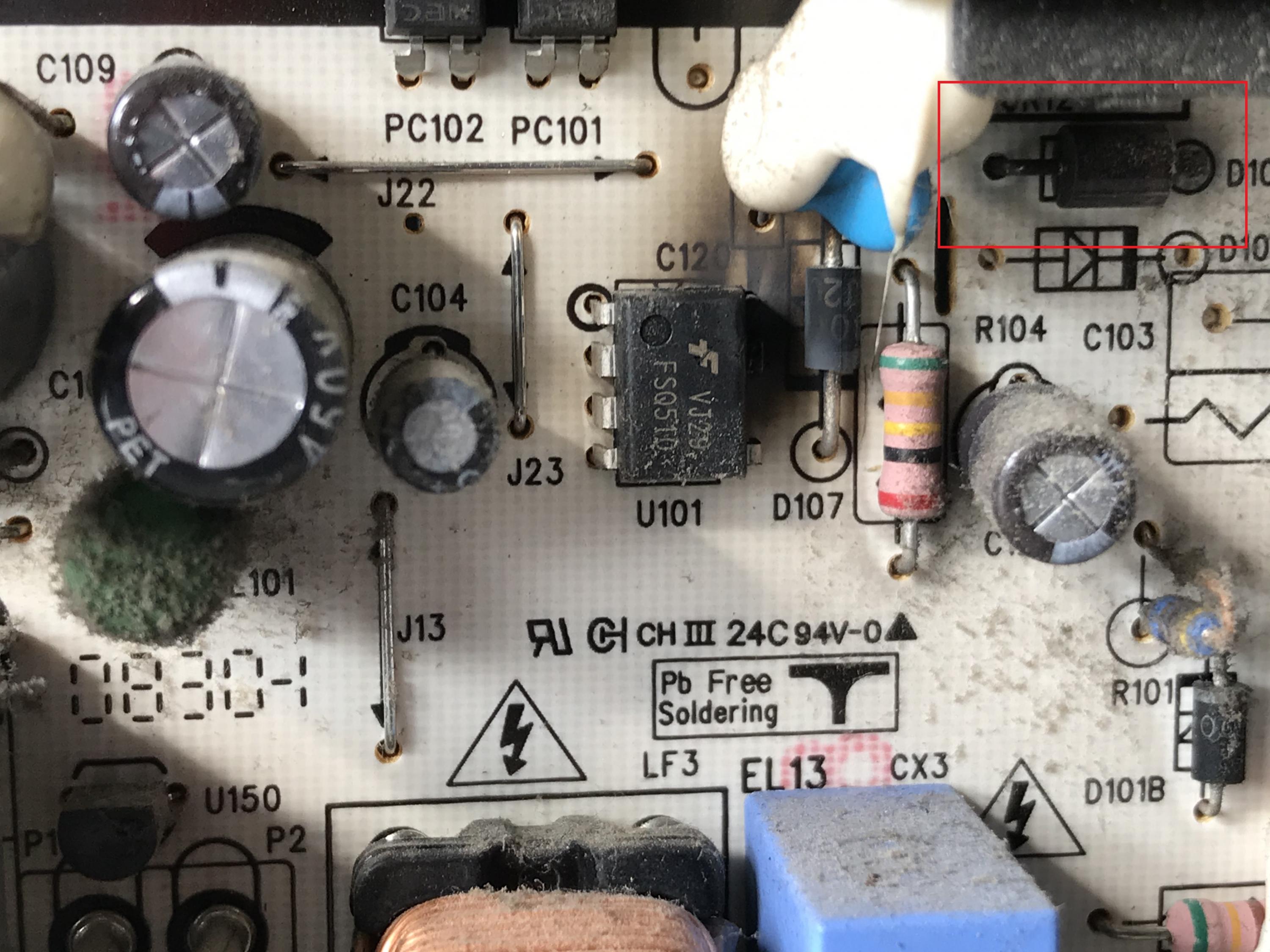

    I have a TV SMPS with a bad diode.
    The marking around the component body is "T2D85" but i haven't been able to find a datasheet for it.
    The diode is a through hole axial. The body is black. The band and text is a dark red color.
    Edit: I have a replacement part for U101 coming next week from Digi-Key.
    -Thomas

    What is wrong with the diode? It can be a TVS diode and they can check open. If it is checking shorted in circuit it could be due to the shorted ic

      I removed it to check for shorts in the supply circuit for U101. While i had it out, I noticed that the diode doesn't beep with the meter in diode mode - no forward drop.

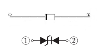

        I find the root part number for T2 diode is ST02D as a Shindengen "trankiller" TVS zener+diode inside. So a T2D85 is 85V ST02D-85 and would test open-circuit unless you can test it past 85V.
        I don't think it's a rectifier diode but would have to see the schematic.

              These type of diodes don't "BEEP", they are usually two internal diodes with common cathode

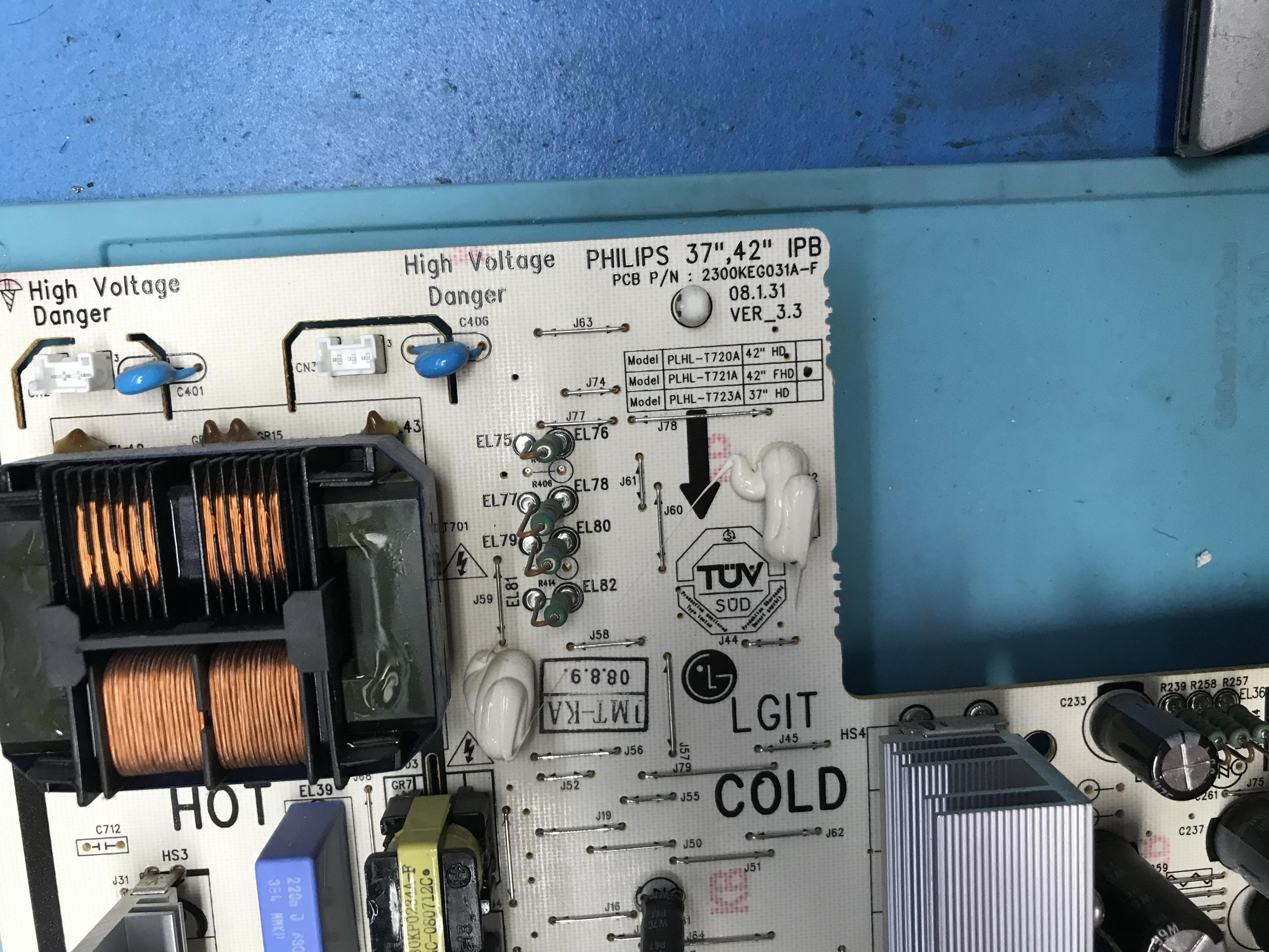

                Thanks guys. The board symbol for this component is the same as the one immediately south of the red box from the pic in Post #1.
                I just realized that i didn't post the board number information.
                This is a LGIT SMPS board for a Philips TV. Board PCB PN: 2300KEG031A-F
                Funny, Coppell TV Repair also mentions that U101 is a common failure (which this appears to be the case):LINK

                  I think OP's could be a ST02D-82 (note datasheet wrong 67V spec). Mouser sells them.
                  It looks like other people mistakenly think these T2D snubber diodes "power clampers" are open-circuit, when they are just HV zener plus diode:

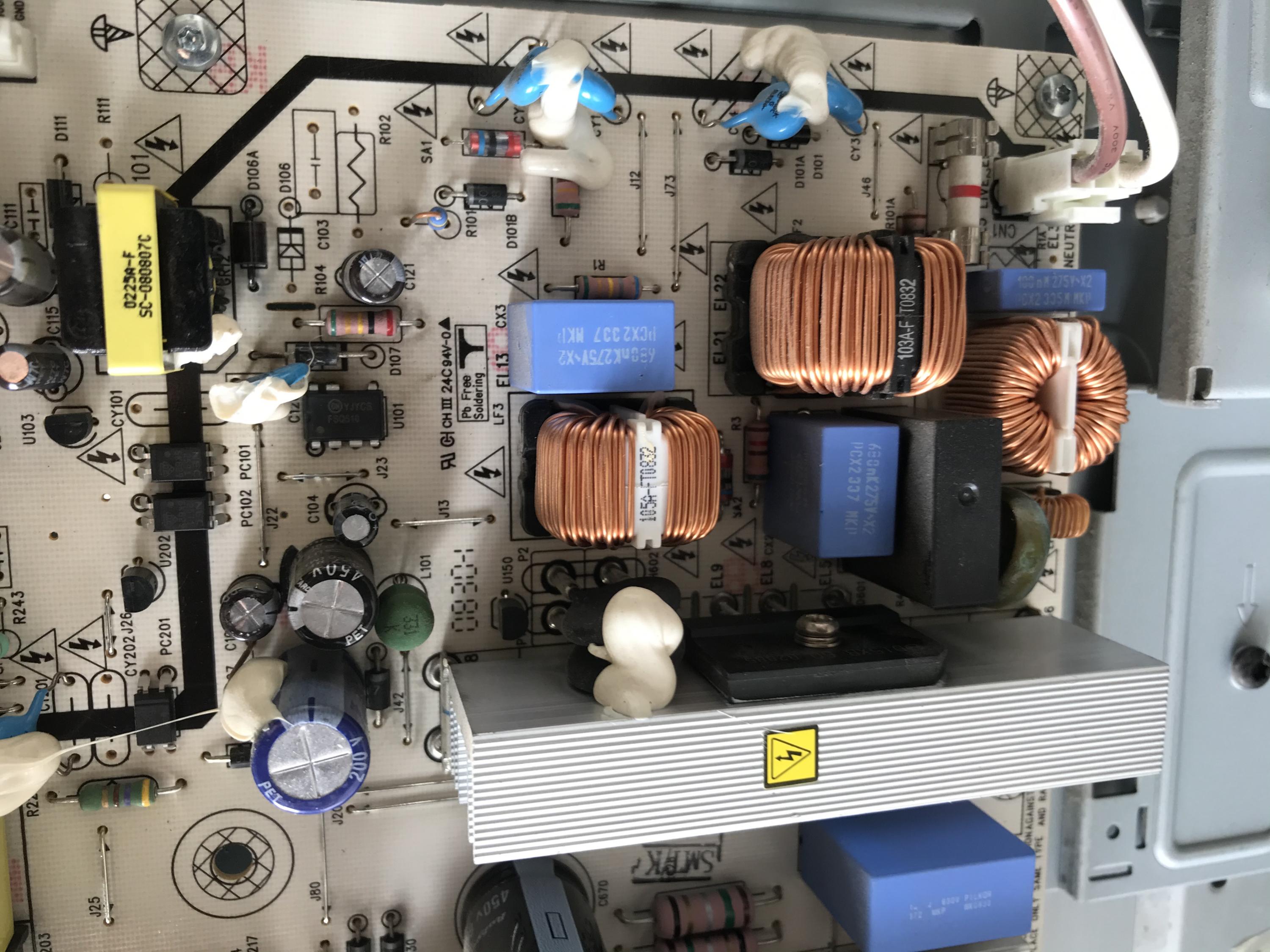

                    Also, looks like this component sits across the two terminals of the transformer that bridges the hot and cold side of the SMPS. I removed the transformer and checked for shorts across the three separate windings. The transformer to be okay.

                      That TVS (HV zener) diode (D106A) is across the primary, In some cases they use a UF4007 for D106 and have C103 and R102 populated which are in series with the uf4007 fast recover diode.

                        Update: The FSQ510 arrived and was replaced on the SMPS.
                        The TV fires up and appears to work.
