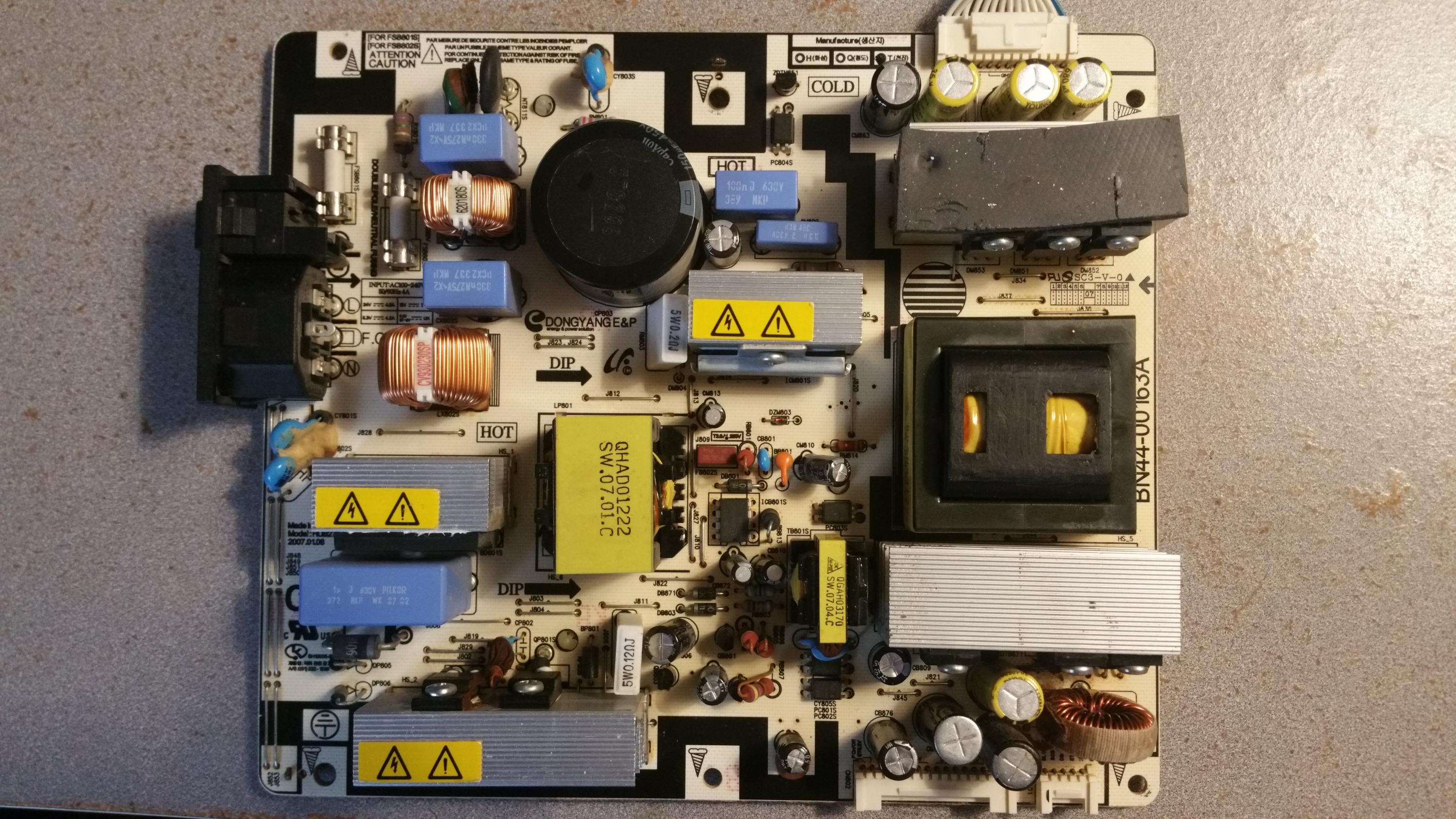

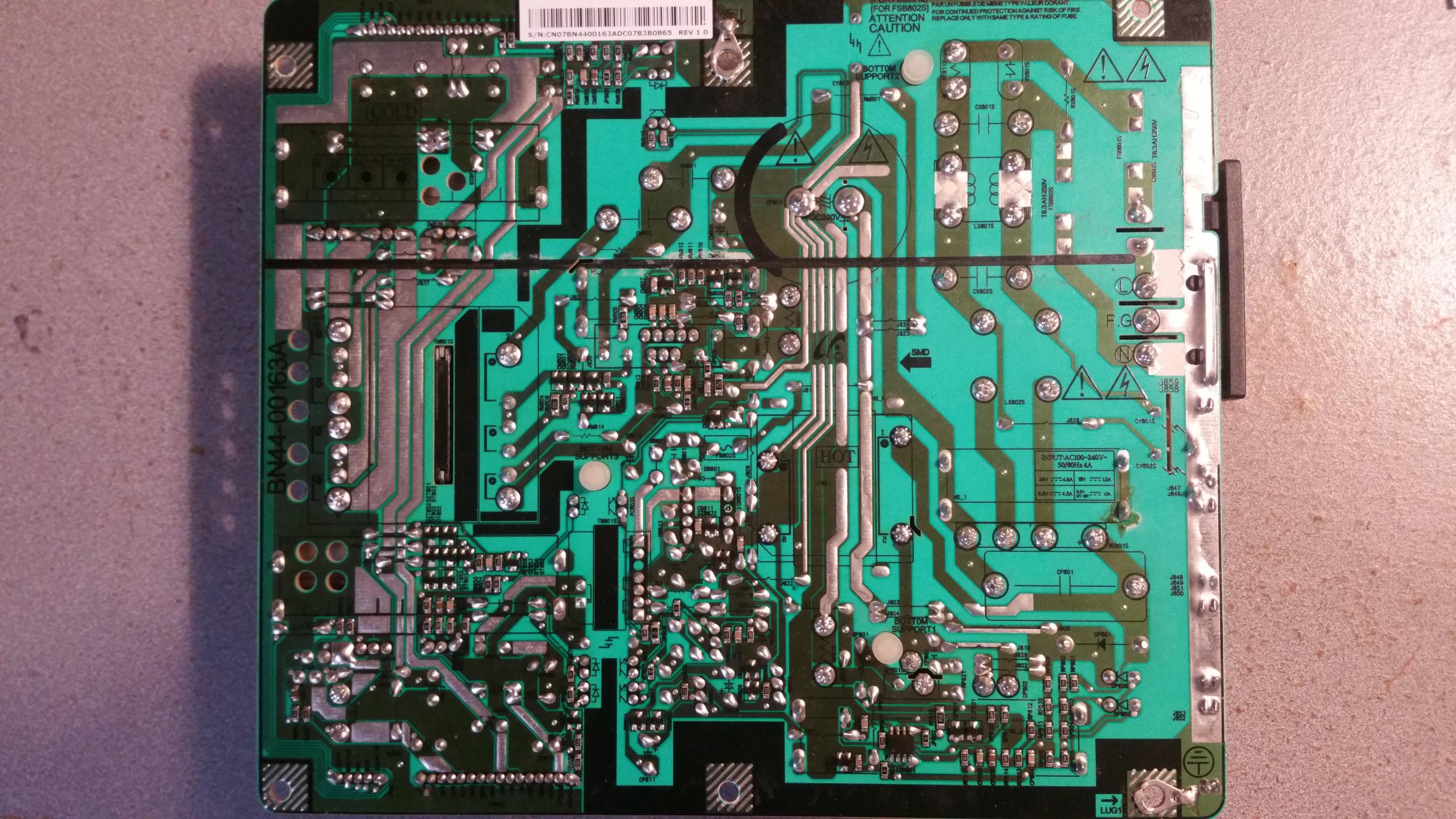

Can we see good clear straight shots of the whole top and bottom side of the board?

Just cut the paper clip down to size and just solder it in and get it over with, that piece of wire looks to be connected to Gate of the MOSFET, that is why I ask for pictures) so any piece of wire will work.

Not that it matters -- just use an insulated or not piece of 22AWG wire -- but that device looks like an IC since it has 5 pins...
whole top and bottom of board.
this board has 24v, 15v and 5.3v~ but 5.3v is not working

That wire is needed for that Buck converter IC to work.
