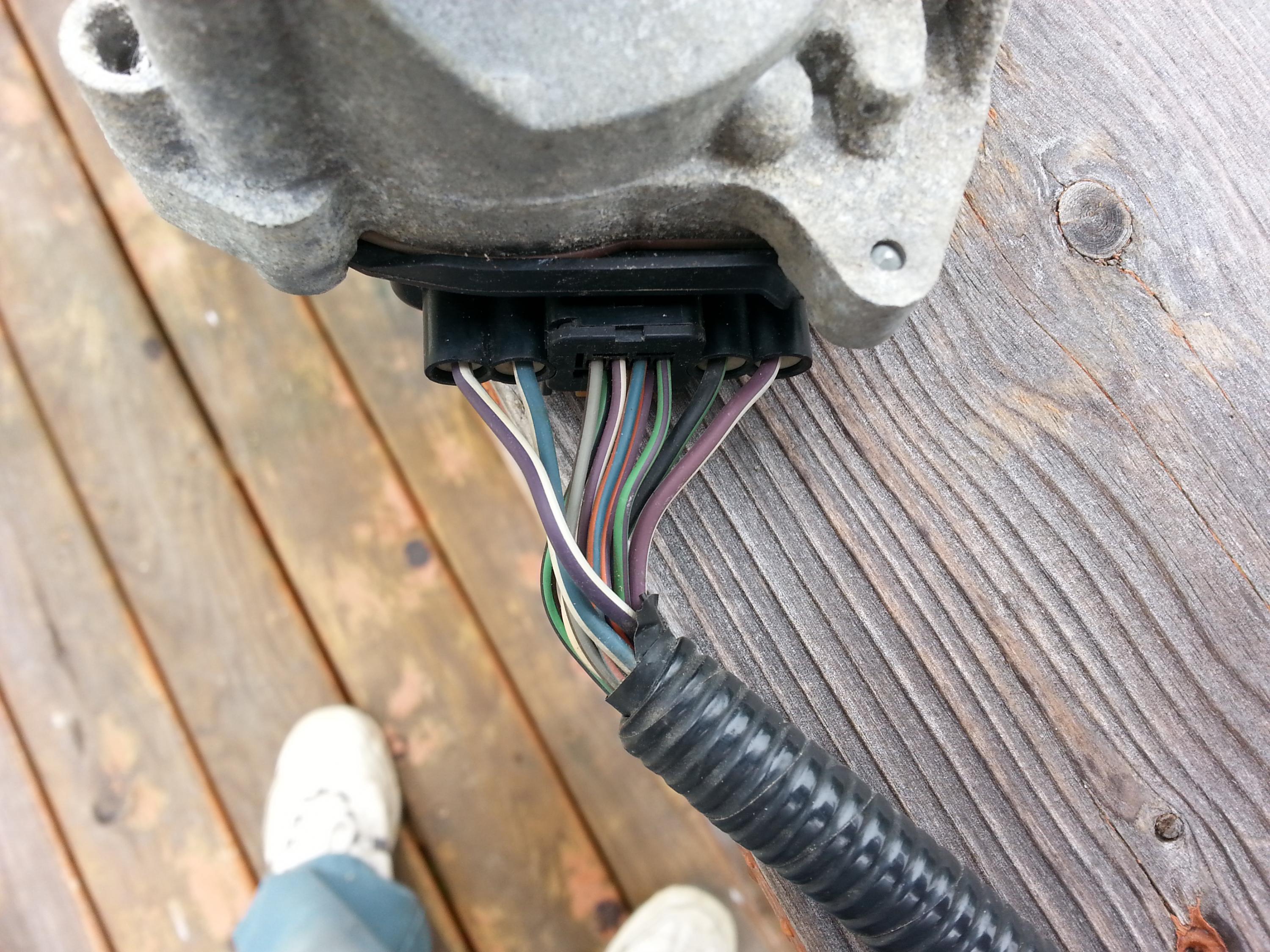

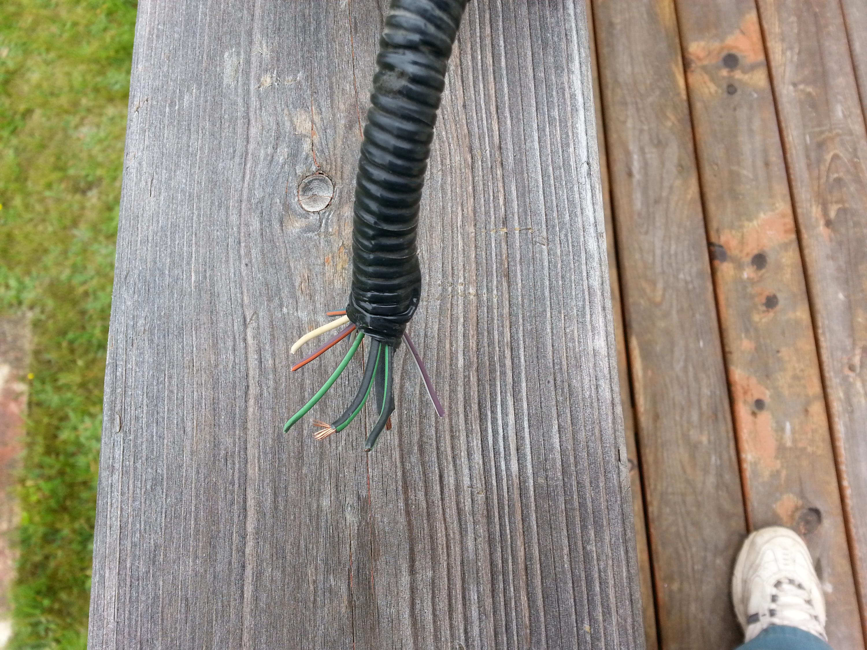

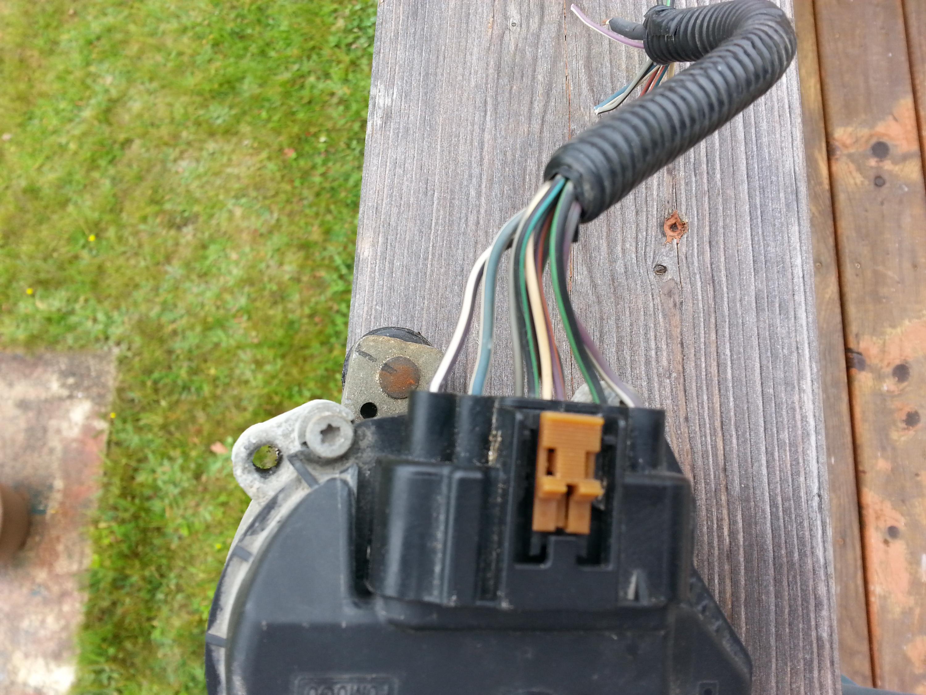

    I have a 12 volt wiper motor off a ford car that I was hoping to use to power the feed belt of a diy thickness sander but I am not sure how to hook it to a 12 volt battery. The wires on the connector are numbered with the following color
    1- orange/purple
    2 - white
    3 -Green/Black
    4 -
    5 - Purple/White
    6 - Black/Green
    7 - Green/White
    8 - Purple/White
    9 - Green/Black
    10 - orange/Blue
    11 - purple/white
    12 - Grey/brown
    5,6,7and 8 are heavier gauge wire than 1,2,3,9,10,11 and 12. 4 is empty and both 5 and 8 are common
    Tried a number of combinations but nothing worked Not at all sure how this should work any help greatly appreciated

    best bet is find the wiring diagram for the car and hope it shows switch connections .

      12 wires? It will be easier to train a hamster to spin a wheel.

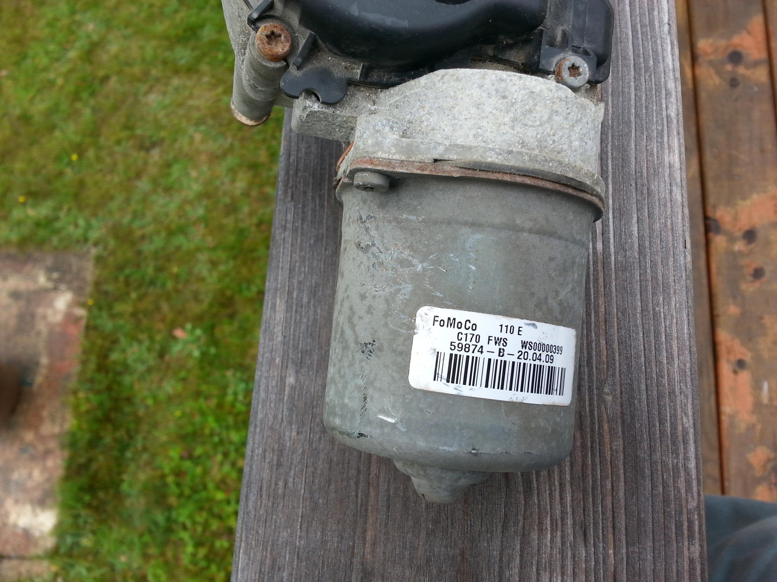

      WS00000399 is from 2007-2011 Ford Focus. There was a recall for water getting in them. Ford seemed to go crazy with the designs.
      Look for a Ford Focus wiring diagram, but I did not see any with so many wires. Unless it's from a minivan where the wipers park.

        you need to open it, it has switches in it to detect the end of travel and may even have them wired to reverse the motor.
        you have to remove the limit switches and any type of cam that hits them and limits rotation.

          Correction wire 9 is (green and purple) not black. Tks redwire it is from a ford focus and maybe it doesn't work? I'll see what I can find in a wiring diagram at the local Ford service center, but they don't like sharing that kind of info?? Anyone know where I might find one on line? I did some searching but didn't find anything specific.

              Tks stj but I have no idea of the year just what popped up when I Googled part # WS00000399 it says 2007 - 2011 Ford Focus. I pulled it from a wreck in the scrap yard and didn't realize it was going to be so complicated.??

                      I would take a volt meter and see which wire have a direct short will be your switches and ones that some resistance to them might the motor windings It might be high and low speed winding
                      There might be a park switch and what the other wires not sure of

                        just open it,
                        your intended use has no use for end-sensors or switches anyway.

                          There may be a connection to unswitched battery that ensures the wipers park even if the ignition is switched off "mid-action". And, another connection to the wiper control knob and SWITCHED battery (i.e., so the wipers keep running into "park" with ignition off but can't be turned on with ignition off).
                          Mitchell or Autodata should have the info needed (or, your local auto parts store).

                            This is complicated I did open it up and yes there is a switch on a circuit board controlled by a magnet on the rotor and the circuit board has three contacts that feed into the motor which are the two speeds and ground. I can run the motor by putting 12 volts across these contacts but I can't find any wires in the wiring harness that will supply 12 volts directly to any of these contacts?? I could eliminate the circuit board??

                              yes, it's a 12v motor so rip the junk out.
