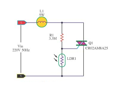

    Hello, it's been a long time since my last post and i'm here again seeking advice from more experienced guys
    I have a night light that had it's incandescent 10W bulb die recently, and i've bought a 2.3W LED to replace it, but i've immediately noticed that when it should turn on, instead it's flickering. There was only ~130ish Volt AC across the leads for the bulb so i've thought that this must be some sort of dimming mechanism for the incandescent bulb. I've since taken it apart and drawn a schematics to the best of my ability.
    No here is the question. What would be the easiest thing to change in the circuit, to maintain the night/light sensing and be able to run the LED off it properly?
    Here's the schematic:
    Thanks in advance for any input

    Re: lighting circuit modification
    you need a resistor in parallel with the led lamp.
    i dont know what value, but that circuit uses the lamp as a source of power to the light sensor.
    led lights are not resistive, they are inductive.

      Ok thanks, i can measure the resistance across LED's circuit, would that help in determining the required resistance?
        MCR100 is an SCR, so when it is turned on it outputs only 1/2 wave pulsing DC to the light bulb.
        Your LED lamp probably does not like this and may not work if it uses a capacitive dropper- then it really wants AC, not pulsing DC coming in.
        If you post a pic of the LED lamp's circuit, you can figure it out if it will work.

          Just a thought would it be possibile to change the MCR100 out for another element (if it exists), that would output entire sine wave to the lamp.
          Edit: I have been able to remove the plastic cover over the LED's, but the circuitry is inside the bulb's base and is not accessible unless i destroy the base :/
            I did find the same night light circuit but using a CR02AM-8A triac which should give full-wave to the lamp. It is hard to find very sensitive gate (100uA) thyristors.
              Duplicate the circuit in reverse ...

                Thanks, this might be just what i was looking for, i'm just a bit confused about the information i read from the spec sheeet.
                namely this:
                why does it say half sine wave?
                  The I2t (amp squared seconds) value is based on the time for a fuse blowing 10-16msec, or 1/2 cycle.
                        Relay? The schematic on your post 1 using the SCR which means the 10W lamp is only be using 5W of power due to half wave action of the SCR, so when you use your meter the Voltage you test is the pulsing DC so it will not show 230VAC.
                          Half wave recitification.
                                  The triac arrived an i've installed it. The light now doesn't flicker anymore, however the light also doesn't turn off when it's daytime xD.. i'll give it another go tomorrow
