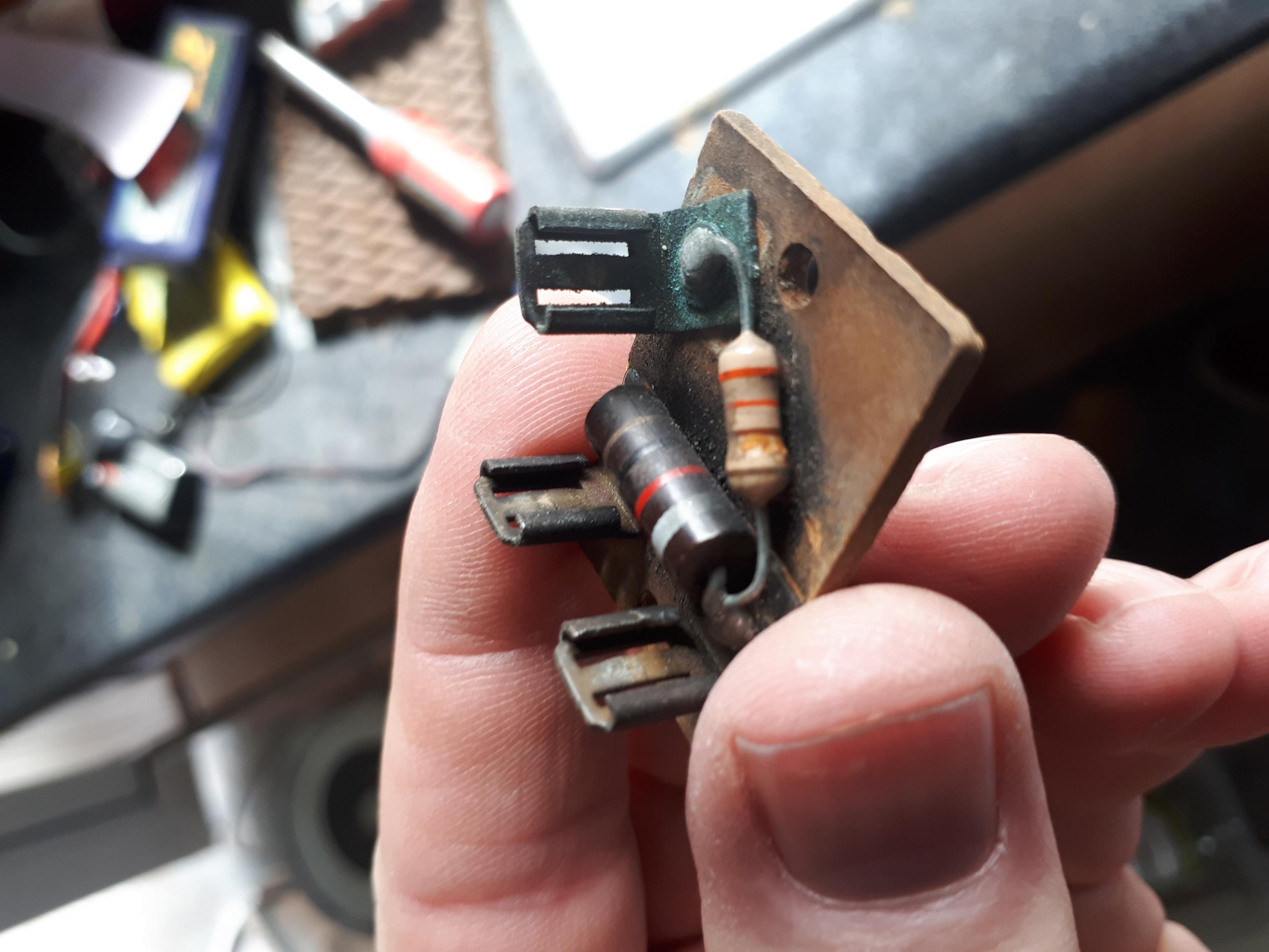

    A quick one for you. Can you identify the components in the attached picture for me?
    It is a small board from the back of my dash (fuel gauge) on my tractor which has dual fuel tank. I think the components are busted and need to be replaced.

    They are resistors, the larger one is 1k ohms and the smaller might be 330 ohm I can't make out the color bands, check them with an ohm meter

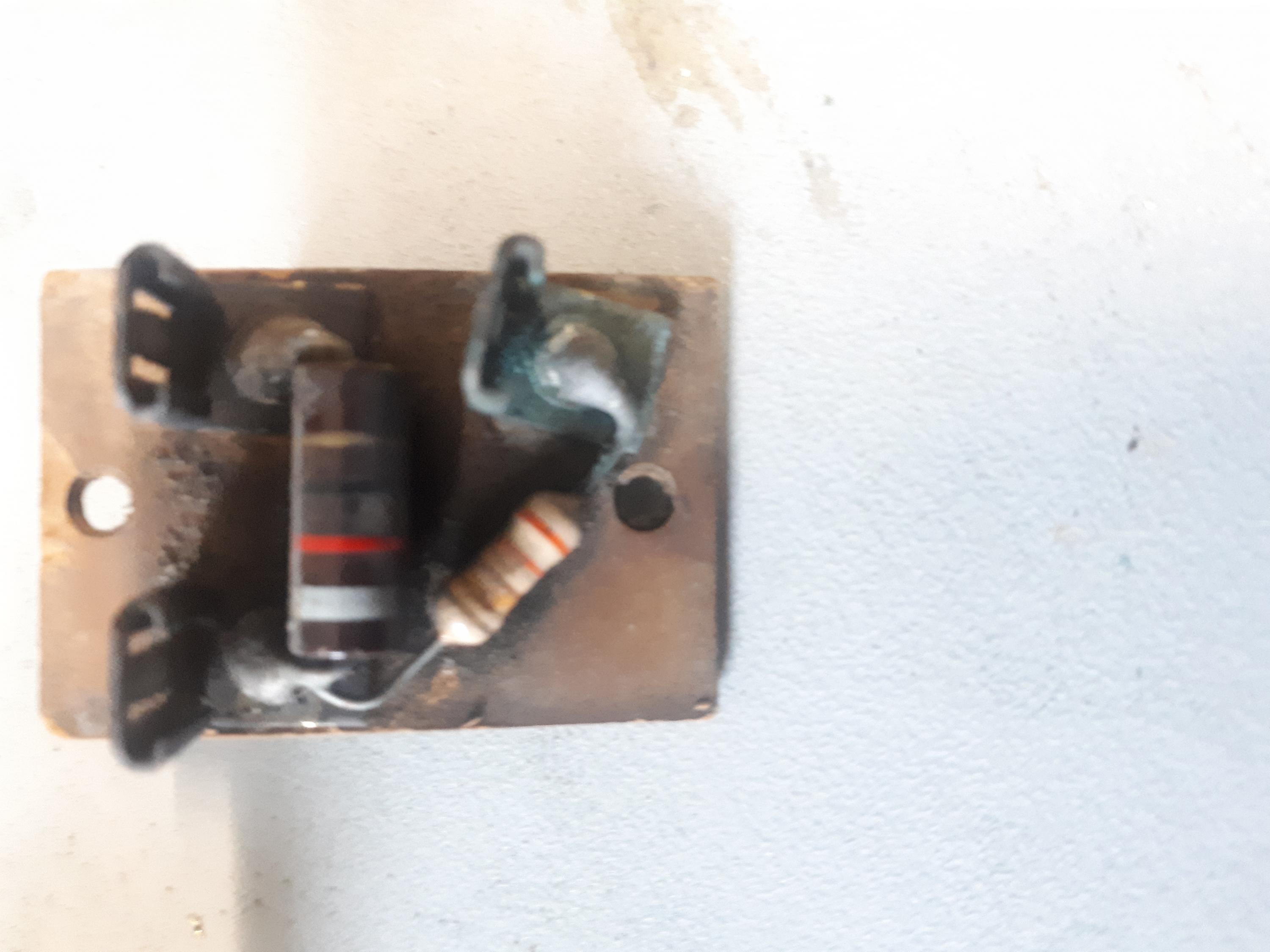

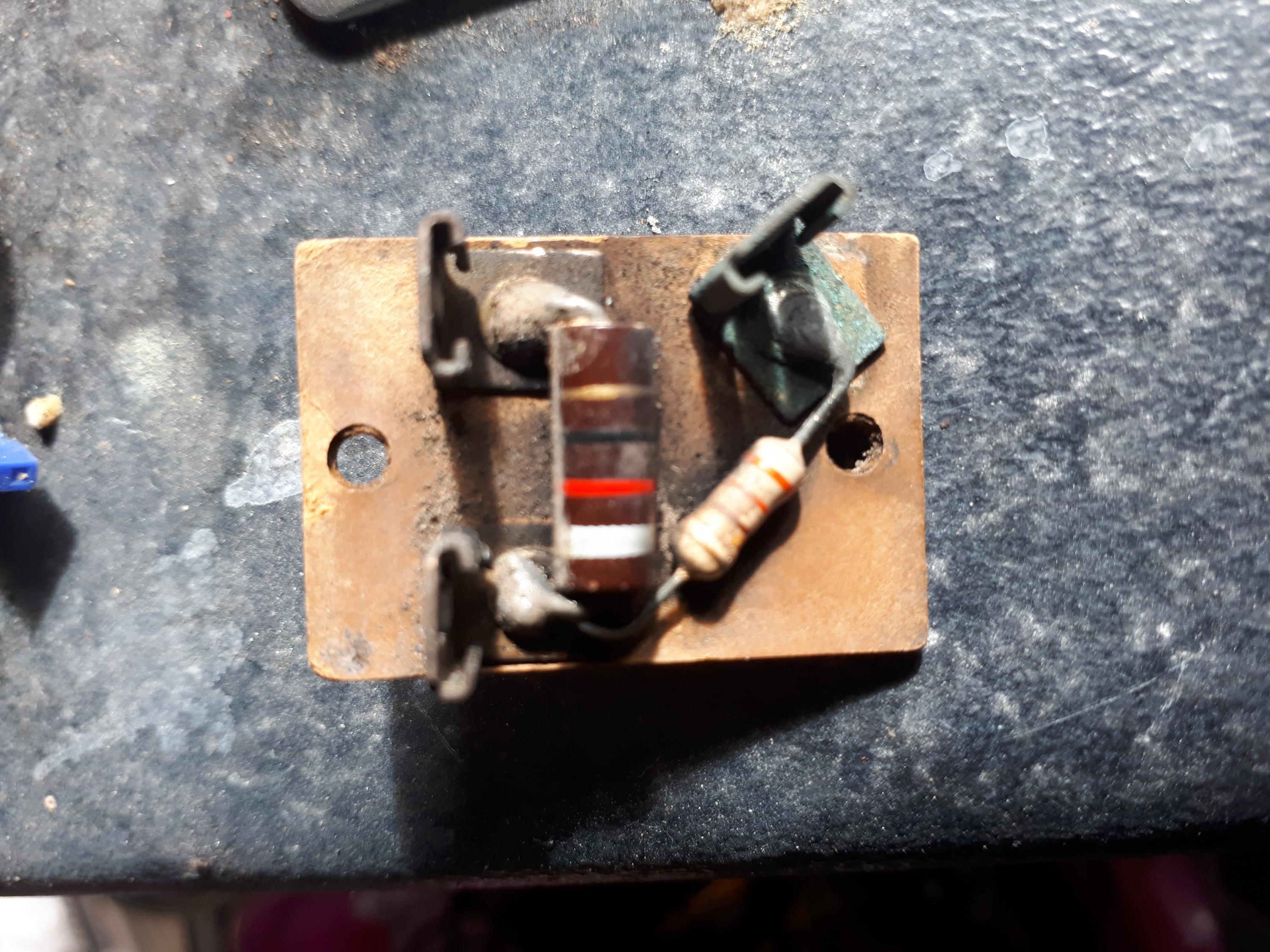

        Pics attached

          It could be 3.3kΩ (orange,orange,red). Do you have a multimeter to check the resistance?
          After a closer look, that larger resistor looks like a 1kΩ (brown,black,red)

              NO, I looked at the other side of the picture and they don't seem to be connected to anything else
                • 31283
                Re: Identification of parts
                your problem is probably all that shit on the contacts,
                try cleaning it up with a wire brush or something - the same goes for the bits that go onto them.

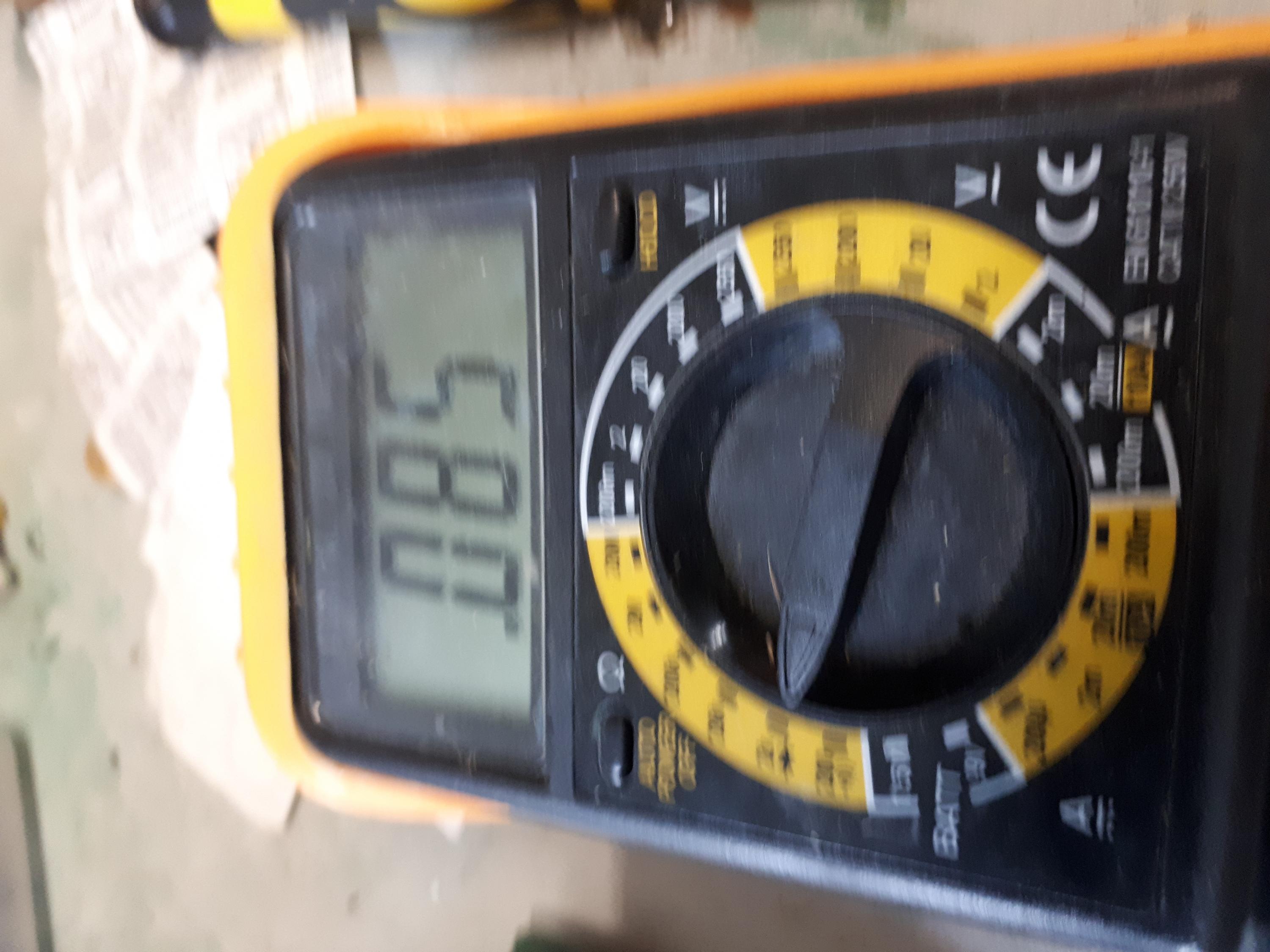

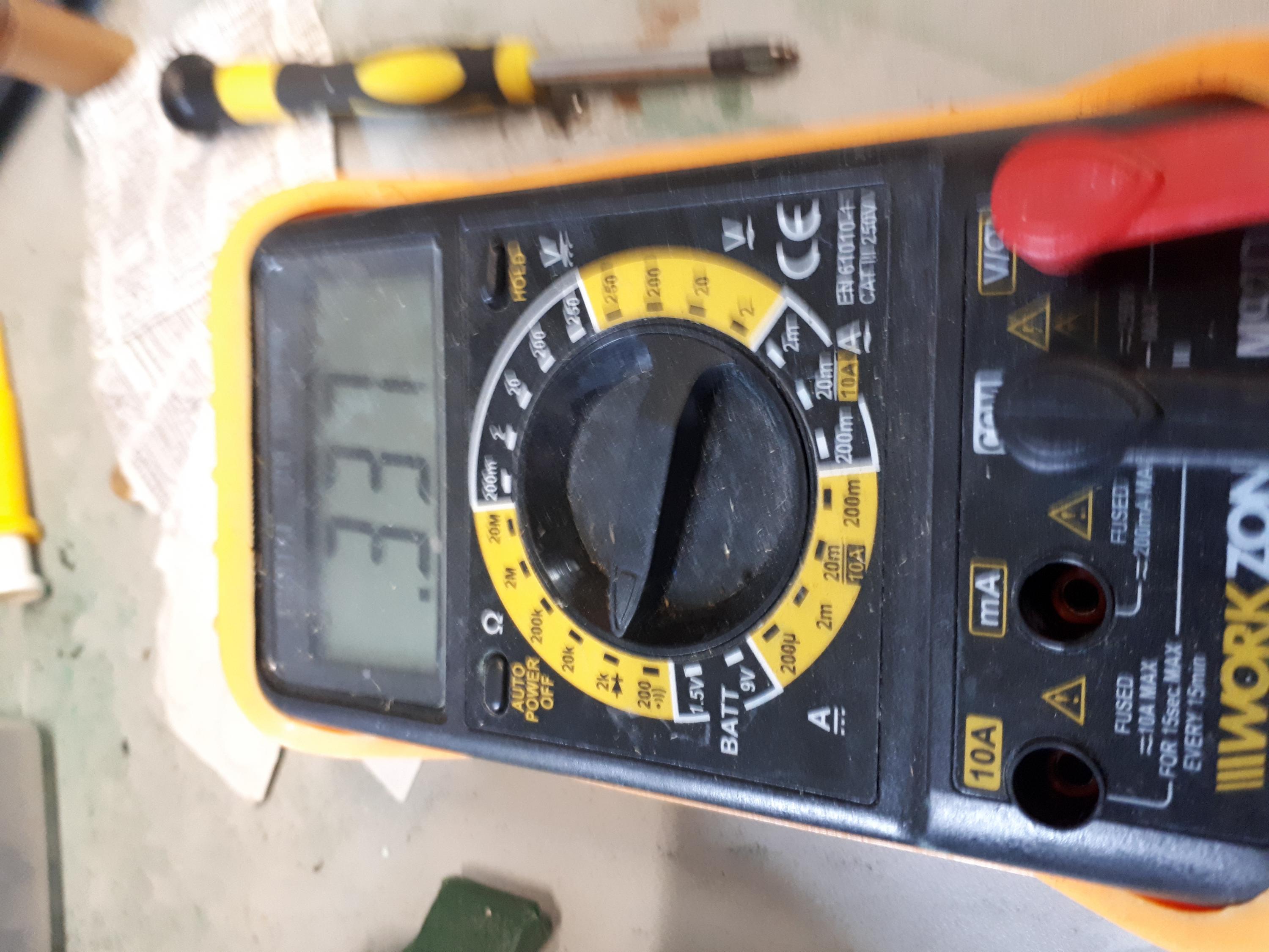

                  Pic of readings attached. First one is the big resistor
                  • R_J
                    • Jun 2012
                    • 9623
                    So the lager one is marked 82Ω 5% and measures 85Ω which is ok, the smaller one is marked 330Ω 5% and measure 337 which is also ok
                    In the first picture I thought it was a 1k but that was incorrect, that gold band looked brown so I read it the wrong way.
