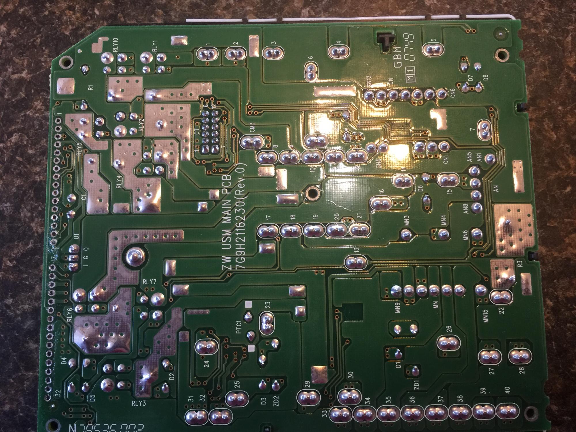

    I have a ipdm out of a nissan that the low beam headlight are not working. i believe it is a bad relay on the board. I had no luck finding the locally, they might need to come from china. is there a way to check them on the bench.

    First check for bad solder/cracked joints on the module main PCB connector and the relay pins. The connector pins I see Nissan truck cracked solder joints on the PCB.
    The relays rarely go bad, they get hot and melt if the contacts are bad.
    If you pull the relay, you can test it on the bench using a car headlamp as a load.
    You can swap the relay for another if you are OK with something else not working until parts come in.
    Taiko YTB1-225L relay is available.

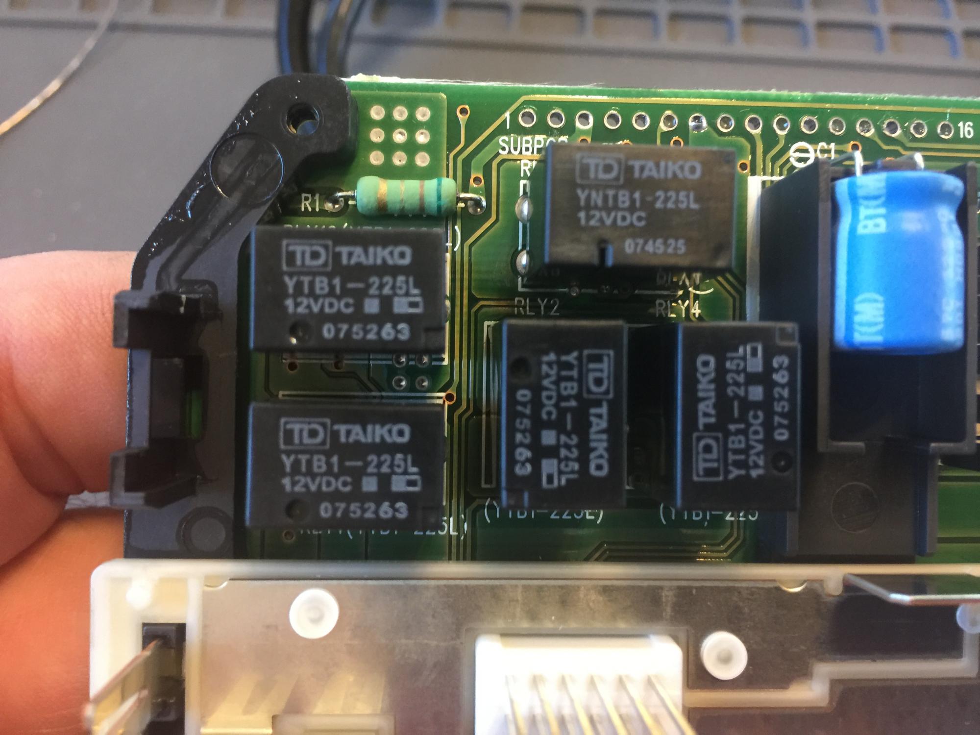

      I just not sure which of the 8 is the low beam one to check, I guess i could unsolder all 8. are they available locally or under a different part number? I will check the joints under the microscope. Thanks Michael

        All the pins look good, i can hear the high beam relay click but I hear nothing out of the low beam.

          Re: Test relays in circuit
          Check the daylight PWM dimmer module, if the car has one. I fixed a Nissan truck, the jumper links have cold solder joints in the small module for daylight low beams. It was a separate module.
          Careful not to go on a goose chase. I check the fuses, low/high beams (bulbs), wiring and headlight switches.
          You would have to follow the low beam wiring diagram back to the connector pin, to trace which relay it is. Or run the module open in the car and feel which one is clicking with a finger - but you say no clicking. You can always tap hard on the top to see if the relay gets unstuck.
          Taiko YTB1-225 relay is out of china, the series root part number is TB1.
          Panasonic has cross-reference to Taiko as TB high-power relays, like ACTBPDH4. It is a specialty automotive relay.

            Yeah unfortunately I had to unsolder a 32 pin board that is stacked on top of the relays. so I dont think there is a way to hook it back up in its current state. I also used my scanner to activate the items in the ipdm and everything passes except the low beam.

              Just use a bench supply and feed the relay coils the required voltage at very low current.
              You should hear them click and you can ohm them out with a meter at the same time.

                If you have the relays out of cct then you can use a pulse / function generator, scope and current limited power-supply to test. I have repaired quite a few of these and or similar for clients, I order the relays from china they take about 10 days to get to me.
                https://www.badcaps.net/forum/showthread.php?t=71359
                This thread outlines the technique I use for testing relays, hope this helps.

                          RLY1, RLY2, RLY10 you can see the coil connects to the high-side of one feed.
                          I would still look at the soldering joints, some look not great i.e RLY5 and others. Use a magnifier. You can wiggle the relay while looking at the PCB backside to see bad connections.
                          7G9H2116230 Renault Clio, Body Fuse Box Module is what search engines give back.
