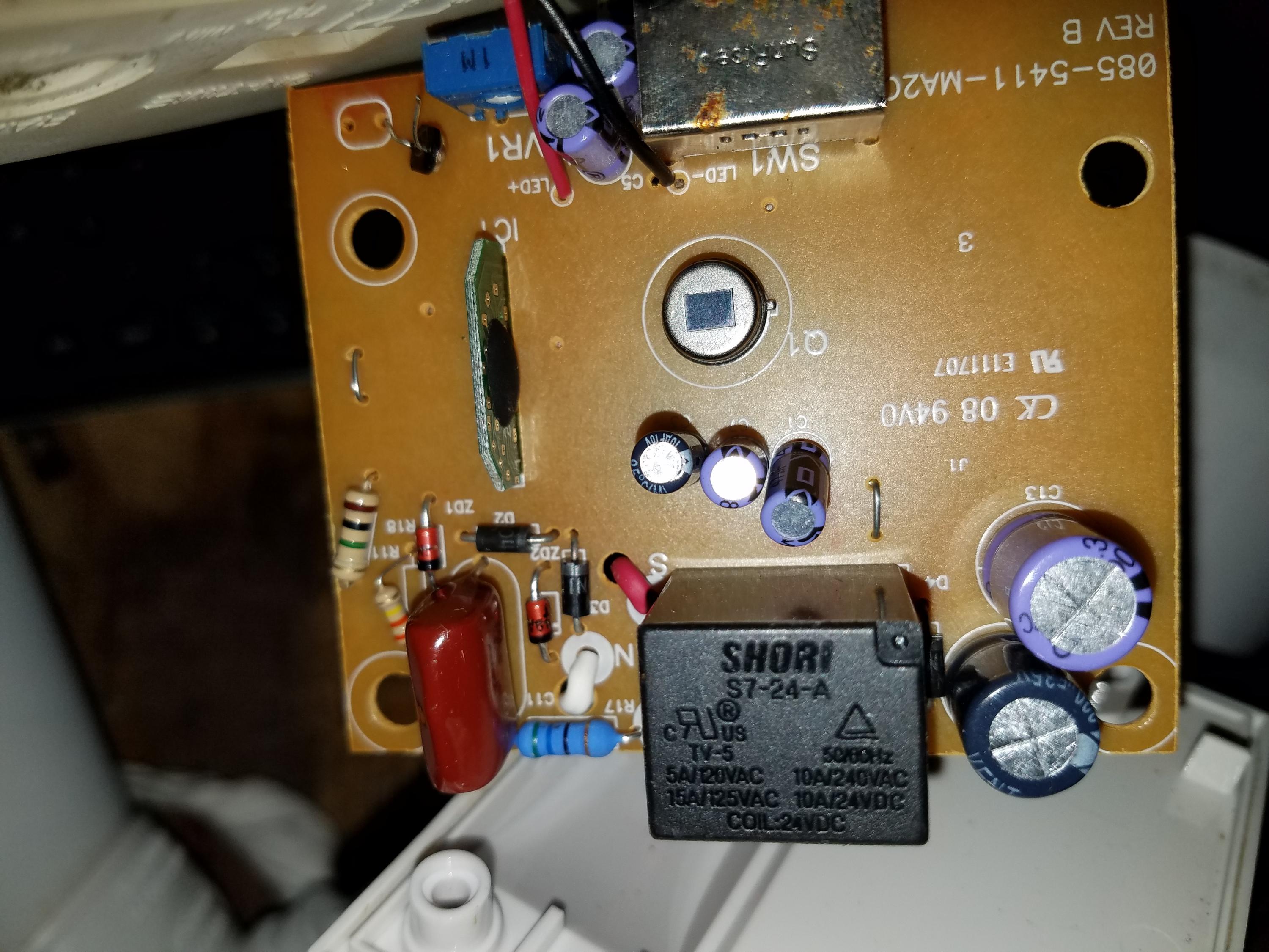

    I just replaced an outdoor motion activated light for my friend and decided to troubleshoot the old one. Within a few minutes I determined the LDR(photo resistor) was bad. It only changes about 5 ohms between light and dark, and after removing it, the light works again. I would like to fix it because I have a use for it, but the LDR has no markings. With the LDR removed, the resistance of the circuit is about 80k. Any ideas on how to figure out the value?
    ------------signature starts here------------
    Re: Replacing failed photo resistor. How to determine value?
    I would put a pot (may be 10K to start with) in its place and vary the resistance to simulate Dark and light so at you will know what the delta is, then you may be able to do some modification using photo Transistor.
    https://www.badcaps.net/forum/attach...0&d=1554877524 where is the connection to the sensor? I cannot clearly see the traces on that section where the sensor is.
    You should also take some Voltage measurement on the two pads where the sensor is connected to.
      Guessing the chip is BISS0001 which is a popular PIR motion detector IC.
      CdS cell input triggers at 0.9V/1.7V and you'd have to check your circuit what the resistor is to +V power, and if it is 3.3V or 5V the IC runs off.
      For 3.3V power if R is 1MEG then a 500kohm dark CDS (or higher). I think you have a 1MEG trimpot for R.
      Some people put in a photo-transistor and lower say ~100k resistor.
      You can do the voltage divider math once you know +V and R.
      Careful the electronics is running from hazardous live so there is a shock hazard.

        New pictures below. Red circle is the LDR connections. Voltage is about 5.7v with the LDR removed.

          It's one of those chip under blob things, so I don't have any way of knowing. The trimmer on the board is for range. Where am I measuring R?

            I don't think you can really make a good guess from here how the blob is made and what its light/dark cutpoint is. Probably have to resort to guess and check, I'd probably start with the GL5528 and see how it works.

                I've been playing around with different resistances and it seems that somewhere around 33k is the tripping point. Anything above that will make it turn on.

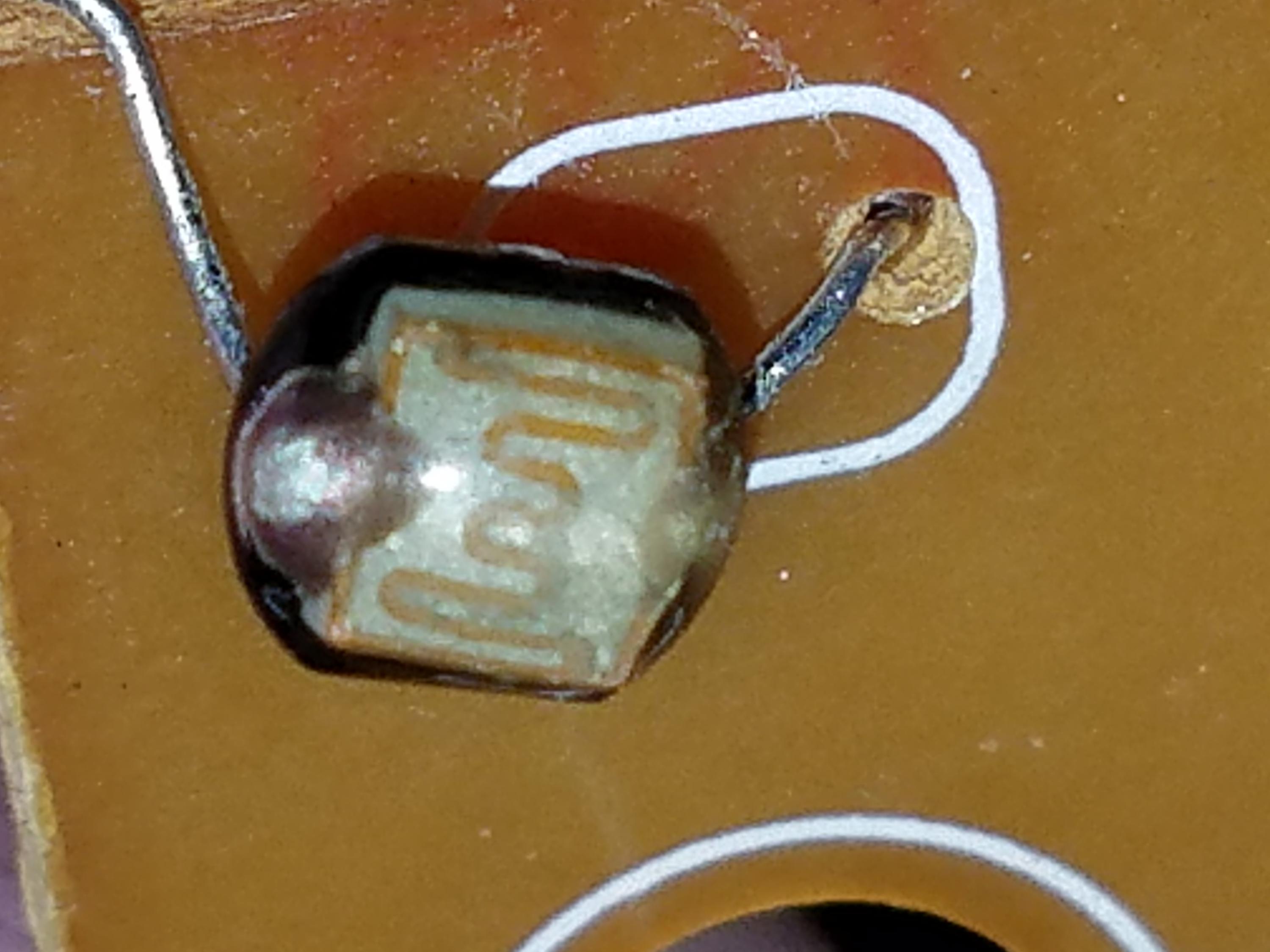

                    You can test the CdS photo-resistor out of circuit. They are slow and it can take 10 seconds when they get dark for resistance to settle. Very small chance the capacitors in the circuit by C16 C17 are leaky or failed instead.
                    I think any replacement CdS would work- photo-resistors have a logarithmic ohms scale and around 100:1 change between light and dark. So there isn't big difference between them if you are only looking at on/off, light/dark sensing.
                    A GL5528 looks good, or a GL5516 if that's all you have in the junk box.
                    It would affect the exact trip point at dusk, the GL5516 would make it need to be darker out before the motion sense is enabled.
                    Another method I faintly recall is counting squiggles and size on the CdS cell to compare them, but that's grasping at straws.

                      I'm 100% certain it's the photo-resistor. I've tested it out of circuit and it barely changes between light and dark. Also, I've simulated it in circuit with a resistor and that makes the light work again. I just ordered 20 GL5528s for 82 cents from AliExpress. I guess it will be about a month before I have them.
