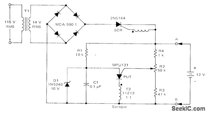

                    It looks not bad, anything beats selenium rectifiers lol. Not hard to sketch a schematic. In the late 1970's lots of GE circuits for SCR chargers.
                    The blue Philips electrolytic caps, I find they don't last.
                    It probably eats SCR's if you short the output.
                    It looks more like a "programmable unijunction transistor" circuit?
                    Like this but drives two SCR's.

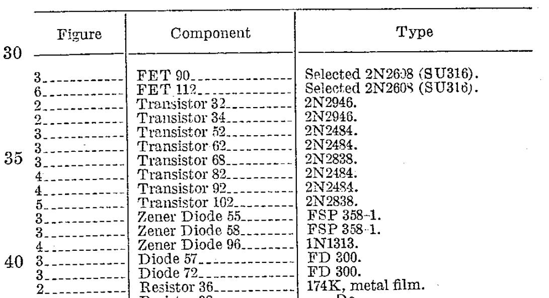

                              Motorola SU316 unijunction transistor. No NTE cross (like a SU112), not in my 1980 Motorola datasbooks. MPU131, 2N6027 are.
                              Also in this thread about Sears 10A battery charger: https://forum.nutsvolts.com/viewtopic.php?f=45&t=8342
                              But images gone due to third party aholes
                              The guy did not get the 2N6028 PUT to work, but 2N2646 UJT did ok.

                                I found another circuit that uses a 2N2608 (SU316), with the SU316 listed in brackets in its parts list, so it might just be a fet?

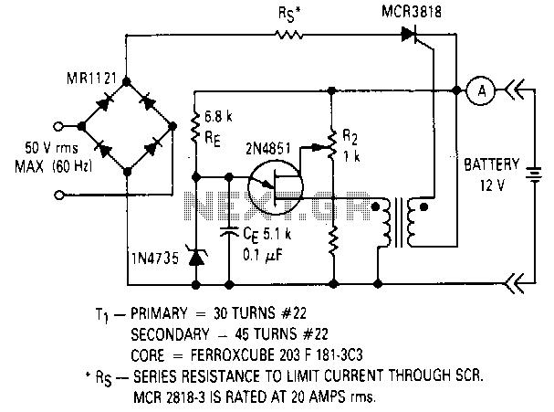

                                  But the circuit does look closer to this, using ujt
                                  The parts list I refered to was this one, the (su316) might have different meaning in this case

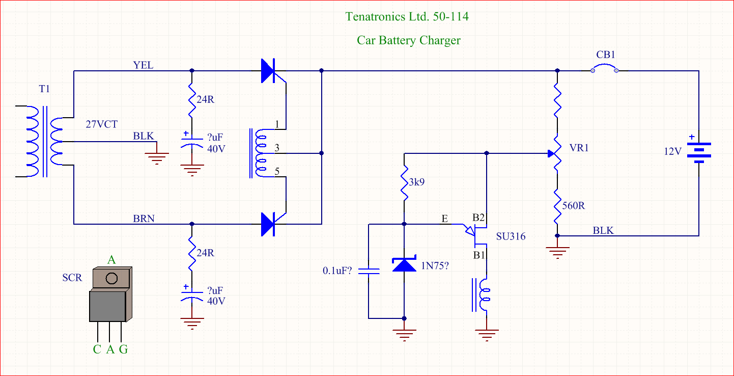

                                    I drew a schematic and it looks like a voltage-controlled oscillator that pulses the SCRs (trigger transformer). I'd guess it's a UJT or PUT.
                                    I think the circuit has some issues... The snubbers are sort of terrible to have AC on electrolytic caps, and the zener should get supplied not from the trimpot. Unless I have drawn it wrong.
                                    Why are the SCR's on an insulator but not the mounting screws? I think that would short the power transformer?

                                      Thanks everyone for your efforts...
                                      I didn't get notifications for these updates for some reason.
                                      I drew this over coffee this morning.
                                      This is a little more rudimentary than yours but here is my rendition...
                                      edit...made corrections to original drawing
                                      edit: adding pic of back of PCB lit up to see traces better.
                                      The SCRs are isolated but from the back side.
