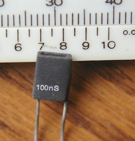

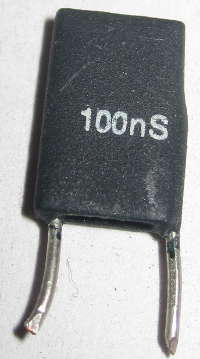

    New component ID of the day...
    Not sure where I got it, I did not desolder it, so I haven't the foggiest idea where it came from.
    The reverse side looks no different, except it's all black with no printing on it.

    looks like an old cap, did you meter it?

      It is a transient voltage suppressor ( TVS diode as same as zener diode ), responses time is 100 ns, faster than Varistor.
      It should come from a power supply board. When you were collected useable parts from it, you cut it with a needle-nosed plier and you may not know how to use it or you don't need to use it, so it’s been in your parts box since then.

        That's the problem, I didn't collect it, someone else did
        If it's a transient protection diode, aren't there more useful information than just response time? Like perhaps voltage?
        I haven't metered it at all yet, in fact, I'm not sure where it is. I'll have to go find it...
        My thinking is that it's some sort of hybrid... what's inside I have no idea.

          It could be a capacitor, 100nf, here is another one: https://www.edn.com/electronics-blog...ird-components
          I Have a suspicion it could also be a 100nS delay line

            I don't know either, probably save ink. you know, right now, new SMD resistors don't even have any marking.
            "High Power TVS Overvoltage Protection Diodes"

              ...the unusual hollow construction...is because the TVS is PN-NP two flat PN junction (diodes) combined together
              The problem is that the author was not sure what it was. I'm pretty sure it is the PN Junction semiconductor TVS diode.

                Aha...Thanks R_J, that was what I needed to see. After losing my main portable capacitance meter to failure of some sort (ugh... got tired of tracing tracks) I haven't tried it on a capacitance meter. Will see how it shows up on my Sencore.
                So... answer is... a thermpacitor! Well, need to check it to be sure.

                  the thermistor is a resister no needs to be so big (thick).
                  ...shows up on my Sencore....you're an old tv man? Like me.

                    No clue. Thermally sensitive capacitor so it will offset the thermal effects of something else. Might be useful if someone doesn't want to add a thermistor.

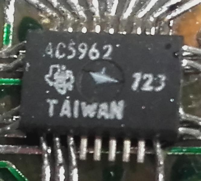

                            Saw this on a local forum. Looking for a datasheet.. there are some clues about the IC which I can post later.

                              I found the forum (hardwarebg) where your digital clock ic is from but, was unable to find any information on that TI chip.

                                Yes, indeed that's the forum.
                                Looks like this is some kind of a watch display controller, but nothing else comes out from the markings on the IC.
                                It's not my project/problem, but just got surprised how the Internet has not heard about the AC5962
