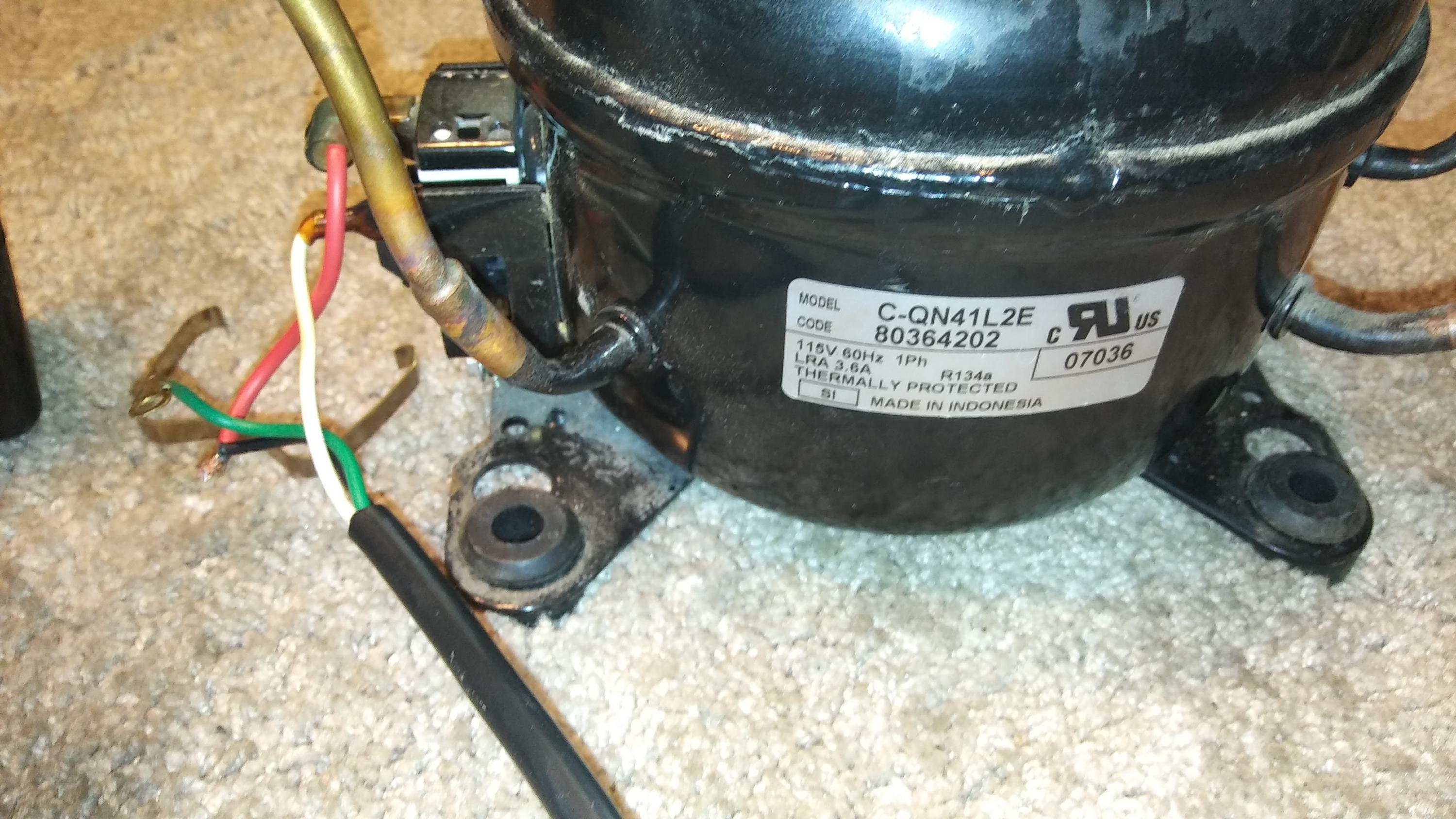

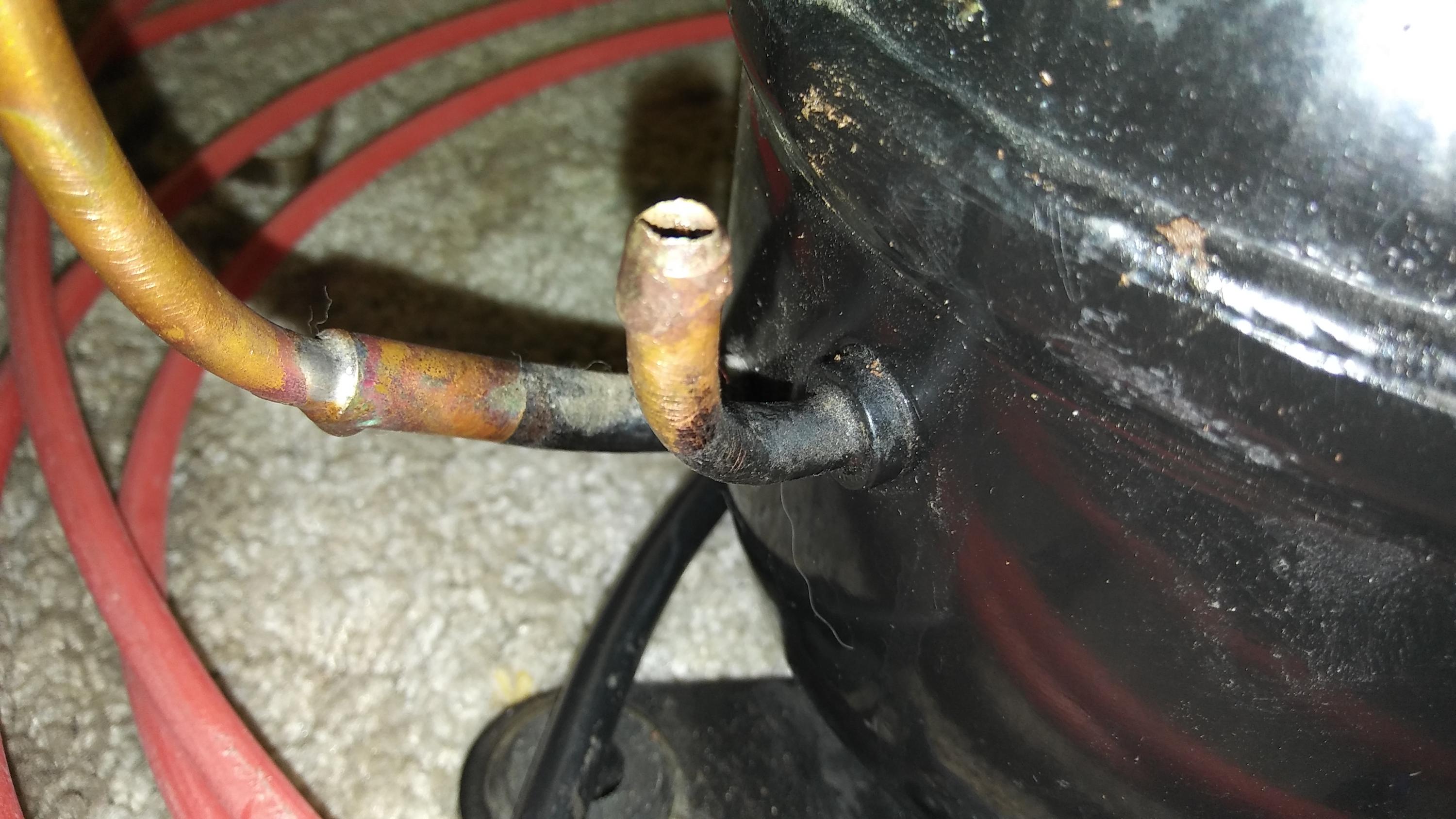

    I need Air Supply Systems in my Workbench.
    (1)Vacuum Air Supply System
    (2)Compressed Air System
    (3)Exhaust Air system

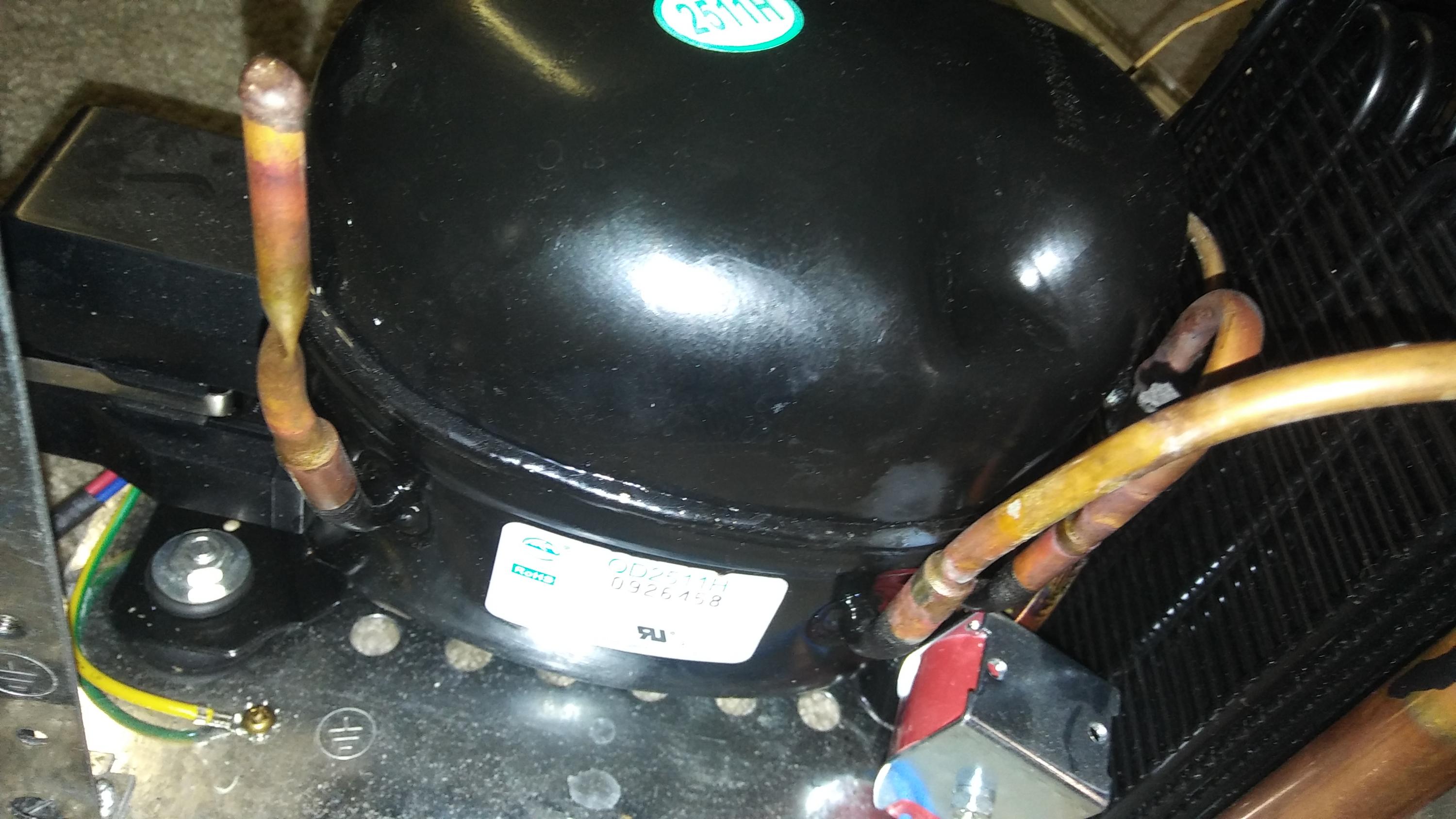

    I don't want to spend too much money to achieve this goal. At the same time, I don't want to use an unwieldy compressor of the refrigerator, so I went to buy a small portable ice maker machine over the thrifty store, paid $4.98, for my vacuum, compressed and exhaust air System.

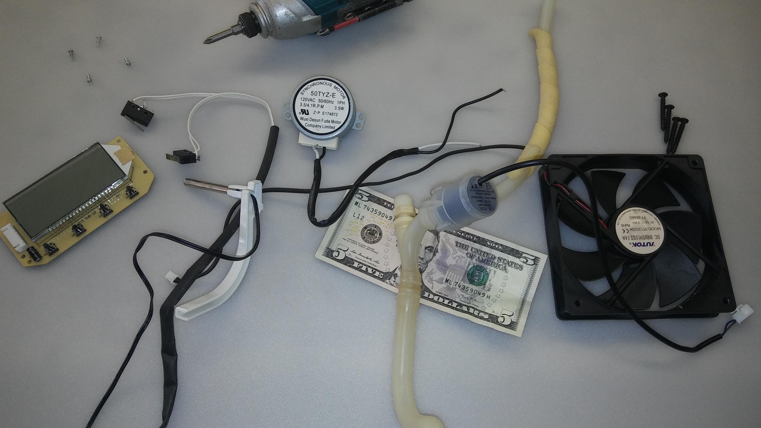

    I opened it but I have two questions?

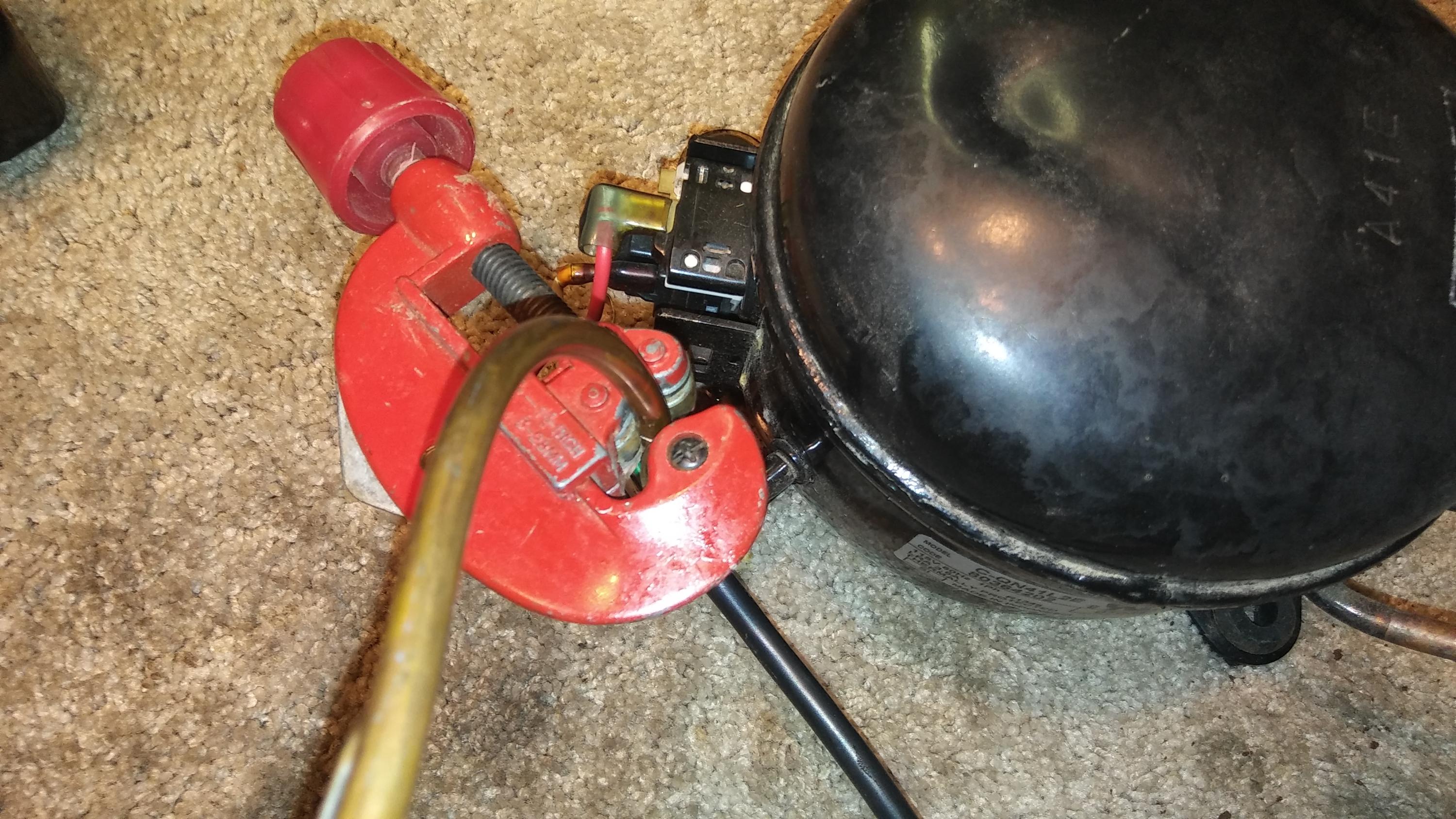

    (1) How to recycle refrigerant In this small compressor? or just use pipe cutter?
    (2)4-Way Solenoid Valve, This means it has a heating supply system? Can I use this valve to make a switchable air blow gun and vacuum solder gun in one?
    Vacuum Air Supply is mainly for placement of SMD parts, Compressed Air System is mainly for the automatic adhesive, and solder paste deposit system.

    Re: Air Supply Systems

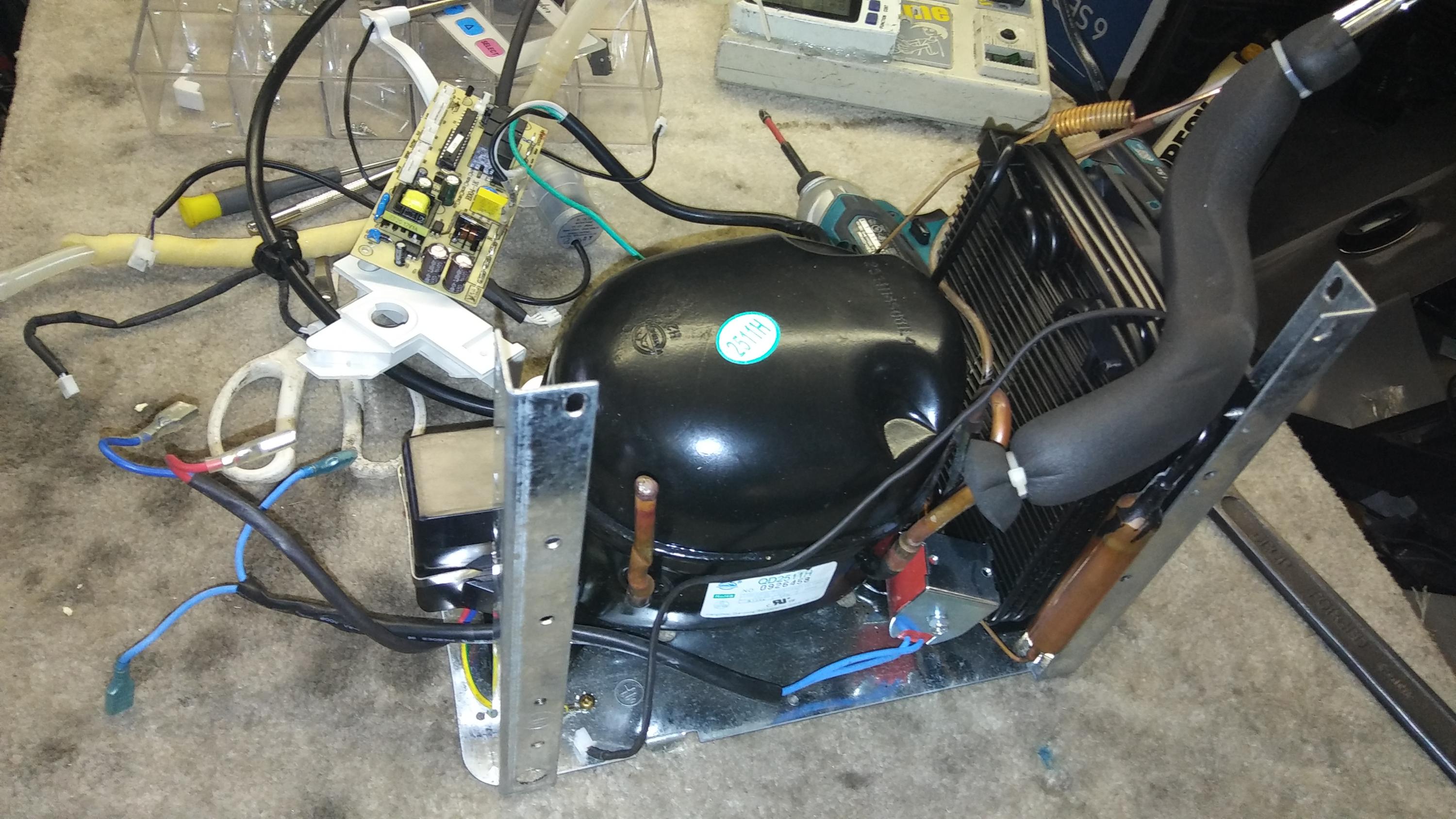

    You can do it but it will not last long because the compressor is made for refrigerant not for air when the oil in compressor mixes with air causes the oil to become an ascetic and a tack the winding in the compressor motor
    In a former life I used to do air conditioning and refrigeration work for a living
    The EPA state a very small amount of refrigerant can be released into the atmosphere less than a pound use your own judgment on this but it would be better if you had some one recover the refrigerant
    The valve that you are taking is the same way in that valve will not last because it uses the compressor oil is used to lubreacte the rubber seals in the valve plus it uses the pressure to switch from one side of the valve to the other side of valve
    You should use a small air compressor for this

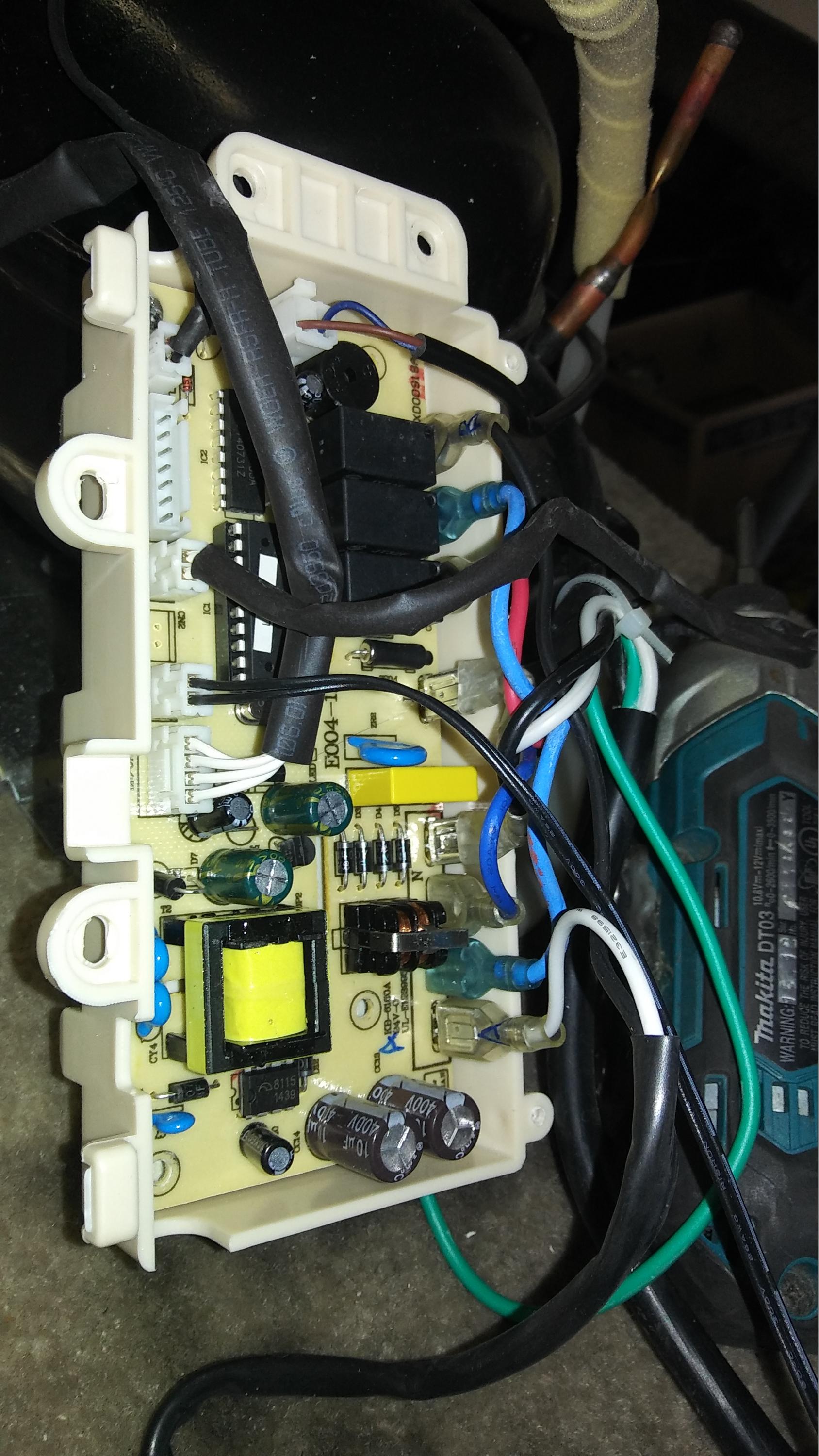

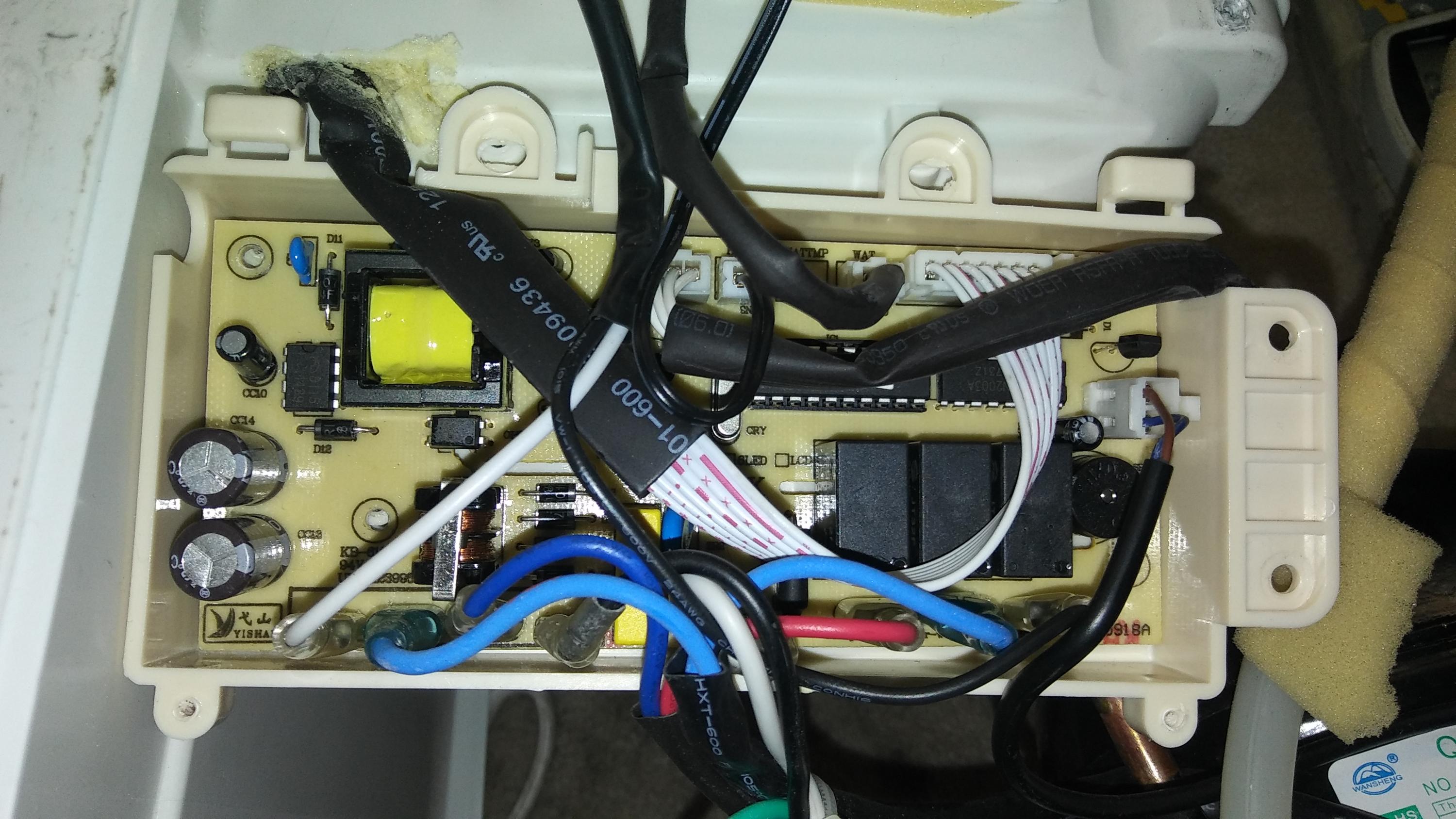

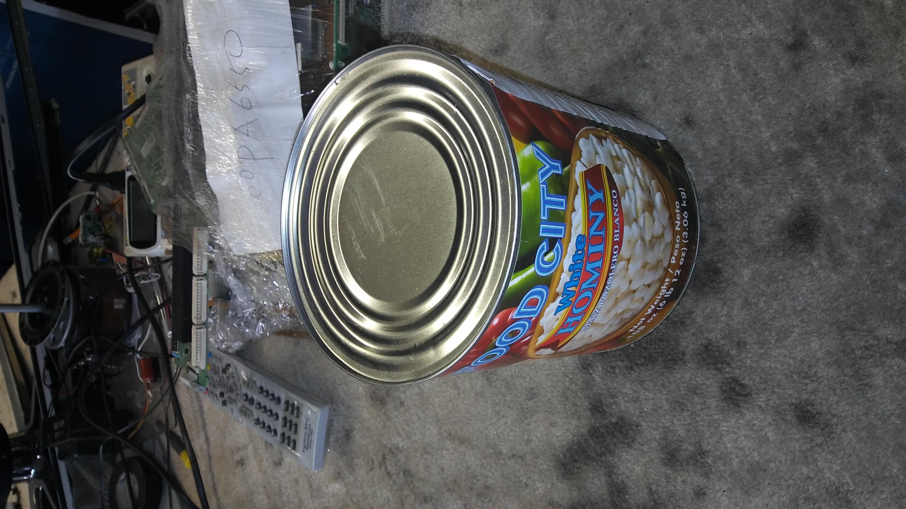

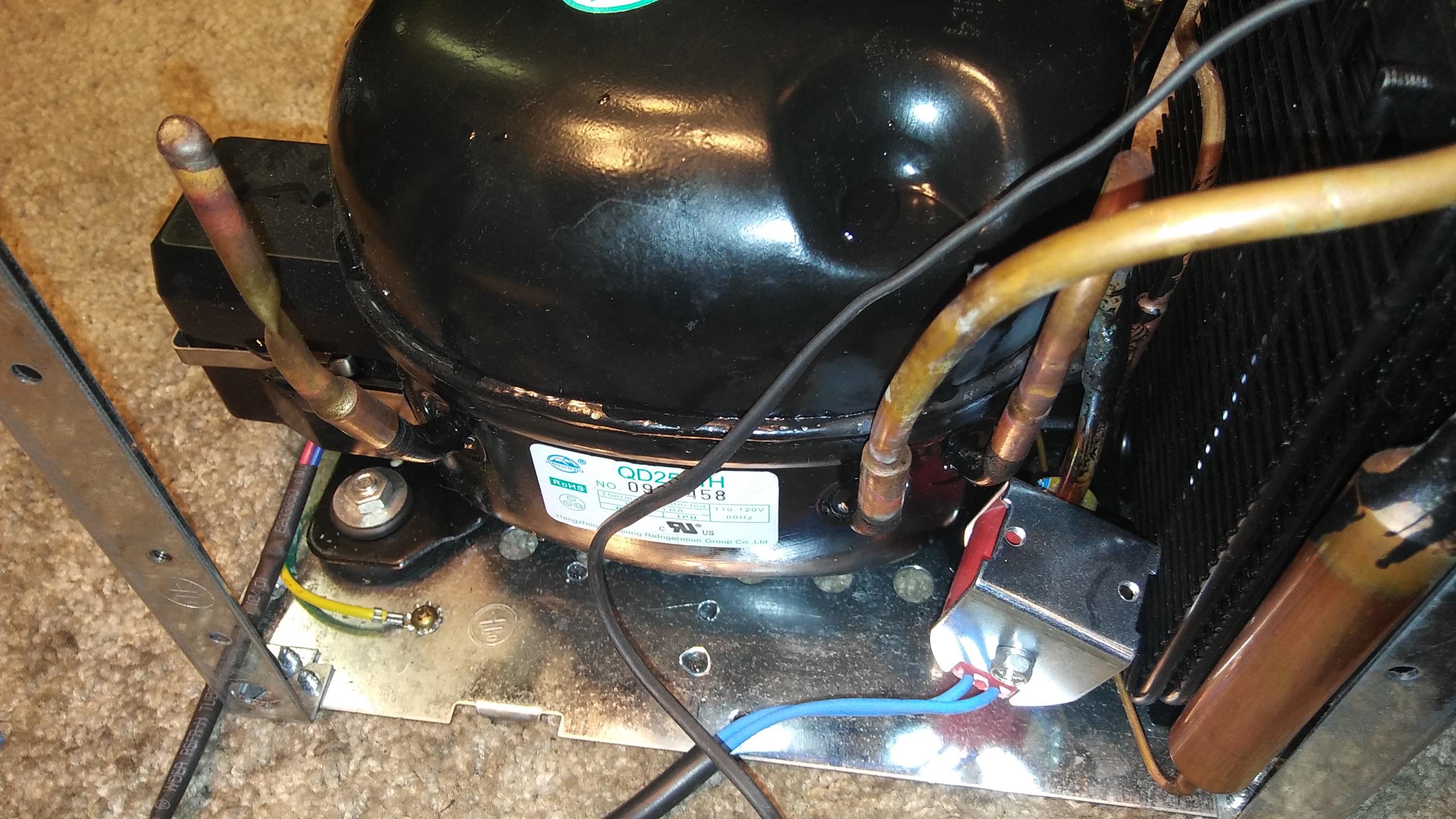

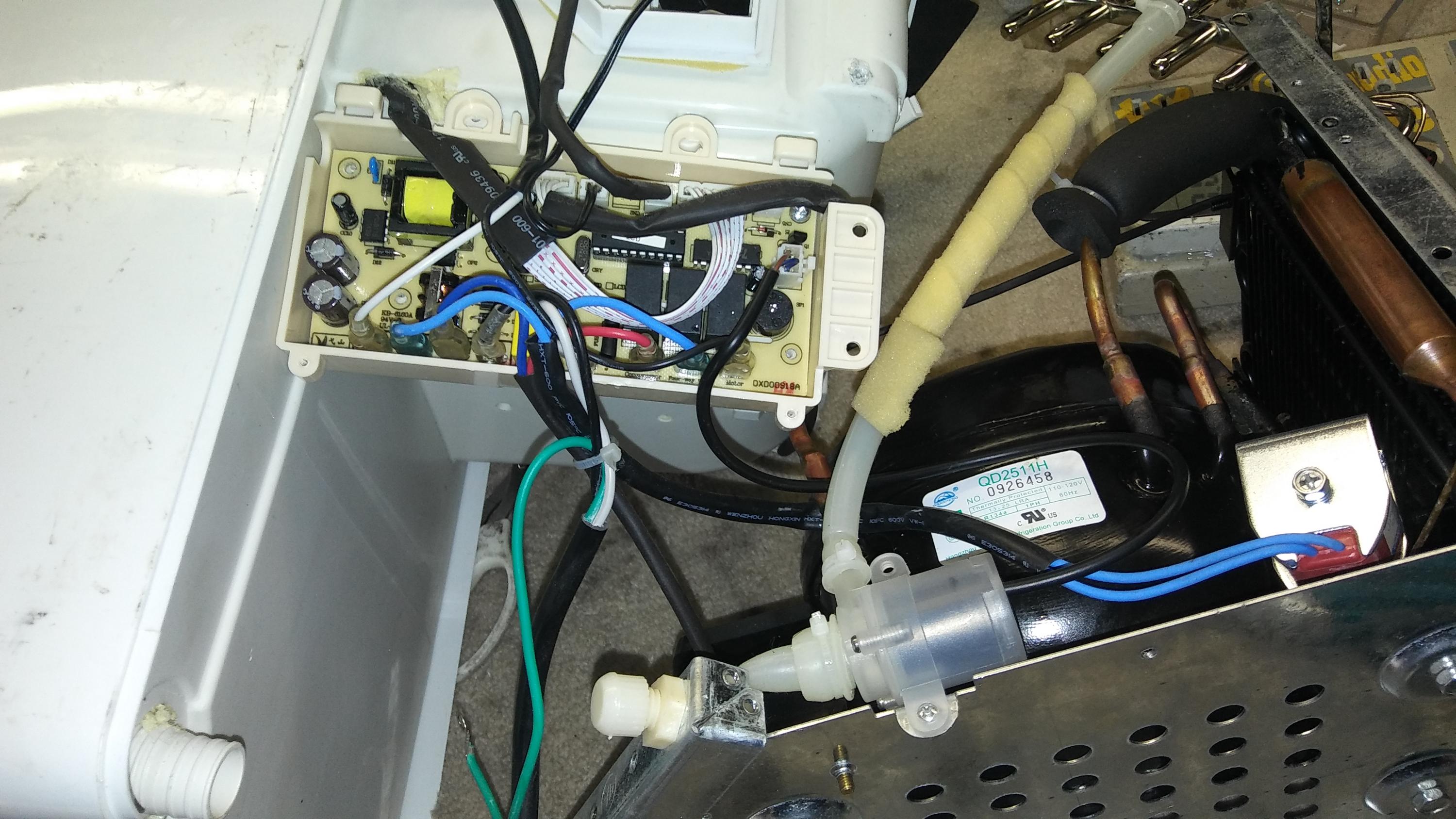

          Yes. is that what I'm going to do next, l will use the canned food cans as reservoirs for both pressure air and vacuum air.

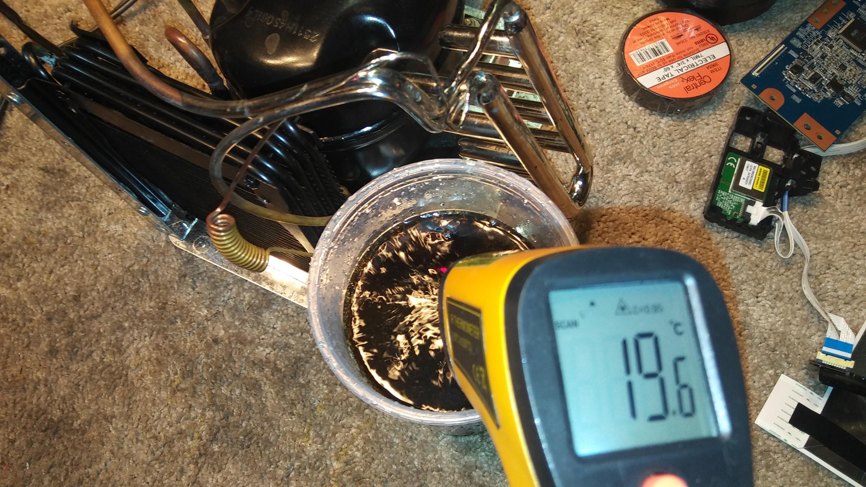

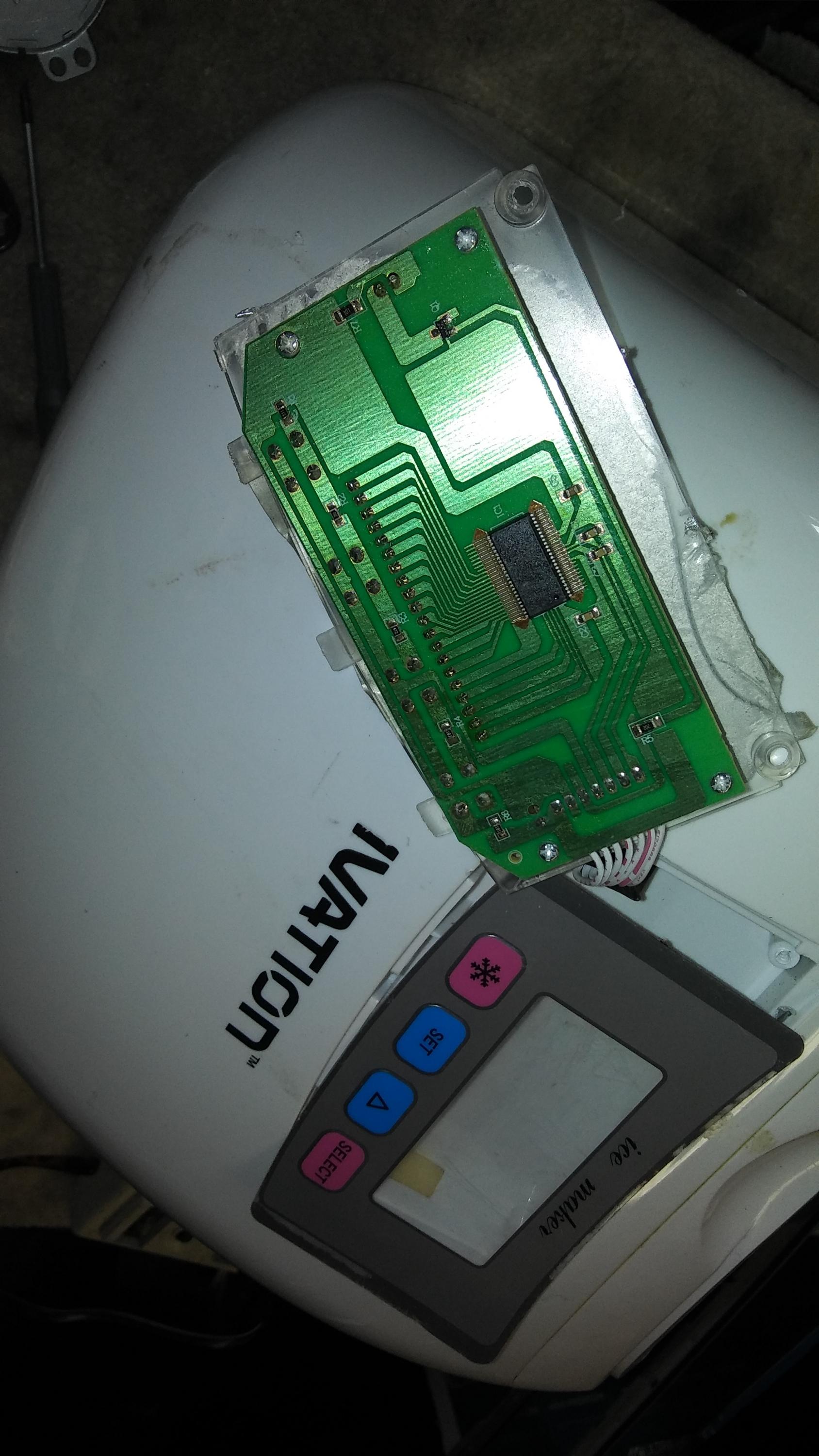

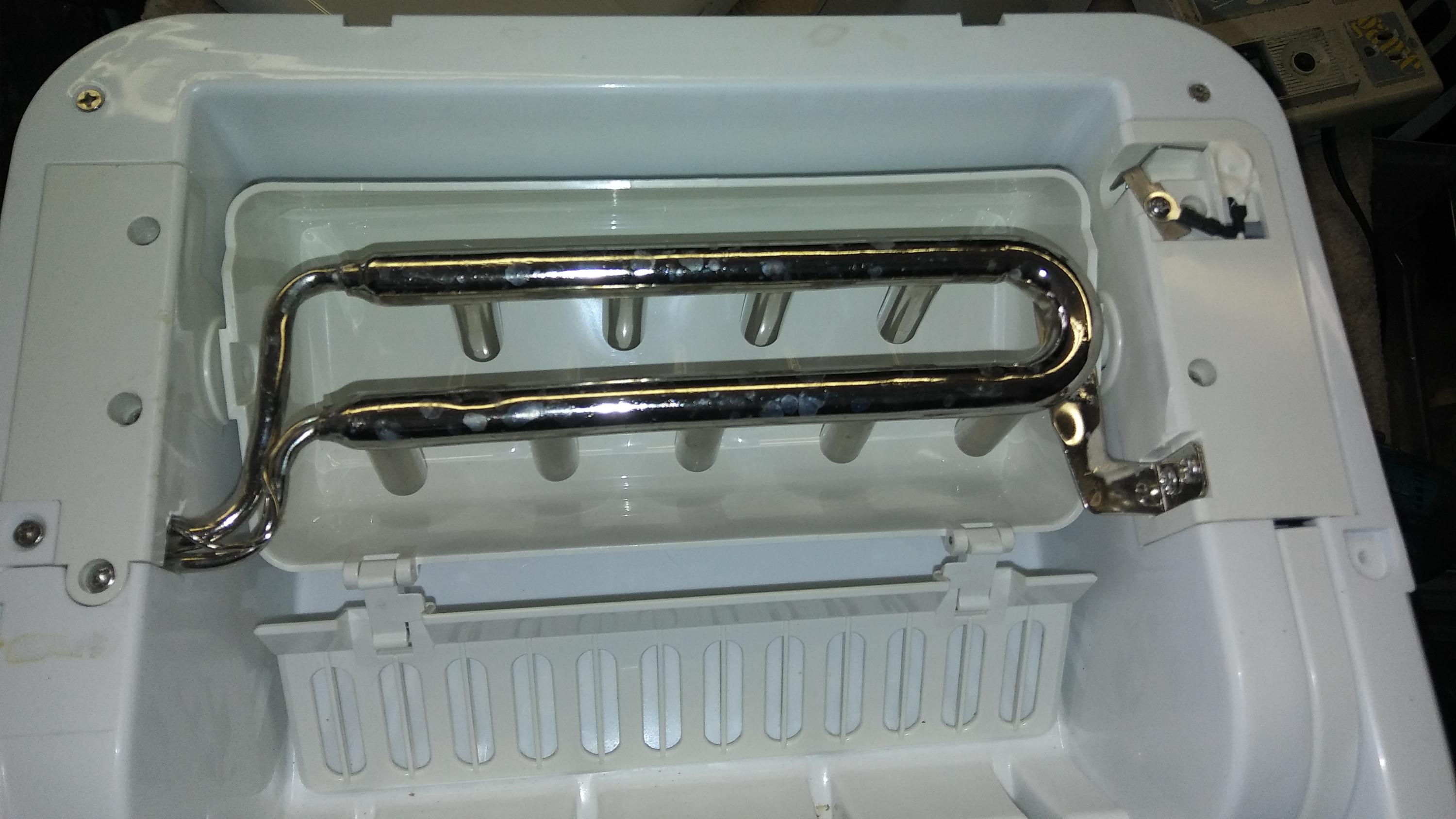

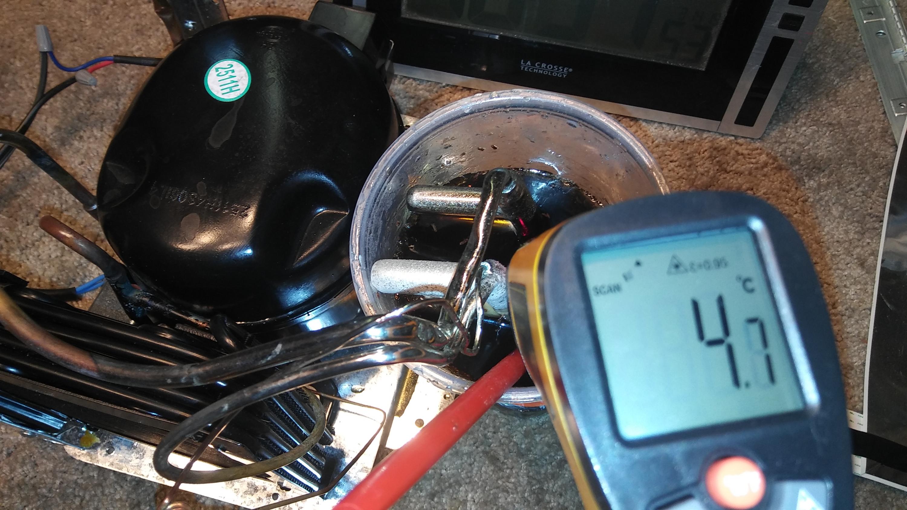

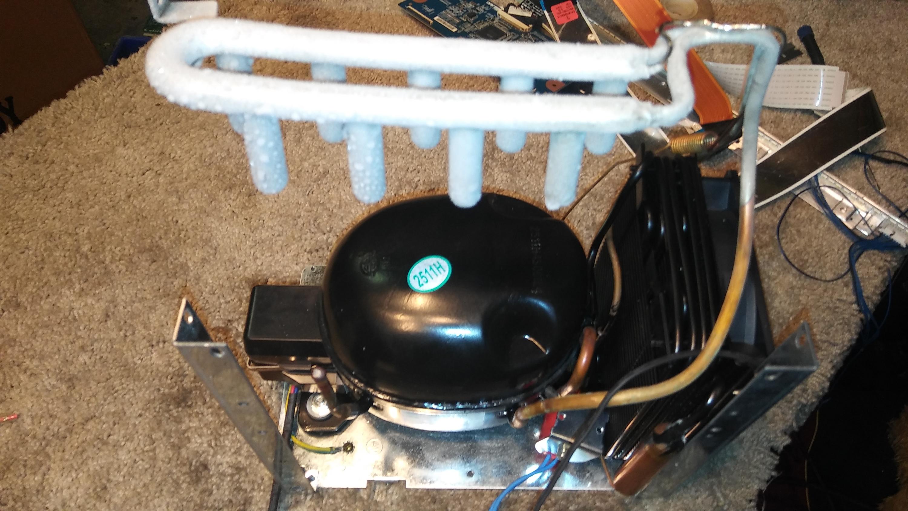

          The problem is I found out the ice maker machine is working perfectly and 4-way switch is for the Heat. I would like to use it to make my organic ice cream machine, don't worry, I will find another one.

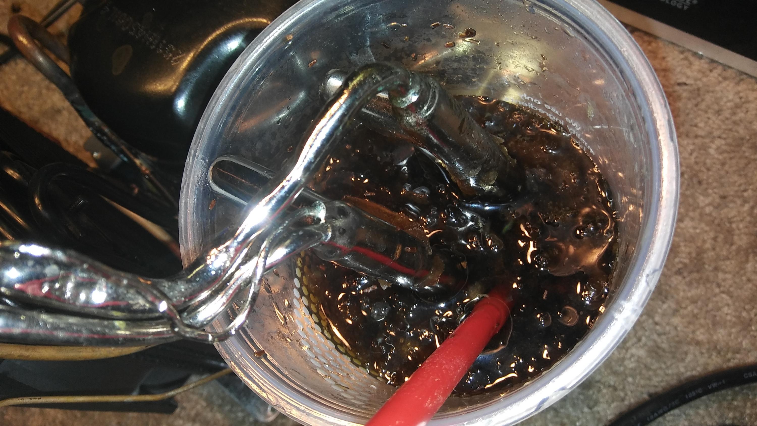

          Picture 2) It only took 1 minute to have ice on it and the machine works quietly and I have to put my hand on the machine to know that it is working.
          Four ways switch and compressor (run on 5.12A) are AC 110v.

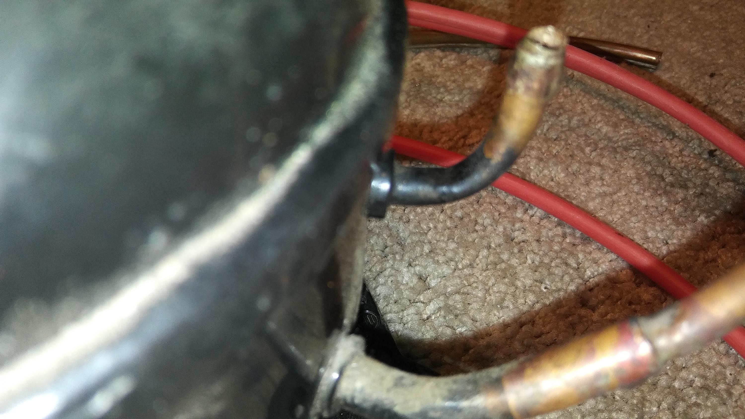

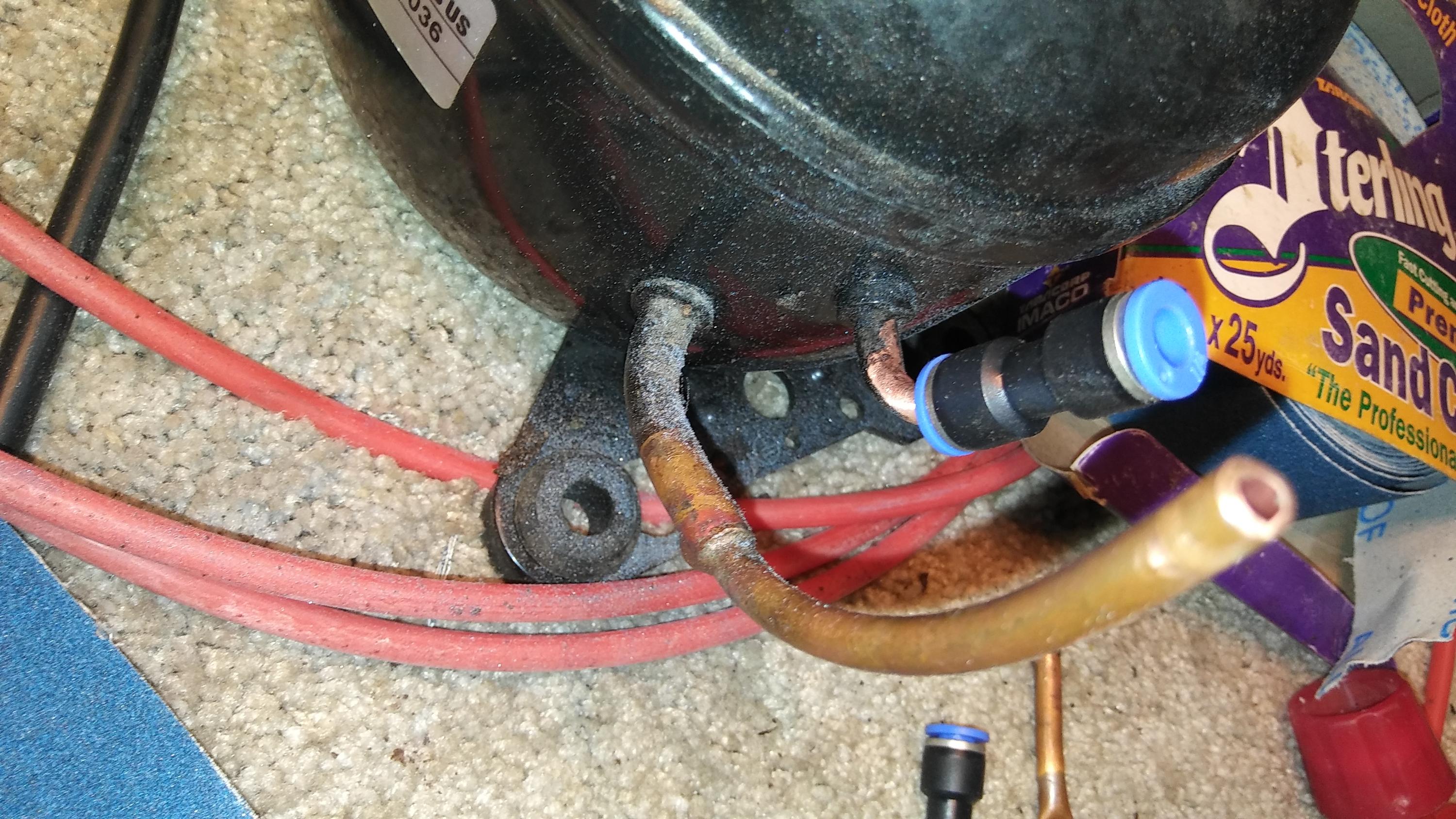

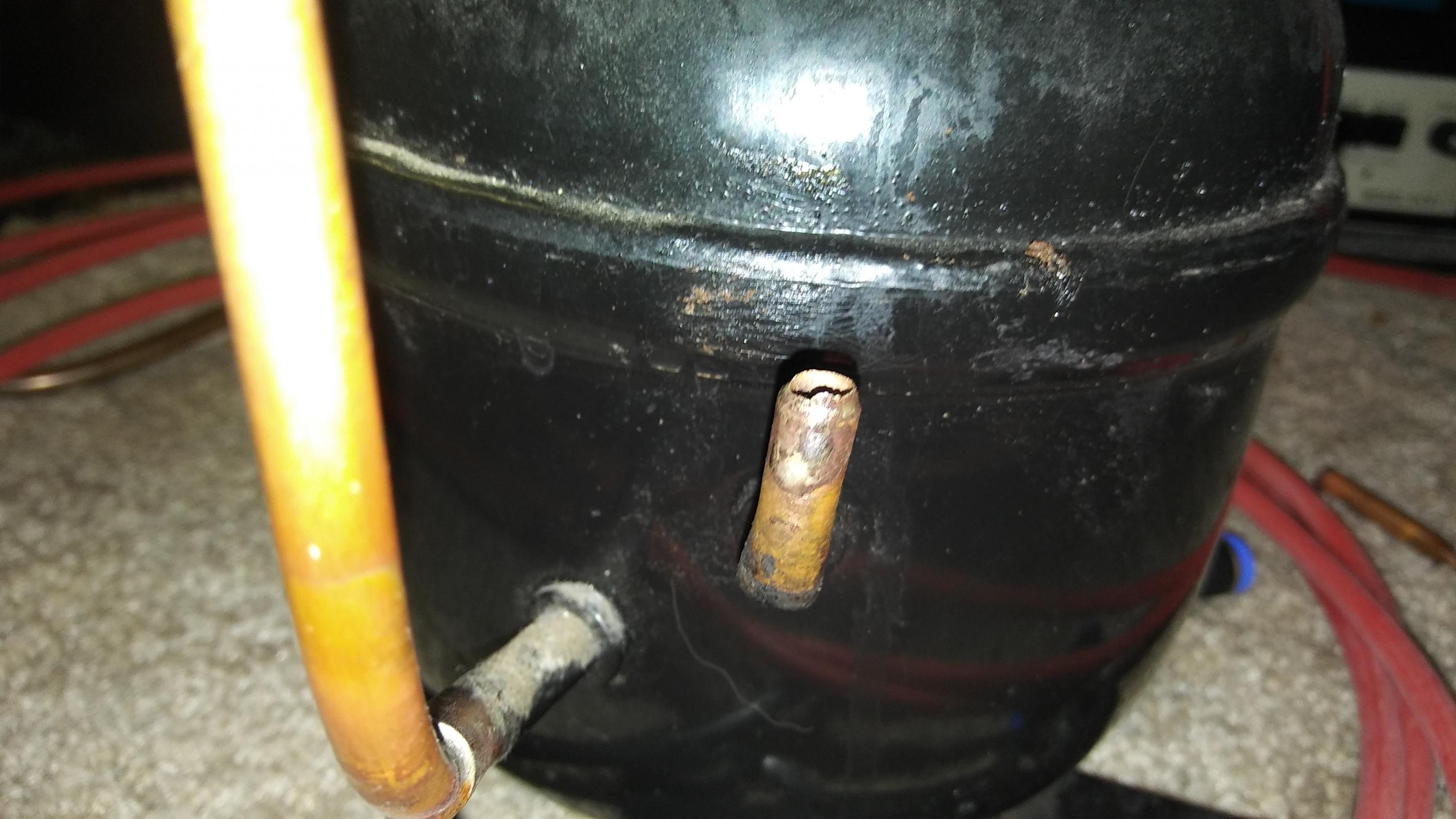

                  One more question is this tube attached to the compressor what is it used for and what can I do with it? Picture 2 at left side.
                  • R_J
                    • Jun 2012
                    • 9579
                    That tube is used for charging the system with freon. once charged it is pinched, the tube is cut off (usually has the valve on it) and soldered closed.
                    It can be left asis

                      Thank you, Mr. sti
                      Then, this will be a good lubricant oil injection port after we can install a bicycle tube gas valve on it.

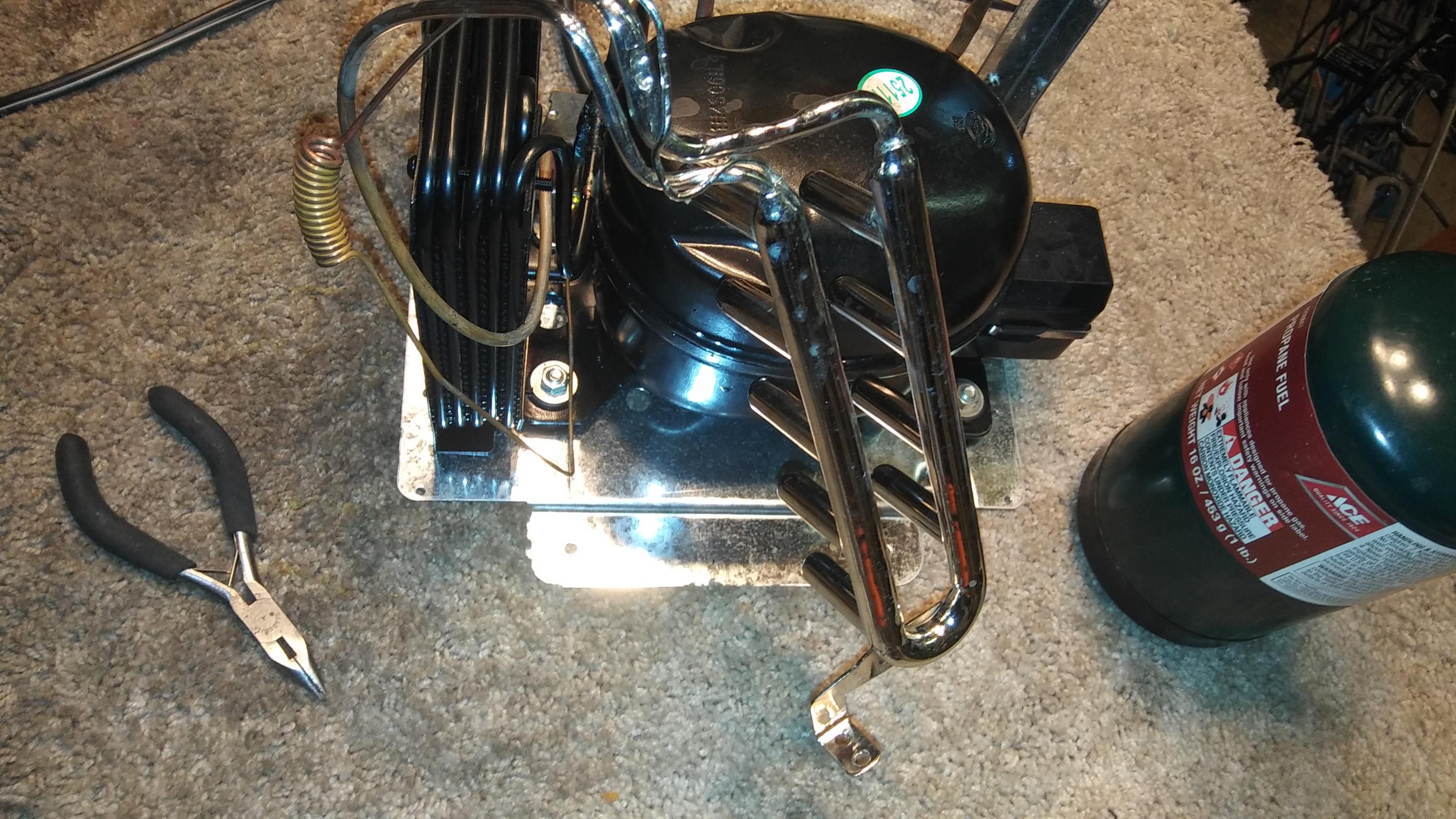

                        Be wary of burst pressure ratings on those (likely UNRATED containers).
                        An alternative might be an expansion tank for a water heater -- they're definitely pressure rated and probably good to at least 80psi (which is a nominal municipal water pressure in most areas). One and 3 gallon sizes being fairly common.
                          • 31139
                          or an empty fire extinguisher / gas bottle for NOS / CO²

                            Use an old propane or freon tank or one of the smaller 16oz canisters
                            If a compressor starting
                            scared the hell out of me
                            what will happen to you when a food can explodes/implodes?

                              Thank you, 16 oz Propane Fuel Cylinders would be very suitable.

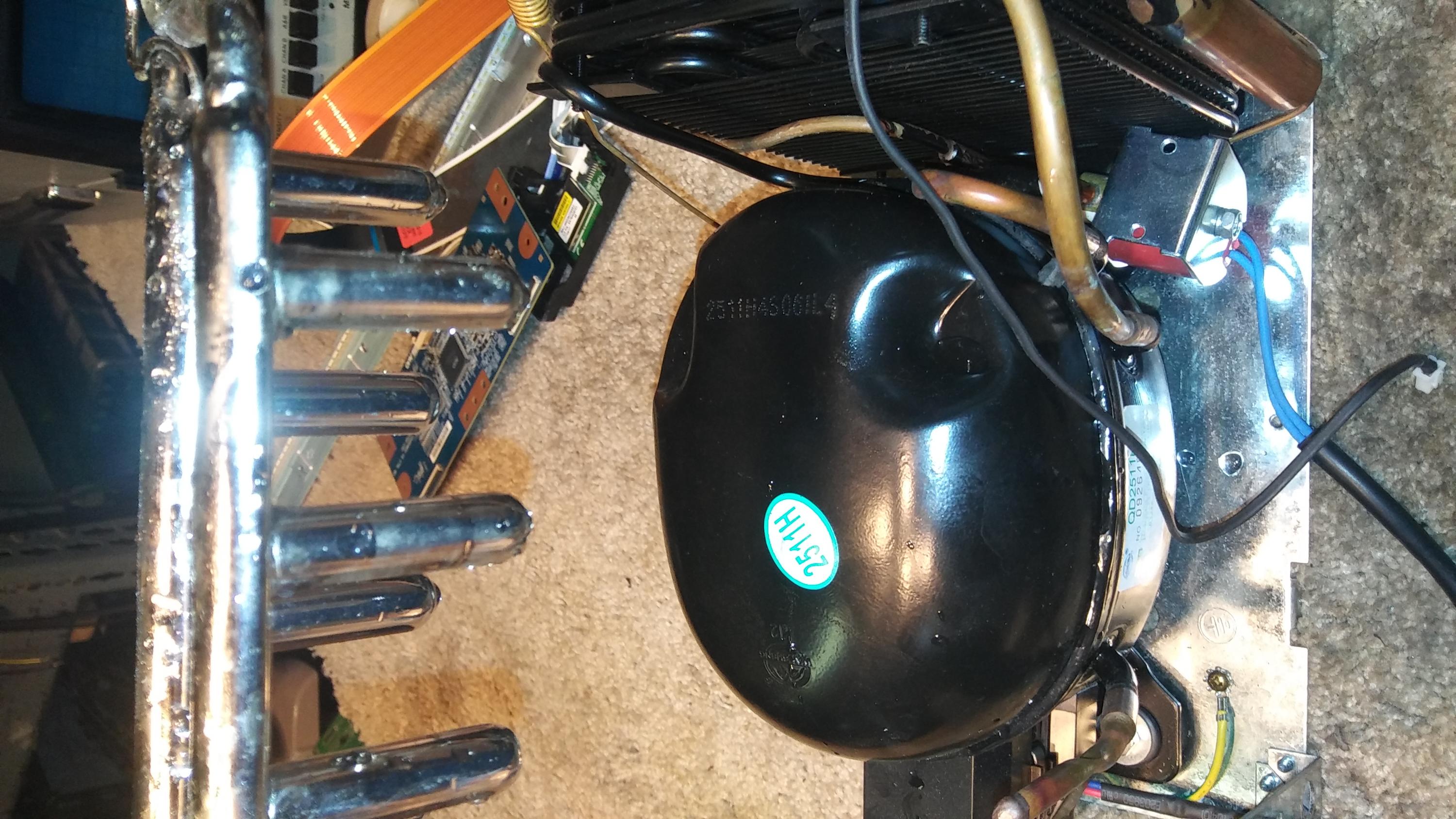

                              But, Sorry everyone, I changed my mind, because I knew that is working, so I can't cut the cooling tube, I mean, I am a repairman, How could I break a good thing deliberately?

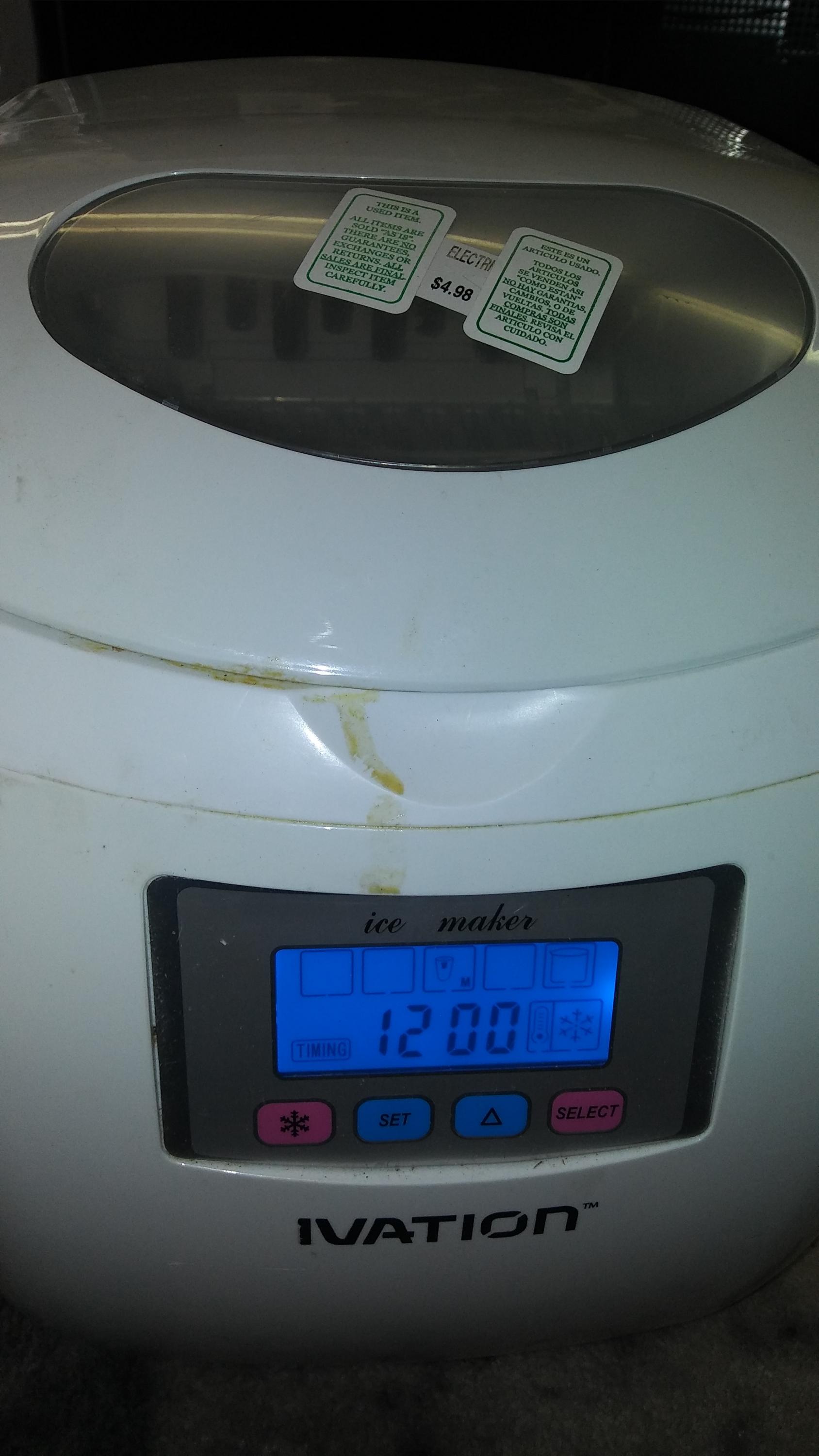

                              So, I made the biggest decision in my life.....I decided to use this ice maker to freeze beer or drink for spring break...Yeah ...yeah... picture 1, 2, 3.
                              So, my plan is going to be suspended.
                              picture 4) Who can resist this temptation? with 100% Coke ice cubes floating on it. Can you imagine if that is beer?

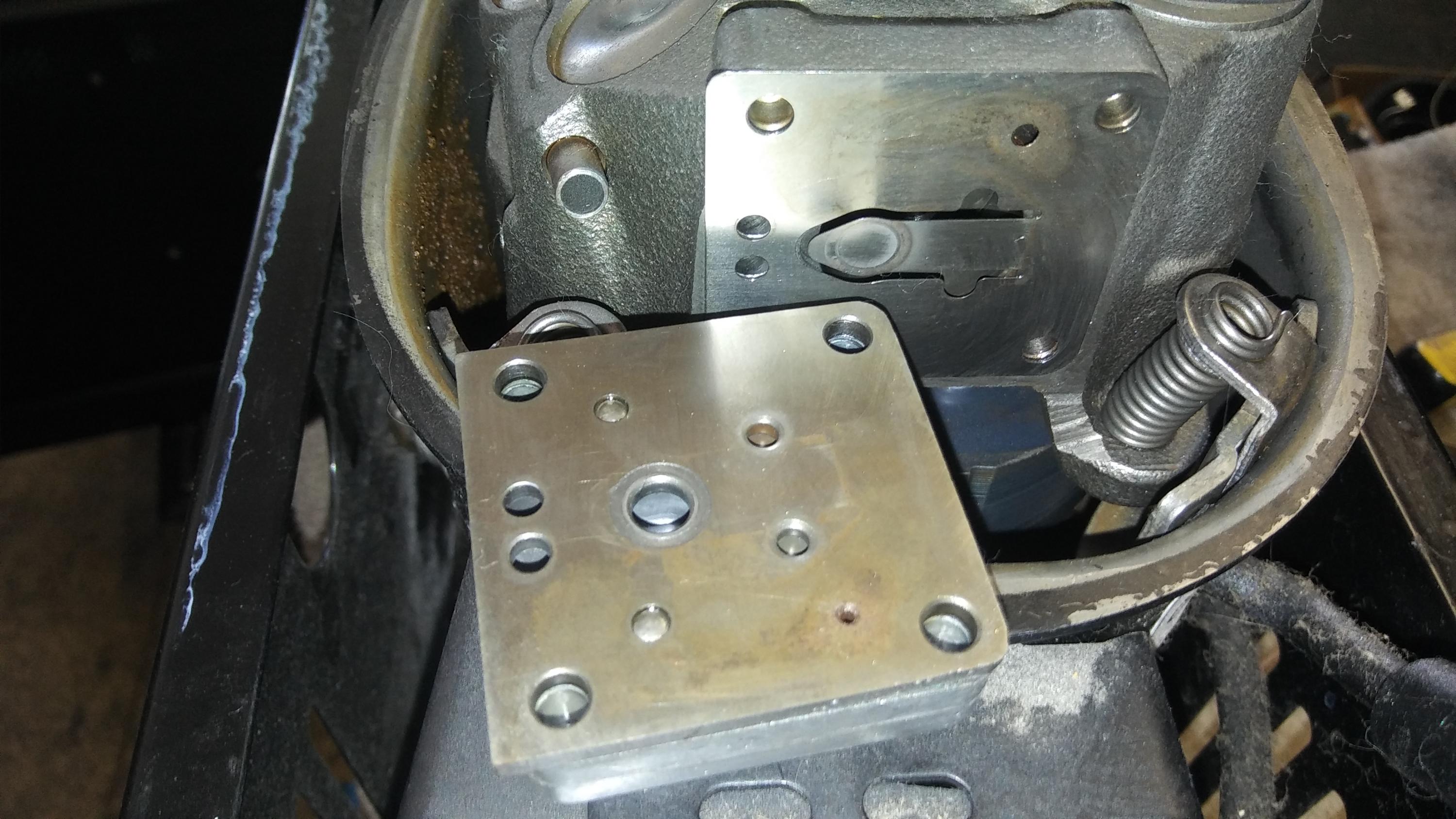

                                • 1991

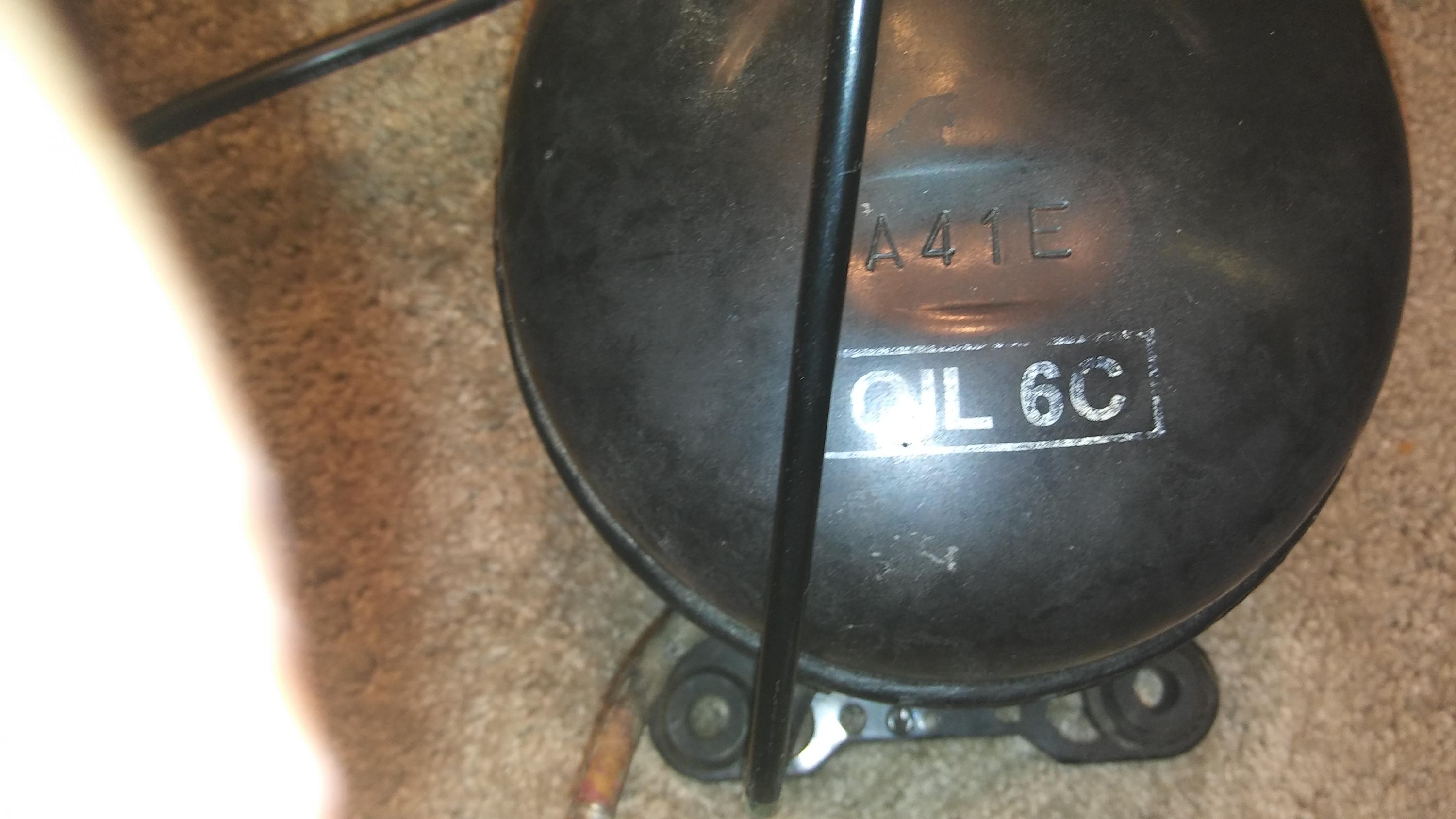

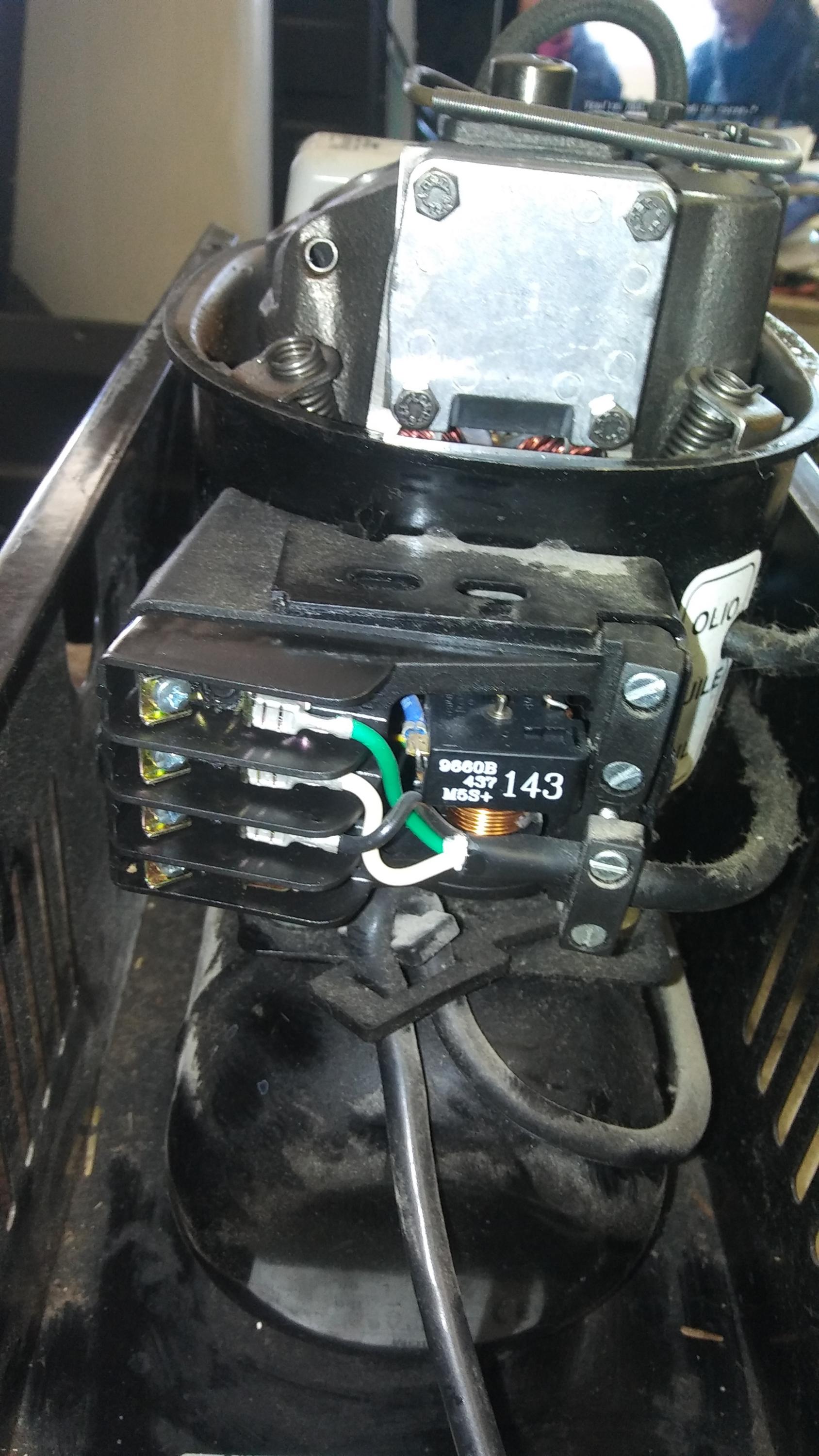

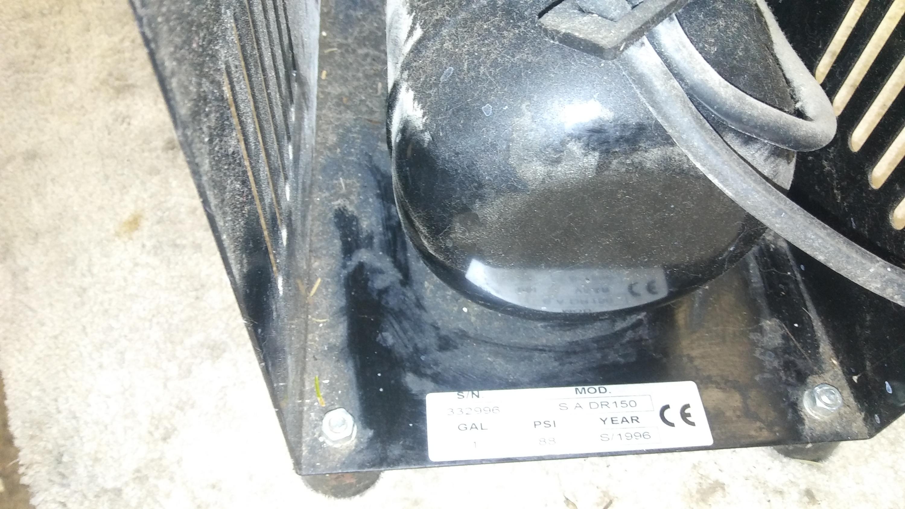

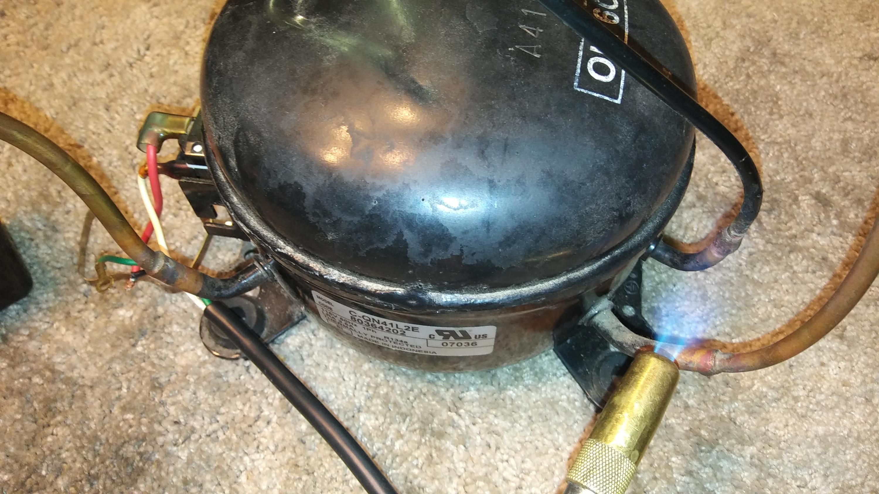

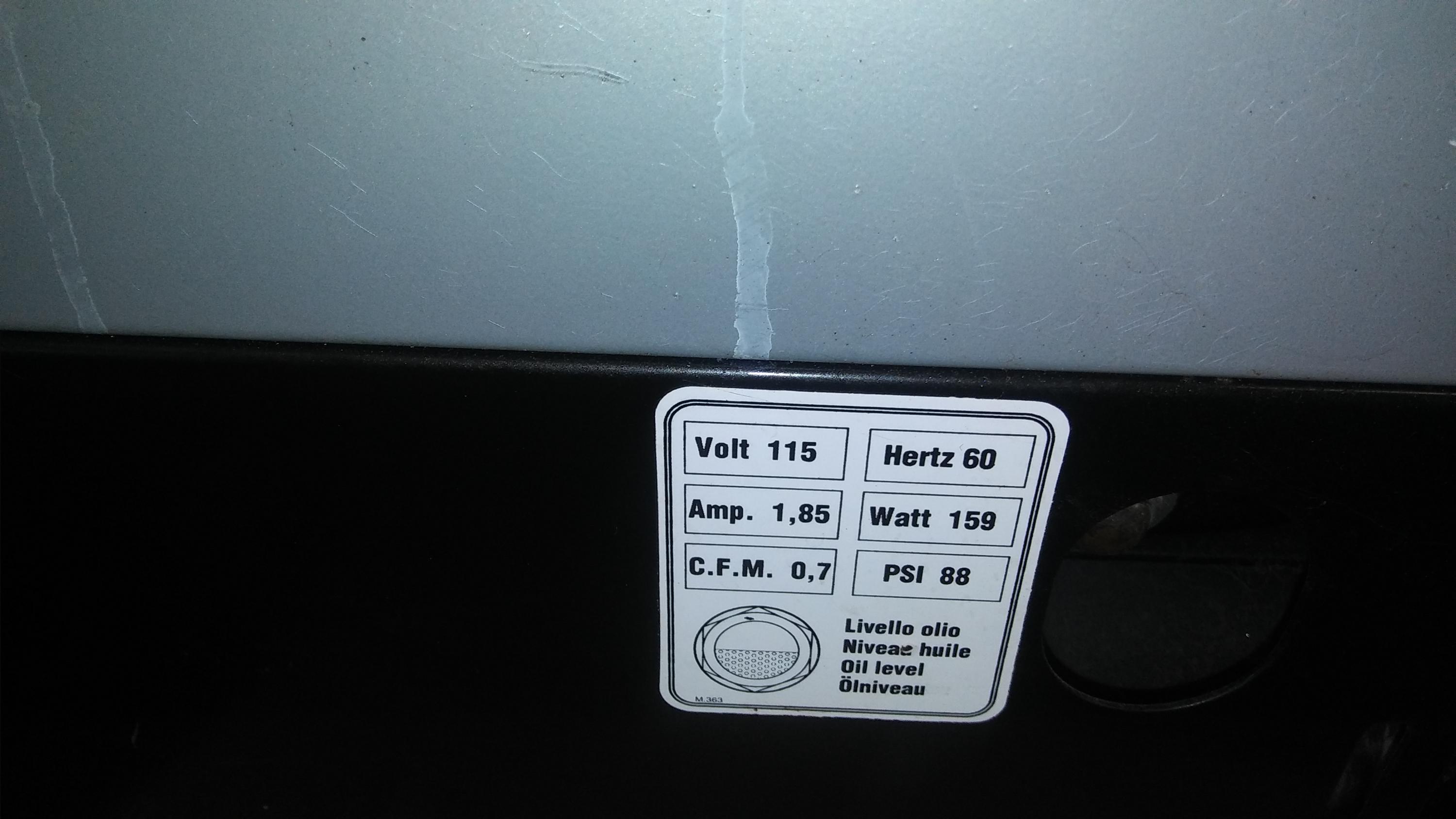

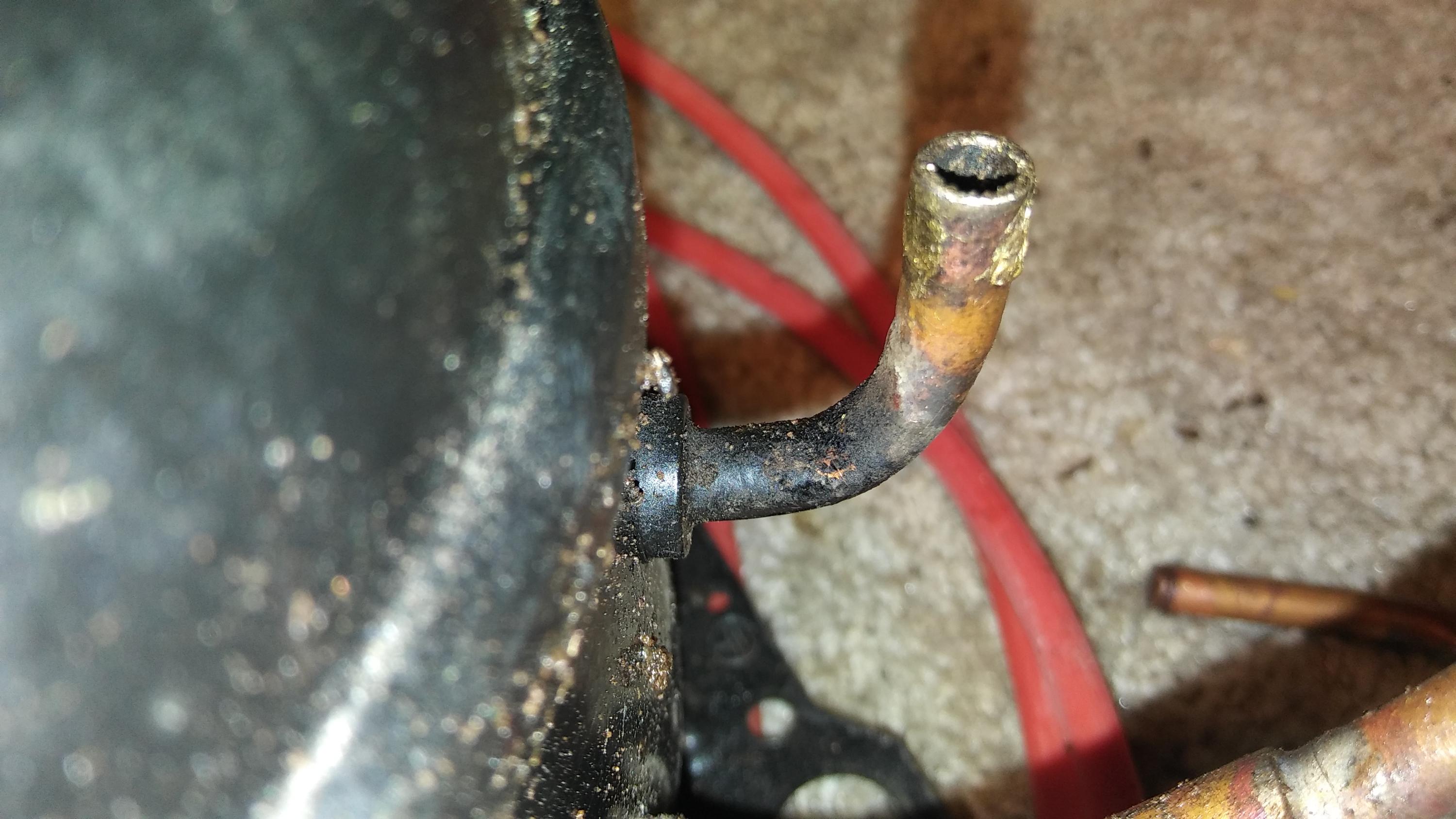

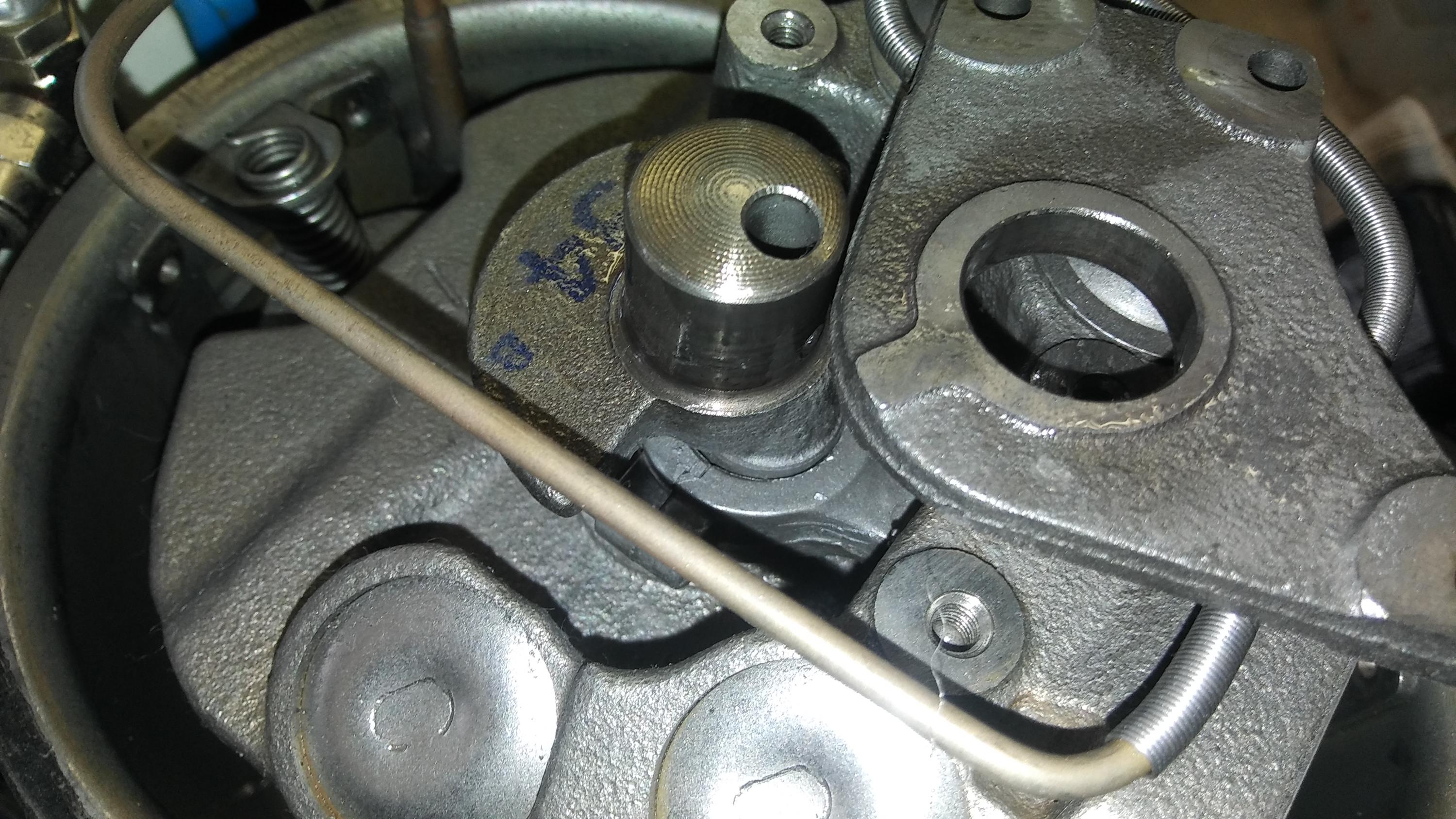

                                I found a working water dispenser compressor by dumpster diving, leaking water is the reason this water dispenser was thrown away.

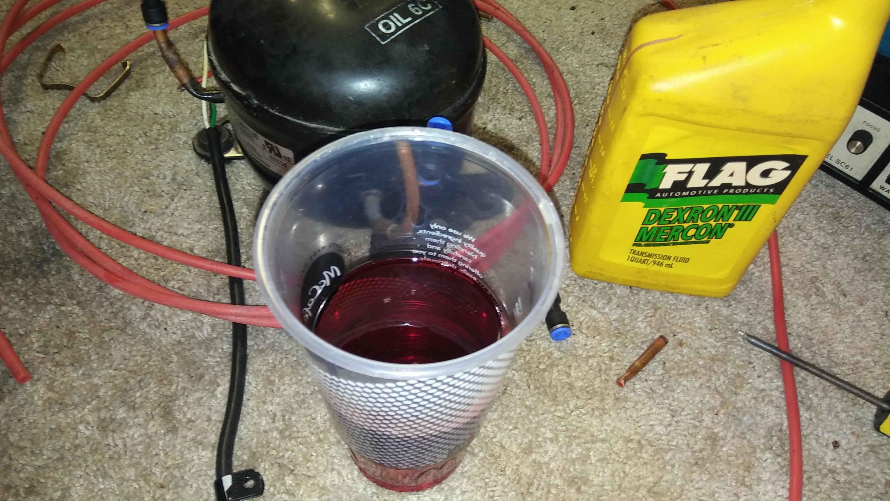

                                I have questions? what is oil 6C (picture 2)? can I use car transmission oil for this compressor?
                                This compressor has a PTC relay and a over-current protector, but, my question is why this compressor has no start capacitor? And I have no problem to start this compressor?
                                Where do I need to inject lubricant oil? inject from the tube that the original manufacturer sealed?

                                  I don't know why you're obsessed with using a refrigerant pump, perhaps it's all those youtube videos. Anyway the reason why it's not suggested is that these pumps is that they are closed systems, and the oil is part of the refrigerant being pumped. When you're using it as a vacuum or air compressor, it's no longer a closed system. You basically have to inject oil into the suction/vacuum stream continuously in order to meet lubrication requirements.
                                  You can go to hazard fraught tools and buy some compressor oil which should be fine for these. Except you'll get oil splatter everywhere as it's now an open system.

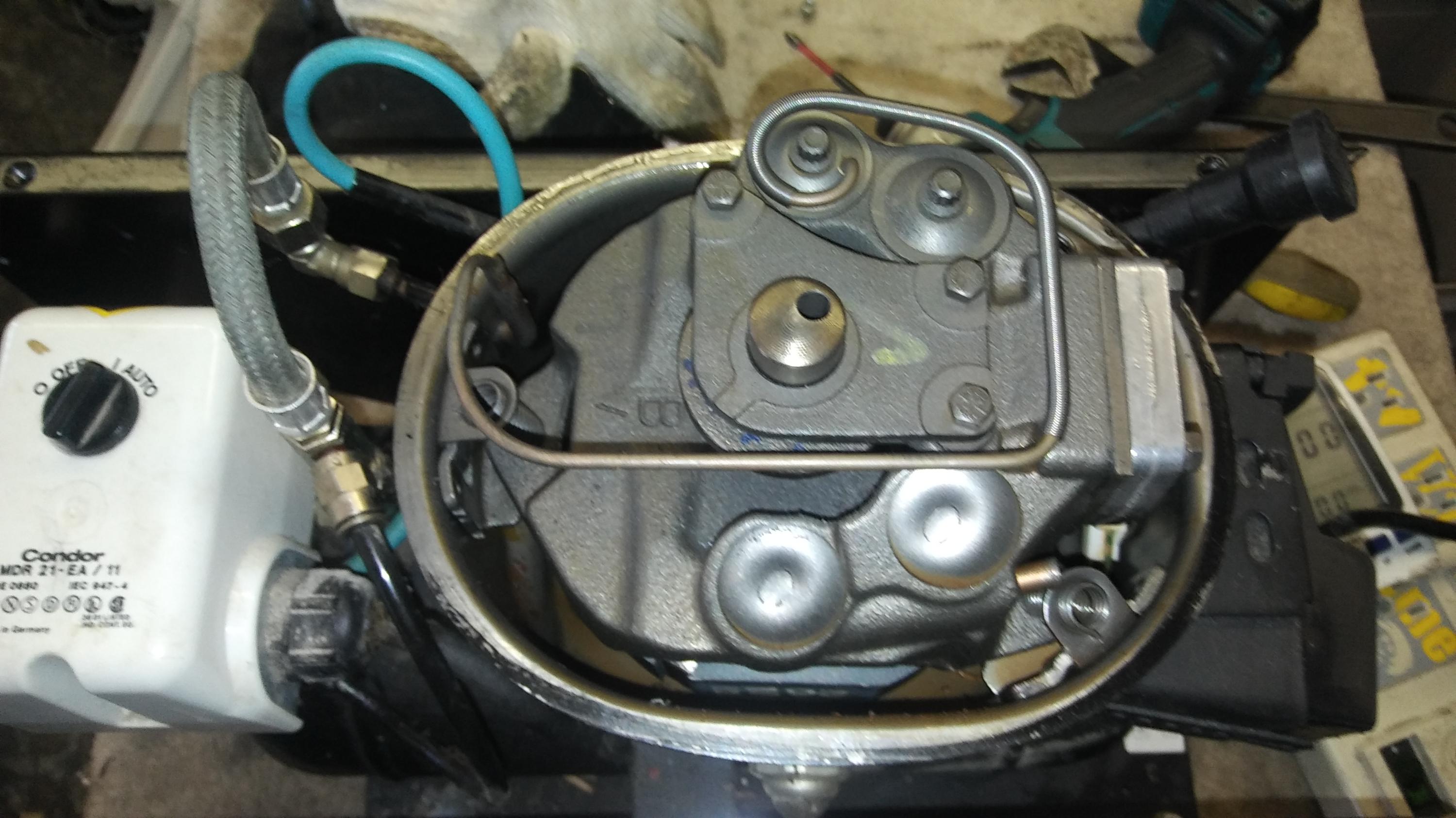

                                    ...I don't know why you're obsessed with using a refrigerant pump,...

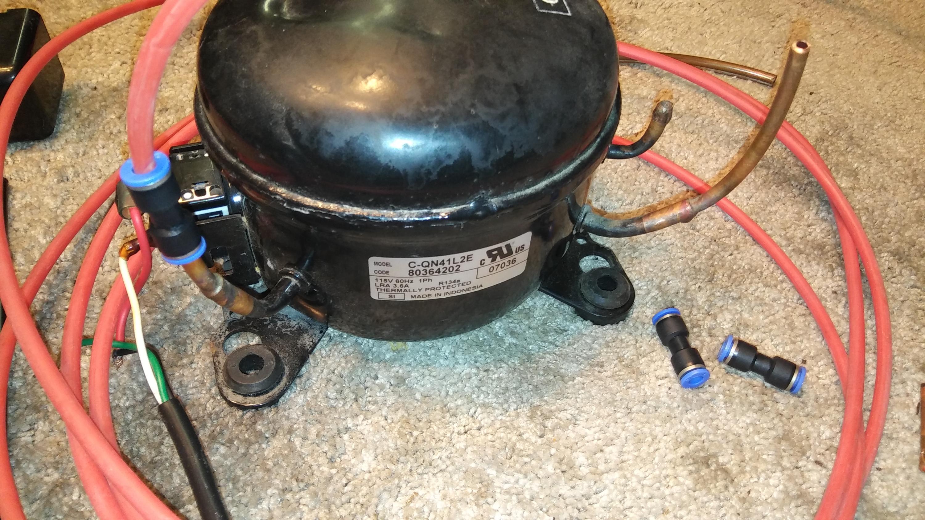

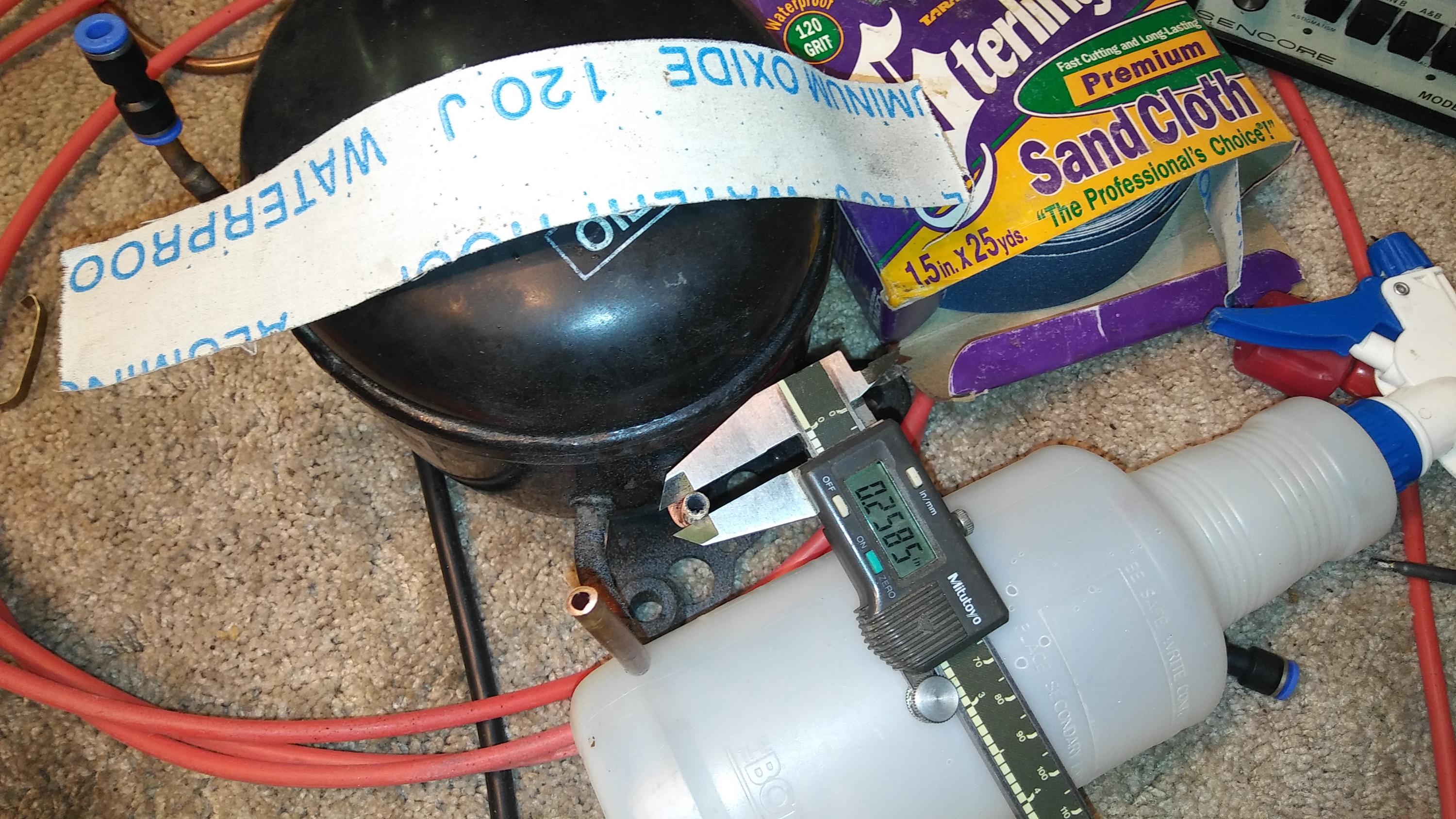

                                    It is because of the weight, I need a small compressor to fit inside my old PC case. It does not need a lot of power (CFM), a vacuum is to pick up the BGA or SMD parts, compressed air is to inject the solder paste, manly is to improve my BGA rework station. ( I thought about using 852D hot air station, inside has a vacuum pump, but I can't bear it noise.) I am not a perfectionist but I need it to be quiet in order to attentive work.

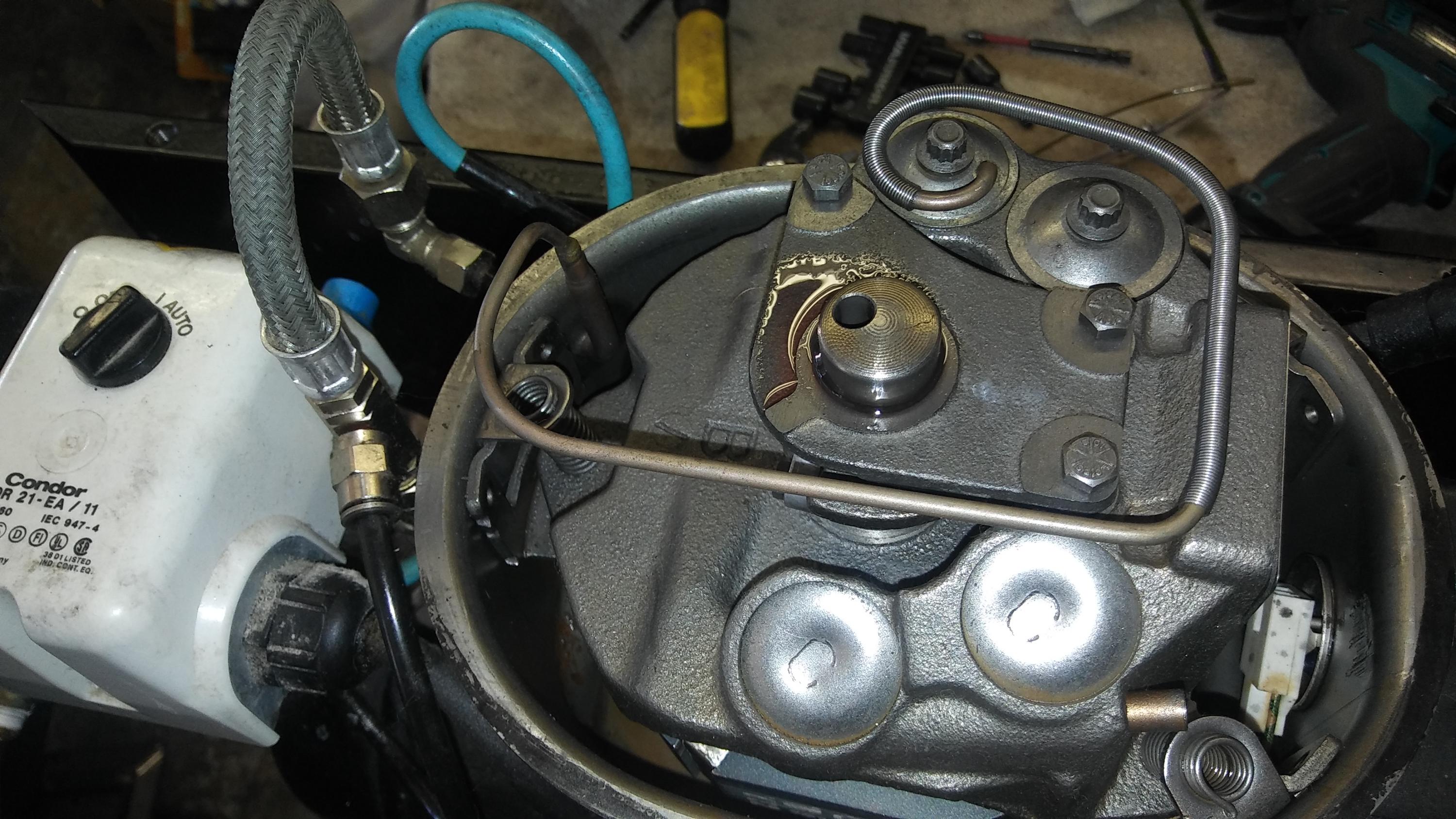

                                    .... inject oil into the suction/vacuum stream continuously in order to meet lubrication requirements...
                                    You're right on, I cut the tube that the manufacturer sealed and found out that was same as suction/vacuum port.
                                    one question, please, air output tube has some brass brazing solder over there how can I get rid of it in order to fit inside my air quick connectors. (I have a propane torch?)
                                    • capwizard
                                      • Jun 2016
                                      • 1991

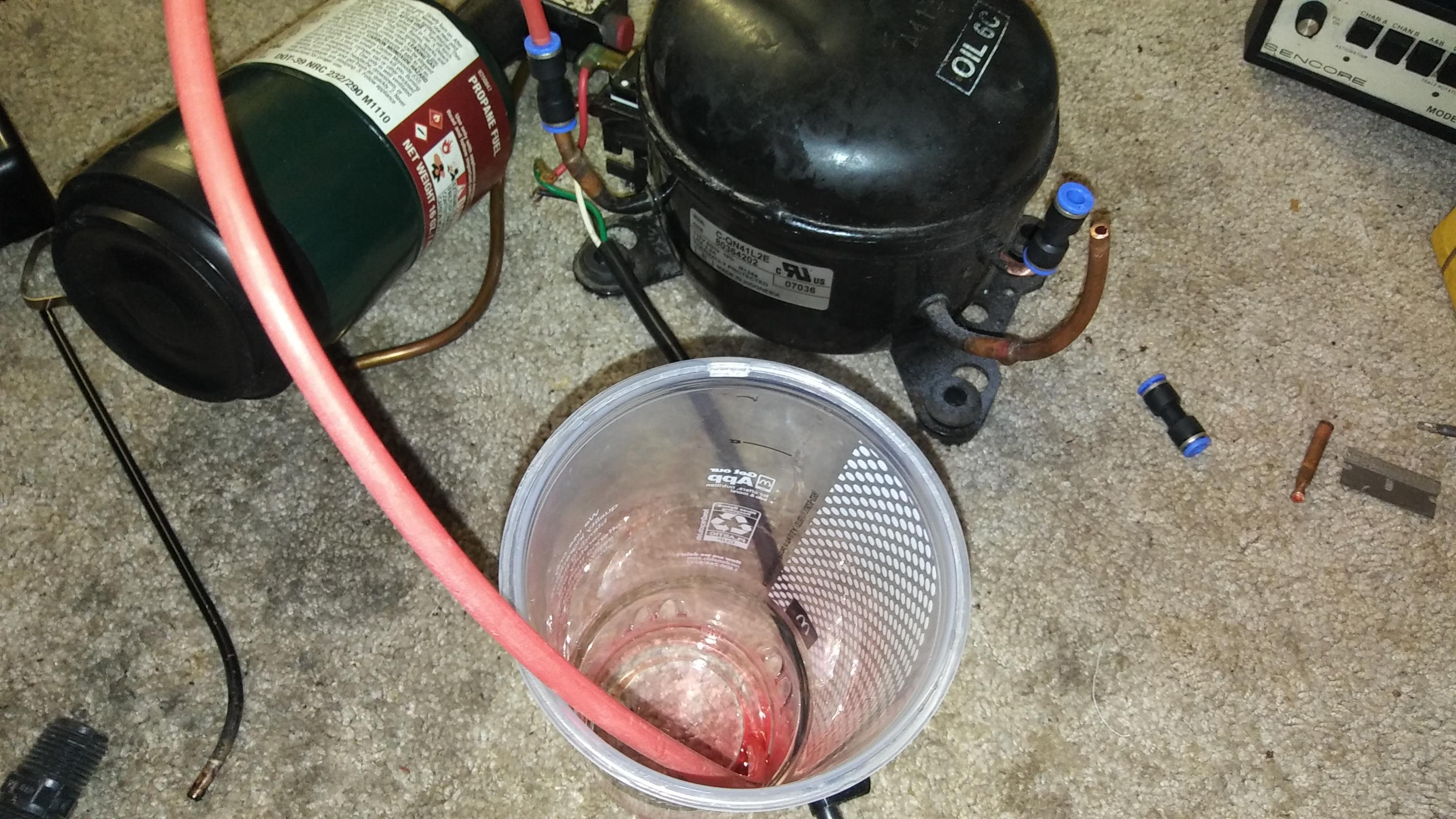

                                      Hola, I just used a propane torch and successfully took out the ( silver solder?). then I ground it into this specification (1/4 inch) with waterproof sandpaper (sand cloth).
                                      I put 500ml transmission fluid to the suction/vacuum tube which sucked oil all in.
                                      I do have a question can compressor be a water pump?
                                      I have a quiz for everybody.... is there any company use this idea put HVAC compressor to make a commercial air compressor or vacuum pump for sale?

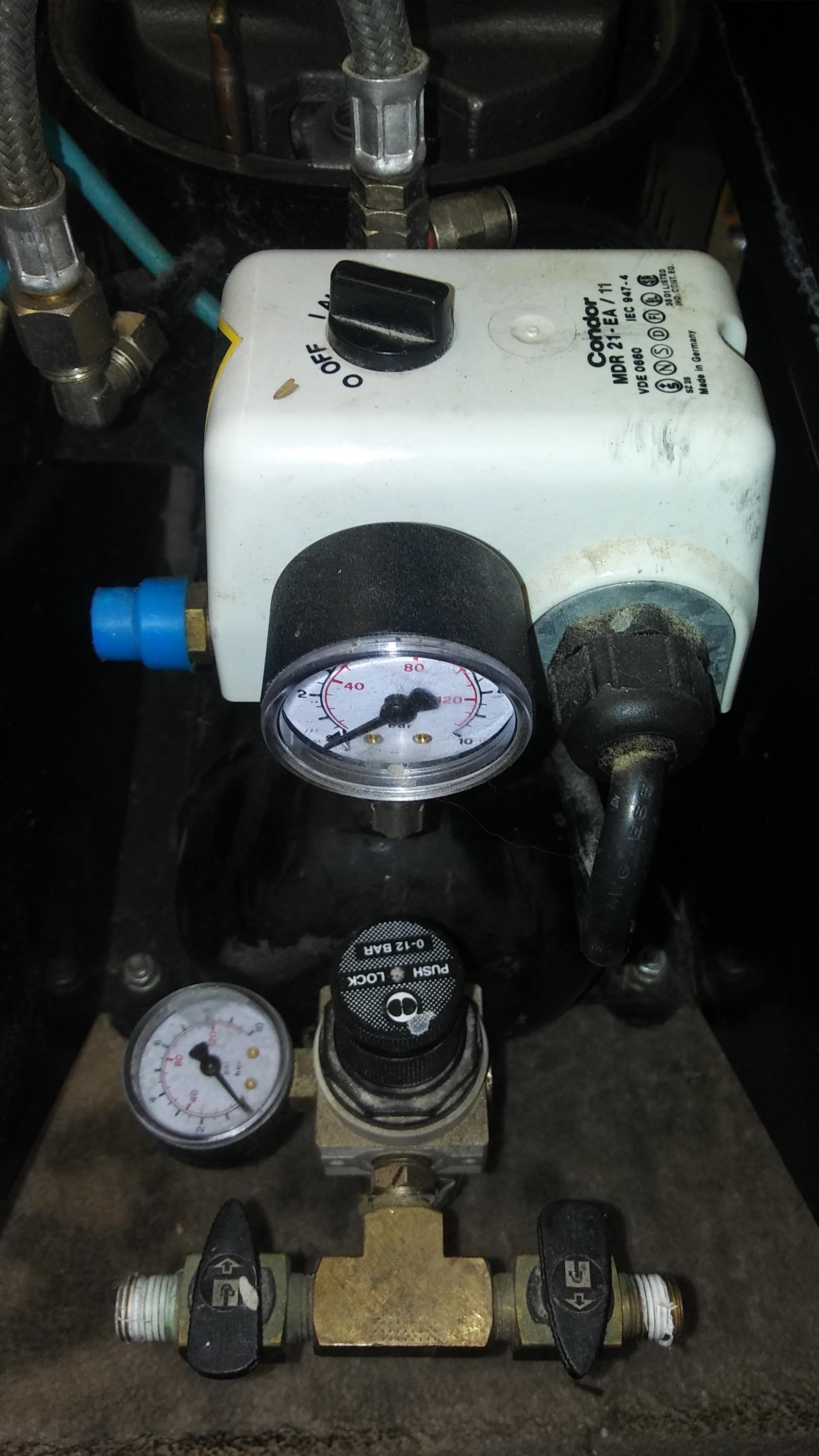

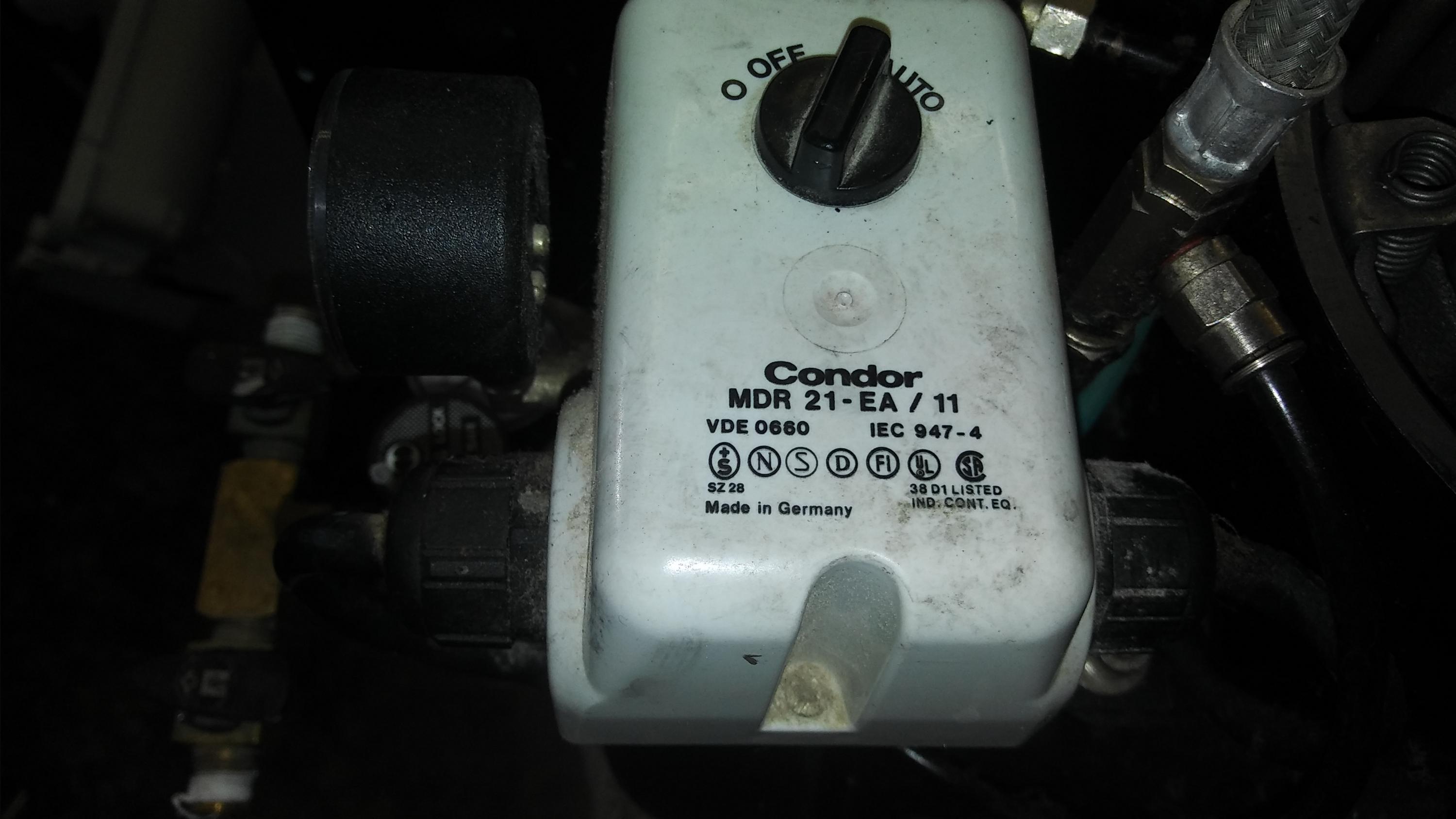

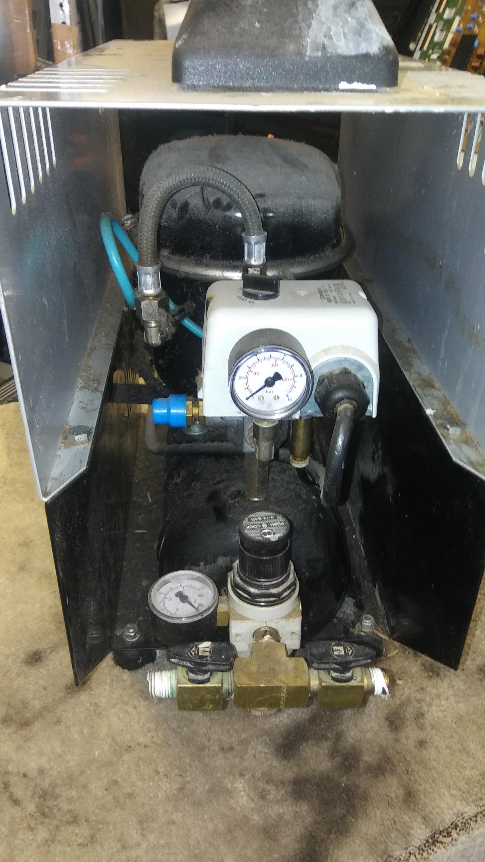

                                        the answer is yes, because I bought an air compressor from the thrift store, I fixed it by WD-40 the crankshaft, that I don’t know which company made it. Can someone tell me? Is it an antique made in Germany over World War II?
