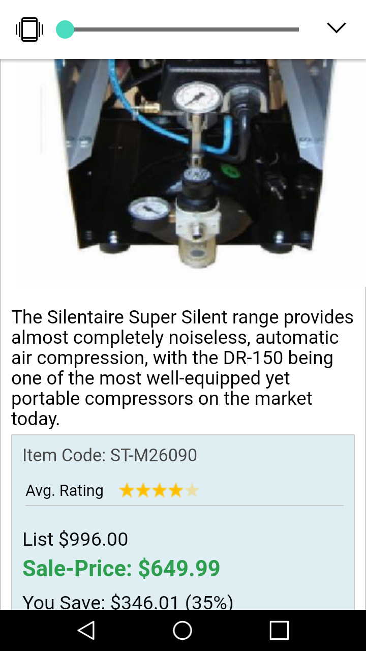

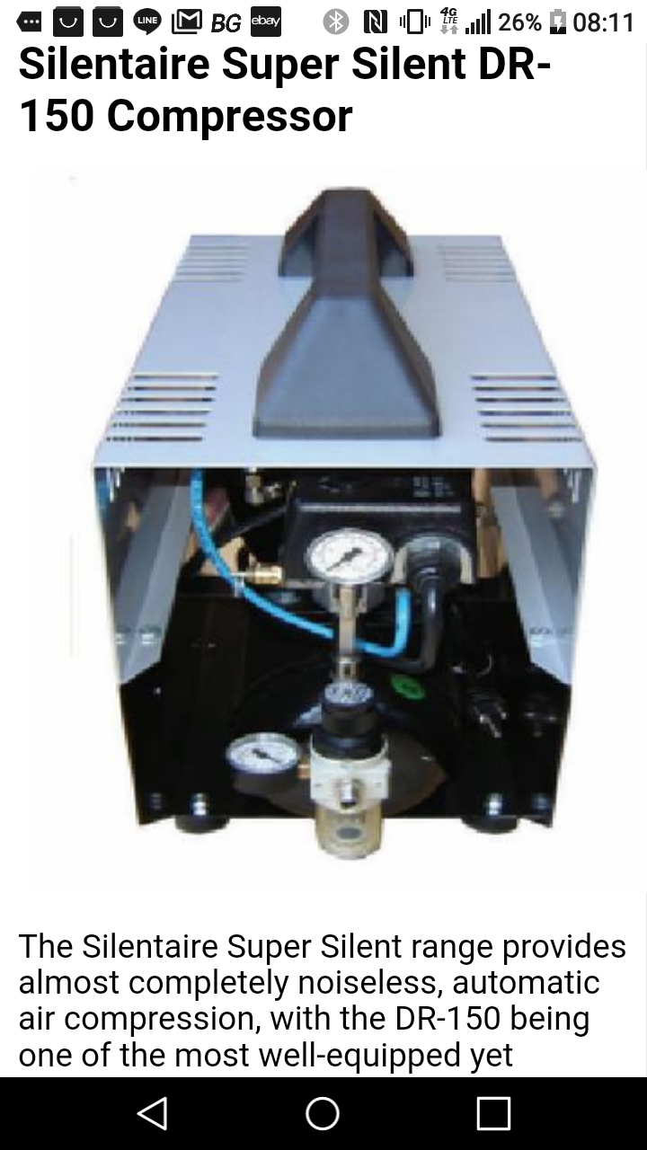

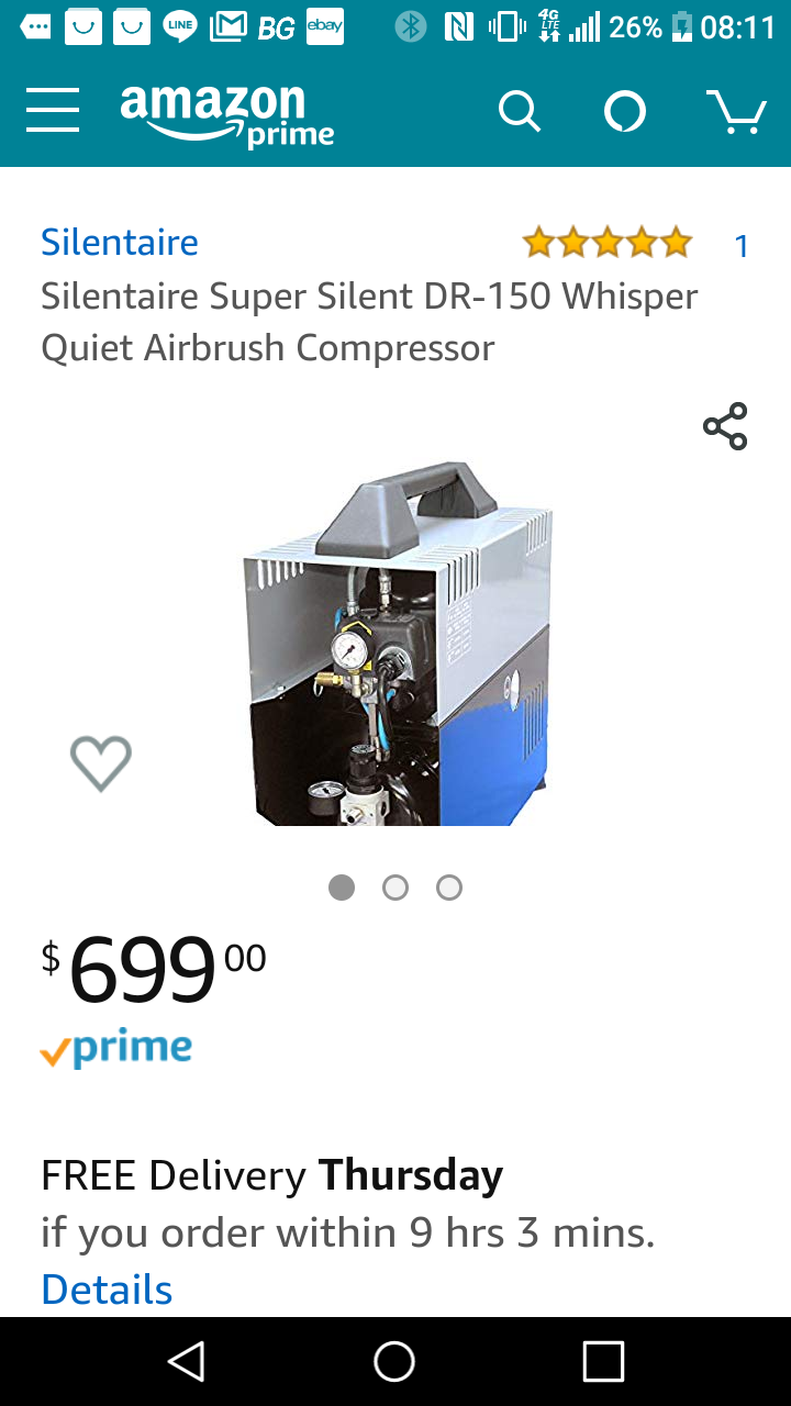

    I think I found it.
    It is Silentaire Super Silent DR-150 Compressor

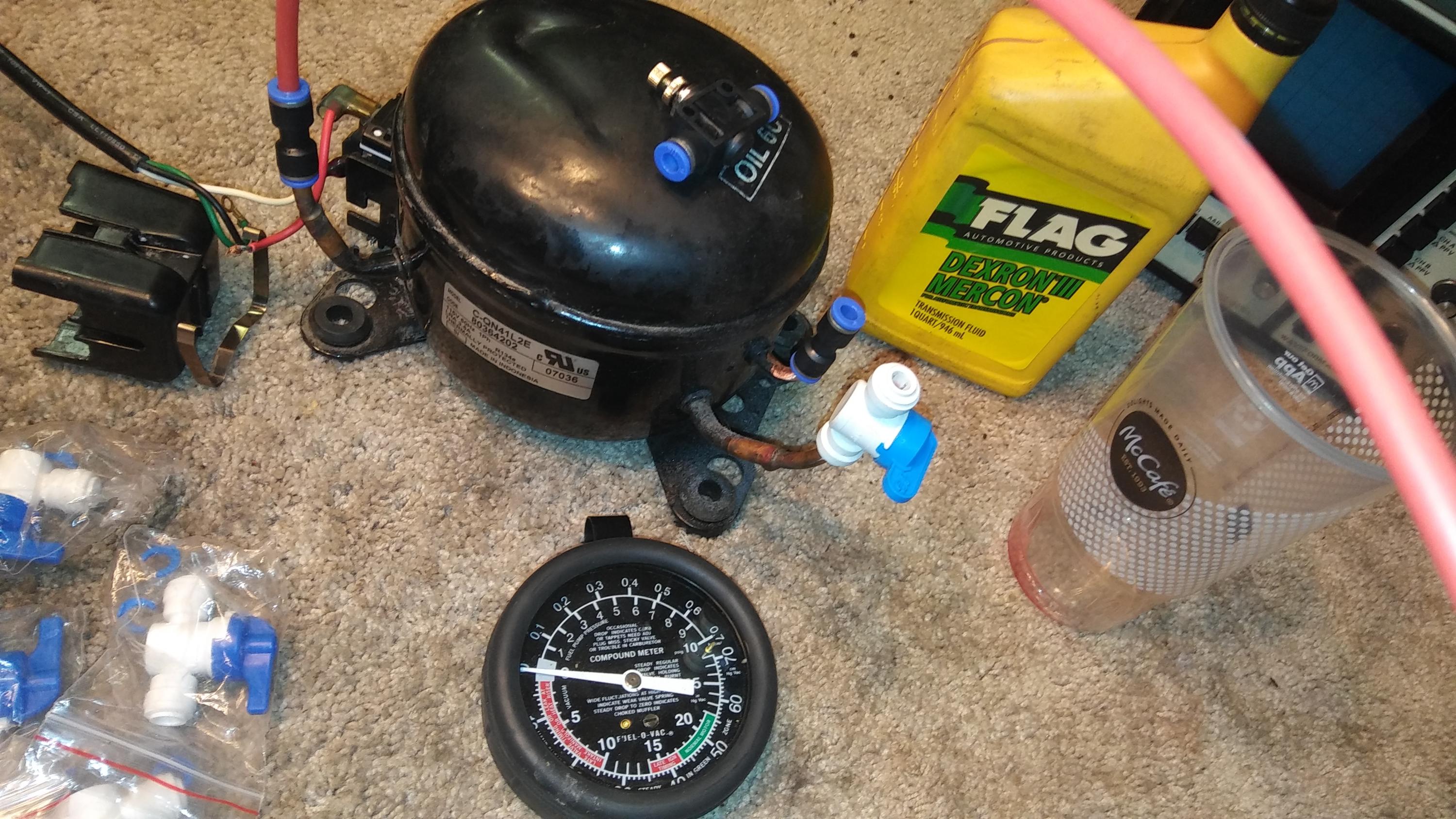

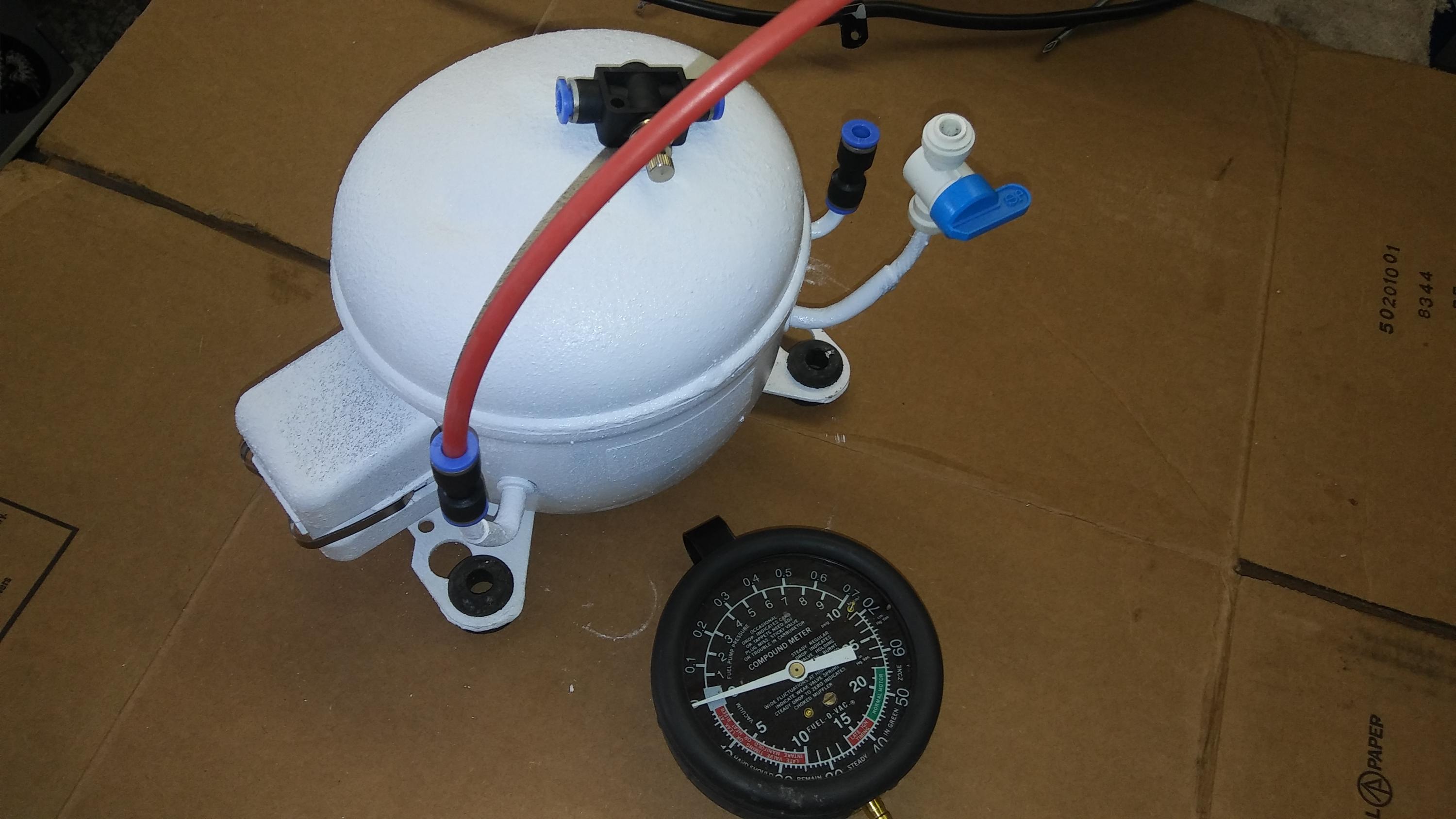

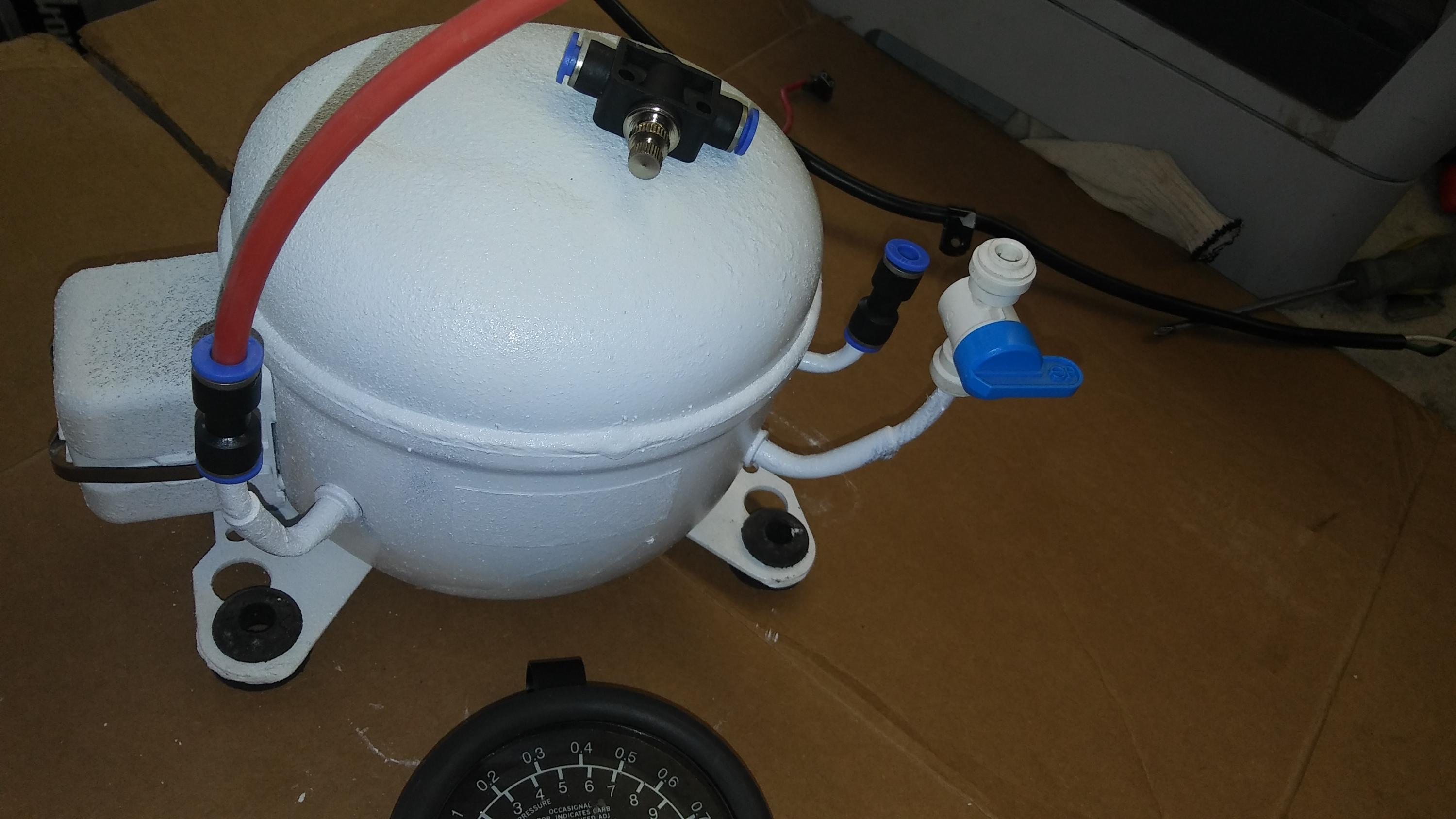

        Harbor Freight their vacuum machines are too noisy, I guarantee that I will use mine longer than Harbor Freight's because I added a valve to the tube that was sealed by the original manufacturer and now I can adjust the amount of vacuum and no needs vacuum cylinder. I will let you see the photos tomorrow.

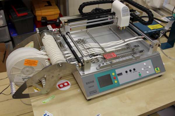

        The real use of this silent vacuum pump is for my next project: Led Tv Suction Lifter, Lcd Sucker (picture 1) and BGA, SMD parts lifter.
        Harbor Freight Pittsburgh 2.5 CFM Vacuum Pump A/C
        https://www.google.com/search?q=2.5+...w=1024&bih=625
        TM220A table top pick and place overview
        https://www.youtube.com/watch?v=yRxcYO0nuD8
        at 8:05 Please listen carefully to the vacuum pumping noise over the background.

          Here are the pictures for you, so now I can control the flow of air. I don't need a canister because of the container of the compressor is storage.

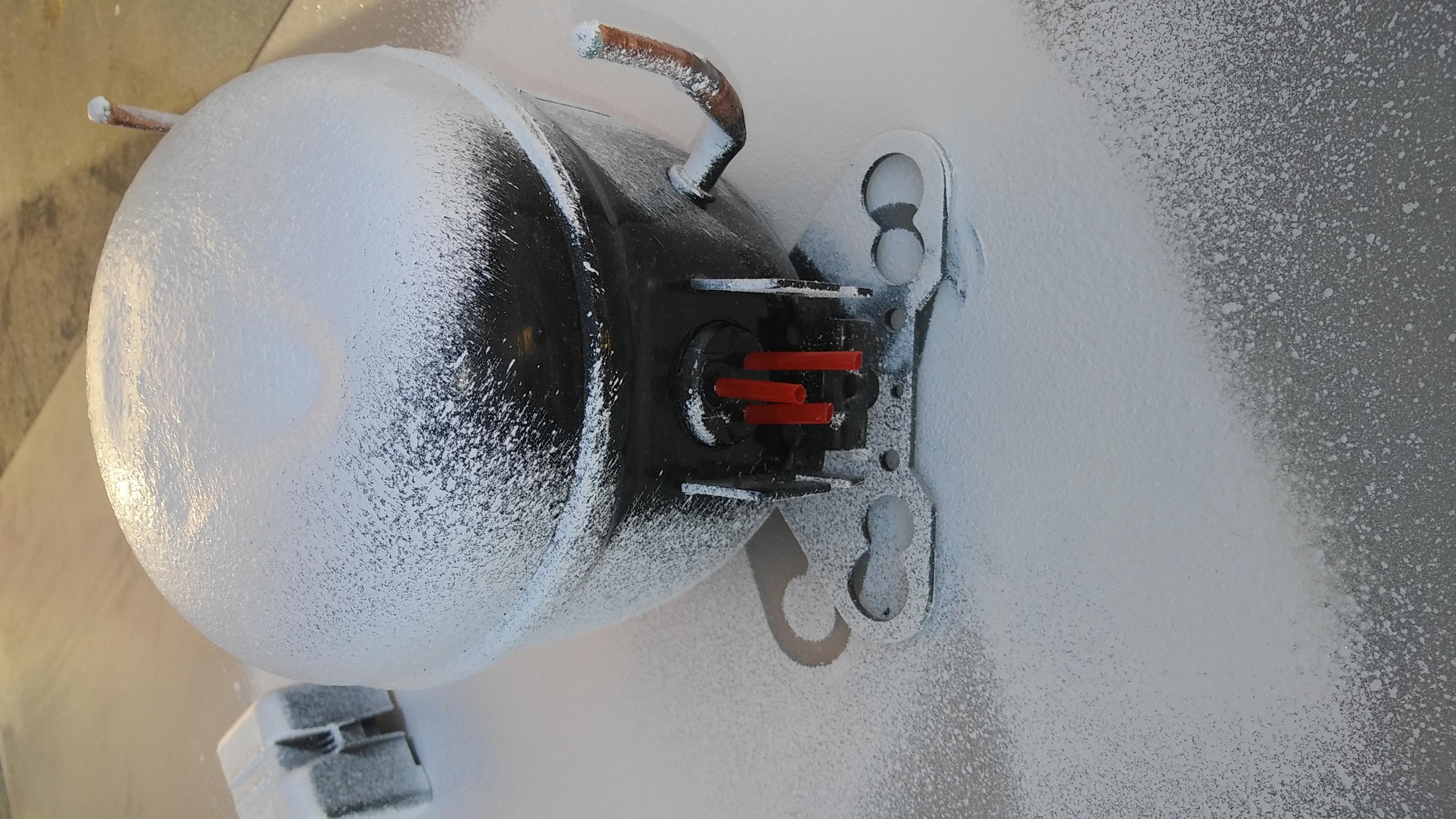

          How about the overheating problem so I will put a temperature control relay and I will change the compressor to the color white.
          I have a question why all the compressors need to print black color?

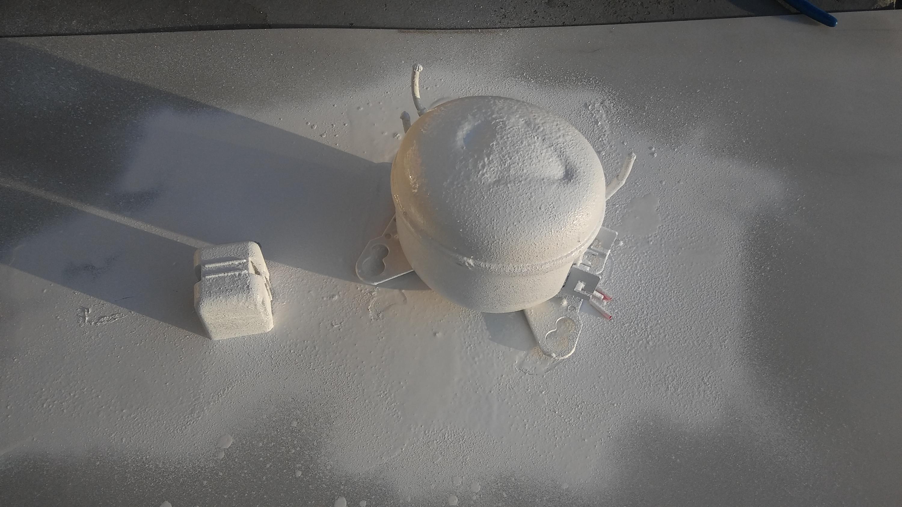

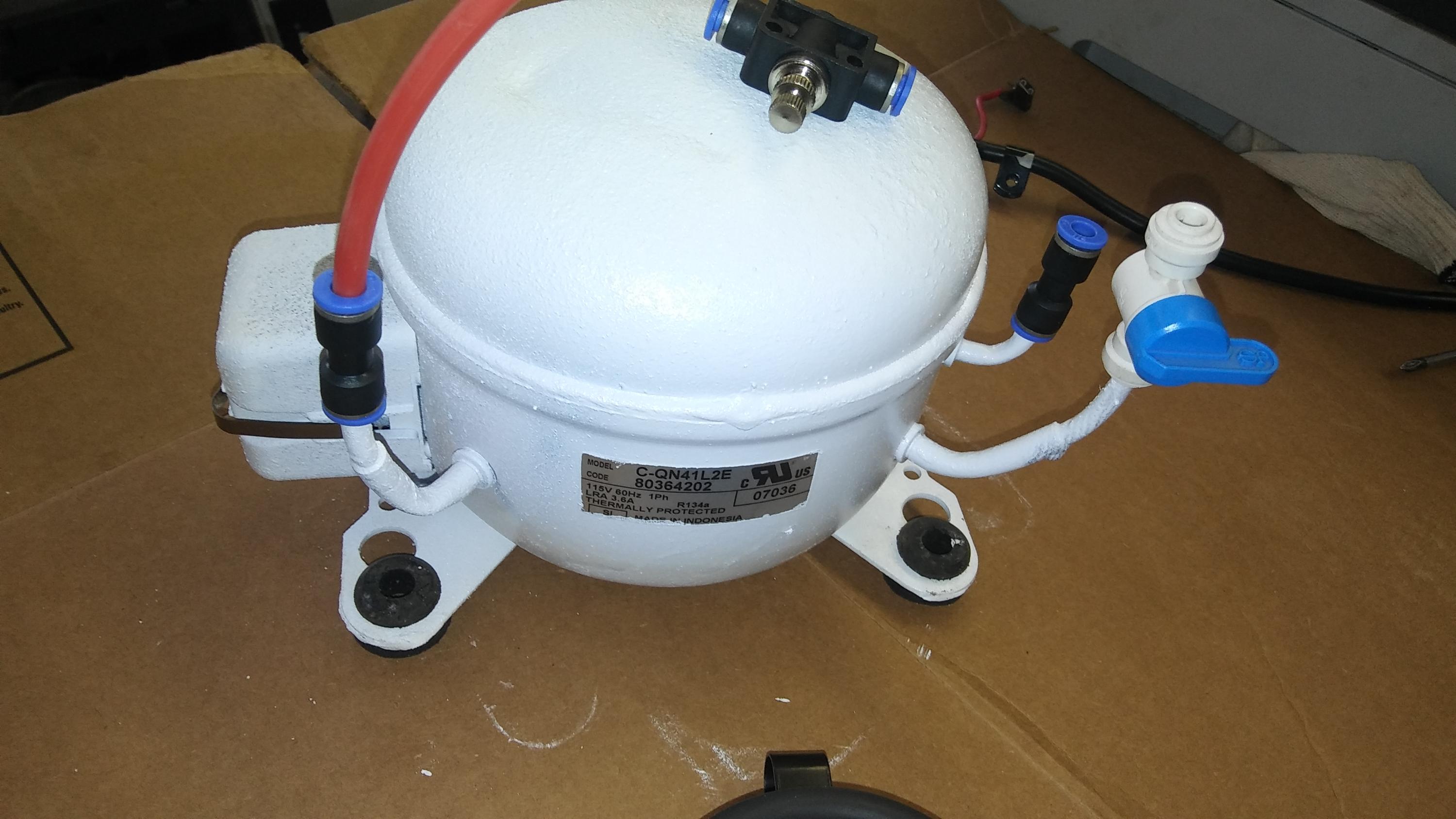

                let's rock.

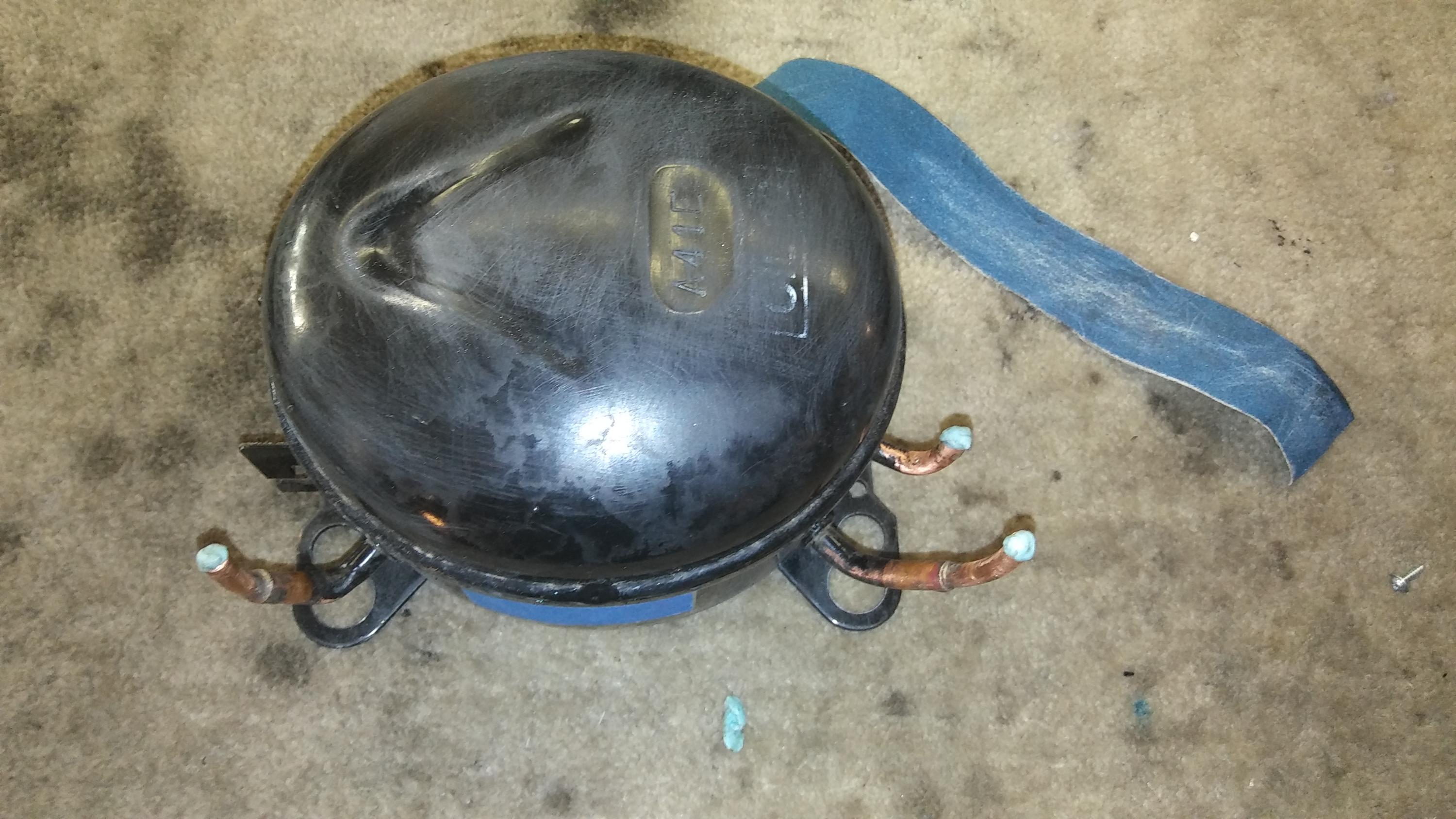

                Three tubes I used bubble gum to seal it.
                The first white compressor in the world.
                I have a question inside the compressor fill with vacuumed air or compressed air? Because I am going to use transparent plexiglass to make a square box case for it and at meantime the casing
                is air storage.
