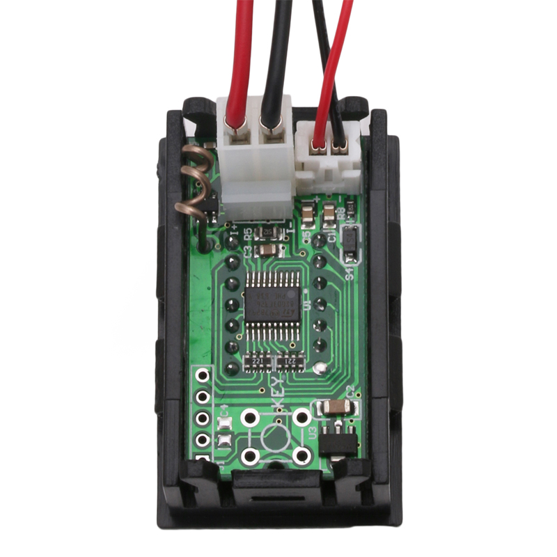

                                    For bench work, I use dedicated DC current panel meters, like the 5-digit ones from fleabay. They cost less than a multimeter fuse under $10. Readout gives 3.0000A gives 0.1mA resolution. The better ones are 4-wire and use SOT23-6 A/D from Microchip MCP3421.
                                    I also see some with the cheaper A/D and 50mA full-scale, so 50.000mA readout.
