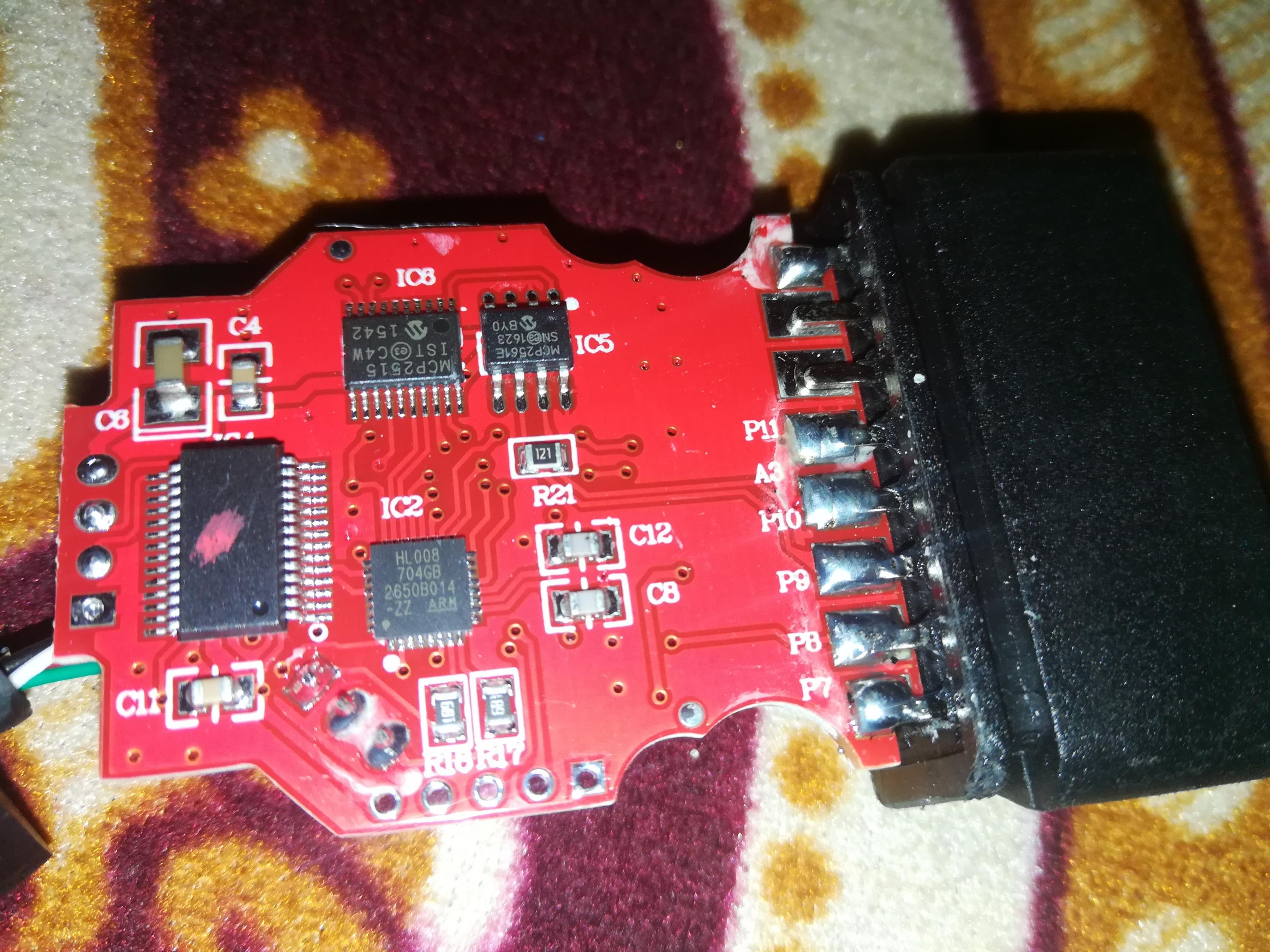

what is this ic ?
  • petehall347
    • Jan 2015
    • 4448
    • United Kingdom
    what is this ic ?
    trying to figure out ic2 .

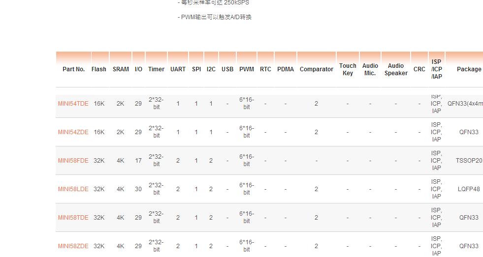

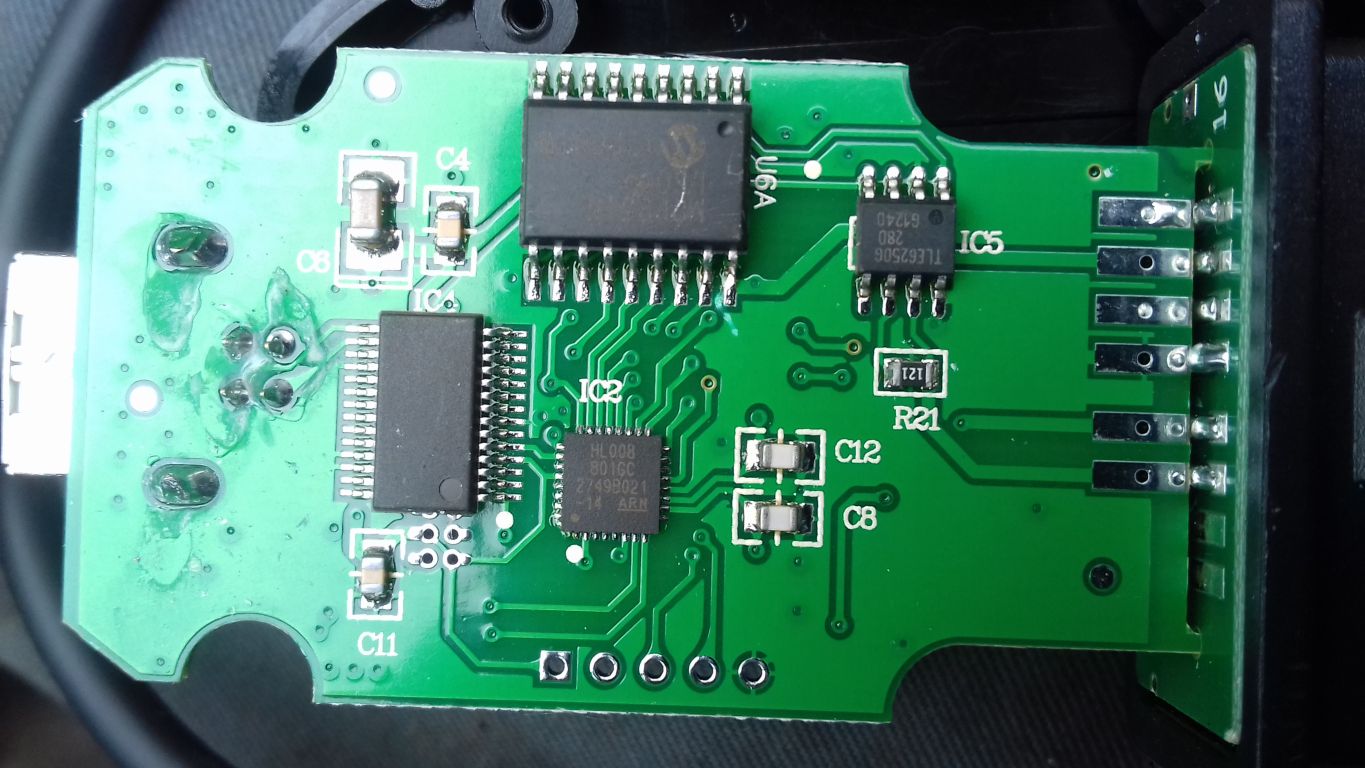

            Here is another picture, looks like the HL008 is 32Kflash, 4k sram, QFN33, Xintang /core Tang MINI58ZDE and I did find this

                Re: what is this ic ?
                Looks like an ELM327 OBD2 reader. SOIC-8 CAN transciever MCP2561 and Microchip CAN controller MCP2515 in TSSOP-20.
