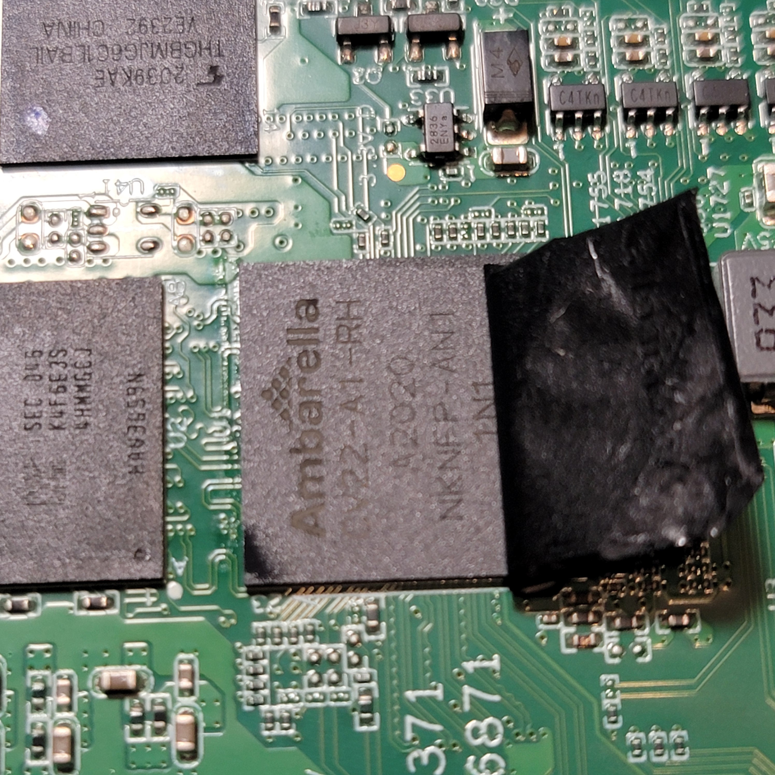

    So have a camera that came with CEEN firmware and when trying to add in USA Firmware the camera is now bricked.. I have looked at the SoC in the camera housing. It has a few and they were not related to the camera it self so I removed the camera module, wanted to see if it was setup like some of the other cameras that I have repaired in the past. This PCB don't have any clear USB or Reset pads, Connecting a USB to Serial I get very little data and shows that it is FW dead.. I can't stop UBoot I have even tried a script that has some expected key strokes and this also fails.. At first I thought the SoC was sanded off but it don't seem to be, Rather they put black tape over the chip, So Found it is a CV22 A1 RH from 2020.. Anyone know of a way to get it so I can put the CEEN firmware back in? Thought I would ask before I take the next step of removing chips lol. I don't want to have to get that deep into it if I can figure out another easier method?

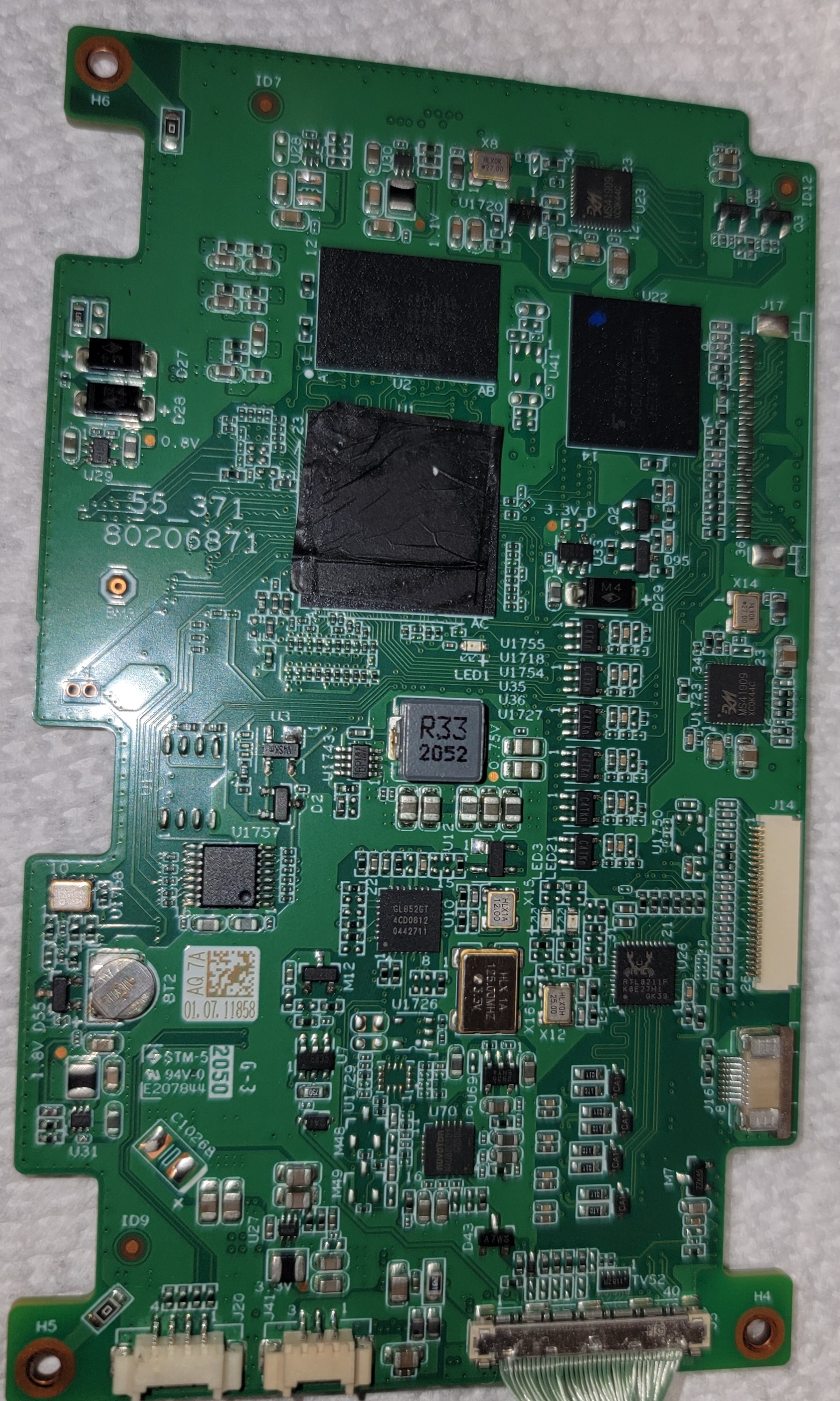

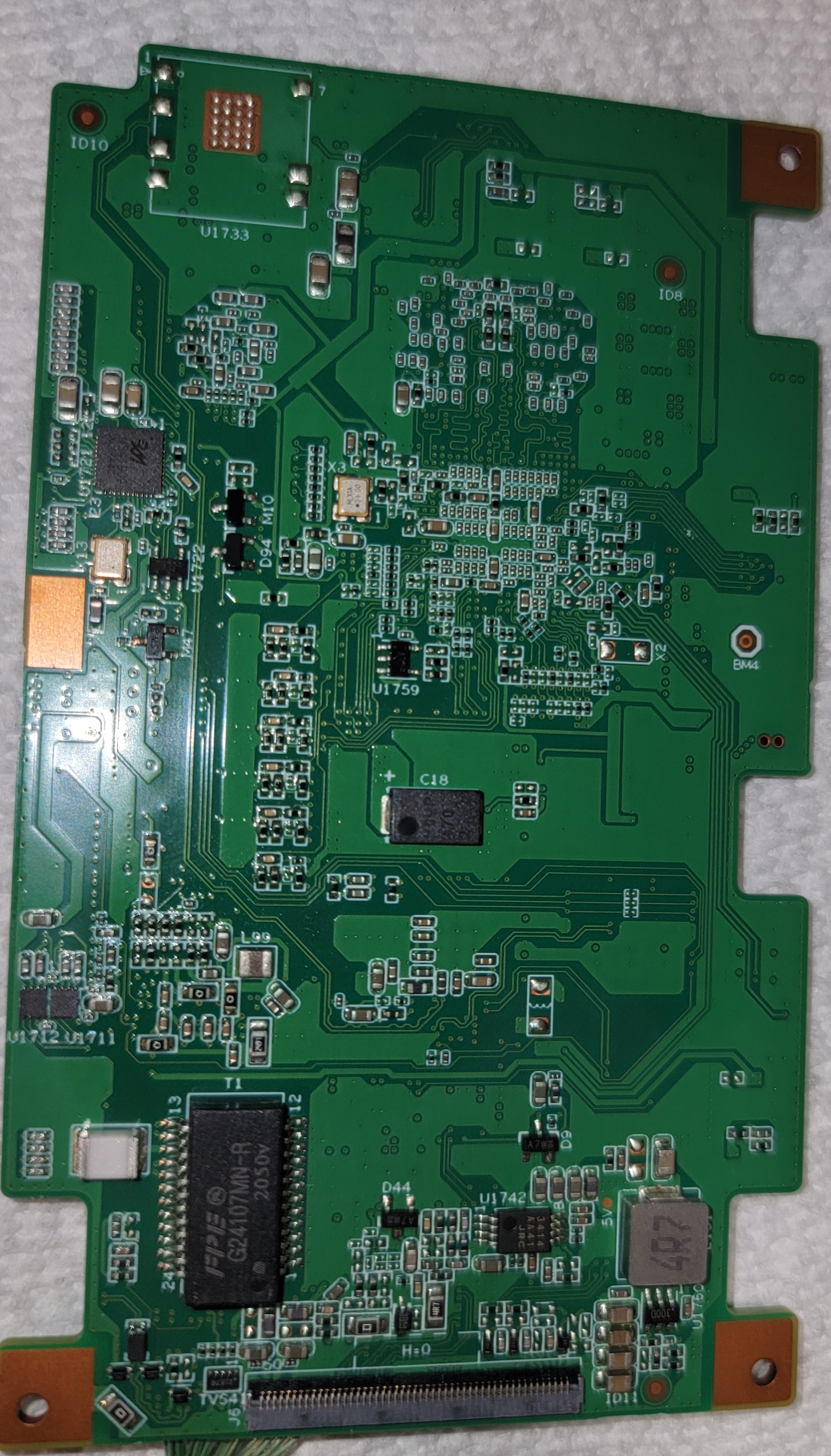

      you are talking on SoC. firmware will written either on SPI or ePROM ! could you show here the Boards from up and downside

      • Revo2Maxx
        • Apr 2025
        • 4
        Thank you for the reply.
        So here is 3 pictures, The 2 of the board I didn't take the tape off at that time because I already had a picture of the chip.
        • Diah
          • Feb 2013
          • 6464

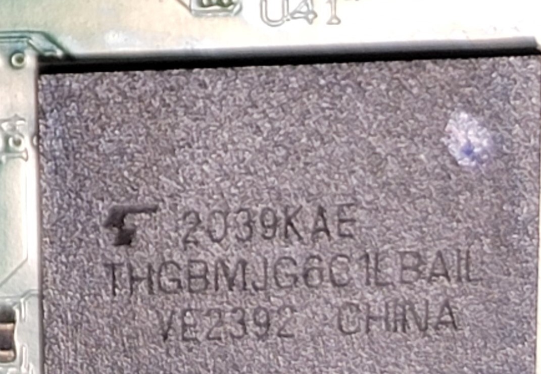

          so the firmware are saved on this custom NAND chips
          • lotas
            • Jan 2016
            • 4787
            • Russia
            THGBMJG6C1LBAIL - eMMC (8GB)
            • Diah
              • Feb 2013
              • 6464
              its look as eMMC but its as i wrote custom NAND it process FG NAND, any way.. he need to find the rights pins on SoC to switch it in download mode
