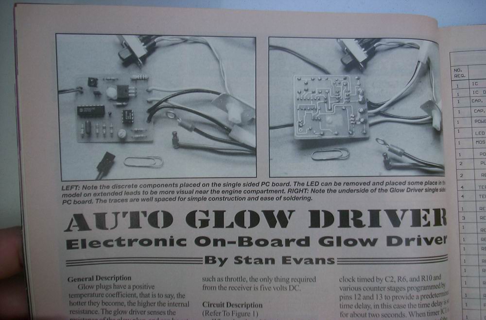

    New guy here.
    I am trying to build a small RC plane Glow Plug Driver that senses the resistance across the glow plug and can sense when it is cooling down and then heat it up. I purchased one just like this and it works great but the company that made it from the UK appears to have shut their doors.
    I found an old plan that was posted in one of the modeling magazines years ago and I am going to give it a shot.
    The problem is one of the capacitors is now obsolete.
    CAP Film 0.01uf panasonic ECQ-P1H103 P3103-ND
    How does one find a good replacement?

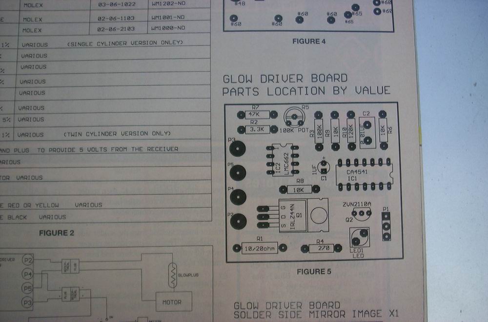

            Here is the parts list that I got from the page:
            1 IC timer TI CD4541BE 296-2078-5-ND
            1 IC Dual Op Amp National ic dual op amp LMC662AIN LMC662AIN-ND
            1 CAP 1uf panasonic Tantalum Capacitor 1uf ECS-F1CE105KGZ P2105-ND
            1 CAP Film 0.01uf panasonic ECQ-P1H103 P3103-ND
            1 Power MOSFET Int Rectifier IRLZ44N IRLZ44N-DN
            1 LCD RED DIALIGHT 550-0404 350-1009-ND
            1 MOD FET ZETEX Inc ZUN2110A ZUN2110A-ND
            1 POT Bourns 3329H-1-104 3329H-104-ND
            2 Molex 03-06-2024 WM1203-ND
            2 Molex 03-06-1022 WM1202-ND
            4 Molex 02-06-1103 WB1001-ND
            4 Molex 02-06-2103 WB1000-ND
            1 Res 10hms 1/2w 1% (single cylinder version)
            3 Res 10K 1/4w 5%
            1 Res 100K 1/4w 5%
            1 Res 120K 1/4w 5%
            1 Res 3.3k 1/4w 5%
            1 Res 47k ohms 1/4w 5% ???
            1 Res 270 1/4w 5%
            1 Res 20 ohms 1/2w 1% (twin cylinder version)
            Receiver cable and plug
            Power Switch
            Glow Plug connector
            #10 stranded wire yellow
            #10 stranded wire black

                The 0.01uF cap is for the 2 second glow plug on-timer, it is not critical 1.9-2.1 seconds ±5% is fine, besides the CD4541B IC is not super accurate either. Parts used 10k/0.01uF gives 1.88 seconds.
                I looked at the circuit and there are a few other obsolete parts:
                1uF 16V tantalum Panasonic ECS-F1CE105KGZ P2105-ND, substitute AVX 1uF 20V 478-1833-ND Digikey or a 1uF film cap 399-5860-ND
                Potentiometer Bourns 100k 3329H-104-ND is now lead-free 3329H-104LF-ND but expensive. 3362H-104LF-ND would work too.
                The LED can be anything from the junkbox.
                Molex pins p/n now WM1001-ND, WM1000-ND.
                If you are not using a PCB to build it, note the schematic does not show power connections for the op-amp LMC662.

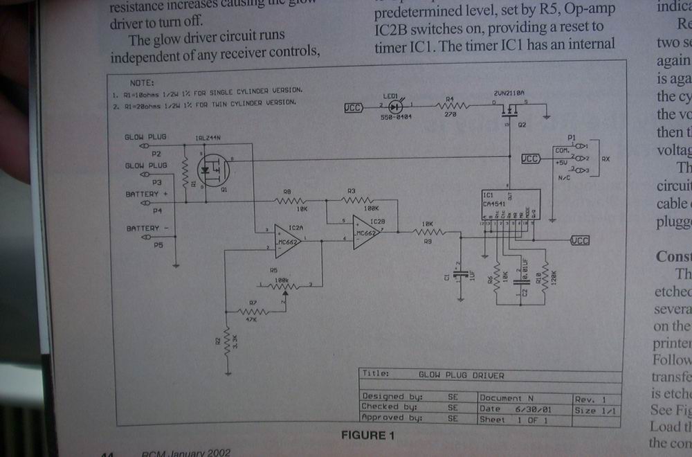

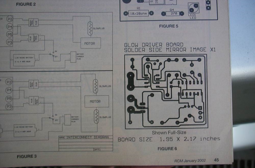

                      I'm back - I purchased all the parts but am having issues getting the LMC662 to reset the CA4541 by the diagrams.
                      I have a 5+ battery connected as the main source and a 1.2v battery connected for the glow plug.
                      What is supposed to happen is when the glow plug ignites the system will ignite if for about 2 seconds and then stop and test the impedance. If it is outside of what the Op-Amp is set for then it will ignite it again and the process loops until you shut it off.
                      I have attached some more detailed pages I found on the net.
                      Any ideas are welcome.
                      Thank you.
                      Ej_Flys

                        It's got a couple wiring mistakes in Fig. 2 and 3.
                        They show P3 as glowplug battery (+) but P3&P5 are connected together (on the PCB) for negative ground/common, so P3 should instead go to glowplug battery (-). P4 goes to glowplug battery (+).
                        Hope this is your trouble. Otherwise we will have to dig in to the circuit

                          Thank you for your review and input. I swapped the 1.2v battery leads around as you suggested and it is now working on my breadboard!!!
