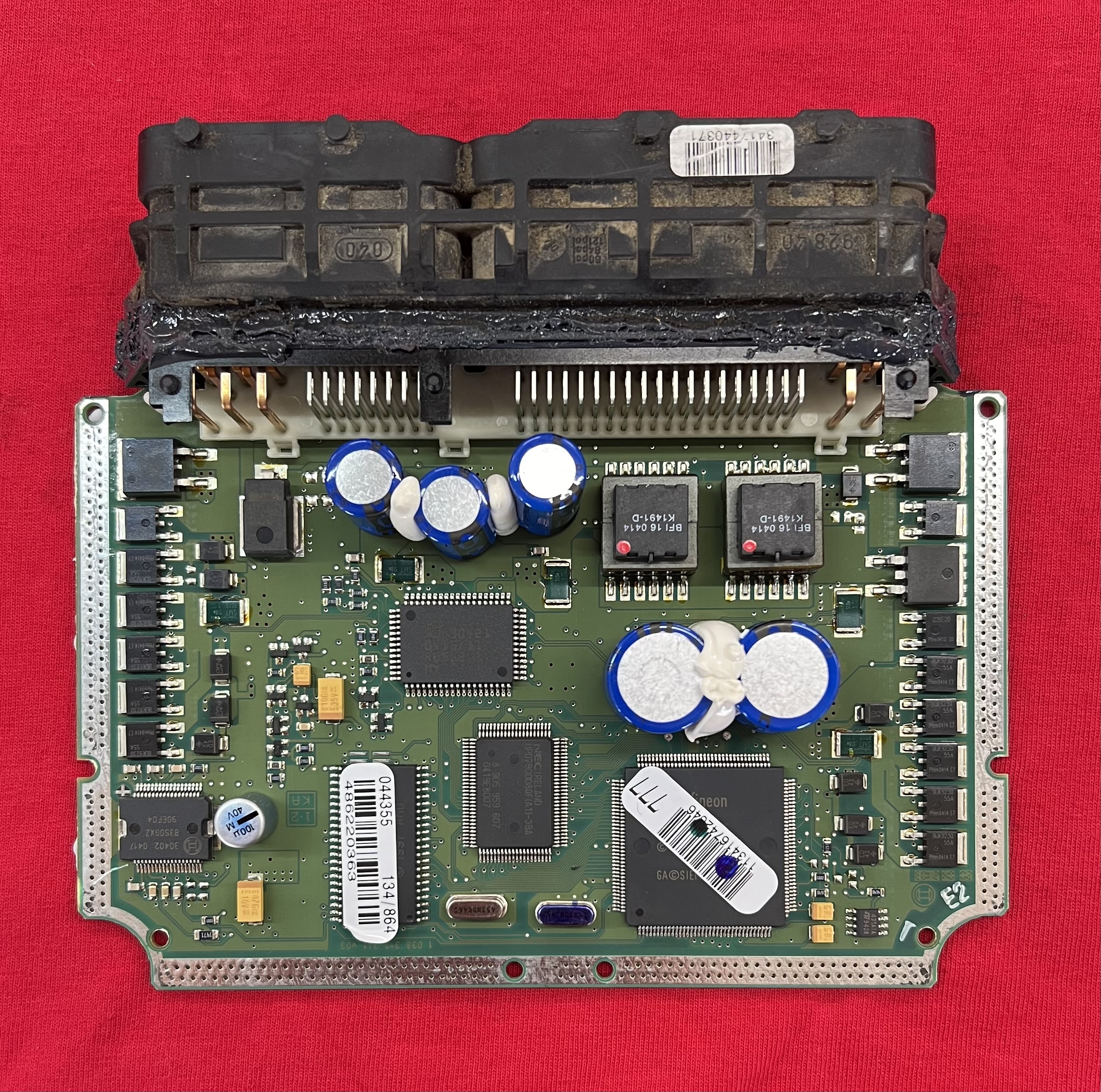

Discontinued Capacitor looking for Replacement
  • rwkish
    • Sep 2018
    • 2
    Capacitor has been discontinued (EGXF101ELL331MM20S) all of the replacements I have found have are smaller than 0.709" Dia (18.00mm). I would like to use the same size or at least close to the same size Capacitor. 19mm would be too big as they would touch and not be able to through hole mount. Tia
    • 31283
    not discontinued
    https://www.chemi-con.co.jp/en/produ...101ELL331MM20S
    125' is unusual - whats it for?
    • rwkish
      • Sep 2018
      • 2
      2004 Chevy Fuel Injection Control Module, the set of 2
        • 31283
        probably o.k. to drop to 105' so that opens up options.
        your restricted to 18mm diameter and thats fine, but whats your true height limit?
