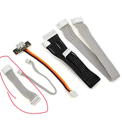

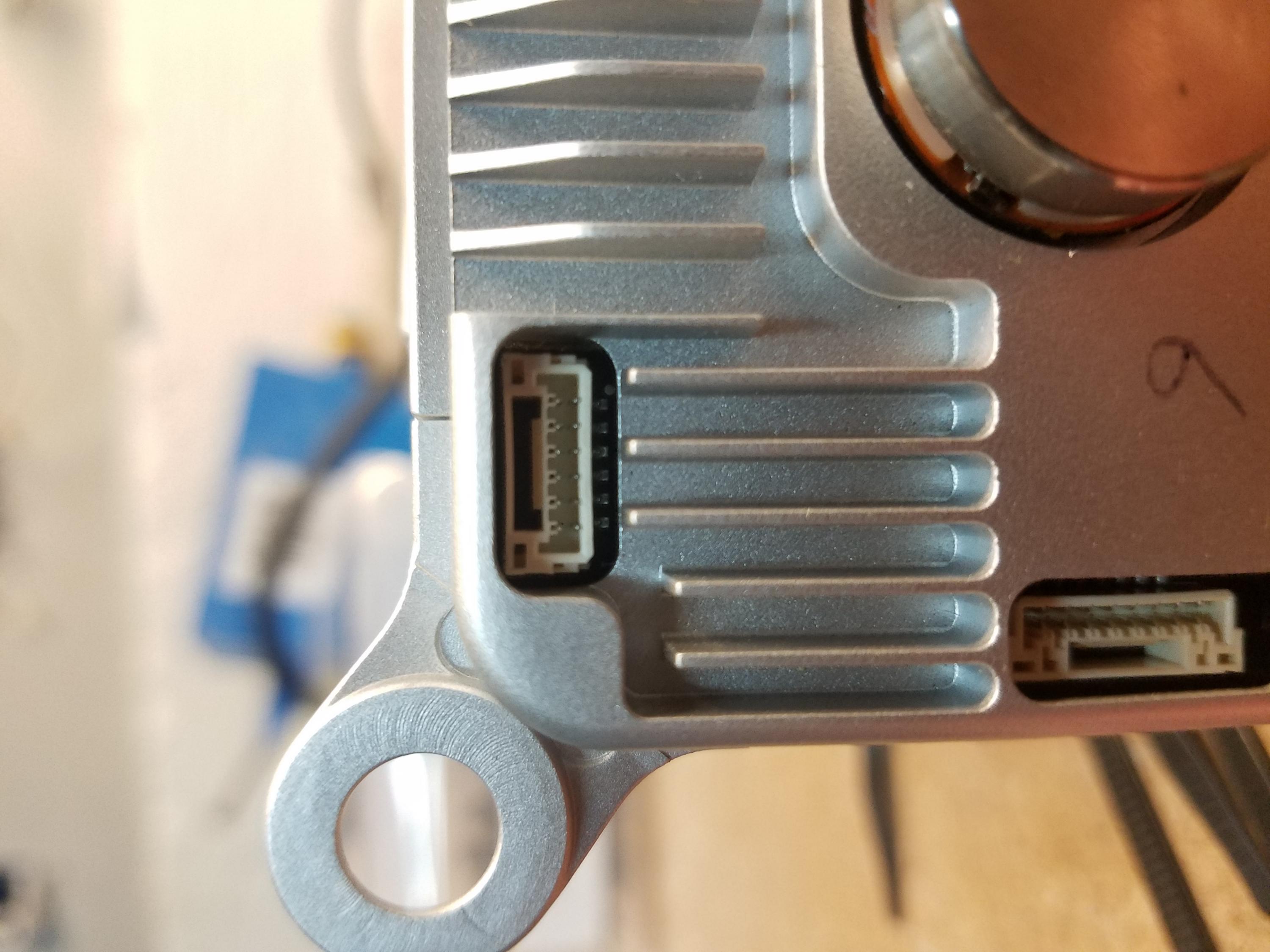

    Looking to identify a connector/cable. If I get it from the manufacturer, it will take two weeks to get to me. Hoping its something I can get from digikey/mouser. I can't imagine its proprietary.
    The connector is a little less than a half inch wide. Please see attached photo of cable. I will attach photo of socket shortly.

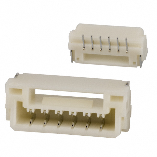

      Is this it BM06B-GHS-TBT(LF)(SN)(N)

        This is the plug GHR-06V-S, this should be the pins SSHL-002T-P0.2
        Digikey has them
        Here is the series pdf
