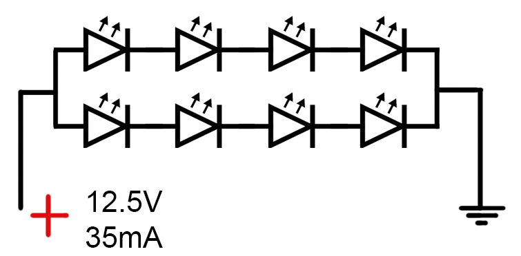

    I've been having a hell of a time driving these LEDs so I broke down and bought a cheap buck CC/CV power supply and I configured it for 12.5 volts output (input is 15 volts) at 35mA.
    I have two rows of these 3528 LEDs, each row has four of them in series, but the rows are in parallel.
    When I connect them to the power supply (monitoring the current with my Fluke meter) the current rides a VERY STEADY 35mA yet after they are lit for a minute or so, they just flicker out and eventually all of them turn off while still drawing current.
    I have 100 of these LEDs so this time around, I used brand new LEDs so that I knew I wasn't using any that had been over driven yet I am having this problem...
    Any ideas?
    (I attached a quick and dirty schematic just in case)

    You have two LED connected directly in parallel so the 35mA will be splitted up and not likely that the current will be equal for each string due to variation in the LED, one may have 10mA, another string may have 25mA.
    Try having just one string connected first, then add may be something like 10 Ohms resistor in series with each string and then hook them up as see.
    https://www.ledsupply.com/blog/wirin...its-explained/
    'The downfall of multiple LED strings:
    'One thing to keep in mind about running parallel and series/parallel circuits is that if a string or LED burns out, the LED/string will then be cut out of the circuit so the extra current load that was going to that LED will then be distributed to the rest. This isn’t a huge issue with larger arrays as the current will be dispersed at smaller amounts but what about a circuit with just 2 leds/strings? The current would then be doubled for the left over LED/string which might be a higher load than the LED can handle resulting in a burn out and ruining your LED! Make sure you always keep this in mind and try to have a set up that wouldn’t ruin all your LEDs if one happened to burn out.
    Another potential issue is that even when LEDs come from the same production batch (same binning) the forward voltage can still have a 20% tolerance. Varying voltages across separate strings results in the current not being divided equally. When one string draws more current than another, the LEDs being overdriven will heat up and their forward voltages will change more, resulting in more unequal current sharing; this is called thermal runaway. We have seen many circuits set-up like this work well, but caution is required. For more information on this concept and ways to help avoid it (current mirror) there is a great article here within LEDmagazine.com.'

        May need a small resistor for each string in parallel to eat voltage drop differences between the series strings, if you don't want to manually bin match all your LEDs!
        LEDs are fickle... on the other hand I'm shocked that there are companies that seem to go ahead and match LEDs so that they can make devices with a zillion of them in parallel and it works (like all those multi-LED flashlights!).

                    why aren't you using a proper led driver like an NSI45020 or similar? Perfect for those small strings.
                      Re: STUMPED! 3528 SMD LED always flickering out
                      "they just flicker out and eventually all of them turn off while still drawing current." This does not make any sense that it still draws the same amount of current but none of the 4 LED's light up.

                            That is right there is no protection device (protection diode connected in anti-parallel with the LED) shown in that data sheet.
                            I sure like to see his LED assembly.

                              These could be very poor quality LED
                              Here try something use just one LED @ 20 milliamperes and see how long it will stay light
                              I have seen this before in poor quality LEDs where not every LED has the same current requirement so when you try to use more than one together not all of the LEDs are the same brightness or after they have run for awhile some will feel warm than other ones

                                Just to make this post complete, I am posting the solution that I came up with that works well in my application.
                                I decided against the LEDs that I was trying to make work, although I do believe this circuit would power them perfectly. But I did order a bunch of 5730's which are much more resilient since they are rated at 150mA instead of 20mA. And I went with this circuit using an LM317 in a constant current source configuration ... those darn things are pretty stable and so cheap!
                                I am only driving each branch at 80mA because I didn't want to push my luck and drive them at max amperage, and they are so bright, 80mA was more than enough to illuminate what I was trying to illuminate.
                                The formula to calculate the resistor value is 1.25 / R1 = Iout so in my case I needed 160mA so transposing Iout with R1 gives me 1.25 / .016 which is approximately 80Ω I grabbed the nearest value I had which I cant remember what it was ... and it worked like a champ!
                                Here is the circuit I ended up using:
                                sigpic
