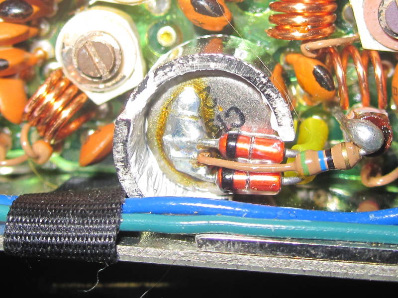

                        what model is this?
                        many older ht's had high power options which were higher voltage packs.
                        you had say a 7.2v pack that ran at 2w or a 12v that ran around 5w.
                        i have an old htx-202 with a custom made 3s2p 18650 pack and a 2sc1972 final.
                        does around 7w.
                        i would be most concerned with heatsinking of the final in your rig.
                        this 202 gets hot on high power if you get longwinded!
                          #32
                          Re: "overvolting" transmitters for more power
                          Here is the final!
                          No there is no different voltage options, so this is it.
