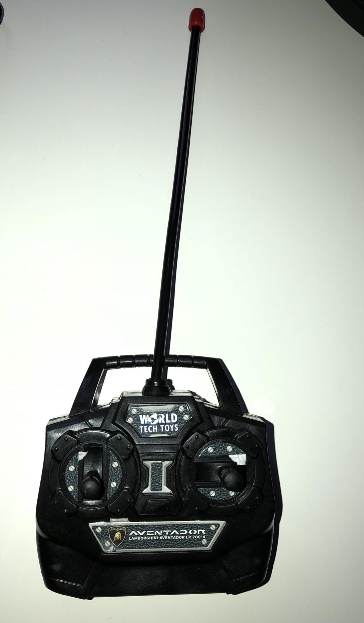

    Its a cheap $20 27Mhz remote control car that a family member's kid plays with.
    They asked (since I like to dabble in electronics) if there was any way to improve the signal as it'll stop responding about 10 feet away from the antenna.
    Ill be honest I hardly know anything about antennas/radio waves when it comes to transmission distance etc so any help would be appreciated

    You should get more than 10 feet range on 27mhz, what size antenna do you have on the transmitter, it may be possible to replace with a longer telescopic antenna however you would need to look at what ever passes for tuning on the transmitter output stages.
    if you can put some pictures up, and if you have the transmitter dismantled some pictures of the pcb(s) etc.

      It's a plastic coated antenna?

        I wonder how far up that plastic antenna the wire actually goes, or is it metal coated with plastic.
          Should I try to remove the plastic? Are antennas made for a specific band that matches the receiver or?

            there may be just a piece of wire inside the plastic tube. Antennas have to be the correct length in order to get a SWR of 1:1
