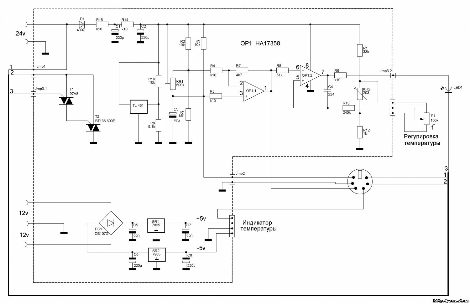

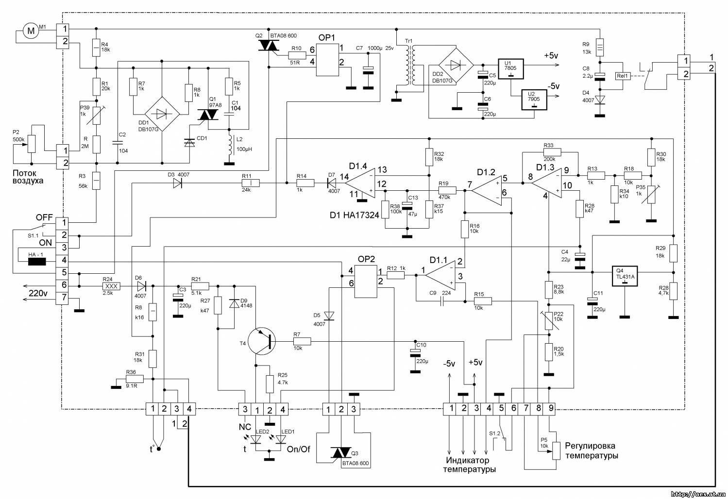

                Pump is a mains AC motor with triac phase-control (light dimmer).
                Here are 852D+ schematics taken from Russian site http://aes.at.ua/publ/pajalnye_stanc...52d/37-1-0-249

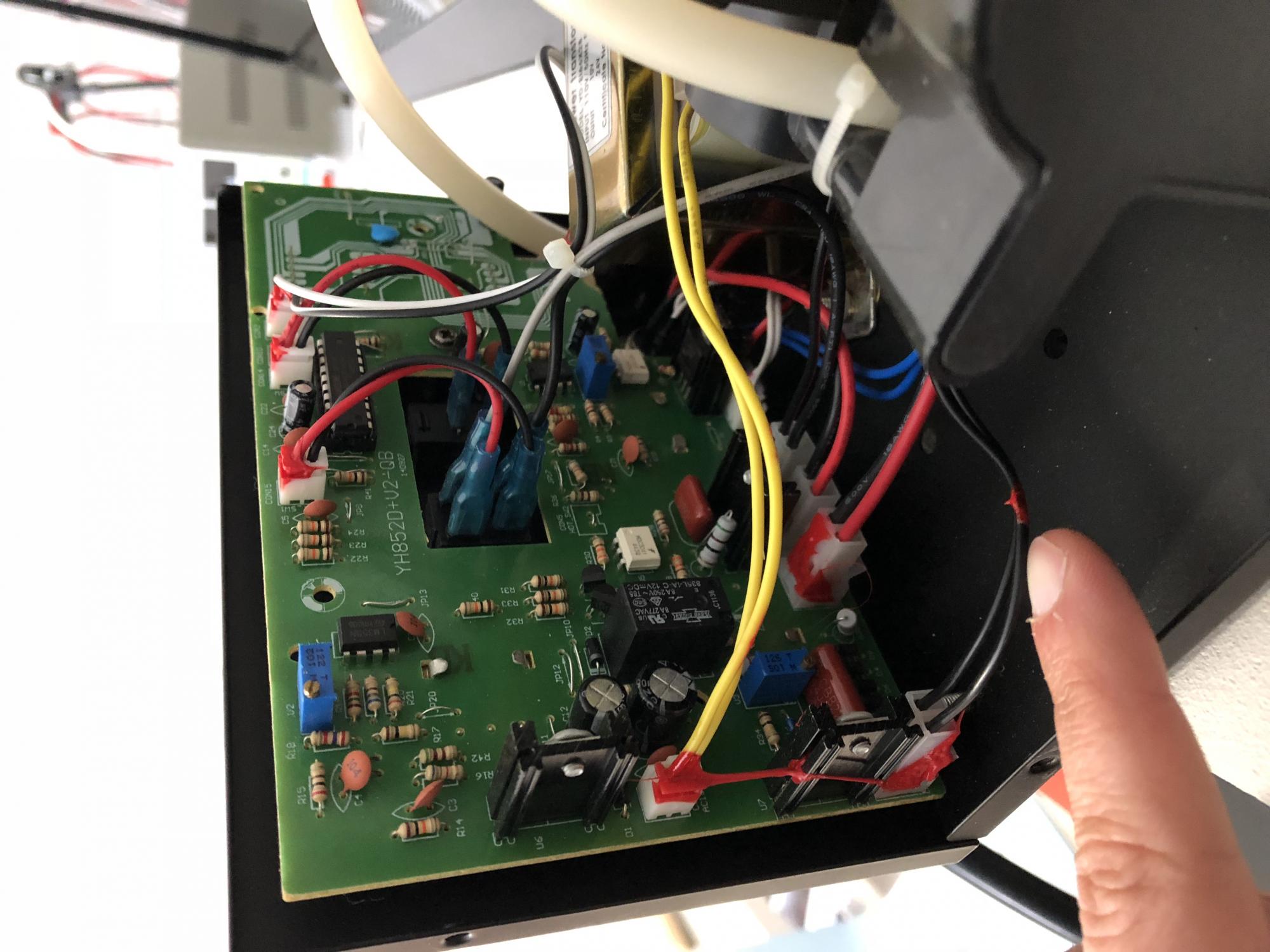

                              Finally had a moment to play around with it.
                              So I measured acv at the terminals leading to the pump (two black wires my finger is pointing to in pic) as I slowly increased the air speed. Seems to smoothly change voltage from 45vac (lowest air) up to 115vac highest setting.
                              I measure 118vac at the receptacle it's plugged into. So safe to say the circuitry is all good correct? More like an aging pump?
                                Re: Hot Air Station - Air Pump Failing
                                You need new pump then.

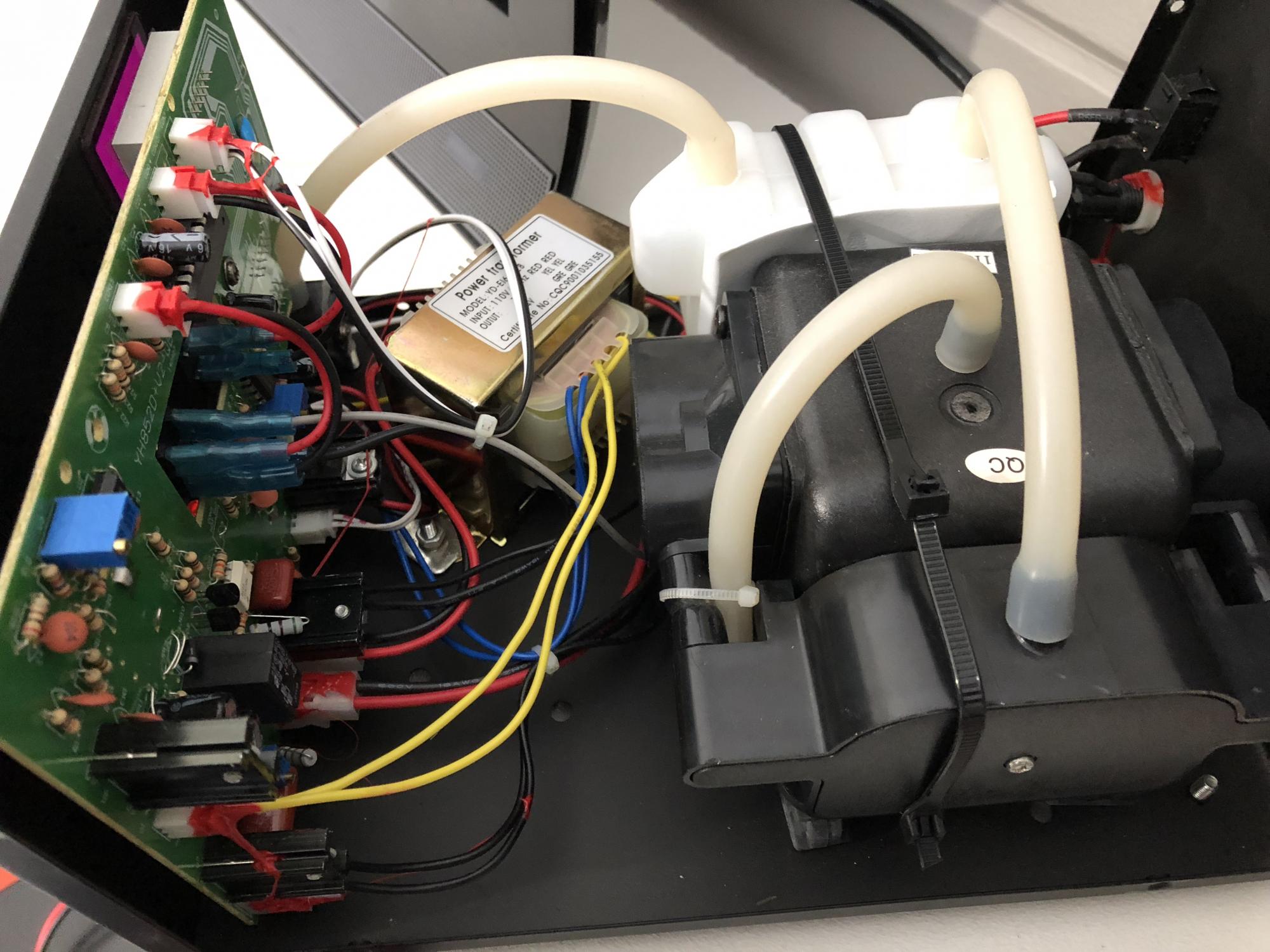

                                      The answer is already in the thread - the diaphragms have to be changed. The pump design is so basic that almost nothing else can go wrong.
                                      The diaphragms are made of a silicone-like thingy, which after some time ( probably depends on the air qualities in your area ) degrades and stops doing what it is supposed to do - which is to keep the pump piston in the correct position and to displace air.
                                      The piston is centered between two solenoids in parallel and it will not move properly if the diaphragms are too soft and are not keeping it in place.
                                      Once you have the pump dissembled, of course do not forget to check if the valves are working fine.

                                          ZD desoldering station pump rebuild
                                          by stj
                                          just did one.
                                          works great.
                                          so here's the discoveries.
                                          the pump "modules" have 4 parts, the main body, the outside bit, the inside bit - screwed to the main body, and the diaphram.
                                          the failure is the inside bit, it has a rubber coating for some reason that becomes tacky and breaks down - contaminating the diaphram.
                                          so you need to clean everything to get rid of all the tacky black stuff.
                                          then reassemble it.
                                          *BUT*
                                          you must put the 2 screws into the assembly only finger-tight.
                                          if you tighten it properly the valves dont work....
