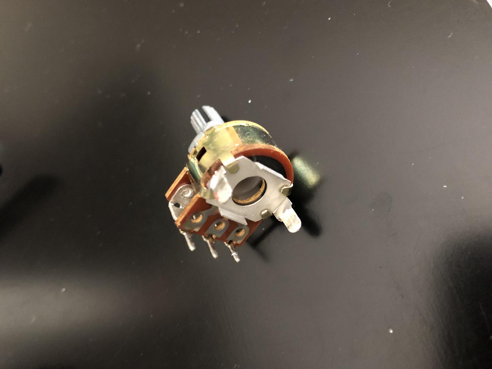

      I’m on 120v. I can’t tell which pins are being used as it’s soldered from the front so would need to remove from the housing. But measuring 1st and 3rd pins it reads 120k as well as pins 2 and 3, and no change really until it’s on the max air setting then it jumps to 10 ohms.
      Comparing to the other two pots they read 2.2k and gradually change as expected. But about half way on them reads 3k then it drops down as you continue. Maybe in circuit it’s giving those readings. But the one for air speed doesn’t have a smooth change
        This tell me that the trim pot is bad and that more than likely your biggest problem with it
        But did you pin one to pin two because pins two and three might be tied together

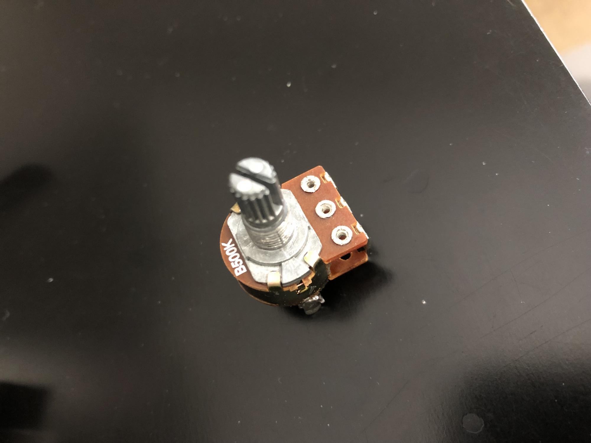

          It is a 500k pot B500k and they have the first two pins tied together. Finally took the front off. So looks like a bad pot as it reads 120k till the very end of its travel which is then 10 ohms.
          Should I replace it with a 250k or would that require messing with the trim pot? How do I make sure I'm getting equivalent replacement? Are they all the same size for the value? There's a ton on eBay makes it hard to know which one to get

              Out of circuit at the lowest setting on the meter it reads .830MOhm so 830kohm and doesn't gradually decrease to 370k and then to 0 ohms with a hair turn after that.
              Only pot I have is a B20k could that be used?

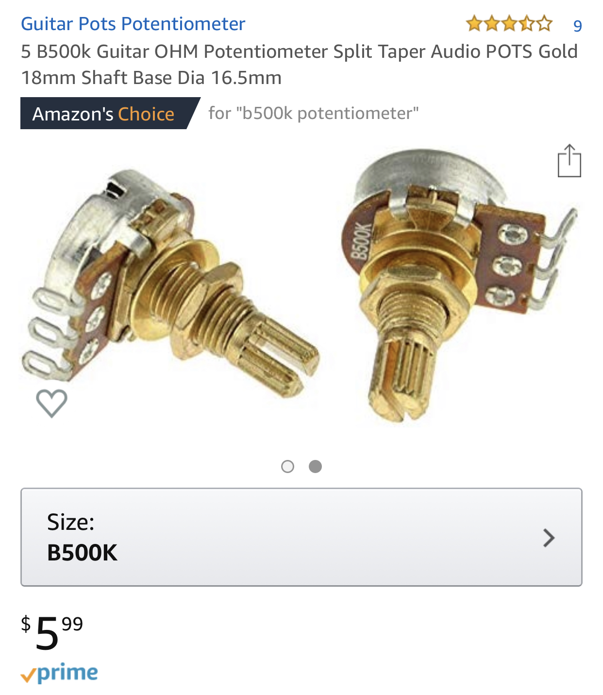

              Would these from Amazon work? Pretty similar size specs expect for the leads and the back mounting piece the original has

                Those potentiometers are weird chinese stuff because it is a dual-potentiometer housing, right angle, PCB mount, but only the one top wafer is used. The WH148 family is a pretty generic chinese ripoff of Alps.
                I haven't seen the exact same part for sale, ever. You could ask vendors if they can supply one.
                What could be done is take out the pot, take it apart (bend up 4 tangs) and swap out just the phenolic wafer/shaft from a new potentiometer. Just keep the old housing and transplant the wafer/shaft portion. It's really no fun and I use a hammer/screwdriver to bend the tangs back down flat putting it together. Note hazardous live mains on its 3 pins, so the pins should not touch other stuff.
                If you stay with 500k, I would change the cap from 0.1uF to 0.047uF for better control. Or go 250k and keep the original 0.1uF part. 20k is too low

                          So these would work fine even though the description says it's for audio yet they're labeled B500k? Confusing
                          5 B500k Guitar OHM Potentiometer Split Taper Audio POTS Gold 18mm Shaft Base Dia 16.5mm https://www.amazon.com/dp/B0191AGY68..._0uvMCb92QMEZ1

                            It's for audio and guitar use, but not necessarily audio taper. Note the vendor sells A250k, A500k as well.
                            BUT the threaded shaft looks too long (it's for guitar use through thick wood).
                            Short shaft is 15mm, long shaft 18mm. I think yours is the short one.

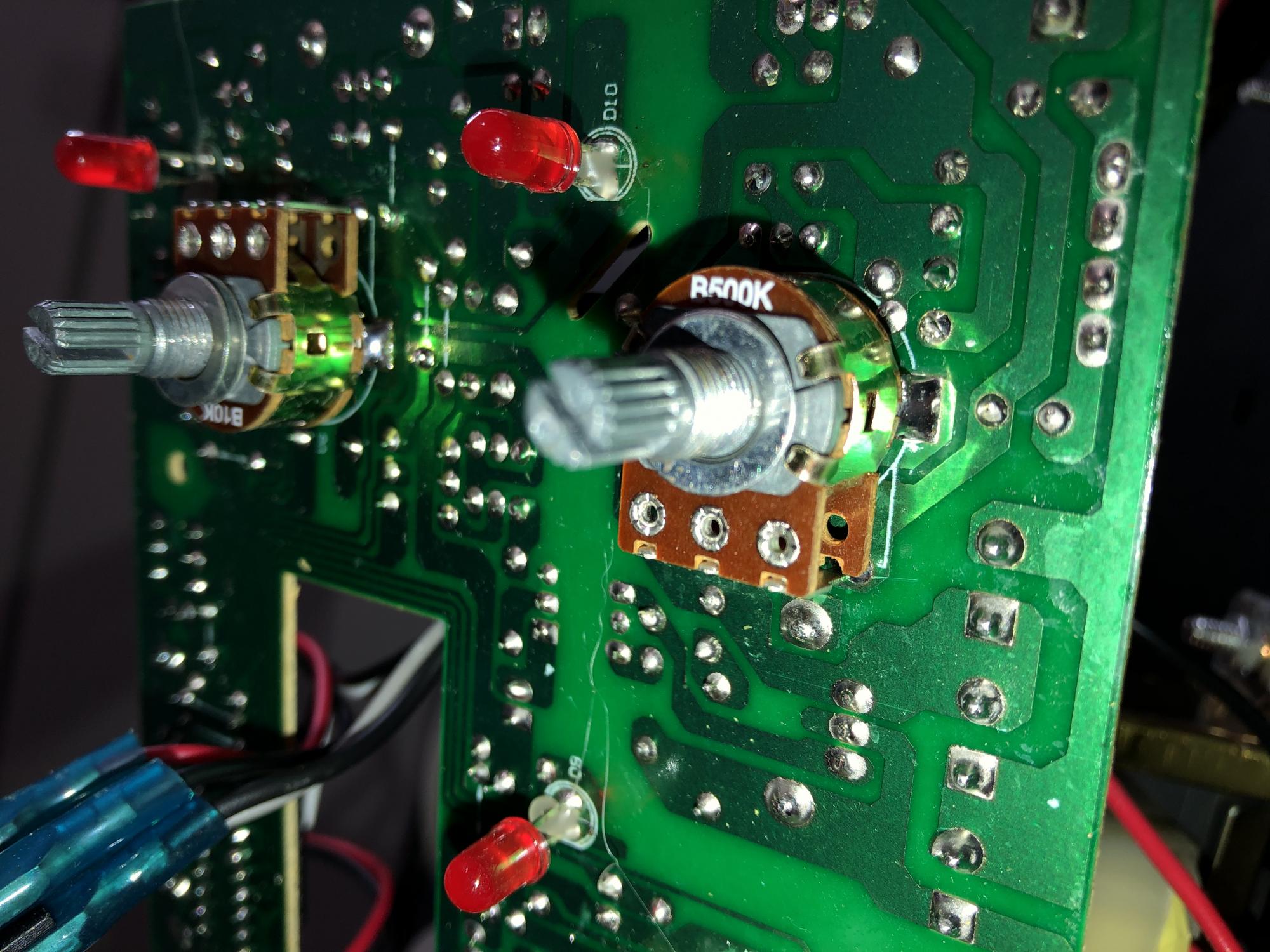

                                you may want to resolder the connector pins - some have ghost-rings in your picture.

                                    the 3.96mm molex connectors

                                      Are ghost rings the greyish cloud looking things in solder joints? I see that a lot in various pcbs. What caused them? I always thought they were normal from lead-free solder

                                        Yes and even the ones that are not shine
                                        It probably would not hurt reheat all the other solder joints as well

                                          Well new pot is in. Had to solder the ends of the old leads onto the new one so they’d reach the PCB.
                                          Oddly the air control seems weaker. I have full range again but just seems weaker than before. Is it possible for a new pot to cause this or?
