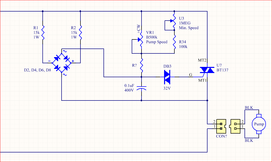

            #65
            Re: Hot Air Station - Air Pump Failing
            You could measure rms ACV at the air pump and see if it's going up to full mains voltage or not. Or use the 40W light bulb.
            The trimpot only sets the lowest pump speed, it would not affect full speed.
            If the pot goes to near zero ohms, and the triac is still not full on, I would change the cap from 0.1uF to 0.047uF (47nF) for 120VAC operation.
            The air pump speed control design is el-cheapo and missing a RC snubber, so I'm not sure how much voltage stress the triac sees, or how much current the main potentiometer sees.
            I drew this schematic of the YH 852D+ V2 pump controller, based on your pictures but I cannot see all the parts. It's a typical light dimmer circuit. Part values are all over the place depending on make (Kada, Yihua, Saike etc).

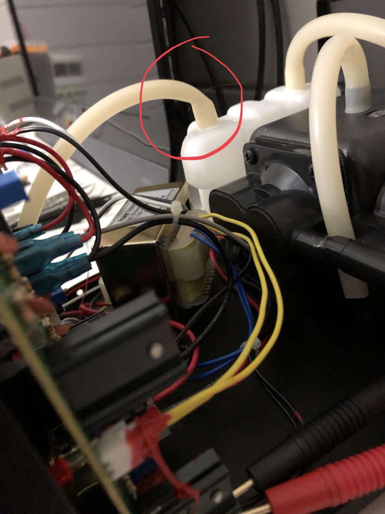

              #66
              Seems to smoothly change voltage from 45vac (lowest air) up to 118vac highest setting. I tweaked the trim pot to get lowest air speed to 50vac as it seemed a little too non-existent at that setting.
              I thought maybe this hose was to blame so I squeezed it open but there was no change over all. Maybe it's the pump not putting out same air as when it was new?

                #67
                maybe there is a blockage - like where the wire joins the air and leaves the unit - that area used to kink a lot on mine.

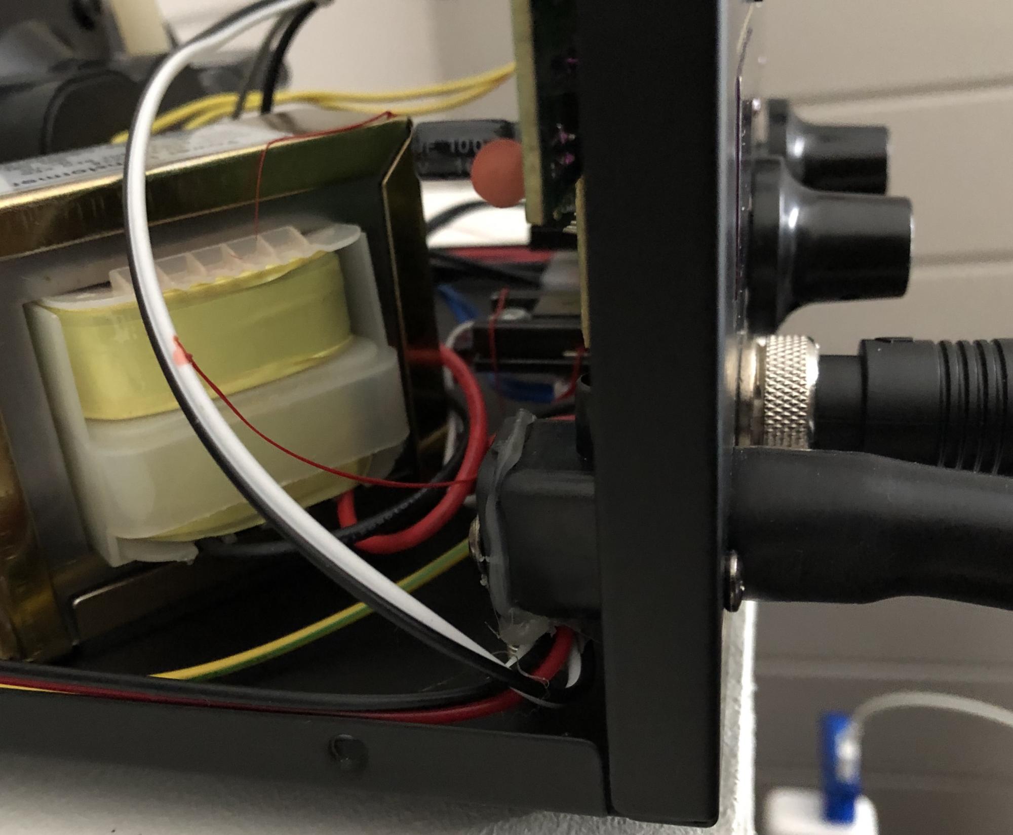

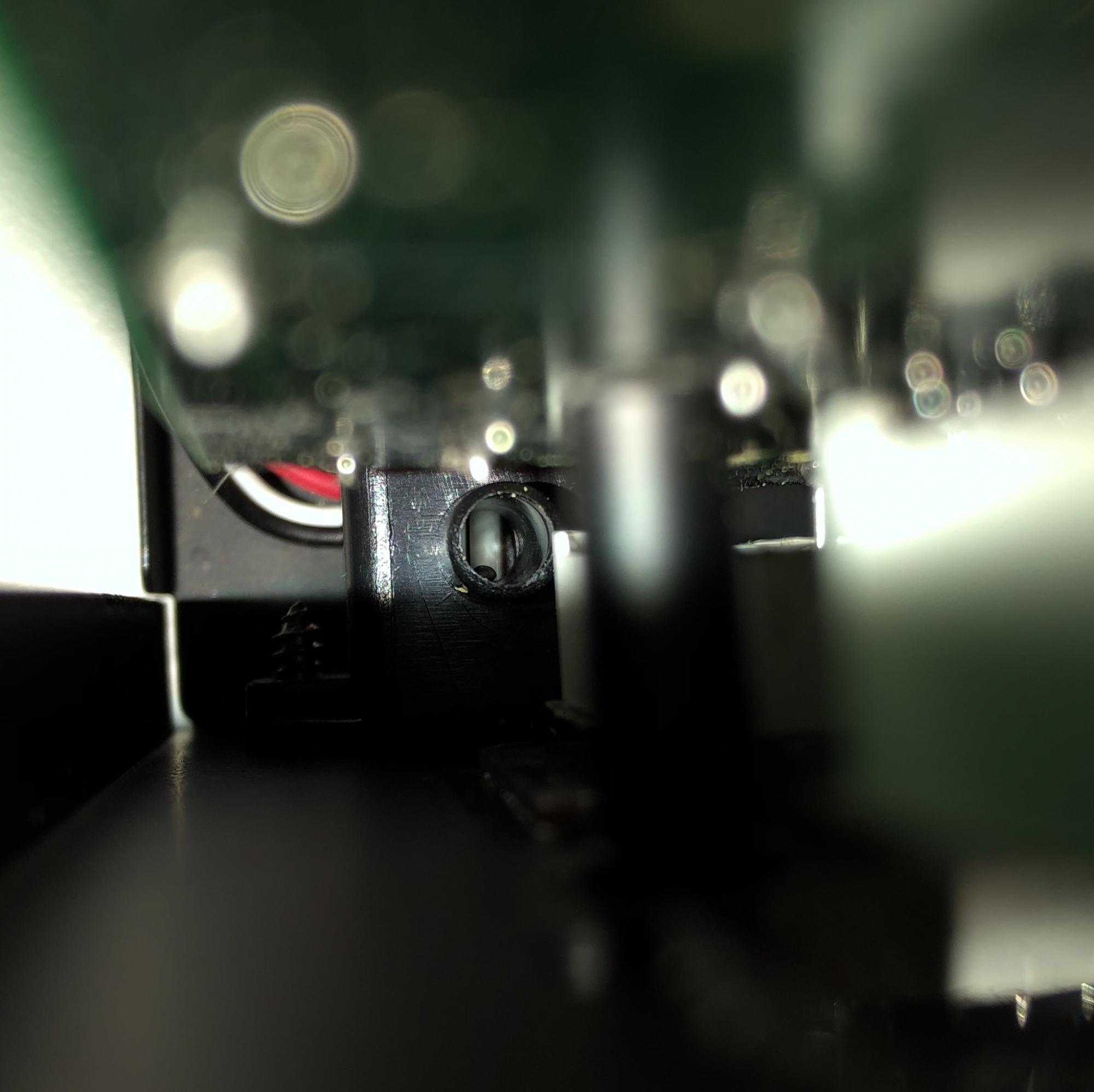

                    • caphair
                      • Nov 2011
                      • 1249
                      #70
                      Do you mean there could be blockage inside the little box that the air and wires join together or that the hose would kink at that point?
                      Here's a pic with the hose removed. I just see wires inside that I'm guessing is normal.
                      How would I remove the hose at the front to check for blockage? Does it just twist off? I tried but it wouldn't budge

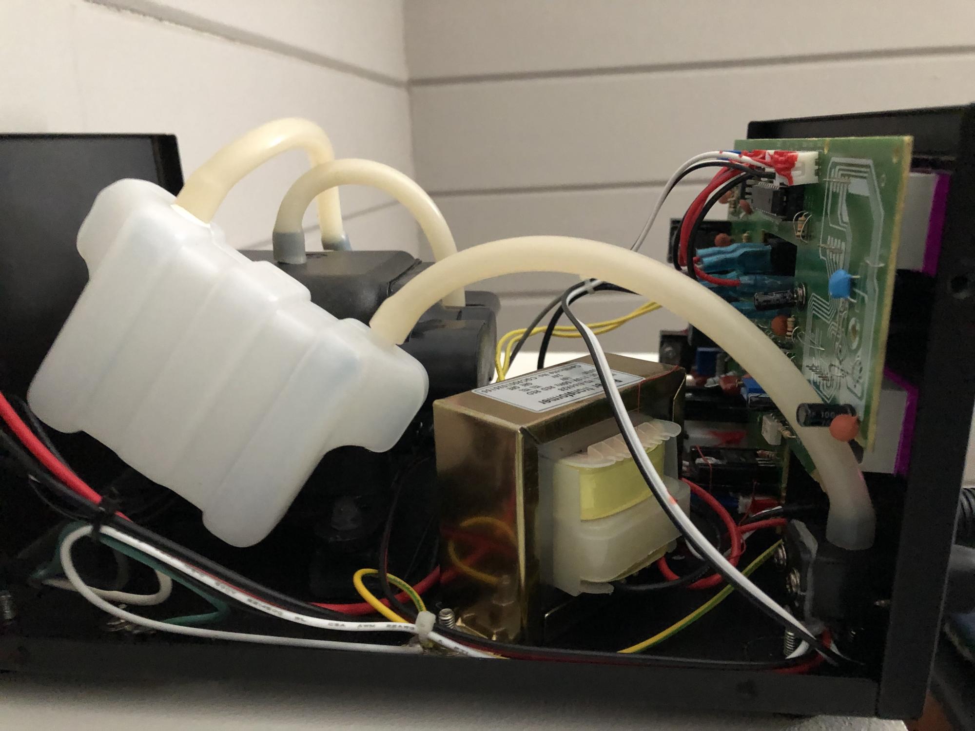

                        #71
                        I even tilted the reservoir? white tank to relief the kink of the hose coming off it but there was no noticeable difference

                          #72
                          Over time of use the volume of vacuum or air supply slowly decrease
                          I have not found a way to repair them

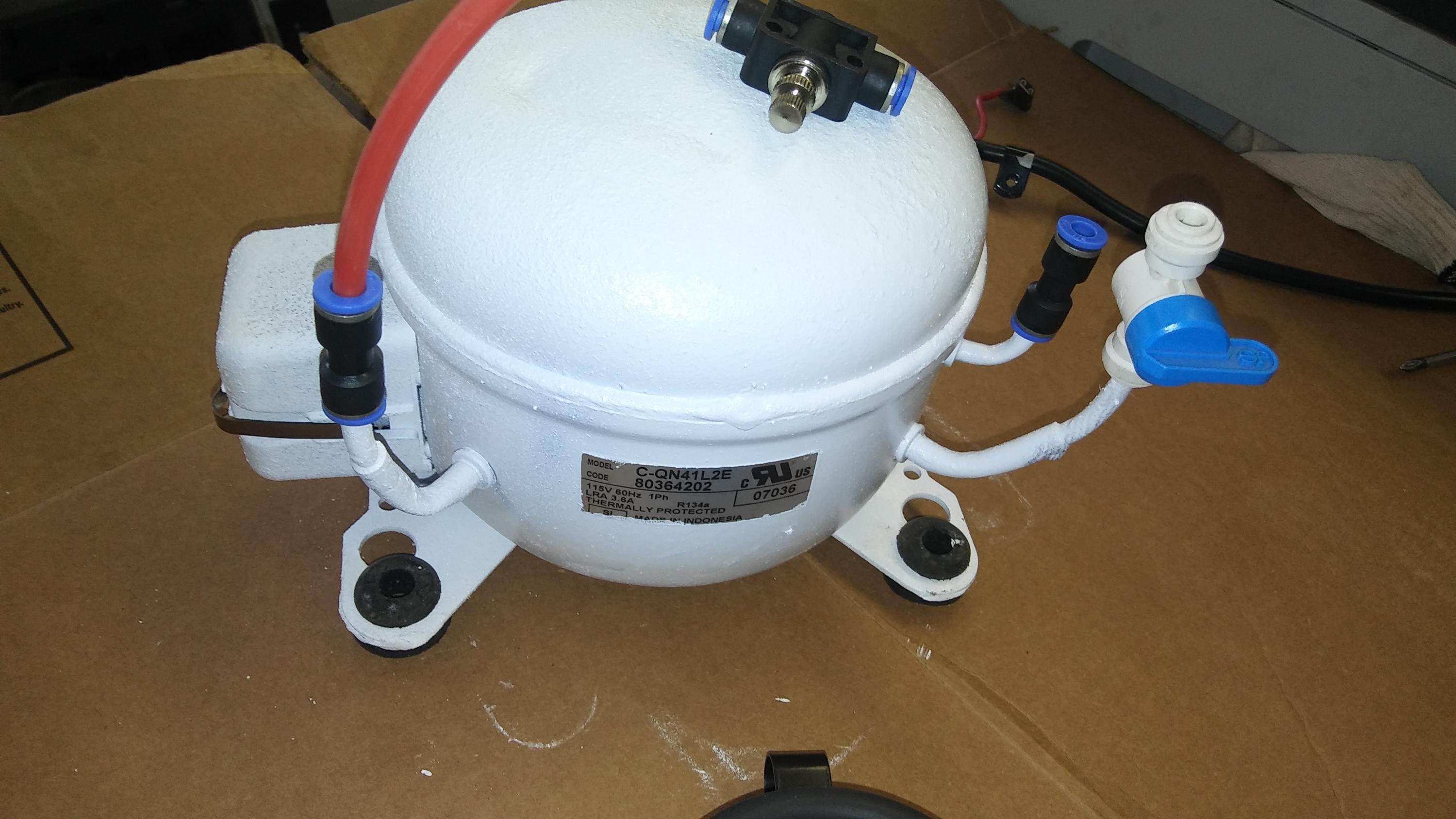

                            You will need a vacuum pump.
                            https://okelectronic.wordpress.com/2013/04/
                            My suggestion is this one. (picture 1)
