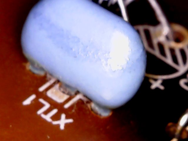

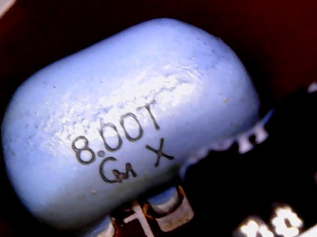

                    I have a part I can not identify. It says XTL on the circuit board. Here are some pictures. Does anyone know what this is? I am guessing it is a crystal or oscillator. But if so I need to know it's value so I can order some. It has 3 legs.

                      Re: Component identification
                      what's the bottom of the board look like, what's this being used in?
                      Three pin crystals are usually crystal filters, which are normally only found in radio equipment. There are some crystal resonators that are used in lieu of crystals for oscillators. This one appears to be 8MHz which is strange for radio use. What makes you think it's broken?
                        It's an 8Mhz 3 terminal ceramic resonator with built-in load capacitors
                          Awesome, so glad I got some answers. Well it is on a main board for a GE microwave. The reason I suspect it to be bad is because it is located next to 3 resistors that get very hot. All the capacitors near the resistors are fried from the heat and after replacing all the capacitors on the board the display still flickers but before replacing the capacitors the microwave was completely dead. So I suspect this part is bad because I can confirm all the other parts are good. And I test all my capacitors before installing them for correct value and ESR. from what I can see online, this part is responsible for creating the microwaves but could also be the cause of the flickering display.
                            I now need to know the value of the internal capacitor. Would help to know the manufacture as well. I guess the brand is Murata.
                              That part is the oscillator for the microprocessor ic It has NOTHING to do with creating microwaves. If you are getting any display at all the part is ok. The microwaves are created from the magnatron NOT from that ceramic resonator/crystal.
                              post pictures of the board and the model number
                              You really need to be carefull when working on microwave ovens, there is over 2 KILLovolts on the capacitor for the high voltage to the magnatron
                                I know it does not create the microwaves but it might have something to do with the frequency that makes the magnatron work, anyway that is what I believe I read in the datasheet. As far as if the part is bad or not I will know in the next few weeks as I have a bunch of these microwaves to test on. You might be right about it not being the problem but I will figure it out no matter what part is bad.
                                  It has NOTHING to do with the frequency of the microwaves either. The frequency is determined by the magnatron at approx. 2.45 Ghz.
                                  If you do something wrong you could expose the people using this mwo to harmfull radiation.
                                  These ovens need to be tested for proper operation (shutdown when door is opened) and have a leakage test done after working on them.
