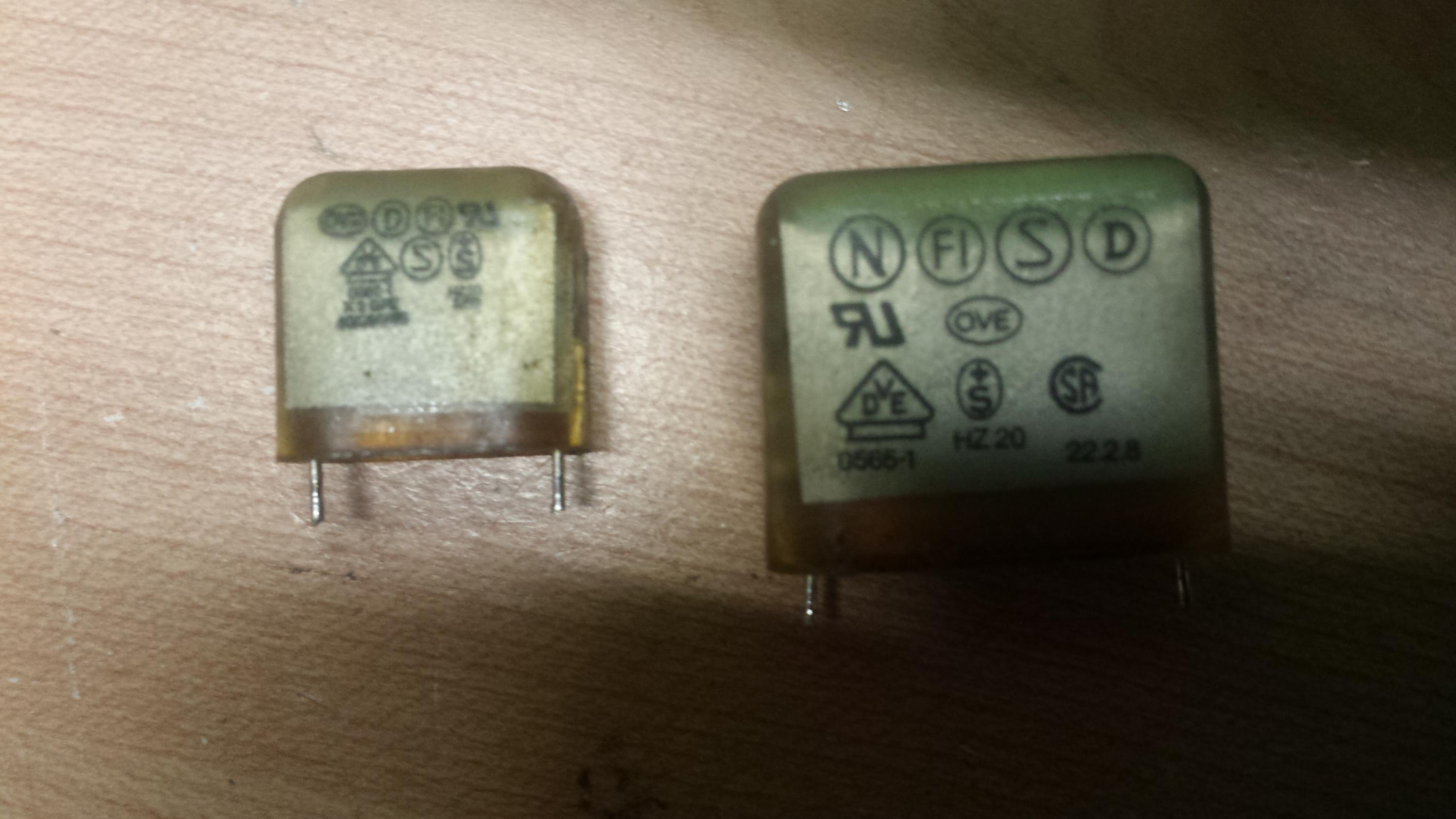

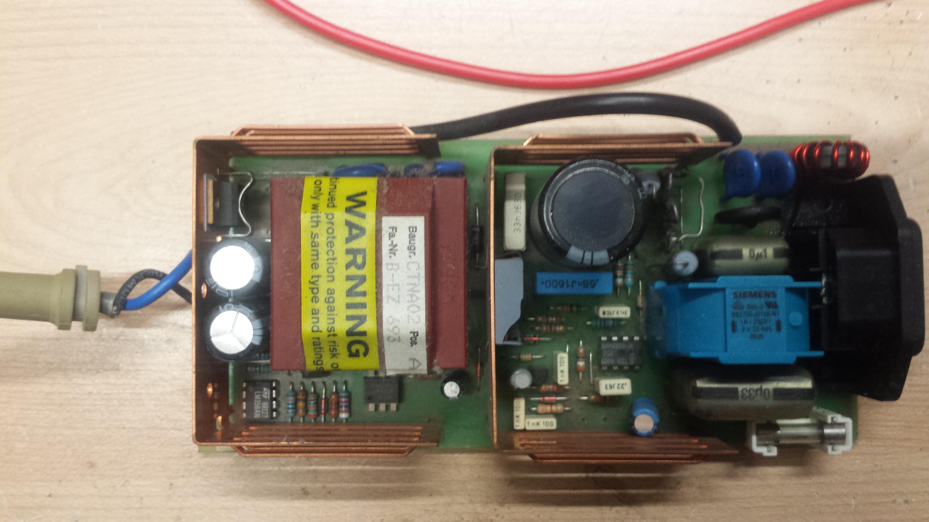

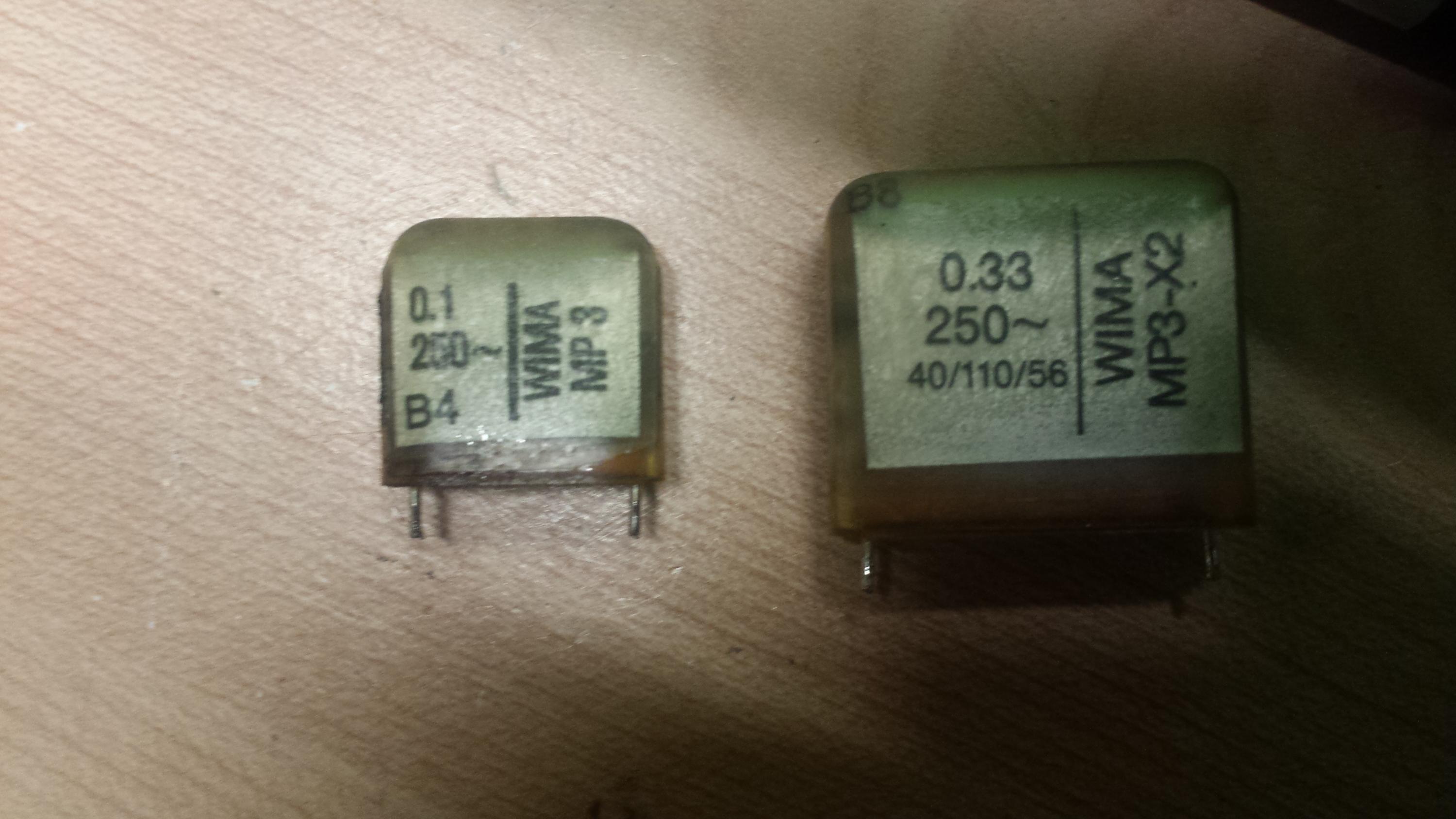

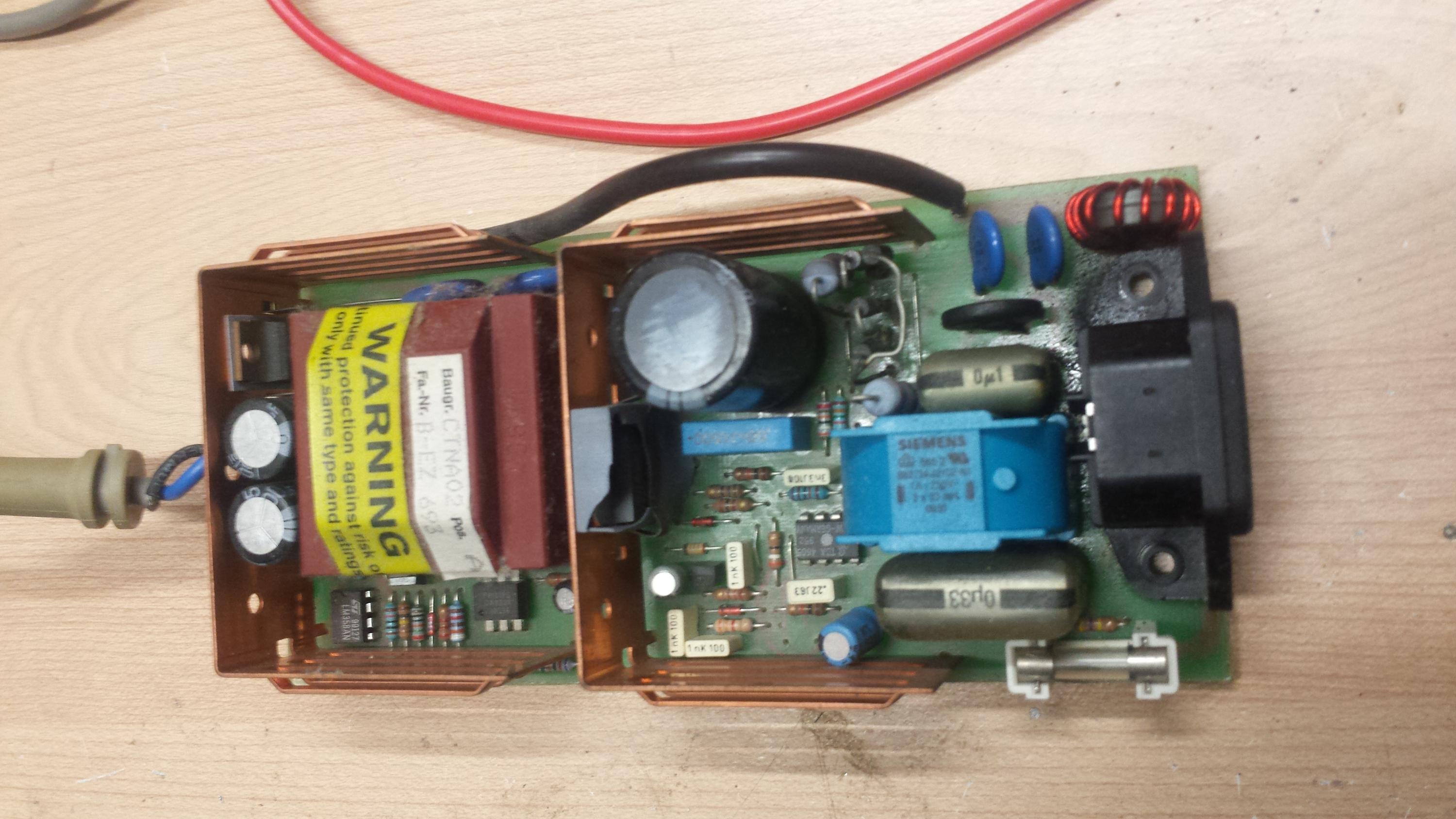

not sure but here are some pics of the filter caps I replaced. The small one blew in a cloud of smoke and boy did it smell foul... Still cant get rid of the smell from my workshop now a week later Pooooo..
I replaced they both because its a certain the larger one was probably next to blow.Attached Filesif you find these attachements useful please consider making a small donation to the site

Those are are filter EMI filer caps in the primary side, it should have cause the main AC fuse to blow.
But how about the DC filter lytics caps in the cold side, are they rated at 50V or more?Never stop learning
