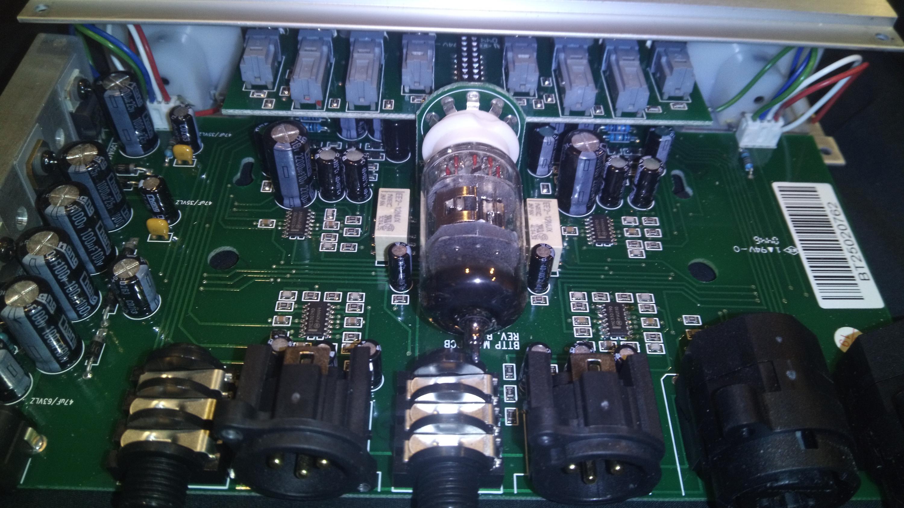

    So I have a Presonus Bluetube, a 240$ (on amazon, right now) tube preamp. So a lot of you will probably say, "I know of Presonus as being a good brand, what's up?" Well, let me show you a couple pictures, and give a review/story on this PoS.
    So in late April of this year, my friend who owns a music supply store came to me and said, "Hey, I got this preamp that came back right after it sold, can you check it out?"

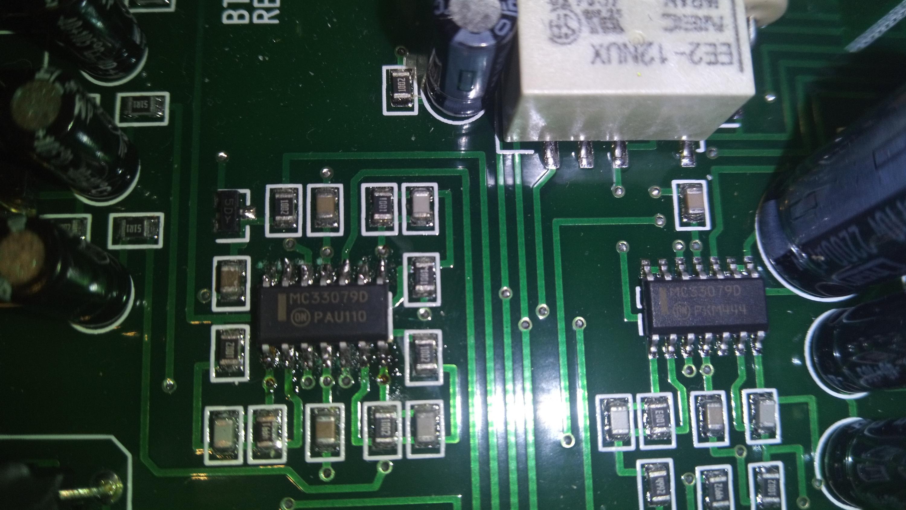

    So I contacted the customer before opening it, and I was told that it was making a horrendous, fast paced clicking noise, and channel 1 was no longer functional. So I opened it up and found that the main MC33079D chip for the output had literally gone up in flames.
    Well, there's gotta be a reason for that, or it's just a defective chip. I proceeded to plug it in - literal worst idea I've had in awhile. Immediately the clicking noise came on, shit started smoking to I unplugged it immediately, what the fuck?
    Well, the clicking noise to me sounded very 60HZ, not 120HZ like normal rectified unfiltered DC. So I proceeded to check the input rectifier, oh wait, there is no rectifier! There are 4 diodes for rectification, only problem is they are all single wave rectification, what the fuck?
    So one of the diodes had failed short after only 6 days of use. Neat. I replaced the diode, then proceeded to go online and search for the IC that had fried. It's 8$ for 72 of them. I have a load of these if anyone wants some. So I got it, Louis Rossmann'd it (as the picture of my soldering clearly depicts). After that, Huzzah! It works... Except the customer decided to return it and get another unit from another brand. Great.

          WTF kind of tube is that? That can't be real. That plate/grid/heater array is BS. That can't be functional!

              It's real, and apparently this thing uses 12AX7 tubes... Do I dare throw one in? I have a fucktuple of new old stock tubes, but I can sacrafice a used Sovtek to see if it even works. But yes, I measured the voltage for the tube, 45V on the meter, very stable too.

                That's not... That's not a 12AX7. Not functionally anyway. Throw one in for shits and giggles. Real 12AX7 are rugged little bastards!

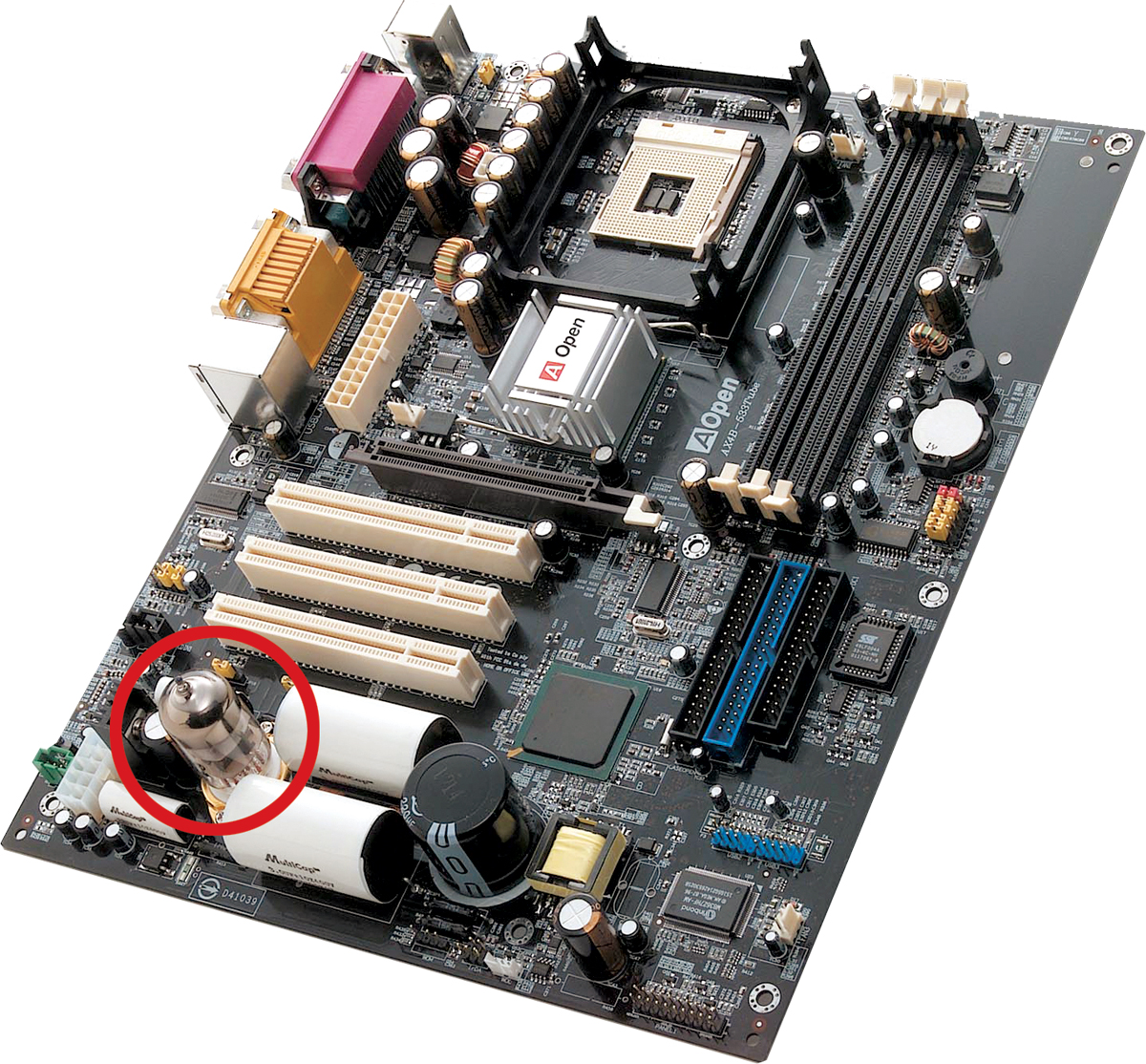

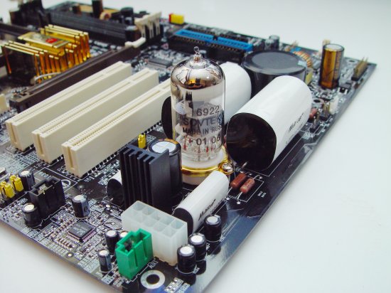

                    There was AOpen AX4B-533 Tube PC motherboard (2002) with 6922 cathode follower I think it had 45VDC for plate supply. Sigh.
