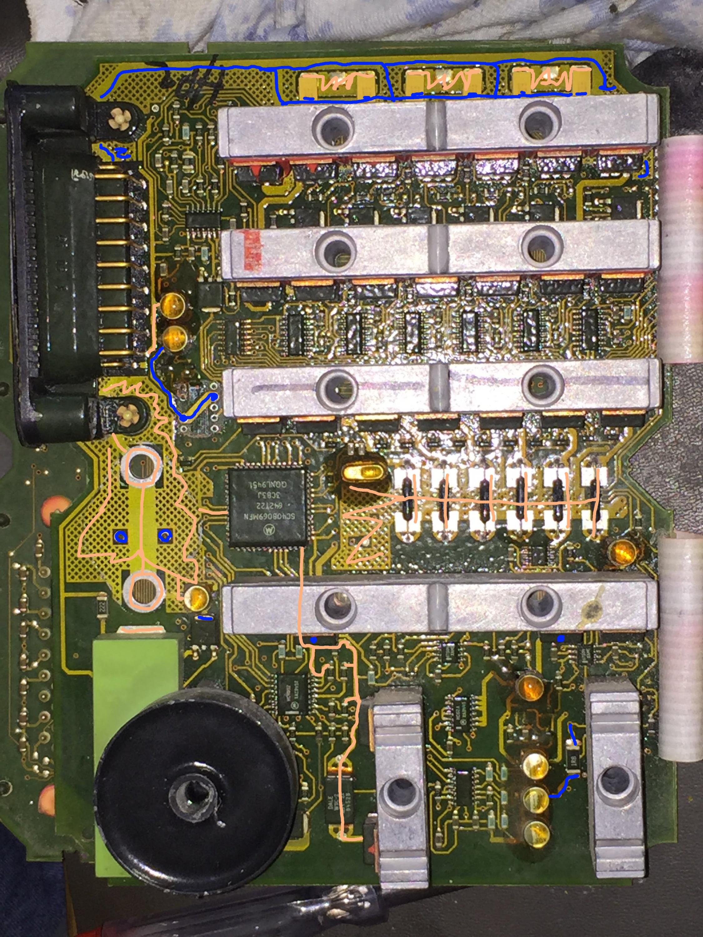

      Re: Need help to ID this transistor
      Originally posted by stj
      strange.
      lets see what it connects.
      is the screwhole(s) actually connected to the groundplane that the metal case also goes on?
      and, does the large track go to any pins on the big connector?
      Here is what I get. Yes, the large track where the screws go on for the TO-3 case goes to the GND pins on the connector (orange). The two pins from the TO-3 go also to the connector on the positive (blue). The ground plane on the board isn't always ground, specifically after the connector going to the orange caps!
      Watch the pictures if you compare between top, bottom and the one where I was shining a light thorough. It revealed another layer with traces in between.

            Cording to my Leakseeker the short is in between the 2 pins of the TO-3 pads, any further I go, as further I get away from the short. What gives?! I cant find anything wrong, checked all the ceramic caps too. Is there a mad purpose of having these two pads shorted together? For some reason I doubt that this TO-3 thing is a FET. Nothing really fits if I compare my M11 ECU to a N14 ECU in the VGB supply.

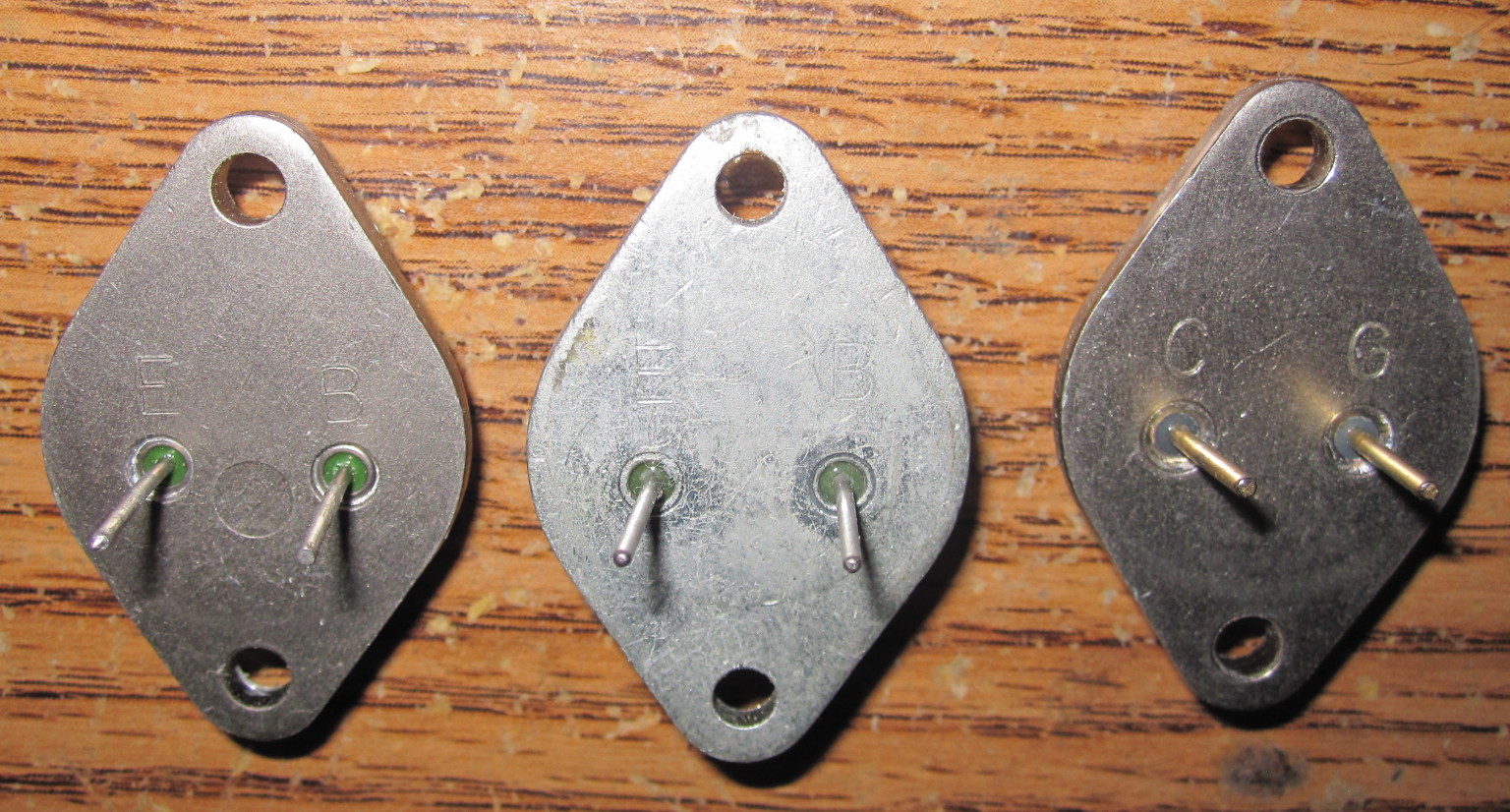

              maybe dremel the top off the device - see if it looks like a single gate or something else.
              • eccerr0r
                Solder Sloth
                • Nov 2012
                • 8701
                #47
                If it's a nonstandard part then we can also forget substitution?
                Other things... this is "supposed" to be high reliability and I would be very surprised if Mot/Cummins would omit the protective gate zener if that were a MOSFET. That is, if it doesn't have the protective zener inside...
                So is it a dead short or how many ohms are you seeing between the pins? If this low resistance was "normal" then it could likely rule out a MOSFET as it would need several volts to hit saturation threshold and the low resistance would thus dissipate a lot of power.
                IC Regulator - ruled out?
                IC other - ruled out?
                Transistor BJT - not ruled out
                Transistor MOSFET - possibly ruled out
                Transistor IGBT - possibly ruled out
                Thyristor SCR - not ruled out?
                Thyristor TRIAC - ruled out
                For fun:
                Left: 2N3055 (NPN-Si)
                Middle: 2N1136A (PNP-Ge)
                Right: MCR649 (SCR)
                All from the days where stamping pinout was not a luxury...

                                        The DC-DC converter for Vgb supply it generates drive voltage for the high-side N-ch. mosfets. The hard part is the DC-DC transformer is on the output and input of the power transistor.
                                        It looks like a self-resonant switcher, for Vgb.
                                        The old model ECM uses discretes and the next gen ECM (Cummins Celect N14) uses LM2901 comparators.
                                        I would sketch out a schematic.
                                        I confirmed the boost-converter is for the diesel fuel rack solenoid.

                                          Maybe you can enlighten me why the 2 pads from the TO-3 are shorted (as a self resonant switcher)? I don't think this is supposed to be like that. However, there is no external diode, or shorted cap that I could find that. So maybe there is a diode internally in the FET?
                                          Making a schematic is out of question, unless I unpopulate the board. The board has at least 3 layers and I am loosing the traces as the go underneath of some IC, cap or whatever.
