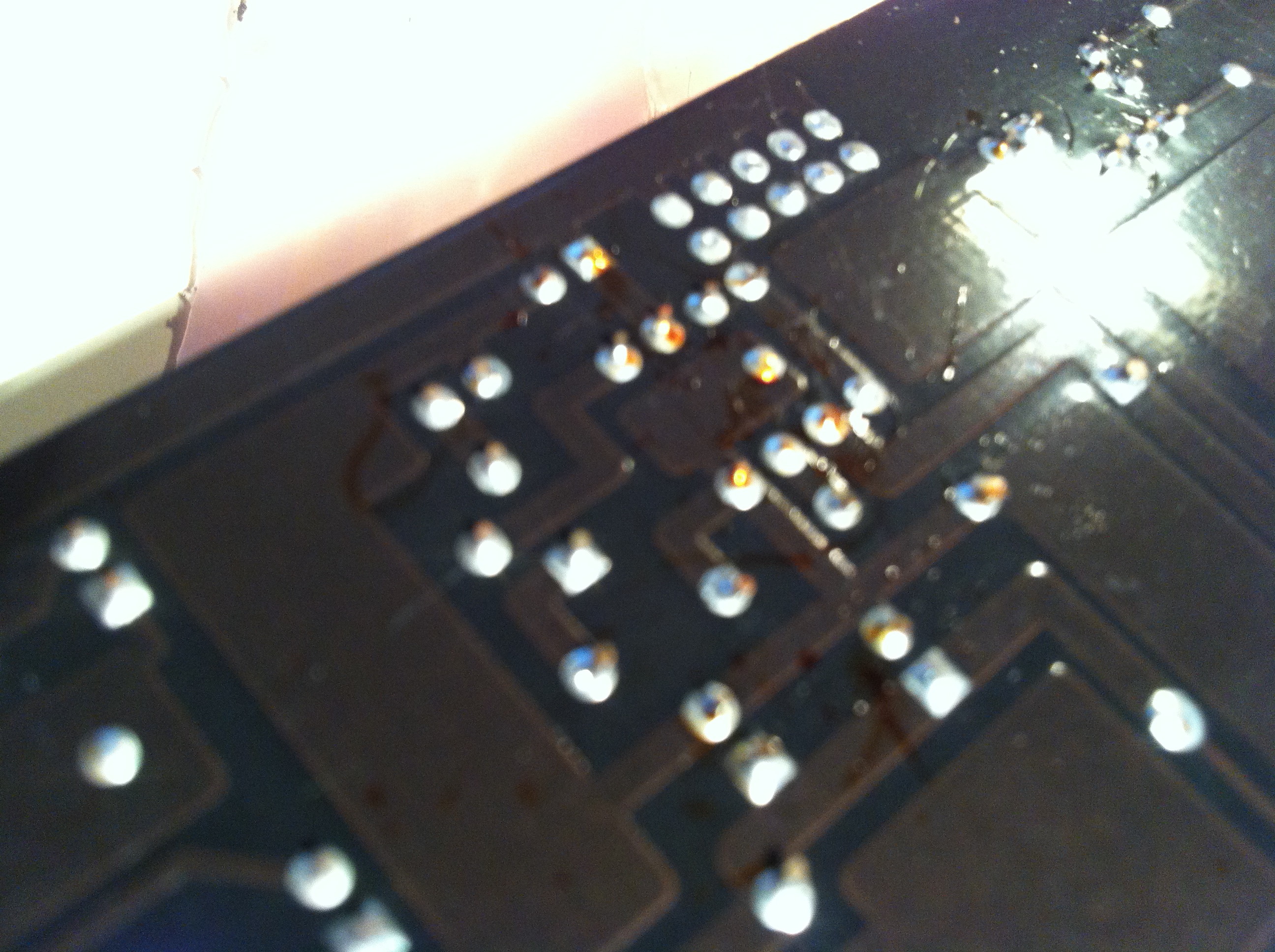

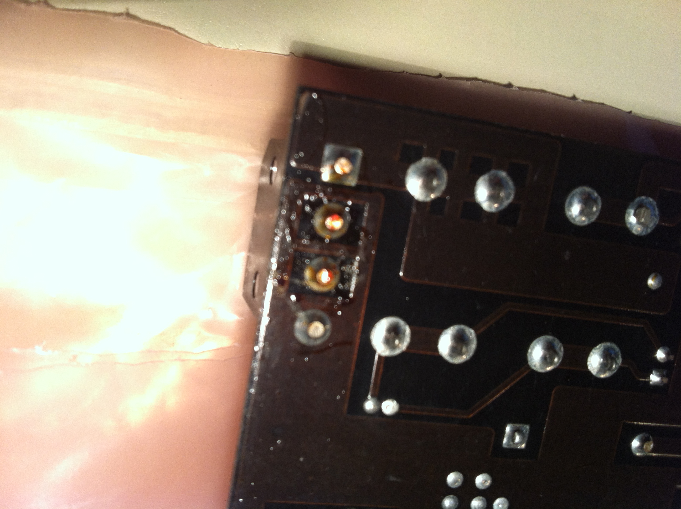

    Does this Bridge Rectifier bottom look bad?
    Does this Bridge Rectifier bottom look bad? It's from a Elite Miracle-One gate opener.
    I pull this board from my gate opener this morning after it blew a 3 amp fuse yesterday. The gates refuse to open when I hit the remote.
    I checked the board and saw a fuse bad, I replaced the fuse and when I hit the remote button and the fuse blew again. I pulled the board and everything is normal on the top side but on the bottom I found two places the the solder looks rusty.
    The first photo group is below the bridge rectifier, the second photos is from the under side near the left side of the board.
    Does the rust color say something?

      you need to check it with a meter,
      the brown is flux from a previous re-soldering.

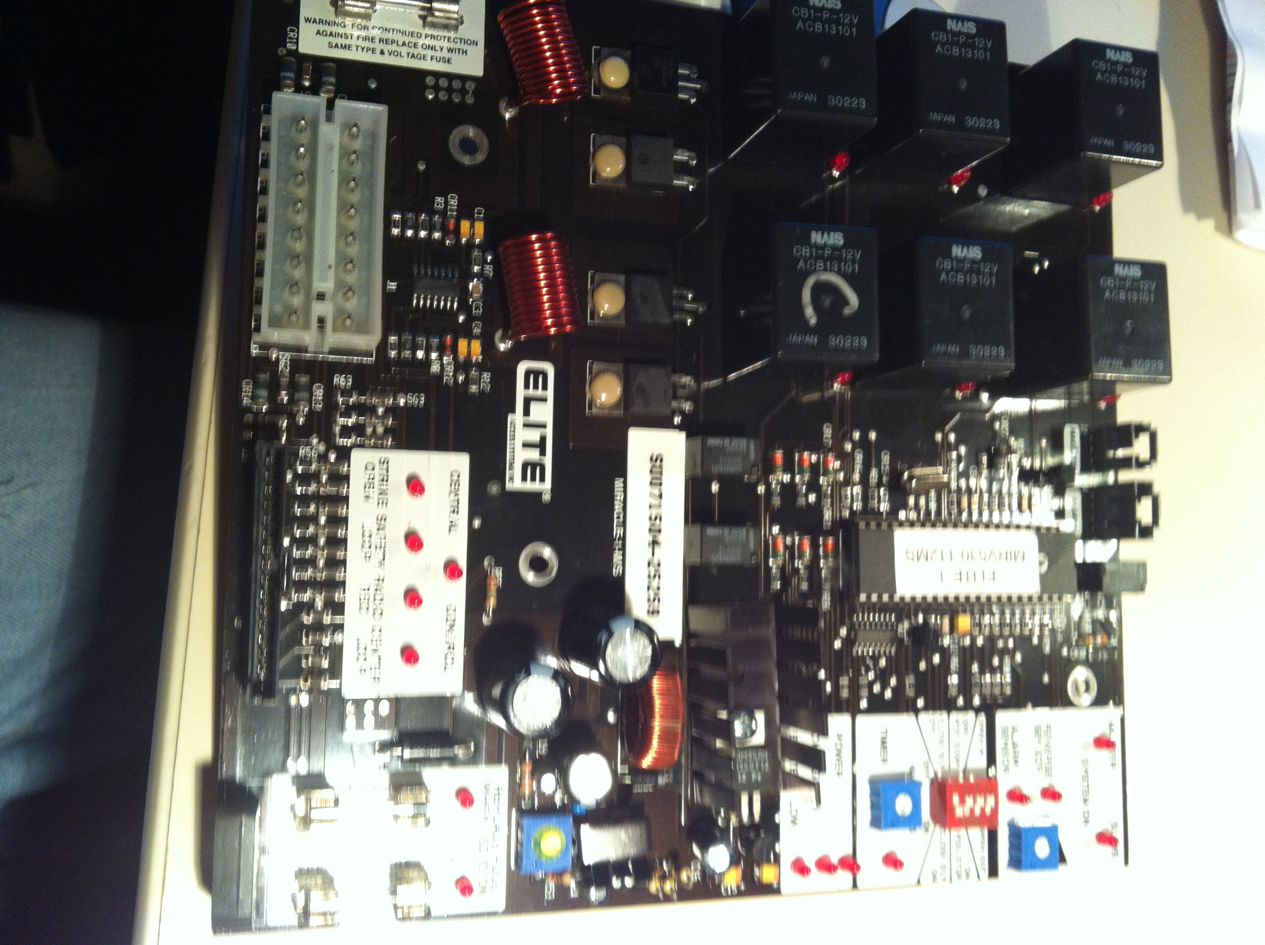

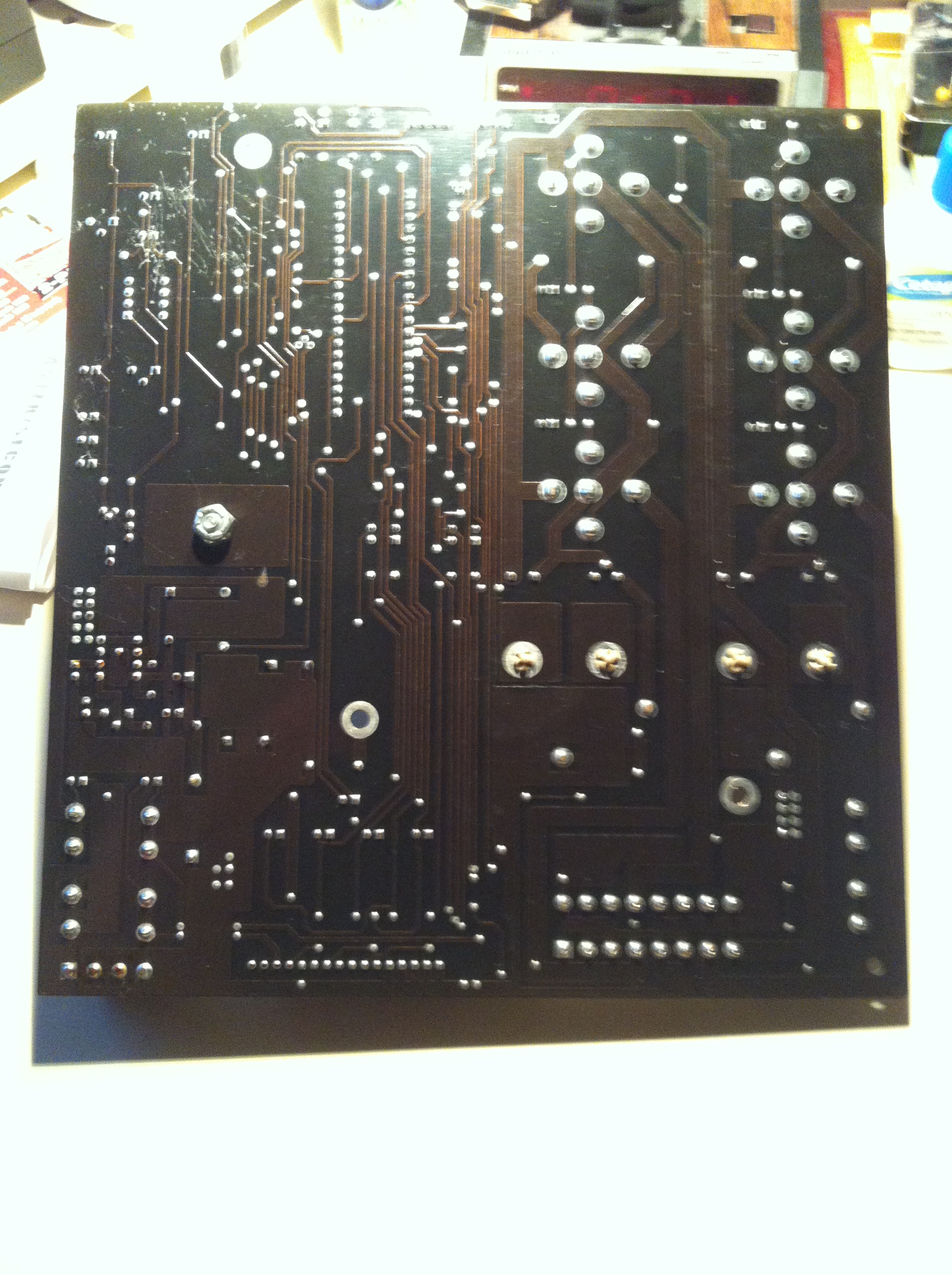

        Good clear straight shot pictures of the whole top and bottom side of the board will help troubleshooting.
        You do have meter for testing, right?

              You have 3 fuses on that board , which one that blow, the 15A or the two 3A fuse?
              https://www.badcaps.net/forum/attach...8&d=1493256609
              I cannot clearly see how the two 3A are connected in that section due to poor contrast of the picture.

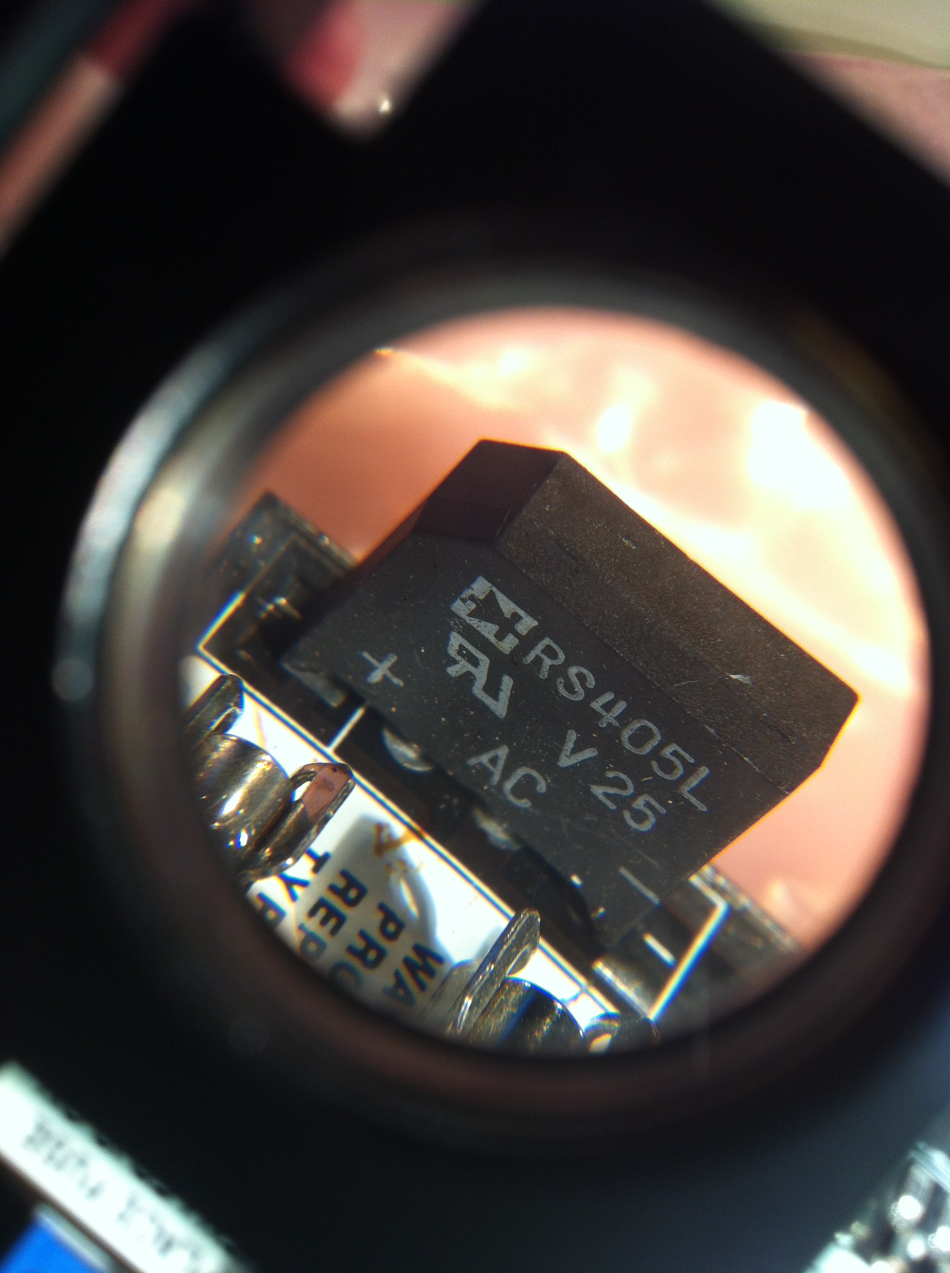

              BTW, you can do resistance test between the two outer pins of the bridge, and also between the two inner pins of the bridge see how Ohms it shows.

                There is a 15A on the left but the two together on the right are smaller.
                The bottom right section have two, one is a 3A the other is a 1.5A fuse
                The 3A keeps blowing, third time I ran out of 3A fuses.

                  maybe do the test as budm suggests in post 7 just too rule out the bridge rectifier.

                          Re: Does this Bridge Rectifier bottom look bad?
                          It's the control board fuse blowing only when the motor gets activated?
                          The left 15A fuse is for the motor.
                          The middle 3A fuse is for the control board
                          The right 1.5A fuse is for the battery charging.
                          To me, means the short is in the controls for the motor or brake.
                          The power semi's below the relays, looks like two sets of Schottky diode/mosfet mtp50n06v on plastic rivets. Check/compare readings on them.
                          I looked again and the one far left mosfet looks like it was replaced, this board may been RMA'd already.
                          Seems strange to have 6 power relays and dual boost converter? or SSR... must be the brake is mechanically normally on?
                          I would check the 4 power semi's and the surge suppressor board diodes are easy to check out with a multimeter on diode-test, it's a bunch of gas tubes and a couple TVS diodes.

                                Bishop, can you post pics of both sides of the Elite Miracle-One surge suppressor board and the reset switch. It looks like an electronic circuit breaker but not sure. Doubt it's this causing the problem.
                                To fix this gate opener, it is best to troubleshoot and find the short-circuit.
                                I agree with budm, the new power transformer will fail because the short-circuit is still there, possibly the reason the old transformer died.
                                It could be the surge suppressor board, control board, or overload from attached devices such as the radio receiver, burglar alarm outputs, photoelectric eye, siren etc.
                                Spend 5 minutes with a multimeter on ohms or diode test and check things. We can help.
