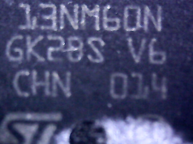

Can I sub STF13NM60N with FDP18N50?
  • capwizard
    • Jun 2016
    • 1991
    STF13NM60N N-channel 600 V, 0.28 Ω typ., 11 A MDmesh™ II Power MOSFET
    in TO-220FP, I²PAK, TO-220, IPAK, TO-247 packages
    FDP18N50 / FDPF18N50 / FDPF18N50T, N-Channel UniFETTM MOSFET
    500 V, 18 A, 265 mΩ

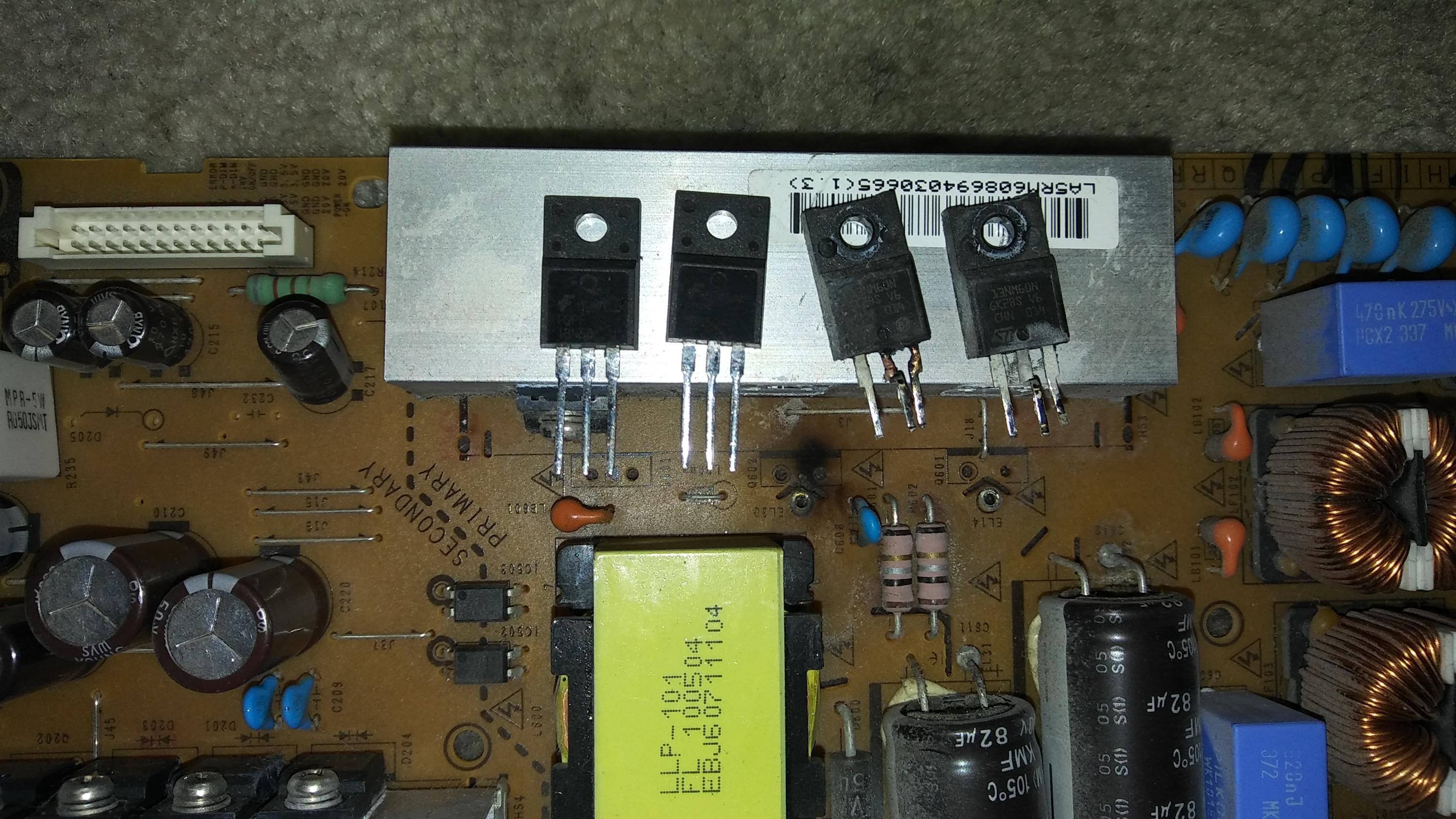

          If no bad connections why they burned out violently, I always update to higher grade parts available to me. EX: FDP18N50 replace FDP8N50, FDP10N50, FDP12N50, FDP15N50, FDP16N50 etc.
            Re: Can I sub STF13NM60N with FDP18N50?
            Why go lower Voltage?
            How about the Vgs (th) spec, capacitance, etc?
            • capwizard
              • Jun 2016
              • 1991
              That happen to be one of my old inventory I had, I doubt about it ,that's why ask "Can I sub STF13NM60N with FDP18N50?" The PFC used 418v and FET Vmax 500v almost is dangerous. Customer picked up TV yesterday, redo will update.
