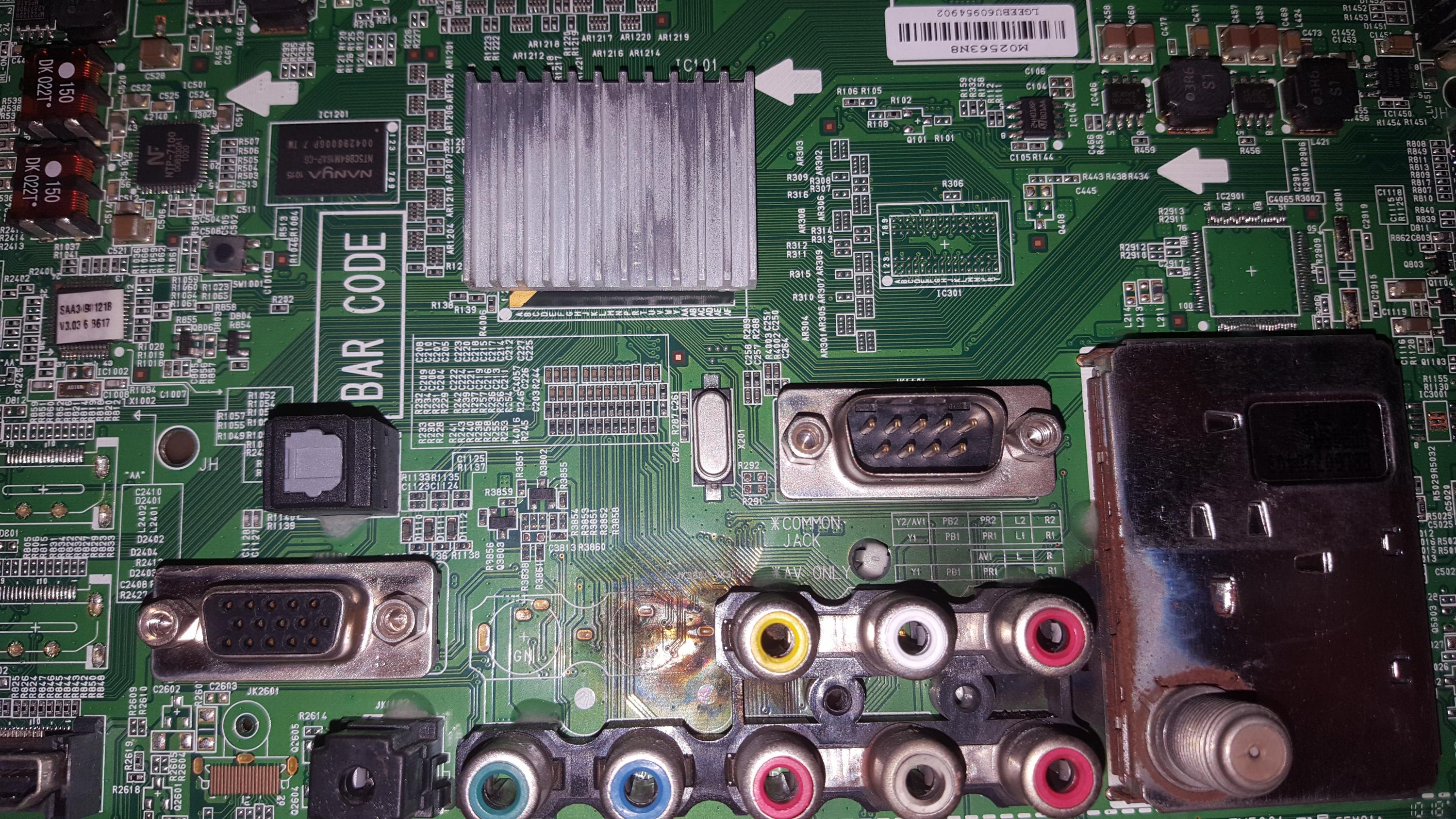

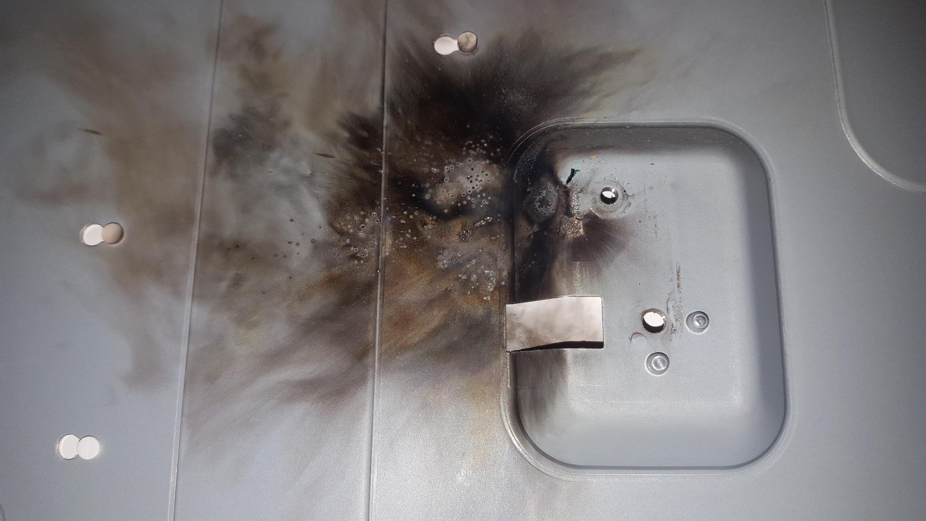

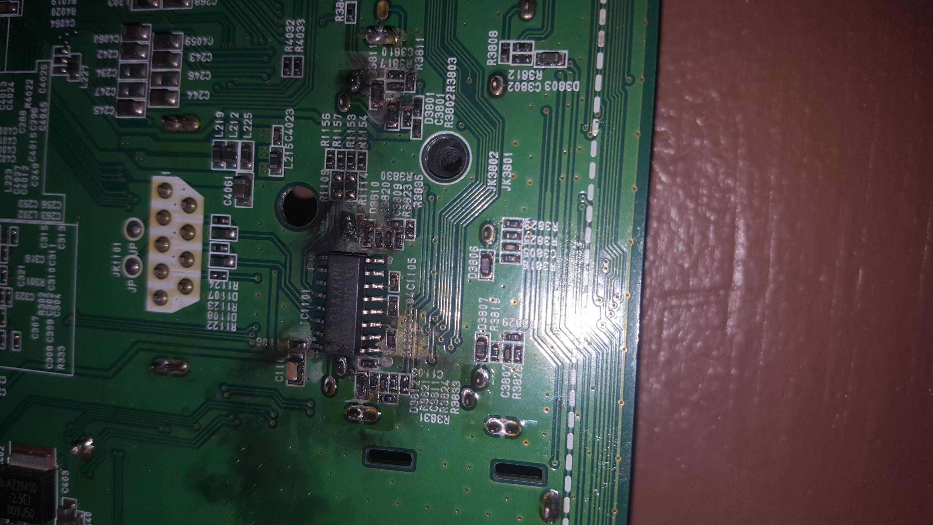

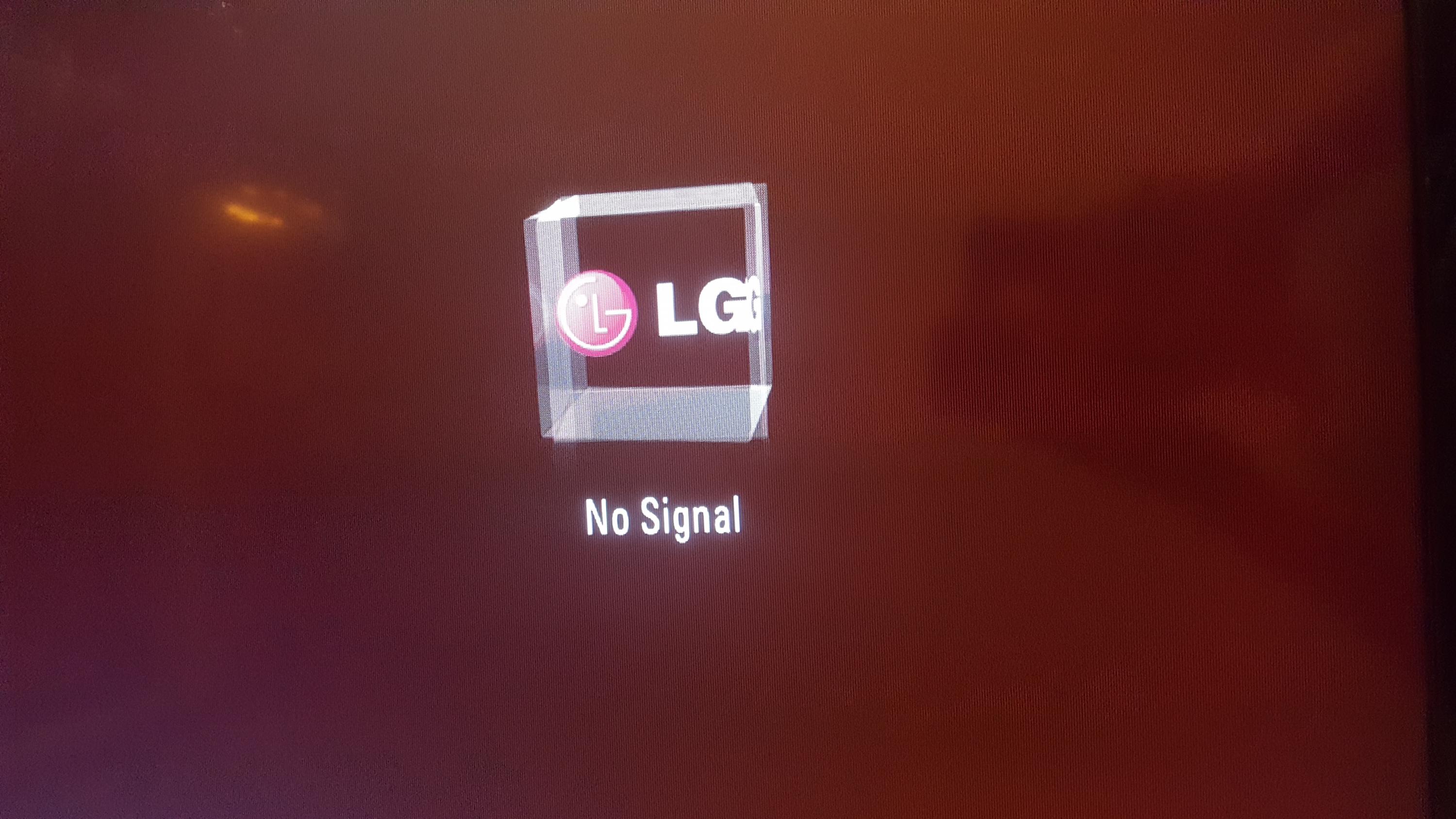

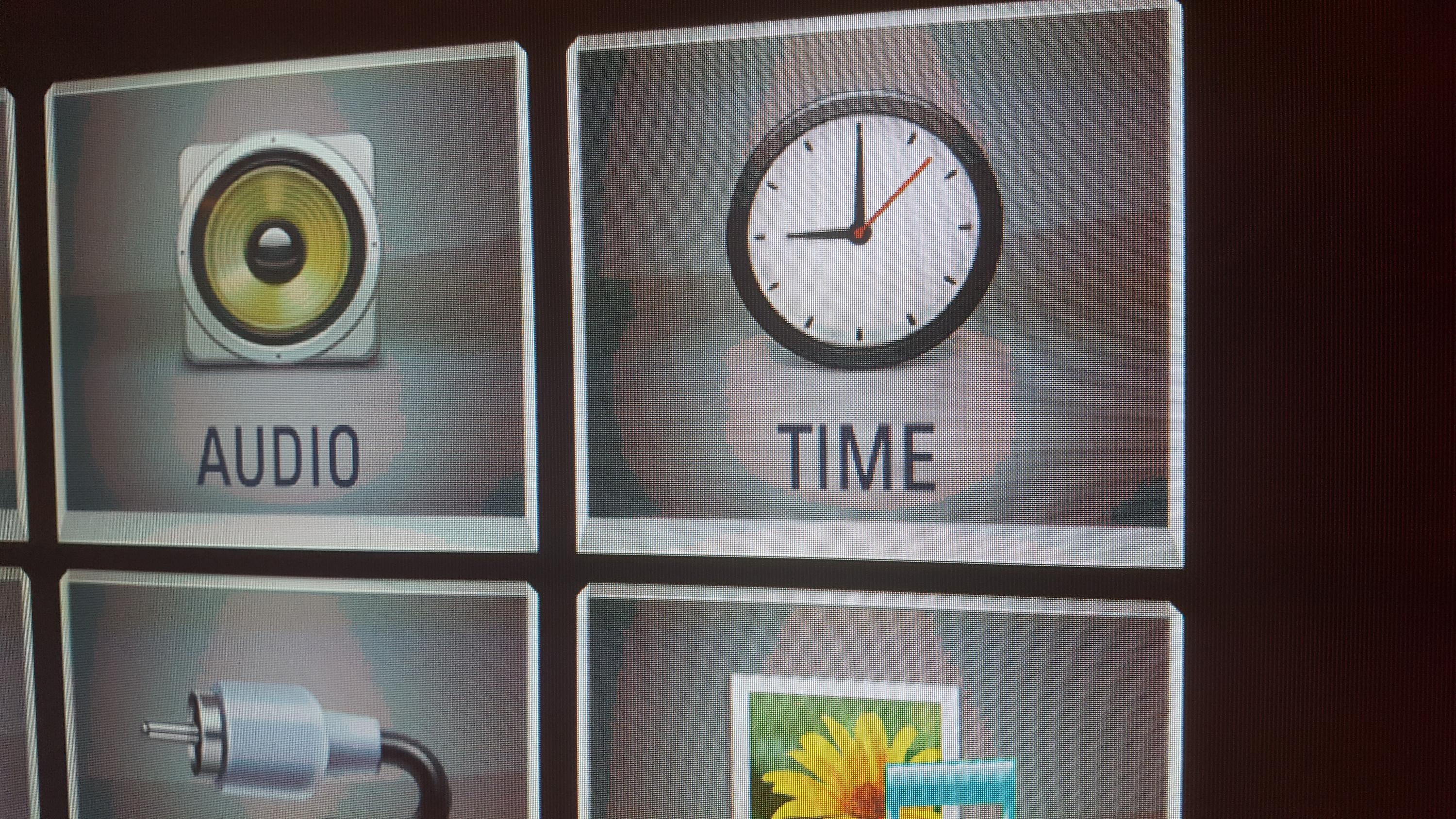

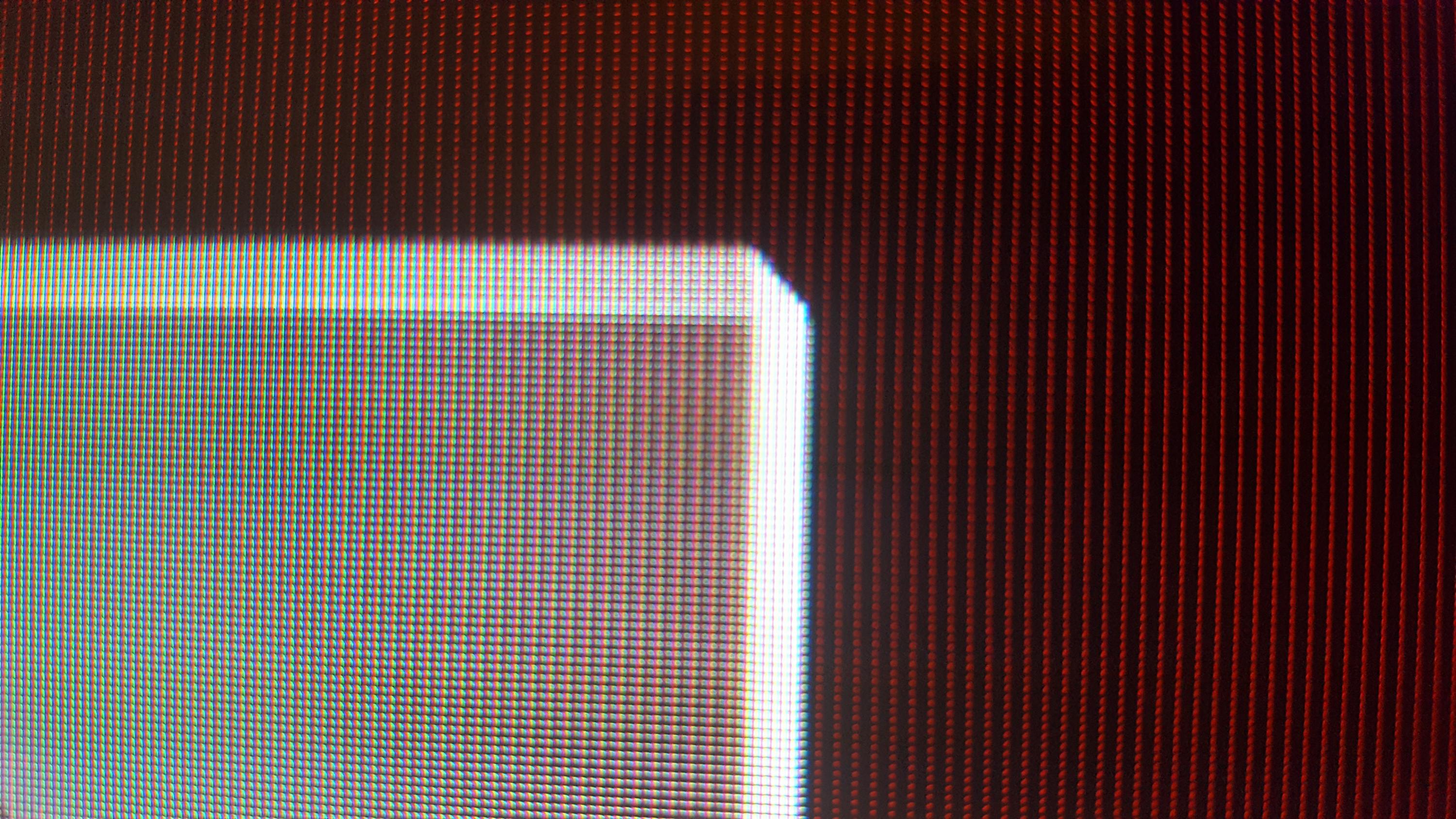

    I got a LG 42LD450-UA with the worst case of lightning damage I've ever seen. The main board was absolutely toast. The lightning came in through the composite inputs and took out those circuits, the main board was a total loss. I replaced the main board with a compatible one, but now every other column is red. It seems too consistent to me to be a panel fault, at first I thought it was incorrect firmware, but after checking the INSTART settings and force flashing the latest correct firmware using the wonderful resources at http://openlgtv.org.ru/, the problem still persists. At this point I am wondering if a failed TCON board can cause this, or perhaps a faulty connection between the TCON and the main board. Any insight is appreciated, thanks
    Re: LG 42LD450 struck by lightning, replaced main board, now every other column is re
    I would carefully examine and reseat all cables to t-con
      Hey dskall, I checked and reseated the cables to the t-con, they look good, it didn't make a difference. Could this be a failure of the as15f chip?
        Not likely as15 problem. Possible t-con, lvds cable or main board. I know that doesn't narrow it down much. Maybe others can.
          Replaced the T-CON, TV is fixed! Another one back in service.
