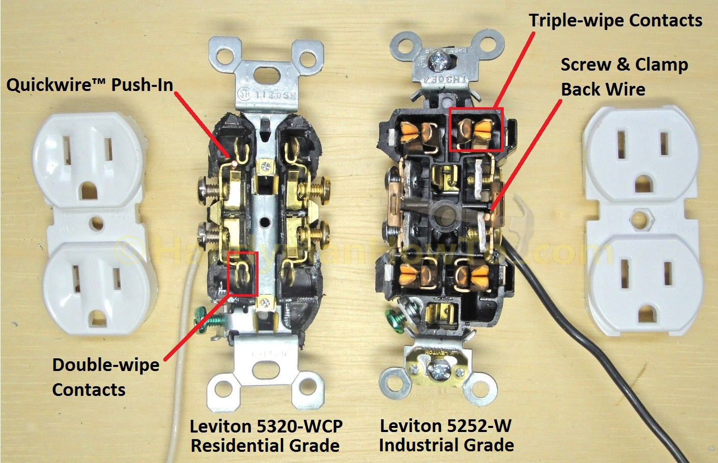

          #44
          Re: Using higher amperage receptacles with lower amperage breakers
          Originally posted by Spork Schivago
          Isn't that called back stabbing and isn't that a bad idea? I planned on just using the screw terminals and wrapping it around and tightening them down. I heard some bad stuff about backstabbing and believe it should be avoided, unless things have changed. From the sounds of it, things have changed a bit, but does it actually make a difference? Is it a good idea to backstab now? Thanks!
          Are you saying it's okay to back-stab with the GFCI outlets?
          It is ok if the "back stab" terminals use a clamp and screws to hold the wires in, as is common in GFCI and even higher-end standard outlets. The cheap spring loaded clamps that don't have much contact area to begin with and hold poorly on cheap outlets are what causes issues.

            #45
            Spork - the clamps on the GFCI's and spec grade devices are not the same as back-stabbing on the cheap devices.
            This is pig-tailing, although I don't use that brand of wire nut:
            https://s-media-cache-ak0.pinimg.com...d313d72737.jpg
            Live work? Sure I do it. With permission from the local power utility, my boss and I have permission to pull meters and reinstall for panel repairs and service replacement.

              #46
              Spring-clamp connectors can be good quality, they're the only thing allowed on locomotives due to vibration and temperature swings. Europe loves them for DIN-rail panel stuff.
              But on outlets they suck badly. I never use them because copper oxidizes with brass and crappola connection happens, with age and chinese drywall H2S gas.
              I can take 10 seconds and tighten the screws. Really.

                #47
                I am trying to explain the new connector that the wire can be put in the back of. These are not spring loaded like the old connecters that were no good. The screw on the side of the connector is what causes the tightening down on the wire. It is much like how one puts a wire in a breaker terminal and tightens down on a screw. Look at the picture on the right hand side of redwire's post 46. The left one is the old connector. Noticed the screw is not tightened on the picture on the left.

                                        #59
                                        Is there a way to tell without tearing apart the device? Also, are there any benefits to backstabbing? If not, I'll probably just do the screw connection.
                                        I know in our old house, my dad hired a "master electrician". When I say master electrician, I really mean a scam artist.
                                        Anyway, half the outlets didn't work. We tore them apart and where he screwed the wire down, it had come off on a ton of outlets and switches! Even at the breaker box, there were white wires that weren't connected. Whenever we flipped the switch in the bathroom, we'd see a spark. I tore off the wall plate and the connections there looked good. It took me a while to figure out what was causing it. It was the white wire in the breaker, it wasn't connected at all! Every time we flipped the switch, at the breaker box, you could actually see the spark arcing from the white neutral wire to the neutral busbar.
                                        With the good connections in the back, are they less likely to come off? Personally, I always try to bend the wires into a circle or almost a circle, around the screw, and then tighten the screw down. I have them bent in such away where they grab when the screw is tightened.
                                        The "master electrician" had his wires going every which way. Some grabbed when the screw was tightened, some were bent the wrong way and wanted to slip out. He didn't know any codes at all. We had a scuttle and you couldn't even get into the attic, there were wires going over the freaking scuttle! That's not up to code at all. We had to slip the scuttle thingamajig out of the way and slide up through one of the wires. What a rip off! My dad went for the cheapest guy he could find, 10$ an hour. I told him a master electrician isn't no 10$ an hour! But his "friend" recommended him. Such a freaking scam! He also had my dad do most of the work! He just supervised! I spoke my mind, right in front of him, and the guy got really pissed and asked why I don't do the job if I don't like his work. And I said because we're freaking paying you!!!!
                                        The benefit I would say is that the wires in the box can be shorter, will fit in the box better, less exposed surface to short out to the box and it takes less time. Do what makes you comfortable.
                                        The easy way to tell is put a wire in the back, if it can not be pulled out without resistance then it is the wrong type. The ones that work correctly you need to tighten the screw down for the wire "not" to move. You can then loosen the screw and the wire will again be able to come out. You will need to strip the end of the wire to a certain length. You can figure this out by simply stripping one wire a 1.5 inches and measure the amount inserted into the receptacle. You will then know approximately how far to strip a wire You can also ask the person you buy the product from and to verify they are telling you the truth carry a number twelve wire with you and verify it in front of the sales person.
